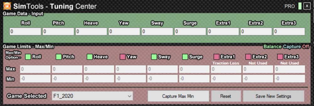

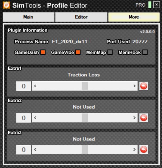

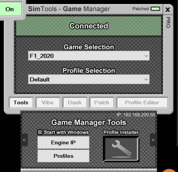

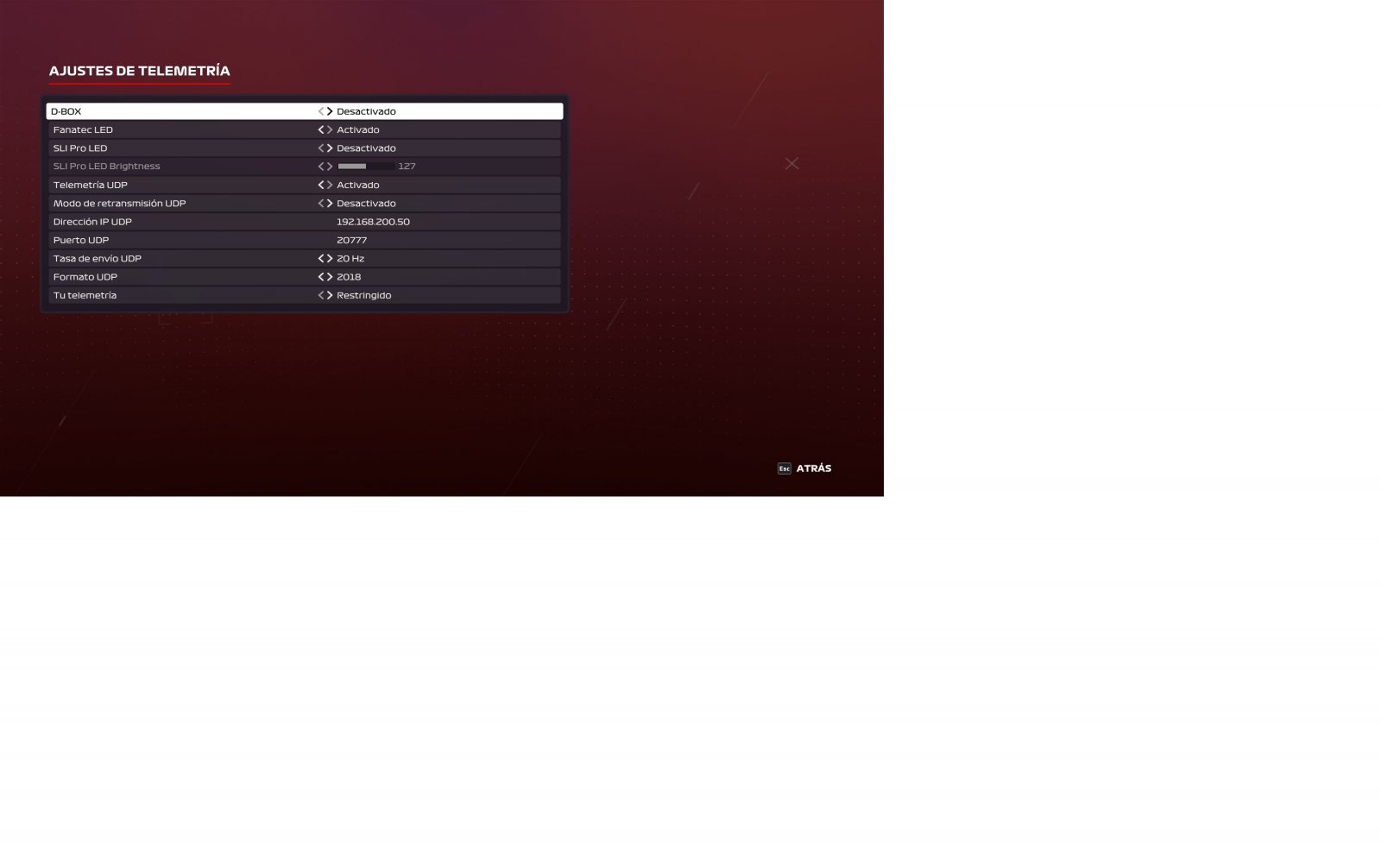

    Can you please post pictures of ALL of settings.

  5. SEELGAIN
    SEELGAIN New Member Gold Contributor
    Feb 3, 2021
    - 39Coins
    3DOF, Arduino
    Tunning center seetings
    For the moment it´s empty...ussually I run a game first time with movement to set values but in this case no movement...

    Presuming you have game data you need to capture TC Min/Max values and tweak from there.

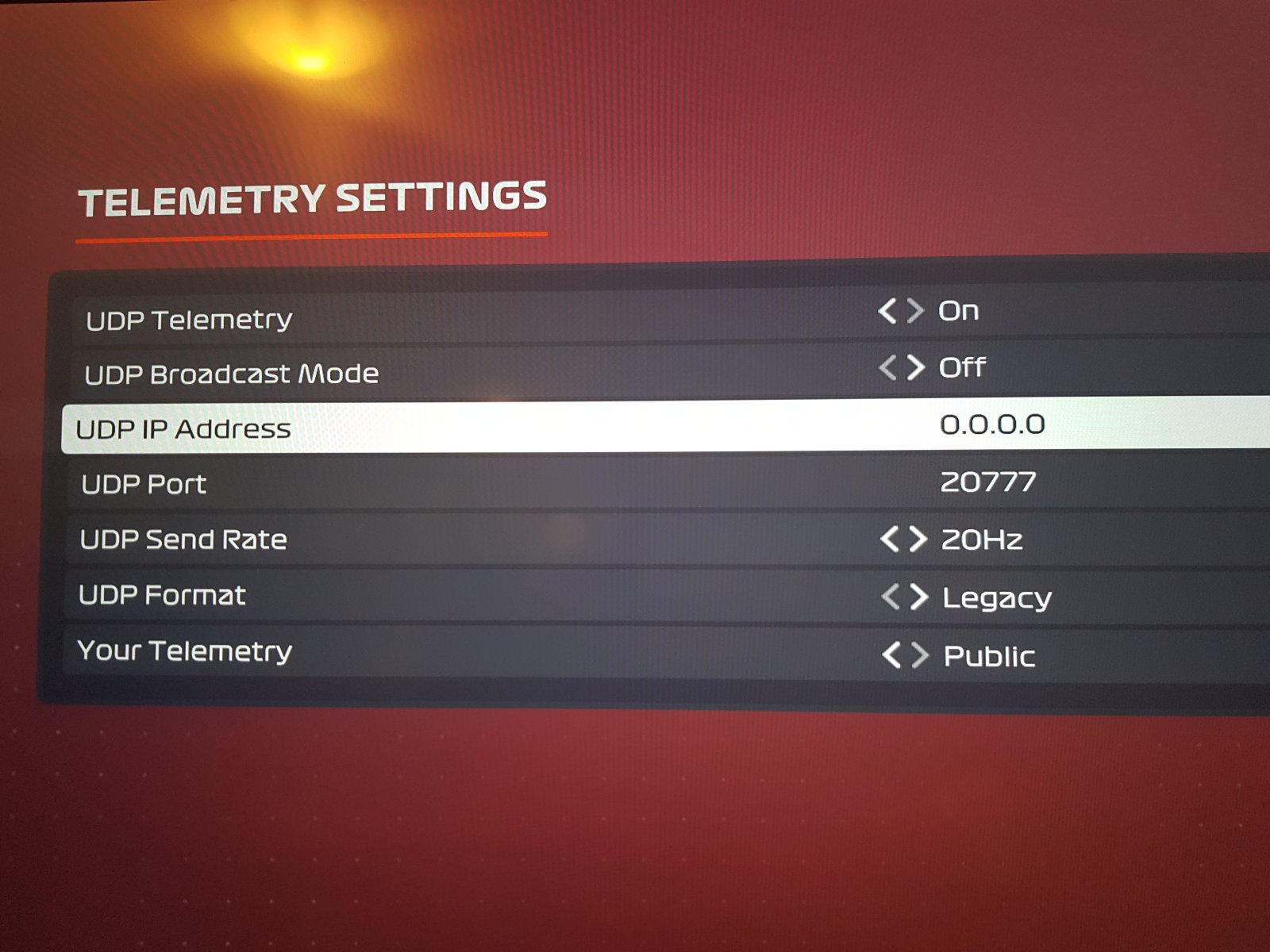

    You could try this one. I have this working on xbox - manual start, plus a pic of in game telemetry settings.
    You might just need to readjust max/min

    It was worth a try. you could try the one from vthinsel, i know it says its F1 2017 but i believe when settings are in legacy mode it works.
    i retested my F1 2019 plugin for ps4 and it works on xbox and for game F1 2020 in legacy mode, the other modes dont work.

    these ok my ip address did not match now my platform is moving but simdashboard is disrupted now

    with running 2 programs from 1 udp output does not work im using ugt dash and it has port forward and telemetry change my settings are 2776 to simhub from game in 2020 format forward to 2778 in 2020 format to ugt and forward from ugt to 2777 in 2018 format this gets simhub wind vibration ugt dash and motion working
