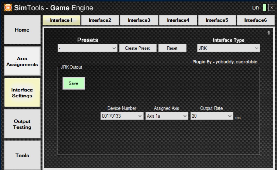

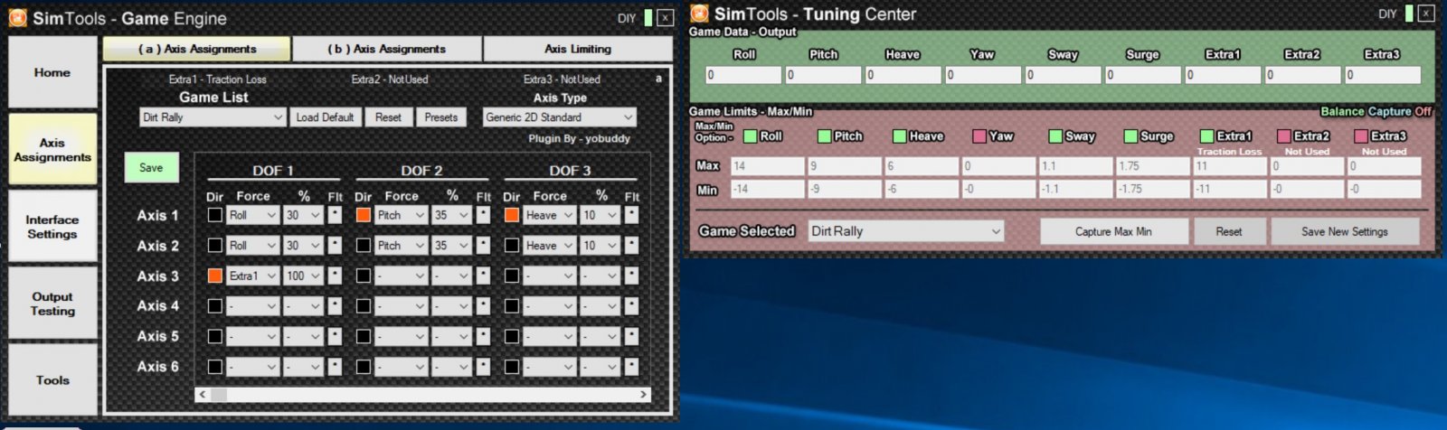

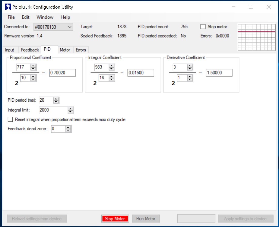

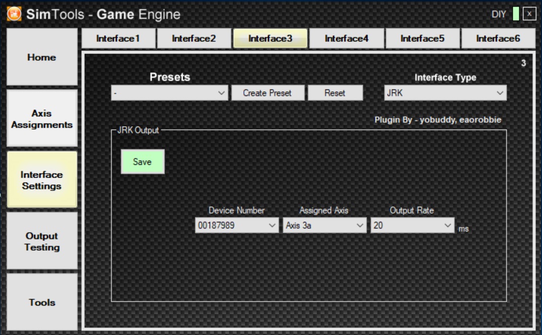

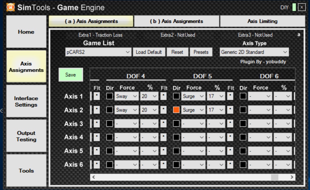

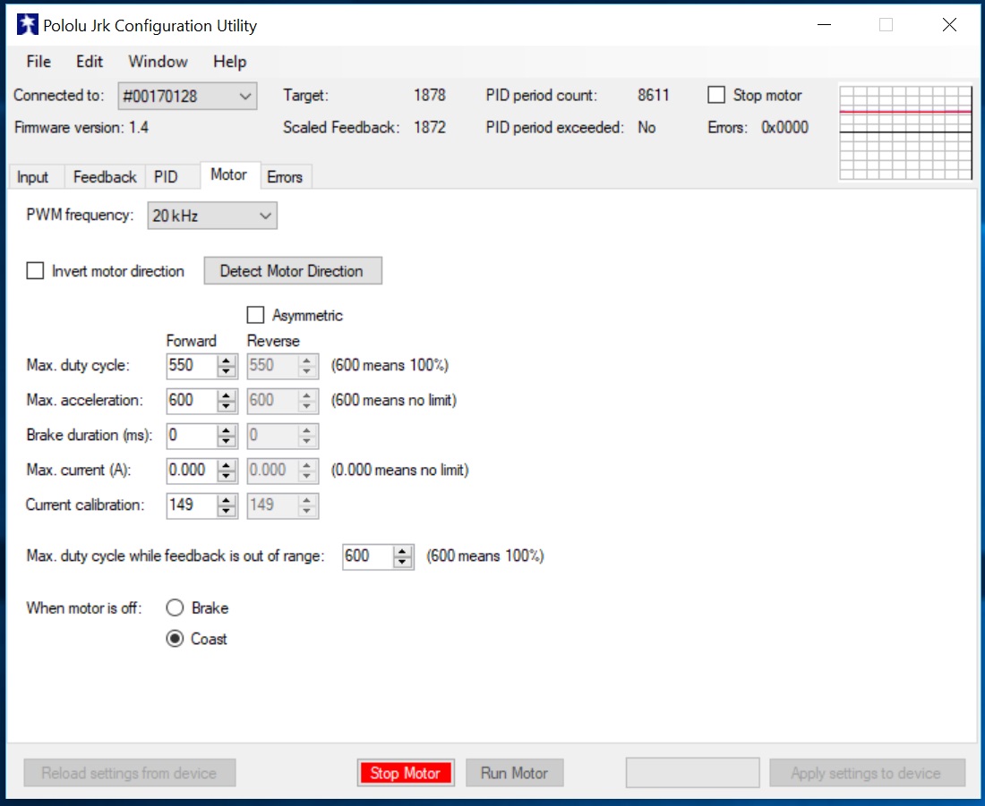

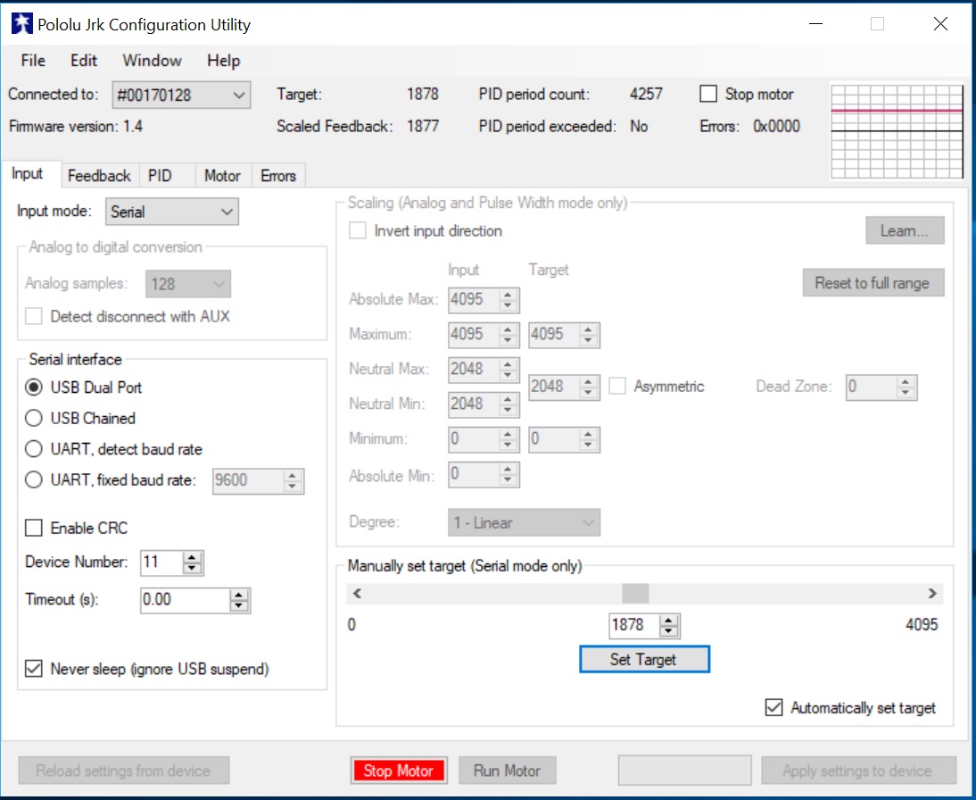

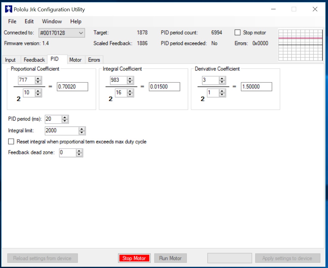

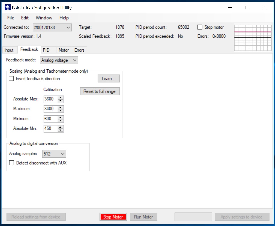

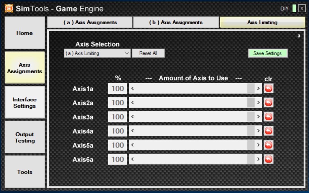

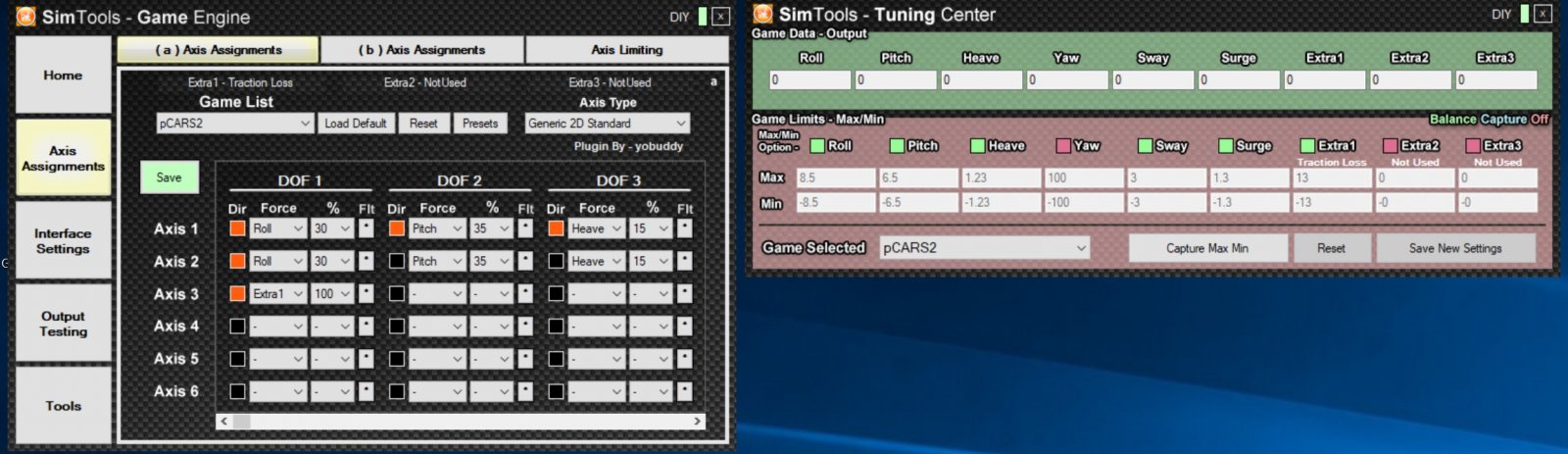

    I need your collective help.
    I have been fighting this problem for a couple months now and am certain it is a configuration issue...
    ONLY in PCars 2 and Dirt Rally (Not in AC EVER) Using the exact same JRK settings (Obviously) I will be driving up or down a steep hill (Pitch) or steep banks (Roll) and my sim will go to the extreme extents, sometimes even opposite of the intended input actually. Until the input event has decreased below what ever value that stops it (I don't know) Anyone ever seen this? I have included screenshots of both Rally and PCars 2 as well as my axis setup and JRK settings.
    Odd thing is it does not happen every single time in the same turns or hills. I assume I am just taking a slightly different line causing this. But why is my machine jumping to extreme limits. It actually hurts as it is a very abrupt input (Running 25:1 PSaw) Kills the experience as well!

    In Dirt Rally currently, I cannot get enough (IMO) pitch because I have to turn "UP" the value in the tuning center just to keep the pitch axis from jerking to its extreme. I currently have it set to "8" in pitch, and it does not have much range of motion but also does not jump tp its extreme. As soon as I turn up the pitch to "9" the jerking almost completely goes away, but I do not have very much pitch movement at all then...
  3. Zed
    Apr 4, 2017
    1,040
    USA
    5,842Coins
    +1,043 / 4 / -0

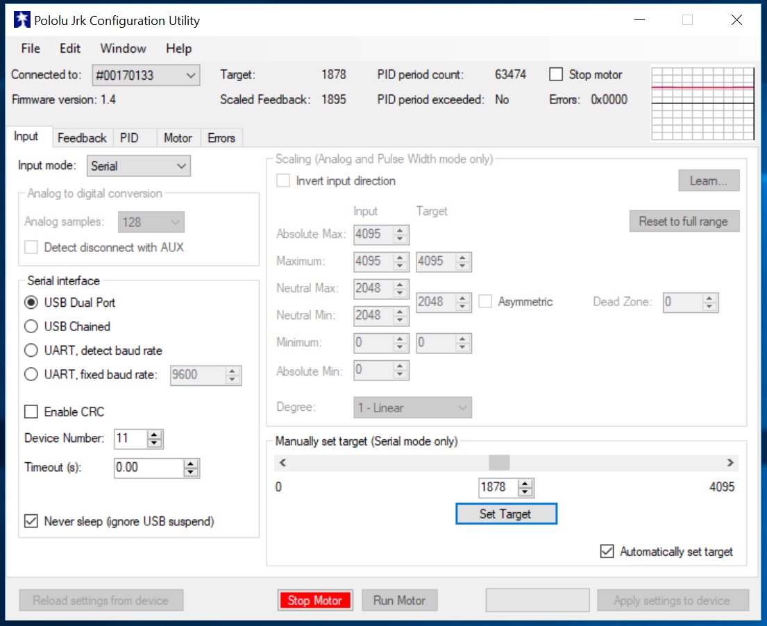

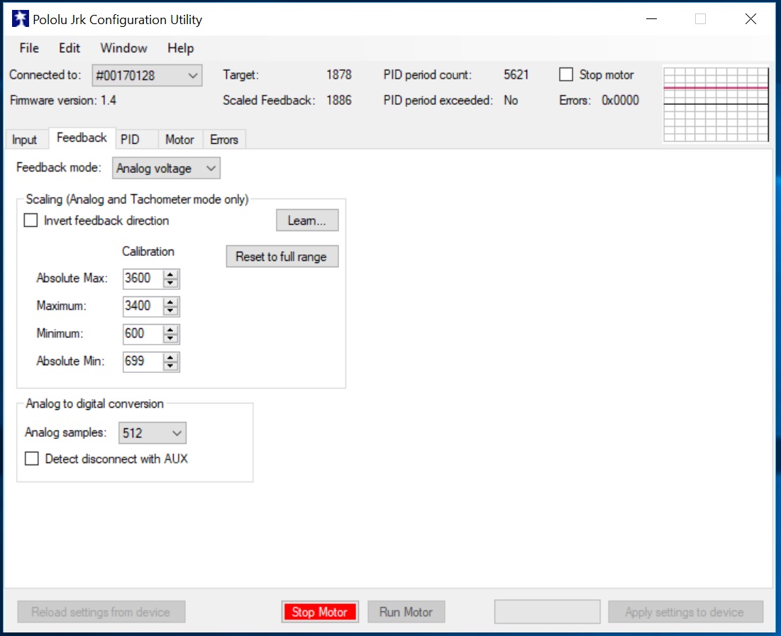

    Hey Brett, one of your motors has an absolute minimum greater than the minimum. Intentional?

    yeah, I have been playing with those settings..... hummm....
    Not saying that isn't it partially, but both motors go to extreme limits as described above...

    So Zed, I think you got it... I went through the JRK setup process from scratch, and all the numbers lined up much better now, Mins and Max Mins are correct. Been driving for about a hour and so far zero issues as before.

    Nope... son of a bitch, still doing it... Im getting tired of this

    Did you reset the JRKs to their default factory setting and then do the setup from scratch?

    so... reset to default no. How do you do that?
    I just reentered and reran my motor centers and such
    21,500
    150,620Coins
    +11,018 / 55 / -2
    The option to reset to default is in the Pololu menu.

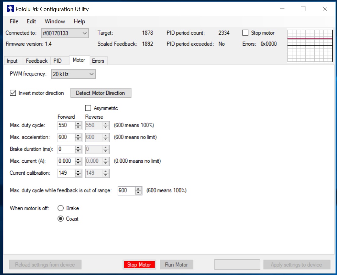

    possibly getting motor errors causing this?

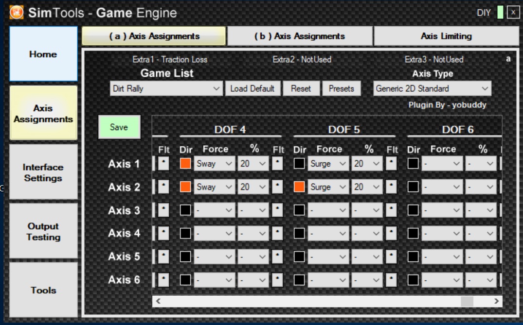

    Hey Brett, not sure but I’ve had a similar issue in PC2. It’s not quite the same but your comment about the 3 seconds makes me mention it. For me it’s sway. I can’t run with sway in PC2 or else I have places in the tracks where my sim kicks over to the side and stays there for about three seconds then straightens up. It’s dead repeatable for me and doesn’t matter how fast I transition where it happens. I’ve inched through and when I hit the point, hard kick. At Indy it’s even on a straight. It also doesn’t seem to happen on every track. If I take sway out of the forces, it doesn’t happen. I don’t have any explanation but it could be I have something not set right. Also, where I had wind at first, it quit working in PC2. No idea if related. But other than no wind, as long as no sway, no problem whatsoever.
    I haven’t added filtering yet. You running with any filtering?
  15. Zed
    Apr 4, 2017
    1,040
    USA
    5,842Coins
    +1,043 / 4 / -0
    Forgot to mention, AC works perfect for me too. Wind, sway, etc. But I also see the sway effect in No Limits 2 but wind works there as well.

    That sounds like it is game generated, perhaps there are a few bugs loose.
