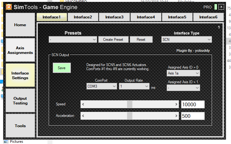

    So I installed the plugin and patched it after removing the old patch. I'm getting a violent roll reversal in rolls, and about 3/4 of the way through a loop. Still no yaw.
    This is in the AV8 with a prosimu T1000 3 DOF

  9. Dirty
    Oct 15, 2017
    746
    All the way up front.
    7,981Coins
    +890 / 3 / -0
    That's the old (conventional) Export.lua! Download v0.03 (first post), unpatch the game and then repatch with the latest plugin.
    Tell me how it went, I'm happy to help anytime and I'm curious to know why things go wrong sometimes :)
    Dirty :)

    Thank you for the reply. So I'm closing Game Manager and Engine after unpatching. Opening Plugin Updater and adding v.03 and it adds sucessfully. Open Game Manager and patch, select directory, and it keeps patching to the old version. I even deleted export.lua completely and it still creates a new one with the old version. What am I missing here?

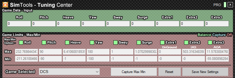

    Ok I manually applied the plugin, by unzipping the .dl file to my plugins directory and putting the export.lua into my saved games/dcs/scripts. It works! In the air, the AV8 feels amazing, much better than the old plugin and I have yaw! I air started for the test, and on landing got some really crazy shaking and yawing, even after stopping completely. Any ideas for fixing that? I'd also like to increase the yaw effect. Export.lua and simtools setting below.
    This will be much better for helicopters and such, it is so much better than the old plugin when in the hover. Thank you again for the effort.

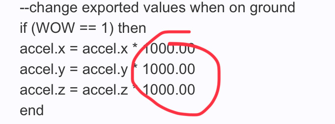

    Ok all sorted! The ground multipliers in the default export were *1000! Dropped them to 1, and it's running perfectly. Seriously guys I can't thank you enough!

  15. Dirty
    Oct 15, 2017
    746
    7,981Coins
    +890 / 3 / -0
    Yes, that was it! I was just about to write this to you when I got your post. :grin:grin
    I did this *1000 factor to check if the OnGround detection worked properly and to see if the gain was applied properly. Guess I didn't remove it before compiling the plugin and it found it's way into v0.03 :blush
    I will correct it before the weekend. As a quick fix you can manually change those values back to "1.0" like @Moe Colontonio did.
