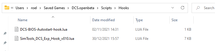

  10. RJ Stausebach
    RJ Stausebach Member Gold Contributor
    Jul 9, 2017
    57
    Ireland
    315Coins
    +13 / 0 / -0
    Many thanks Dirty!

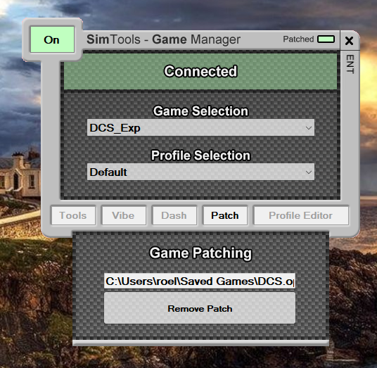

    This is what the Game Manager looks like after I have patched the game (plugin zip file dropped into Plugin Updater, then game patched using Game Manager.
    I only have one version of DCSWorld being the beta.
    These are the files in the Hooks folder:
    This is the successfully patched game screenshot:
    Now, the dcs.log file did NOT have "INFO Starting motion data export. Export script v0.10" in it.
    Much appreciate your having a look!

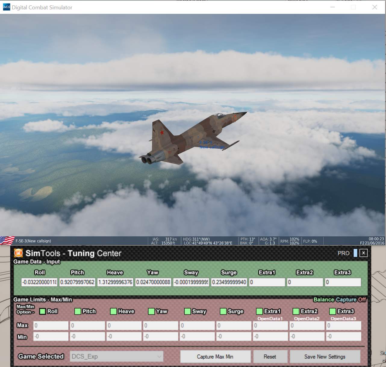

    @Dirty just cleared the log file and ran DCS again. Lo and behold, something happening now..!
    I then also rechecked the log file and found this line:
    "2021-12-30 20:22:01.041 INFO SimTools: Starting motion data export. Export script v0.10"
    I still cannot see the proper descriptions or data for Extra 1,2,and 3 and the logo still does not appear, so there may yet be something amiss. Progress however!

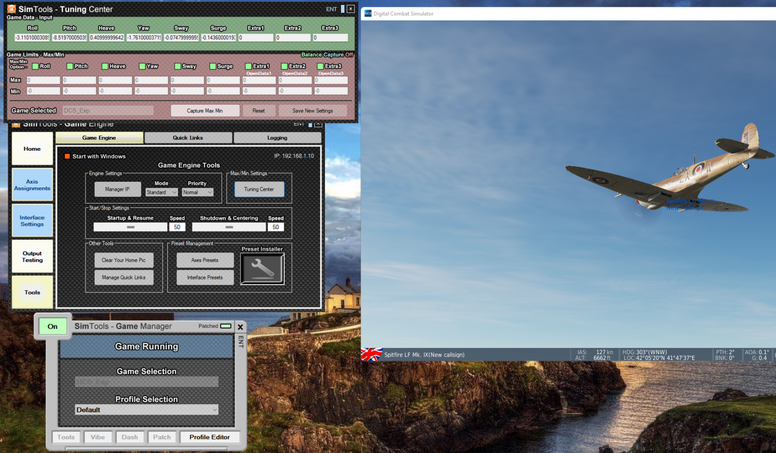

  12. RJ Stausebach
    Jul 9, 2017
    57
    Ireland
    315Coins
    +13 / 0 / -0
    Also very happy to report that the basic data seems to be coming through for the Spitfire too!

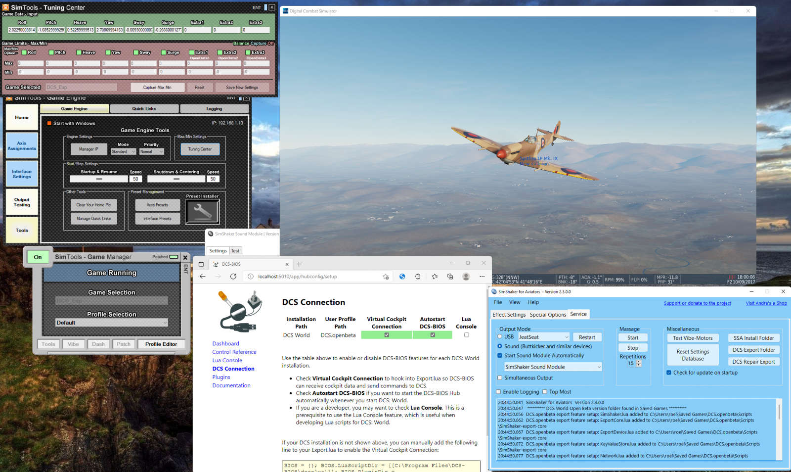

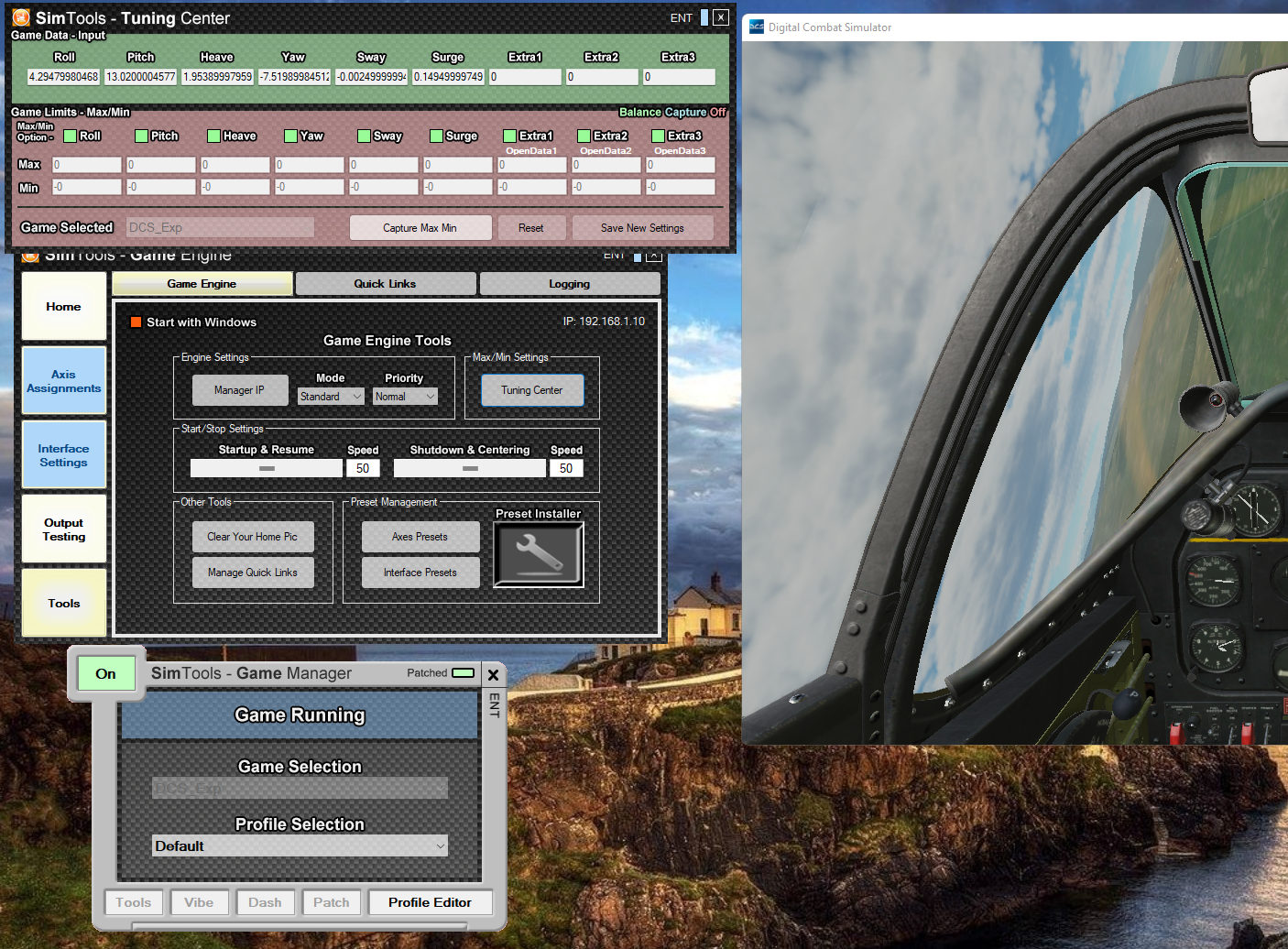

  13. RJ Stausebach
    Jul 9, 2017
    57
    Ireland
    315Coins
    +13 / 0 / -0

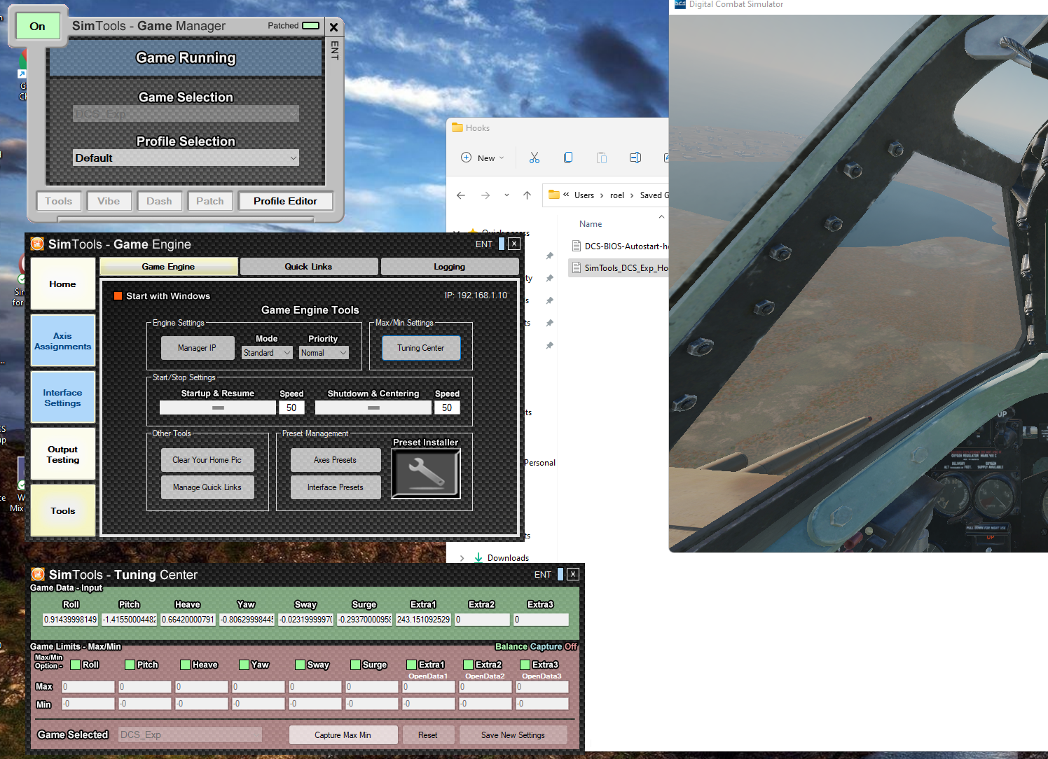

    Here's another interesting one I thought I could share; here we have SimTools, the DCS Spitfire, DCS Bios and Simshaker all running with data still coming through to the Simtools tuning center.
    But not for the extras...?
    ( I am particularly interested in IAS and RPM on the Spitfire, if I can get them running I can get rid of DCS Bios as I only use it for speed force feedback on the stick and rudders now and would like to run wind on a combination of IAS and RPM or just RPM.)

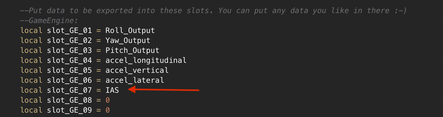

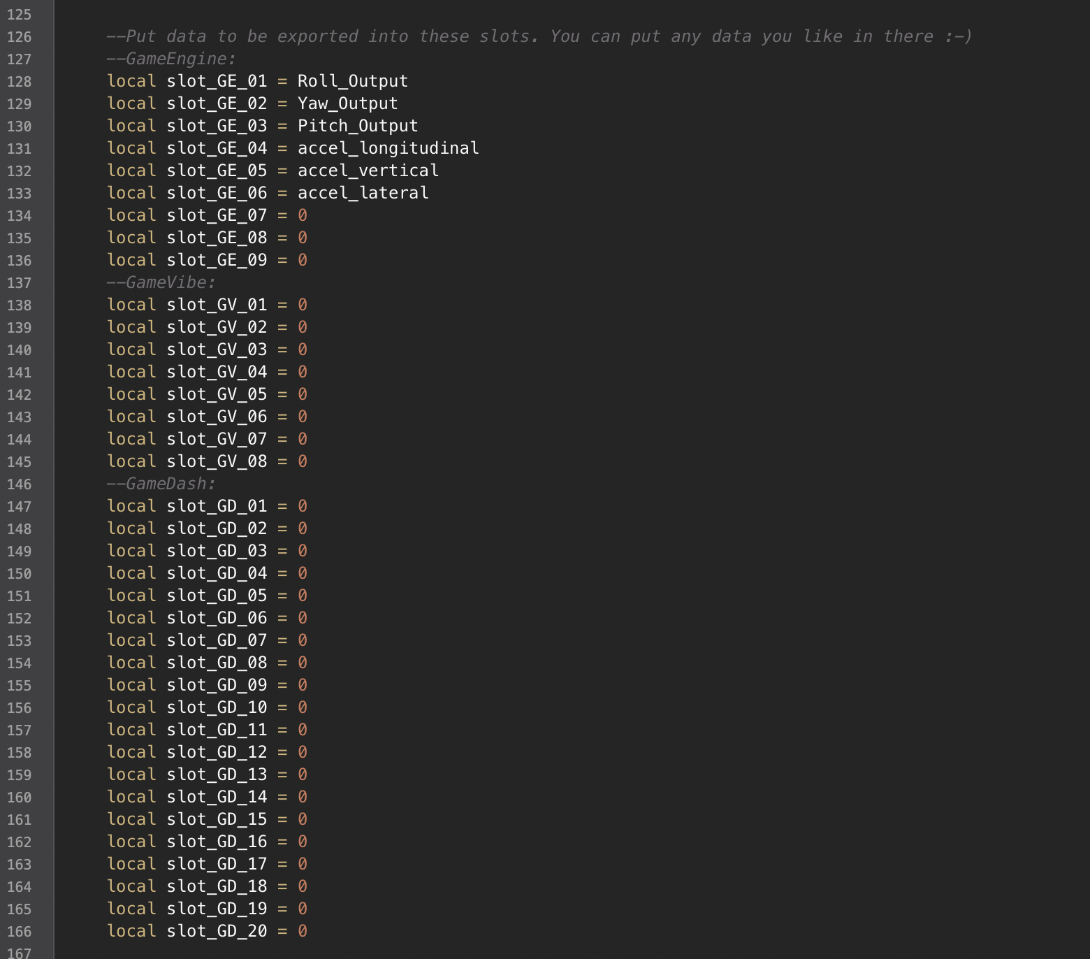

    IIRC, having no data in the Extra 1-3 slots (slot_GE_07 ...08 ...09) is normal. By default, only the six "main" slots are filled. Check the export script to see details here:

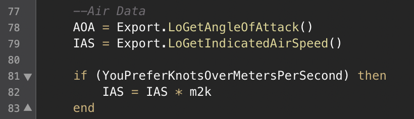

    You can fill the other slots with any data you like. If you like IAS, you can see that the variable "IAS" is assigned a value in this section of the export script:
    All you have to do is put that variable in one of the slots like so:
    RPM is available for export somewhere as well,... I think it is aircraft specific data, so you will have to know the argument number to ask for if you want RPM returned.
    I think it was @MarkusB or @Zed who wrote a function for "Windiness" and I think it contained the aircraft RPM. Maybe one of them can post here how to get RPM.

    +890 / 3 / -0
    Sorry, my mistake :)
    Try "local RPM = Export.LoGetAircraftDrawArgumentValue(37)". You need this "Export" prefix, because the script calls that function from outside the Export.lua.
