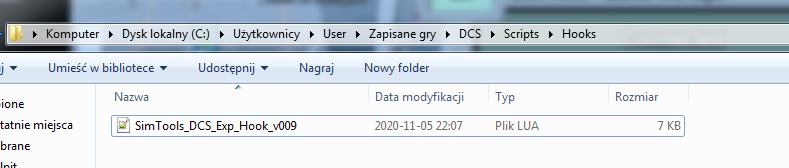

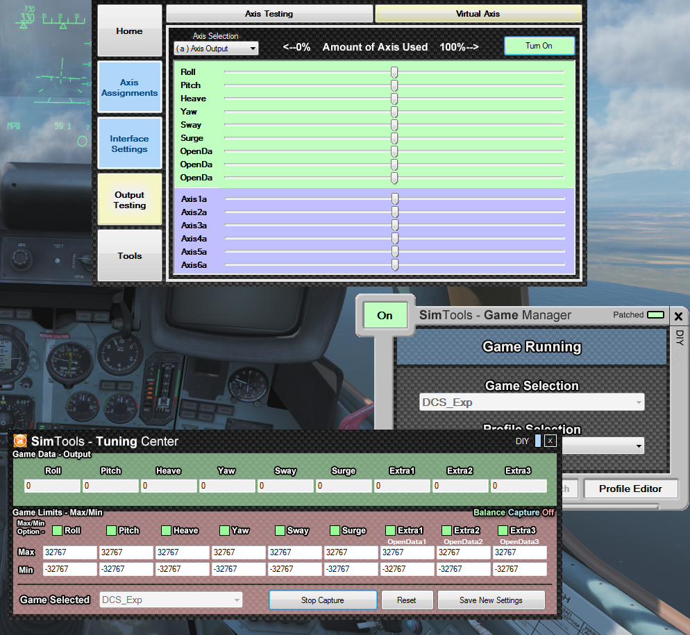

  6. tadeusz
    tadeusz New Member
    Nov 4, 2025
    14
    94Coins
    Hi
    I have a problem with the plug-in
    I have constant values all the time
    best regards
  7. Dirty
    Oct 15, 2017
    746
    All the way up front.
    7,981Coins
    +890 / 3 / -0
    Just for troubleshooting, go to "SavedGames/DCS/Scripts/Hooks" and check if you have the "DCS_Exp_Hook...." file in this folder.
    Then go to "SavedGames/DCS/Scripts" and see if there is an "Export.lua" file in there. If there is, try without that file and see if it does the trick.
    Then report back here with your findings ASAP :-D

  9. tadeusz
    tadeusz New Member
    Nov 4, 2025
    14
    94Coins
    Hi
    Still not working
    1.I delete "Export.lua" file in "SavedGames/DCS/Scripts"
    2."SavedGames/DCS/Scripts/Hooks" is empty
    best regards
    best regards

  11. tadeusz
    tadeusz New Member
    Nov 4, 2025
    14
    94Coins
    Hi
    I tries, with everything and nothing...
    I have a problem that I am using Sim Tools 2.0?
    Which version of Export.lua should I use for the DCS_GamePlugin.2.0.0.0 version?
    Best regards

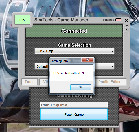

  13. tadeusz
    tadeusz New Member
    Nov 4, 2025
    14
    94Coins
    I use for the DCS_GamePlugin.2.0.0.0 version, but after patched show v 0.09?
    Is it alright?
    Best regards
  14. Dirty
    Oct 15, 2017
    746
    7,981Coins
    +890 / 3 / -0
    I don't know, whether or not the version of SimTools makes a difference. I think SimTools is on version 2.4 but not sure. If you want to be sure, just install the latest.
    There are two plugins! If you are using mine, then in Game Manager you should see "DCS_Exp" and it looks like that's what you have :)
    There is the original Plugin, and that is on version 2.0.0.0 afaik.
    I have made a modified plugin and that is on version v0.9.
    So, the question is: Why don't you get any data?
    I have a suspicion! Could it be, that you have two versions if DCS installed? Openbeta and stable branch?
    Make sure that the version you are using has the Hooks folder with the Export-script.
    To check, go to "SavedGames" and check if there are two DCS folders: DCS and DCSopenbeta.
    Is that the case?
  15. tadeusz
    tadeusz New Member
    Nov 4, 2025
    14
    94Coins
    I have original Plugin, DCS_GamePlugin.2.0.0.0
    but after instalation it show like on photo V 0.09
    is it right?
    maybe I should delete the temporary files in some folder related to the older plagin?
    best regards
  16. Dirty
    Oct 15, 2017
    746
    7,981Coins
    +890 / 3 / -0
    I guess you have two versions of DCS installed and/or you have not unpatched DCS through the other plugin.
    No worries, I am 100% sure we will figure this out.
    I will send you a PM.
