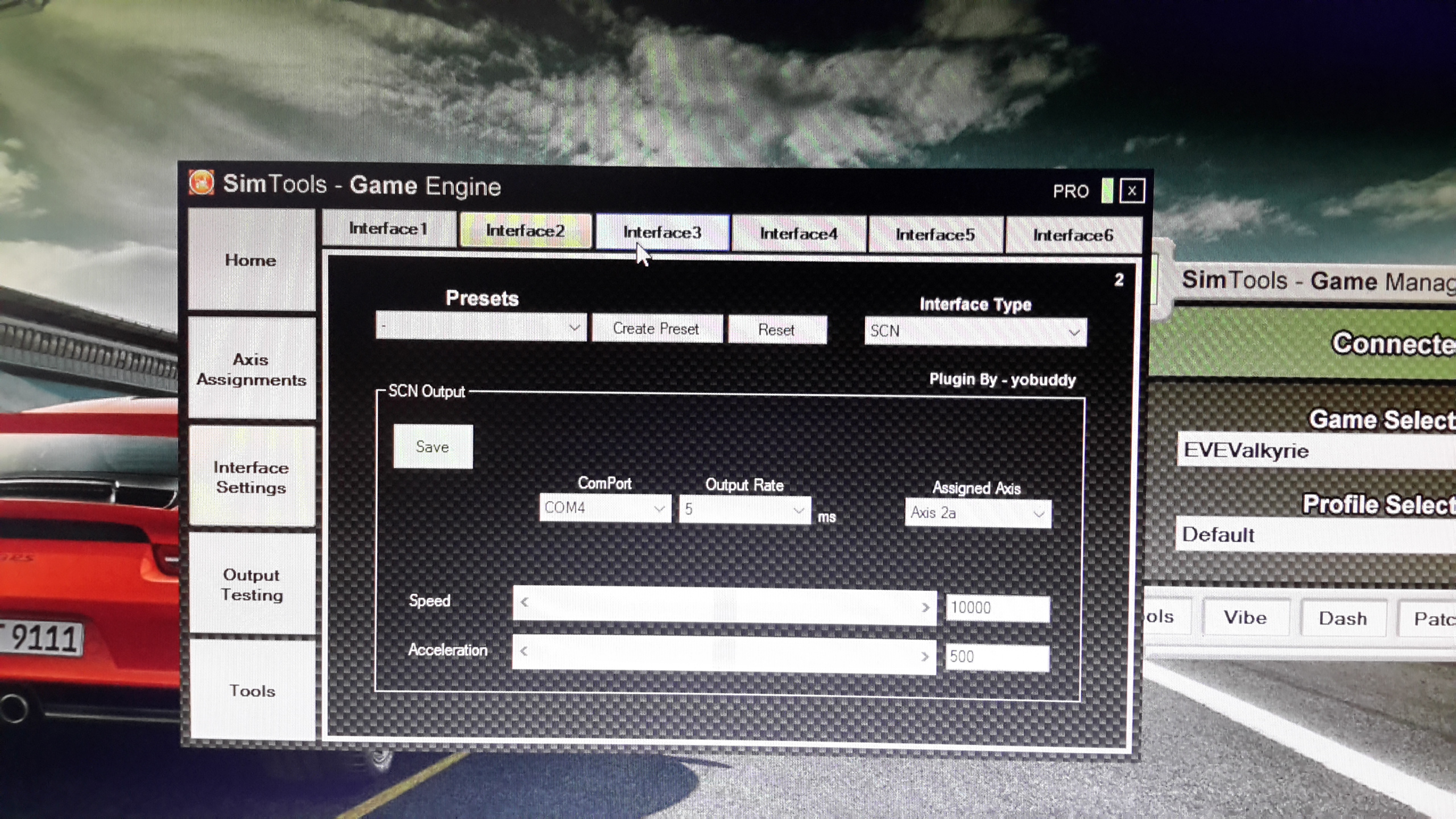

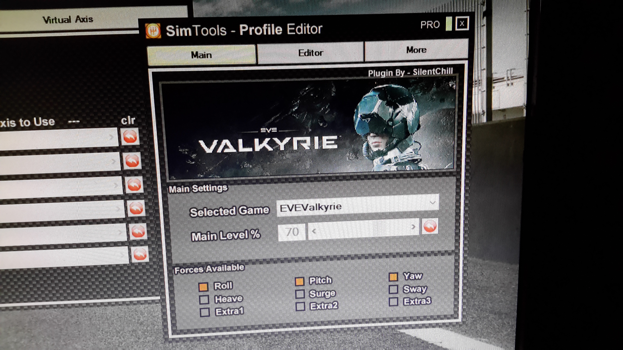

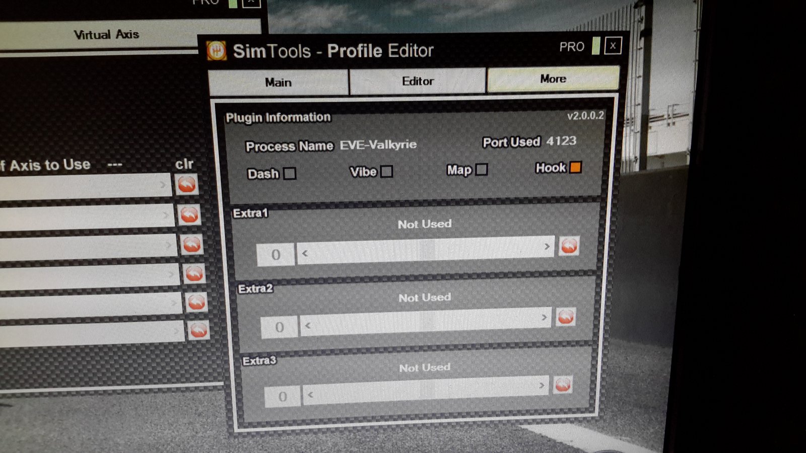

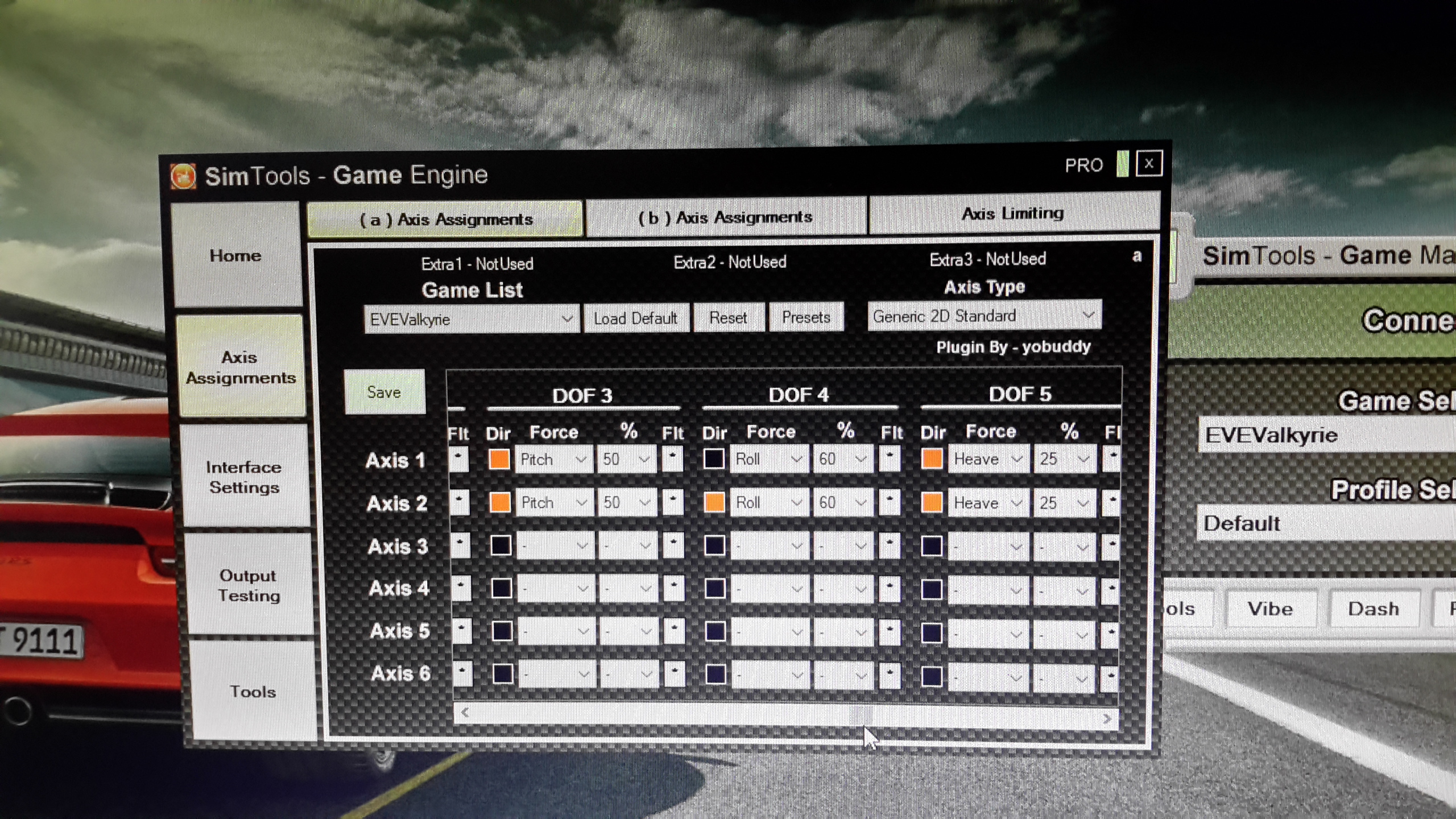

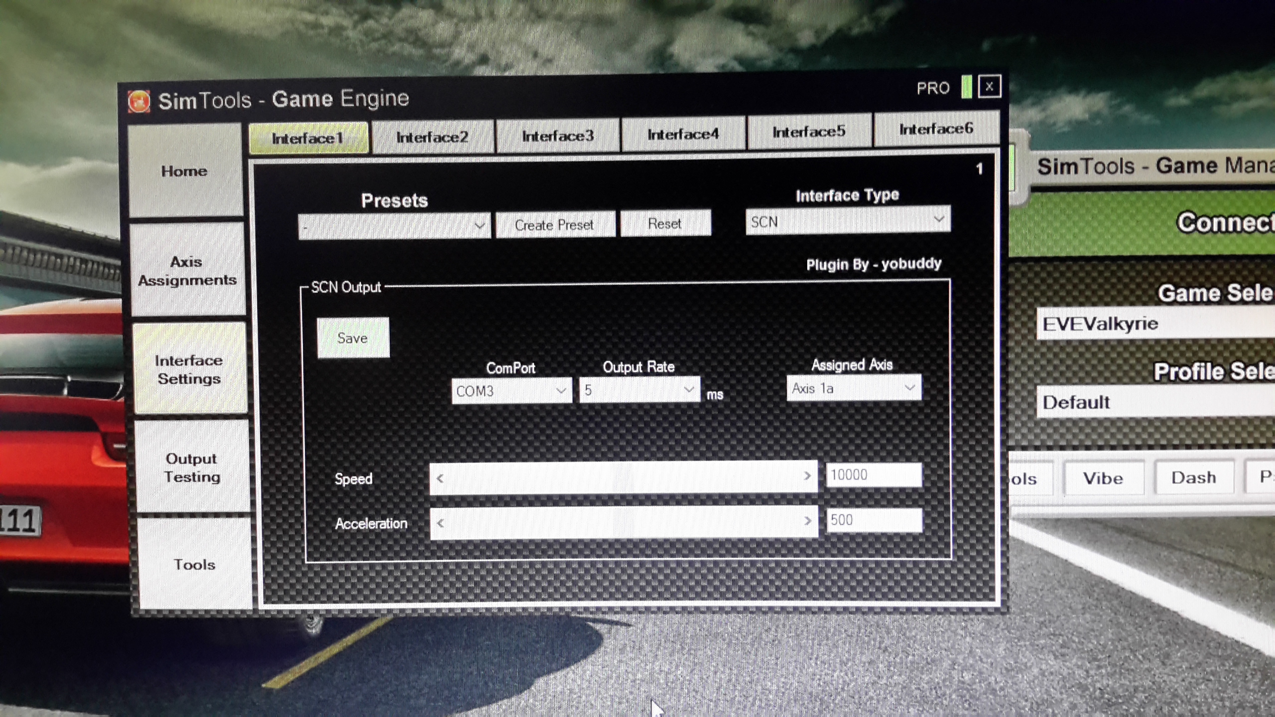

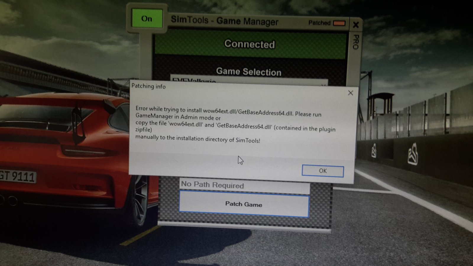

    Unfortunately I'm having the same issue. Eve version 116..... Oculus home edition. Installed plugin through pluginupdater, run game manager as admin, patched successfully, banner turns blue when game is running, no movement. Rig works with all other games through simtools.
    21,582
    151,106Coins
    Can you please post pictures of all of your settings and verify if data shows in the top of the Tuning Center.

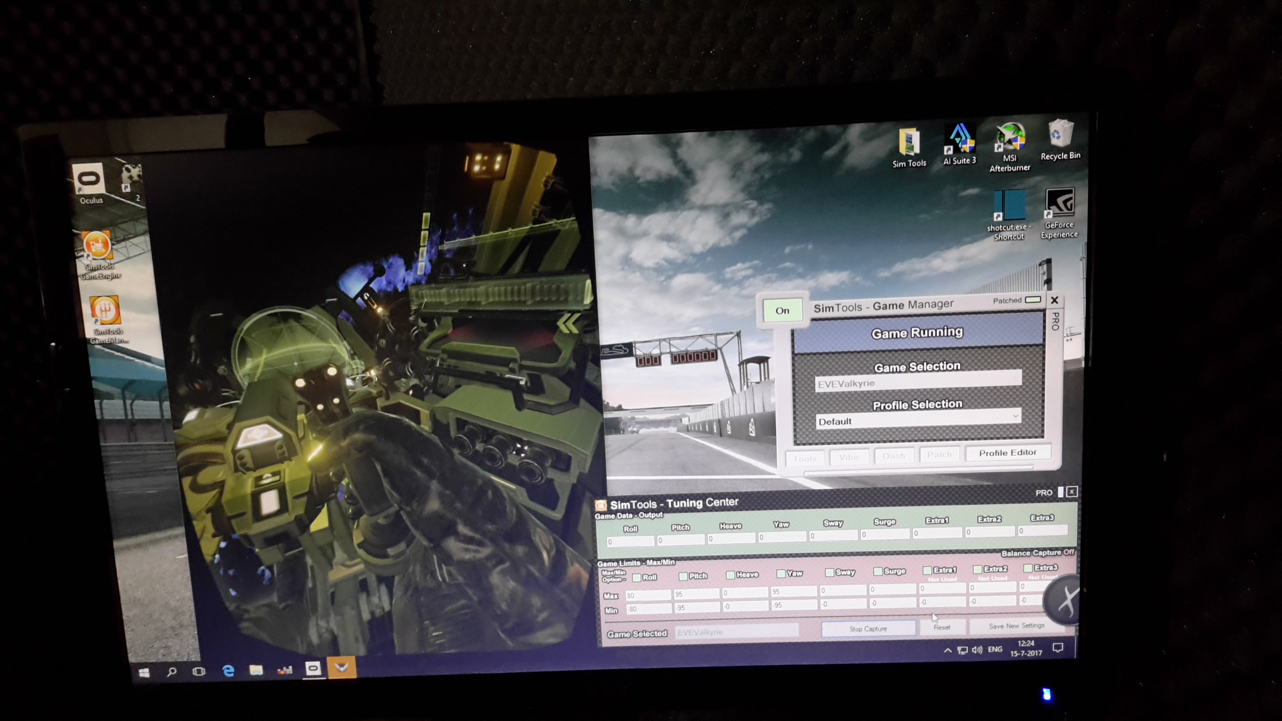

    Hi Noorbeast, thank you for the quick reply, there's no data in the tuning center. 20170715_122705.jpg 20170715_122707.jpg
  16. noorbeast
    21,582
    151,106Coins
    Try unpatching, run Game Manager as the normal user and patch again.
    Was EV run fir before patching?

    I unpatched, run game manager normal, patched again. Get error (attached picture). I follow the instructions in the error. Gamemanger reacts normal after because it detects the game (from green to blue, back to green after exiting game).
    I als tried: remove patch, delete plugin, delete Eve Valkyrie, restart computer, install Eve Valkyrie, start game, fly for a while, stop game, install plugin, patch game through normal user, follow error instructions, game mangers successfully detects game, still no motion, tuning center: all zero's
    P.s. I just bought Eve Valkyrie today, because they released a big update 13 July..
  18. noorbeast
    21,582
    151,106Coins
    So have you tried manually copying the file @Tummie555?

    Yes I followed the instructions in the error: I copied both the files manually into the simtools installation directory: C:/program files (x86)/simtools
    (The copying works fine, but the problem isn't solved)

    If they updated the game I will need to update the plugin, its not on my radar as I never play it. I will try and have a look
