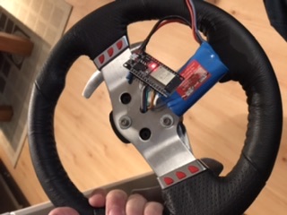

    On my hoverboard wheel I have been trying to make the wheel wireless using an esp32. I now have it working, but something makes it disconnect and connect again every thirty seconds or so. Does anybody else have this problem?
    I’m thinking it could be the receiver, but I’m not sure.

    Ok, so it turns out it was my Bluetooth USB dongle that was causing problems. Bought an Asus usb-bt500 and now it works like a charm!

    My code was built on the same repo this guy built on, but he added encoder support:
    https://github.com/manoukianv/SteeringWheelBluetooth
    I have no idea how to make rev lights. If I would try to do it, I'd look if I could find some arduino solution that could do it today, and try to figure out how to paste it into the code above..

    I managed to make a button box with up till 19 buttons with the Wemos Lolin32 lite. And this works well.
    I now tried to make one with 3 rotary encoders but this isn't working proparly.
    So let's say button 15 and 16 are on one encoder and they both flash if I turn the encoder clockwise and also if I turn the encoder counter clockwise.
    I see the guy from https://github.com/manoukianv/SteeringWheelBluetooth has rotary encoders working but I can find his sketch.
    So I ended up modifying the "SingleButton" example.
    Does anybody have the right sketch from manoukianv or a suggestion how to connect or program the correct way for the rotary encoders?
    Here is my sketch::blush

    That sketch looks much better indeed, but I'm missing some voodoo.
    I get an error message trying to upload this sketch to my lolin32 lite.
    Do I need to install some libraries first?

    Are you using platformIO? Did you download the whole code?
    From what I can see by a glance, these are the includes;
    Code:
    #include <Arduino.h>
    #include <BleGamepad.h>
    #include "button.h"
    #include "battery.h"
    #include "encoder.h"

    It has been a long time since I tried all this. I made my code in ArduinoIDE and lost touch with PlatformIO.
    You need to install Visual Studio CODE and PlatformIO, then download the github repo and run it in PlatformIO. As I recall it was quite self explanatory when it all was installed.

    I manged to get this working thanks for your help, but the encoders are chnaging the X and Y axis. Do you have any idea how to change this to buttons?
    Also there are only 14 buttons I would like to have 21 (including 3 encoders). I wasn't able to change this either.
    I also am a bit more familair with ArduinoIDE, do you maybe have a skecth with Buttons en Encoders?

    Sounds strange with the x y axes.
    I haven’t used this code myself, I only needed buttons.
    Nope, no code other than buttons.
