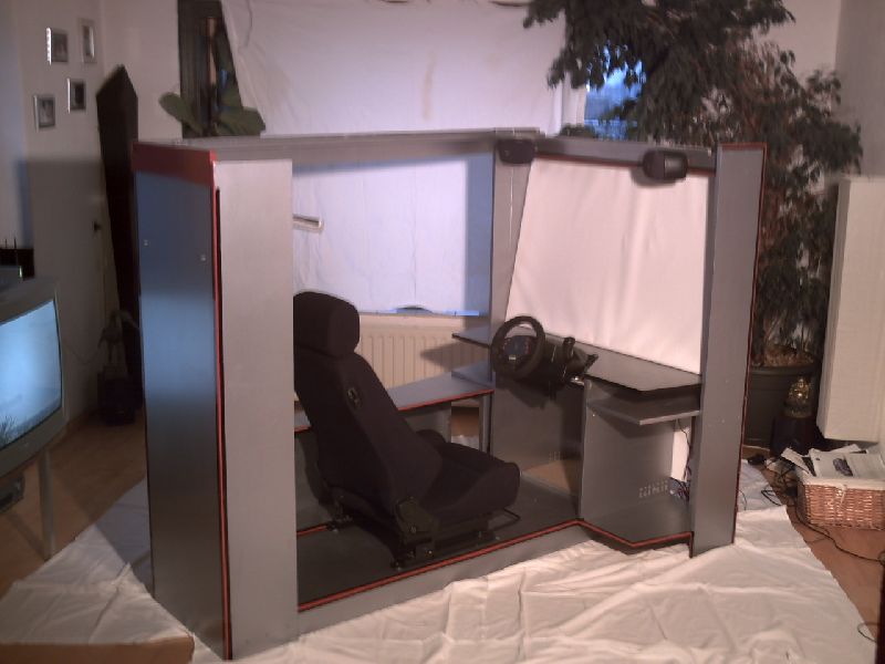

    Hi Wannabeaflyer

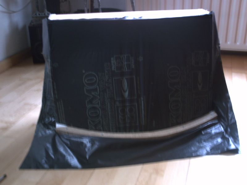

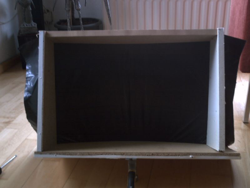

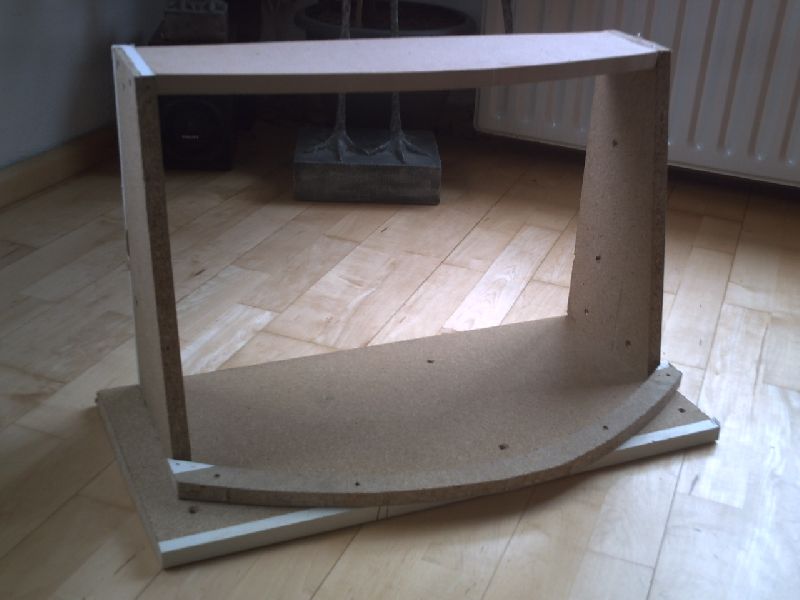

    J-DOME is the site from the spanjard ,he patented it a year ago
    My windscreen i made it this way
    Take a pice of MDF from 115x75 cm(pice 1) its gone stand right up
    second pice Mdf 115x50 cm(pice 2) ,this pice is gone be placed horizontal (perfect to fit your steer up)
    These 2 MDF plates are fitted in a 90 degrade angle.
    But before that you need a second 115x50 pice(pice 3), This pice is to fit your screen to your wishes
    When your sitting in youre car, you see a line between the dash and windscreen.
    This line must be sawed out, and this pice will later clamp the screen in your sawed form,when fitted
    plat up they other 115x50 pice
    The upstanding MDF plate(pice 1) :You do the same as above, saw it out in form from roof and door style (ROD)Its gonne be youre standing window frame like in youre car.
    Now comes Mdf 115x73,2cm (pice 4)and is gone do the same as pice 3,But saw it a fuw cm out bigger than pice 1 , it's also gonna clamp the screen ,only a little bit futher and looking tru pice 1 ,it's gives the illusion youre realy looking outside
    Now fit pice 1 and 2 together in a 90 degrade angle ,make the angle stif with some wood on the sides
    from the pices.
    Now put pice 3 up to pice 1 with screen between them ,and screw it only in the middle
    Now put pice 4 up to pice 1 thension the screen and screw it in the middle.
    This way you clamping the hole screen ,from center to outsides.
    So i made my windscreen
    regards Ad

    Pice 3 must go up pice 2

    hi i hope this made it clear

    hi i tried it bigger in my simulator
    JDome way, but my short trow projector gives to much distorsion
    regards Ad

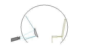

    I'm psyched: I've managed to get my last actuator up and running. I had to take it apart and look up the datasheet on the encoder, at which point I realized that the servo drive unit was using the wrong parameters for this motor. The motor also didn't have its thermal switch hooked up to the designated pins, which resulted in a continuous Motor Overtemp error.
    I think that was the last major hurdle, though there are still an ungodly number of of minor hurdles remaining.
    I also tested my new dome projection scheme. I had to relocate the projector outside of the dome to get the proper focal length. I should end up with about a 60 1400x1050 dome-shaped screen. If you are willing to give up legroom, it could probably grow to 72+.
    here is a sketch of the dome projection system (in reality, it projects higher on the dome than my beautiful illustration shows):

    Have to ask ? what type of Mirror or reflective surface is the convex element of your setup? Cheers.

    It is an 18 Indoor/Outdoor Acrylic Mirror (used for parking, security, etc).
    http://cgi.ebay.com/ws/eBayISAPI.dl...753303&ssPageName=STRK:MEWNX:IT#ht_500wt_1022
    The size of the mirror is dependent on your projector. I have a Dell 2400MP (1024x768) that focuses just fine on an 8.5 mirror (truck rear-view convex mirror). The larger Dell 5100MP (1400x1050) requires more distance to focus, hence requires a much larger mirror and more space. But I wanted the additional resolution, so I am ok with it.
    The smaller projector and smaller mirror could fit completely inside the dome, but those projectors are loud and create noise, so I am happy to eject it :)
