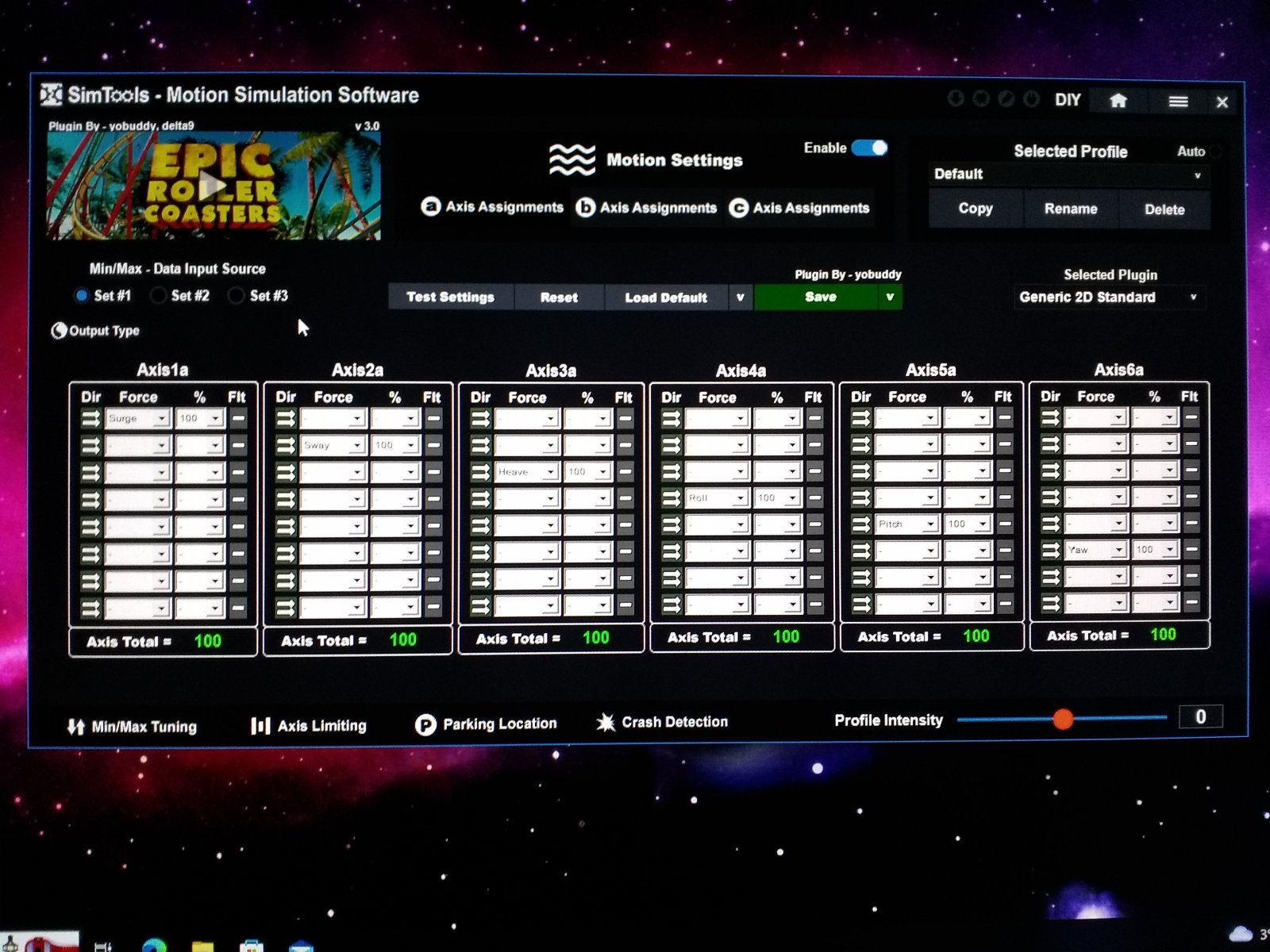

    What do you max/min settings look like for the game - Max/Min Tuning page?
    And what do your axis assignment settings look like for the game?
    I way see something if you post a pic of each.
    Take care!

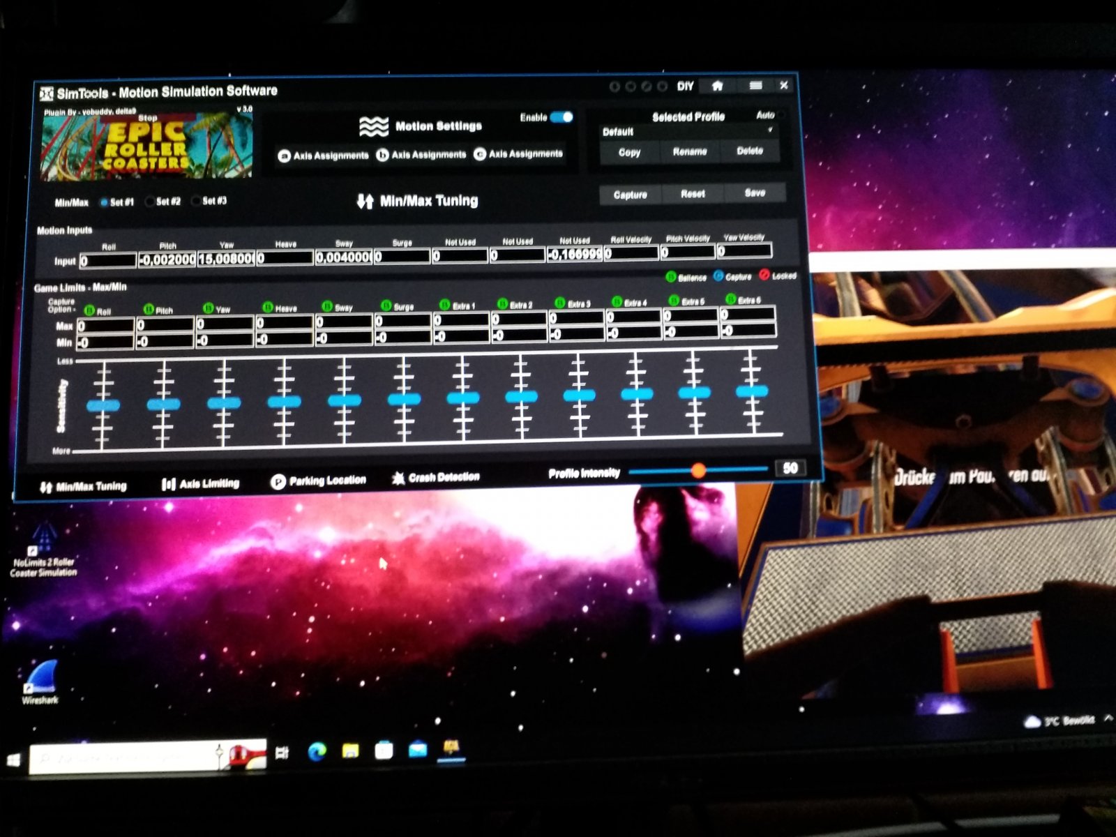

  6. Rainer Arbinger
    Rainer Arbinger New Member Gold Contributor
    Feb 22, 2020
    17
    101Coins
    @yobuddy
    Hi yobuddy!
    I hope the pictures I took are the pics you wanted.
    The second pic was taken while running Epic Roller Coasters.
    Thanks so much for your efforts!
    Best regards
    Rainer.
  7. yobuddy
    5,433
    51,016Coins
    +5,181 / 19 / -0
    Cool, looks like its working! (there is just no max/min settings for the game is all.)
    What you need to do is start the game and once the ride starts, in the tuning center, click capture and then restart.
    Let it find some max limits and near the end of the ride, click save.
    You will then get output data.
    Take care!
  8. Rainer Arbinger
    Feb 22, 2020
    17
    101Coins
    Cool!
    After capturing the max/min data everything works.
    Many thanks for your great work
    and patient help
    Rainer.

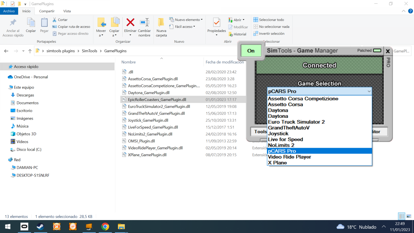

    hello. I was trying to install the epic roller coaster plugin. but I had a problem that I want to share and it is the following: once I install the plugin, it does not appear in the Game Manager list. It didn't happen to me with the previous Epic plugin. I clarify that I have the firewall disabled. Attachment screenshot.
    Thanks in advance for any possible solution or guidance.

    As I understand it the plugin is for SimTools v3 beta, and is not compatible with SimTools v2.
  17. Rainer Arbinger
    Feb 22, 2020
    17
    101Coins
    Yes! This plugin is for SimTools v3!
    I tested it with v3 and for me it works perfectly.
