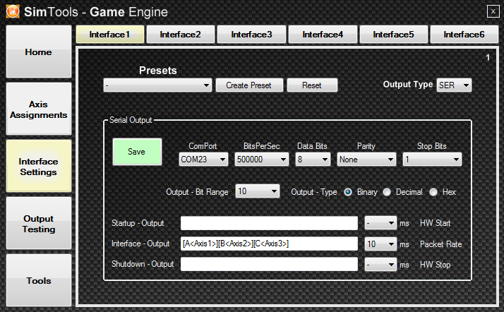

    So i finished all wiring and got a basic SMC3utils setup for the motors. I tested with some different CTC settings, i think a CTC of 50 is good enough. As you can see in the video's i did some motion testing in SMC3utils to give you some idea of the speed and movement.

    And a video of the SMC3utils window, you can see the settings i used.
    Kp = 400
    Ki = 0
    kd = 0
    PWMmin = 0
    PWMmax = 200
    PWMrev = 0
    Max Limits = 145
    Clip Input = 165
    If i set PWMmin higher than 20 i get noise from the motor. A higher Kp setting doesn't seem to influence the speed that much so i guess 400 is a safe value. The seat holds its position fine even after days off, so i guess these settings are fine :)

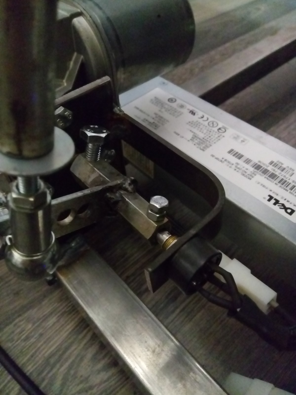

    I solved the squeek; the problem was that i tighten down the shaft of the hall pot. So when you loosen and tighten another part of the axle (or by just a lot of movement) you (can) put axial force on the potentiometer shaft. So when i removed the pot i found it to be seizing up :eek:. I was able to free the shaft and hoping not to destroyed the pot but i was lucky :cool:. I solved it by giving the pot shaft some free play and made a locking nut on the bolt. Now the shaft is able to slide in and out of the lever mount but without any radial play.:thumbs

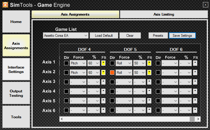

    Thanks, i am experimenting with simtools right now. ;) But i have a question to the experienced users over here; which DOF do you assign to a shoulder mount seat mover? is it only roll and pitch? as these are the only physical movements you have. For testing i have this;
    Works fine, but i don`t know if i need to include other forces o_O

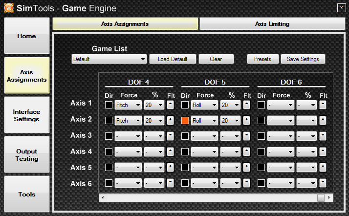

    @noorbeast Thanks, i found that item just yet :thumbs also the information on this link; http://www.xsimulator.net/co-ordinate-system/ was very helpfull in testing the simulator. My settings are as follow now:

    You start at 20% @EntonoX and tune from there, normally you will allocate more % to sway and less to heave. Try not to go too much past 100% total for the sum of all allocations.
    You have enough coins now.

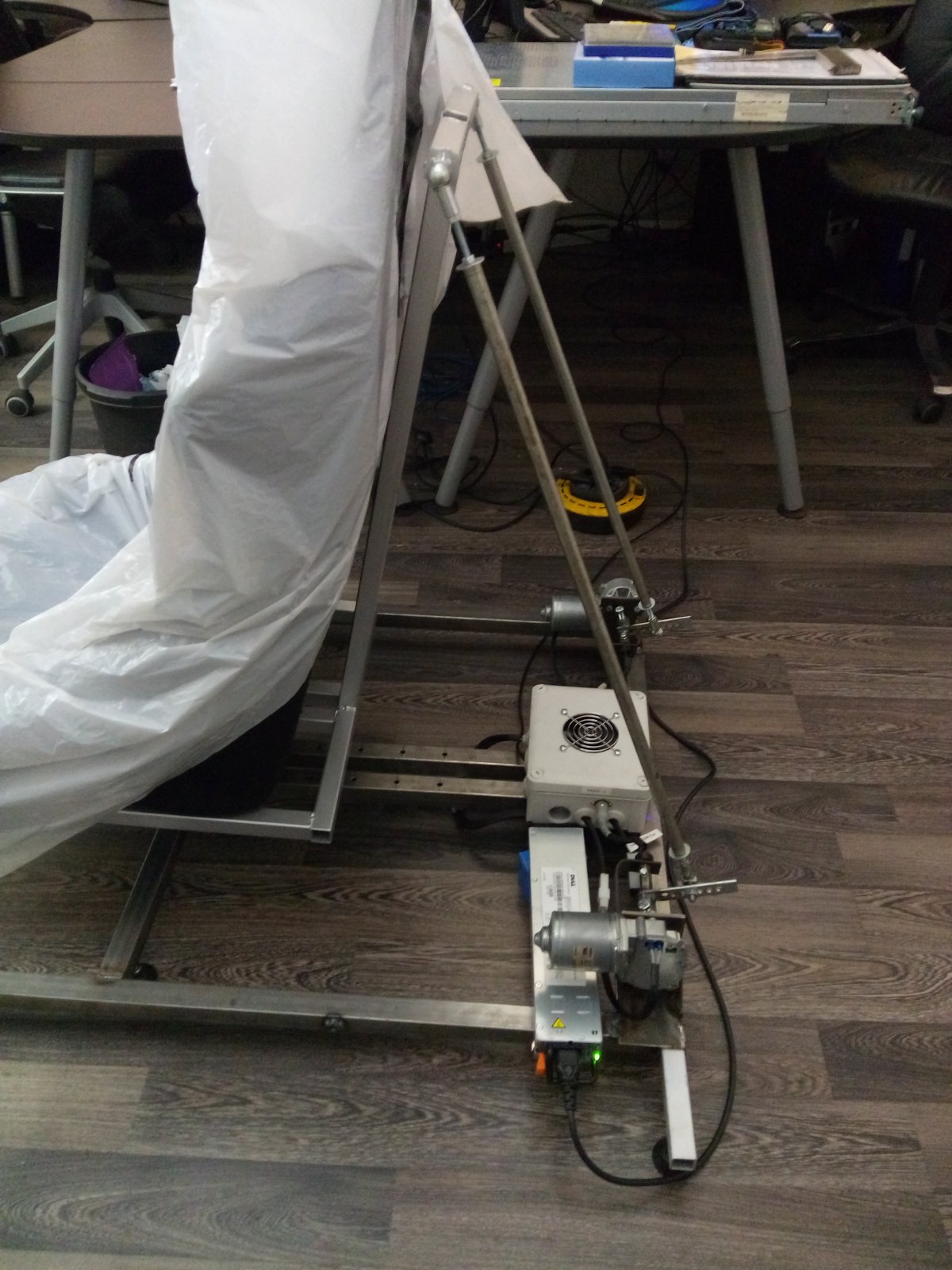

    Nice Progress, But.....Errr....why has no one pointed out the Very much poorly optimized angles on those rear arms.
    EntonoX, Sorry I didn't see your thread earlier, but Imo those wiper's are going to struggle Big time with those angles.
    Move your seat forward more As i see you have some adjust ability there, Get some Angle on those arms, Your motor's will thank you later.

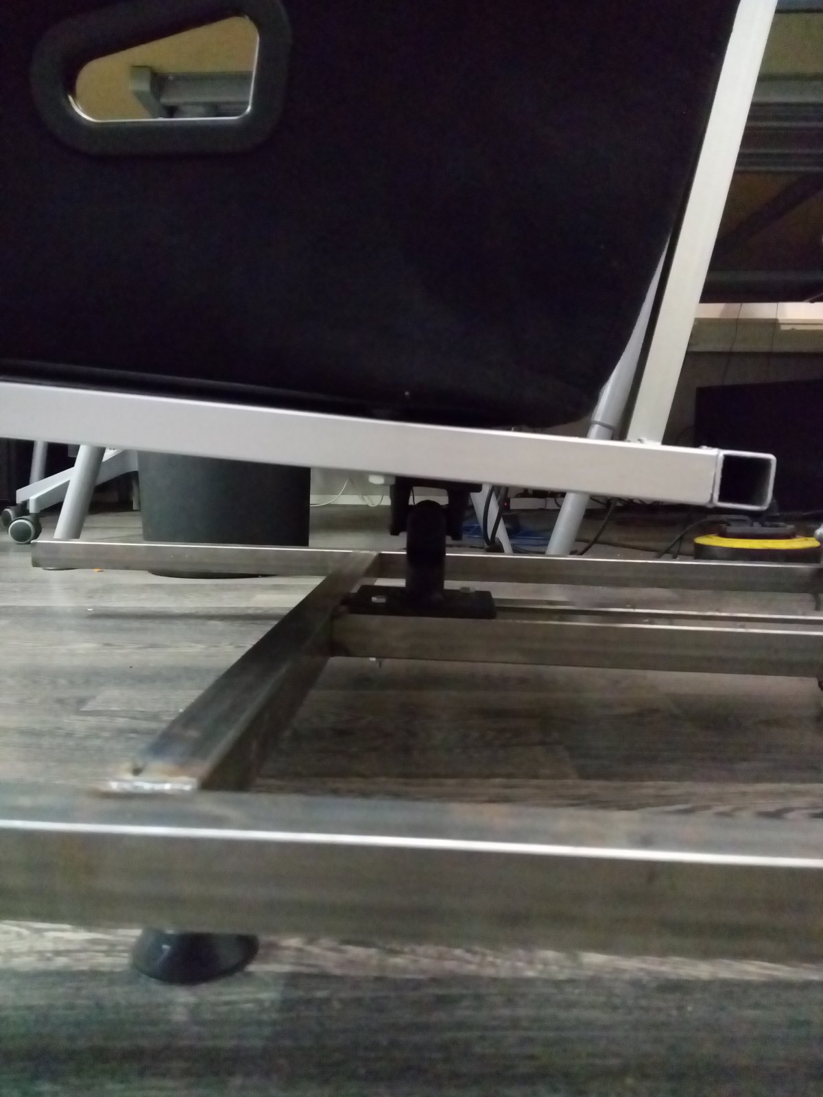

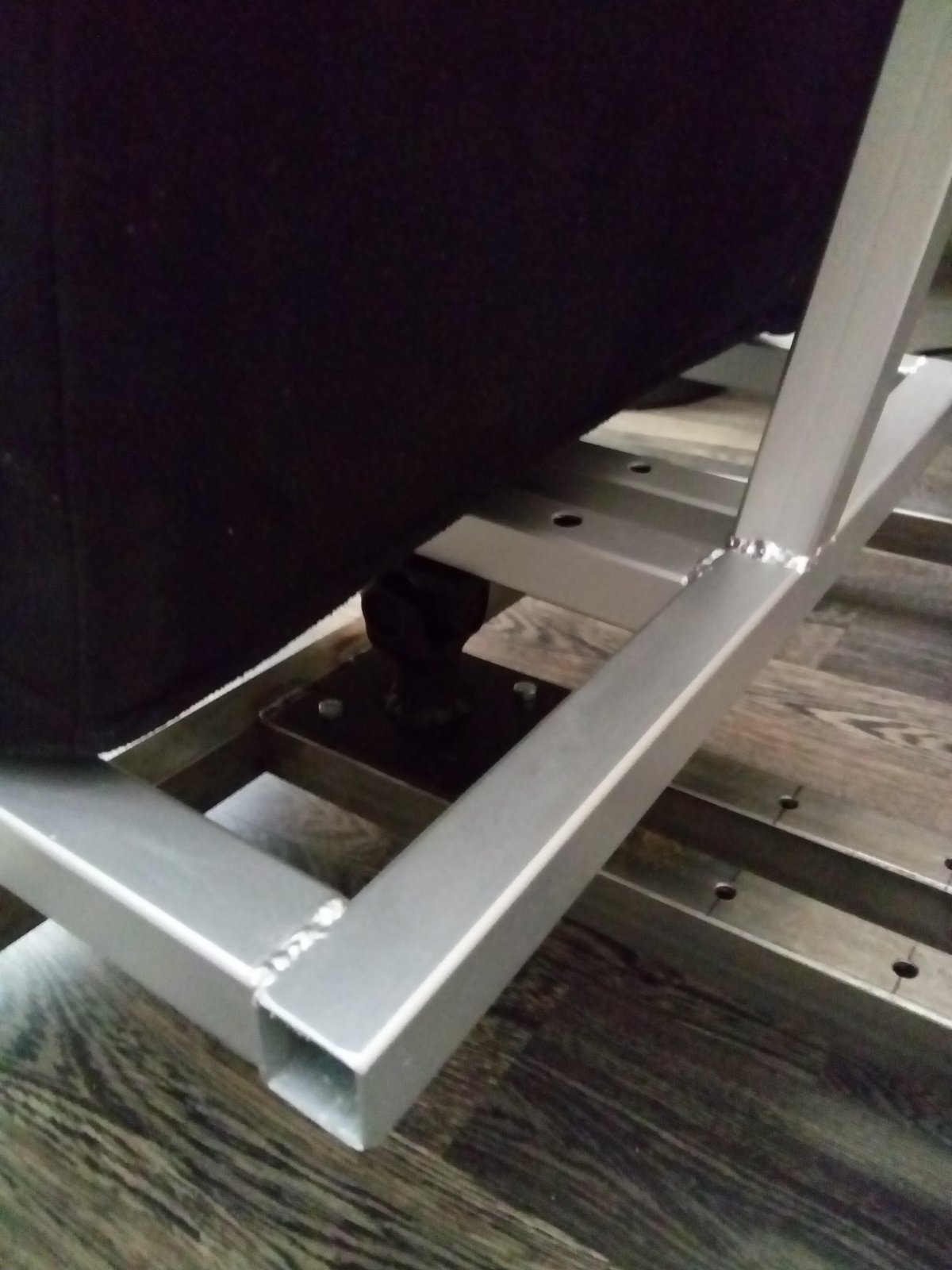

    @Nick Moxley You mean the overall angle of the rear arms? I moved the base joint 15cm to the front at its maximum mounting point. Should this be more like it?
    I can also place the seat 1 position forward as you can see below, this should increase angle further. Do you thinks its advisable?
    I appreciate an experts view ;)
  14. Nick Moxley
    17,056Coins
    +2,506 / 30 / -2
    Moving the seat Itself on the seat frame will effect the overall "balance" of the Seat frame Moving the whole Seat frame and Pivot point increases the leverage the motor's have on the seat and seat frame.
    The first pic shows A lot better angle than in previous pictures. Know that More angle is Better and will alleviate some of the pressure on the wipers.
    Maybe for testing purposes at a later date. remove the 2 front screw's in the CV joint plate and move it up to the 2 bottom holes, Not exactly giving you much more angle, But every little bit helps. Then if that's all you need. Weld on a New cross brace, add the 2 front bolts in again and your back in action.

    The only that i am a little concerned about is that due to flex on the shaft there is put some pressure on the pot shaft. I already made the pot shaft able to slide in the lever. But because the pots mounting strips are very firm they wont flex with the axle. I start to think about some spiral coupling to relieve this stress away from the pots.o_O but this can also be because i had the angle of the bars too low and causes to much force on the axles...

    Yes Flex coupler's are your friend...Cheap and effective. They wont cure a really outta wack setup. But will help your pots last for years to come(pending the quality of pots you have)

    Update time;
    So i changed the pot connection to a flexible one, this way i hope the pot 'll have a long lifetime. Thanks for the information guys :thumbs
    Next i painted the rig, transported it to my home and reassembled the whole thing. i'm now in the process of setting it all up with Assetto Corsa. I just got some initial movement so things looking good :).

    Glad your getting closer and closer. One word of warning tho, The Lever's look to be on the Thin side, If you see any deflection or bending happening go Double the thickness at least. 5mm flat bar is what I use as it will NEVER EVER twist or bend no matter how big of driver i slap in the seat.

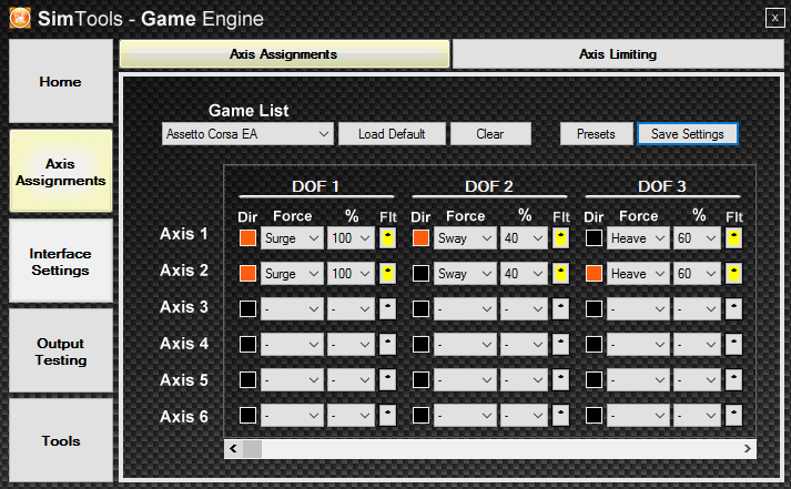

    @Nick Moxley Thanks, the levers are fine. I think they are +/- 4mm so strong enough. Last night i was setting up the axis for Assetto Corsa and came up with the settings below. The movement feels good, but i don't have any reference yet so i am not able to tell if it is actually good :eek:
    I thought i read somewhere that axis allocation must not go beyond 100% total. But i am way over that now. Can anyone give an opinion on these settings? The filter i am using is 'Boundary' for Surge:50, Sway:50, Heave:20,Pitch:20,Roll:20.
    I know tuning centre values 'll have a great impact on this, i'll try to make a screenshot of those tonight!
    EDIT: after watching some videos, i think i have way to much movement on all axis. i'll try to lower the settings. When i accelerate now, the surge is so much that it almost lift my foot off the accelerator pedal :rolleyes:
