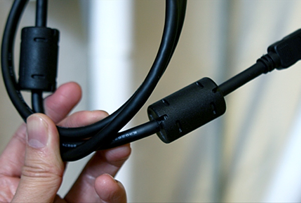

    If this ends up being the issue, maybe look into ferrite beads. I don't have a lot of experience with them but you should be able to get some that "snap-on" and they are supposed to remedy issues like this.
    Here's an example of what you're looking for:
