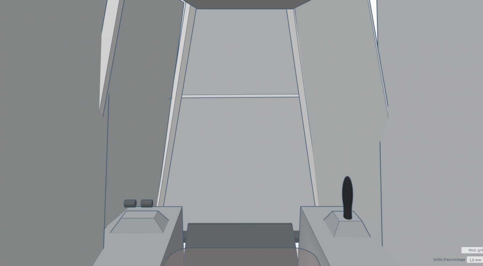

    When using a WMR device, in this case my HP Reverb with inside-out tracking, I was wondering if it would be able to work smoothly in an enclosed 3DOF sim.
    Quick draft of what I had in mind:
    A few notes/considerations:
    1) This would be conceived for flight simulation (P3D), flying commercial planes with little vibration or movement (compared to race driving or combat fights).
    2) The panels would be made out of extremely lightweight materials like foam board panels.
    3) There could be any type of symbols, colours or shapes on the inside-facing sides of the panels to help the camera sensors (+ enough light).
    4) Disregard the practical aspect of not being able to get into your seat for now, this is more of a proof of concept at this stage.
    My main interrogation:
    I know the Reverb also has built-in inertial sensors like an accelerometer, gyroscope & magnetometer. How much do you think they would influence the visual sensors? Which one has priority in case of conflicting data?

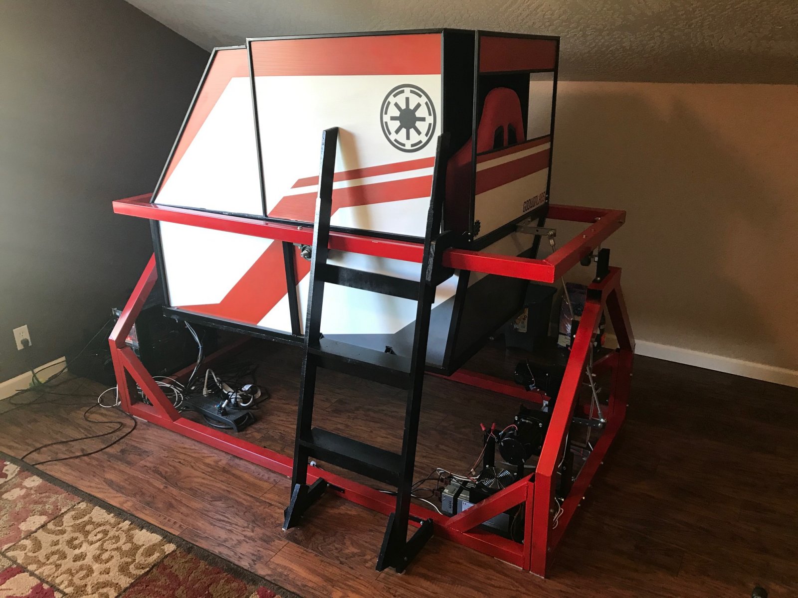

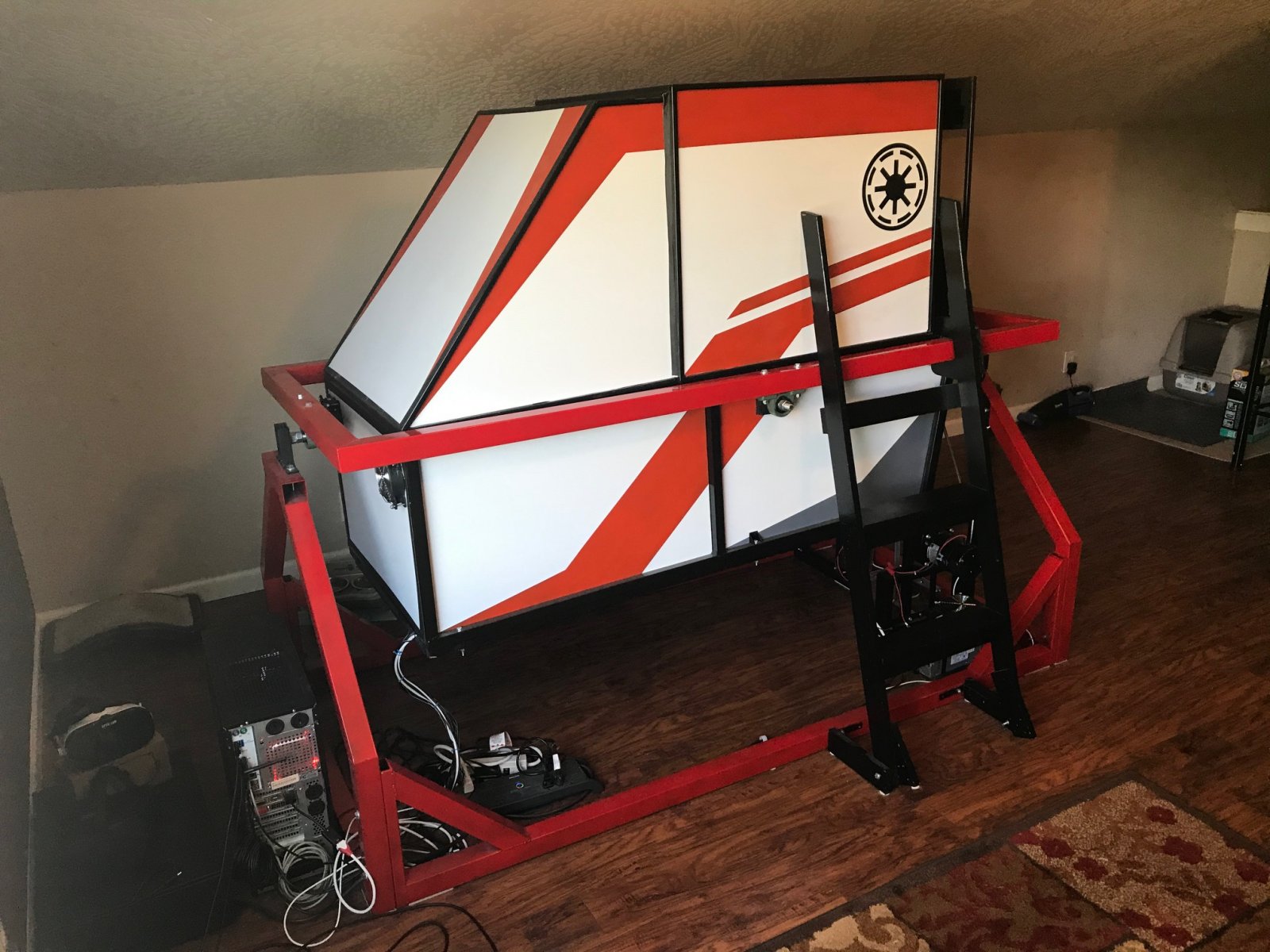

    Here is my enclosed simulator. It has a sliding cover and a tilt away ladder for getting in and out. When I run it with VR I put my Rift position sensor right inside on each side of the screen so they move with me. My sim has a pretty big range of motion (about 30 degrees pitch and tilt) and I'm usually pretty susceptible to motion sickness. But that setup doesn't bother me at all.
    I built mine originally for flight sim but I found the motion didn't add anything at all to the experience. If you fly with coordinated turns there is no motion. With aerobatics it is simply too much motion for the sim to recreate. Now I use it almost exclusively for car racing and a little bit of roller coaster sim but only certain coaster tracks work well.

    cgodwin... Which model of rift do you use? And just to confirm... say you're on a flat track in a racing program, you go through a hard turn to the right, your sim rolls hard to the left, but the horizon in your HMD stays level... is that right?

    I think I have an Oculus Rift CV1. It has no model numbers on it or the box. It uses 2 sensors on short stands for position tracking. I put those sensors inside my motion sim (see the pictures above) so they move with the sim.
    The motion is what you want, which is as you described. With a hard turn on a flat track, the horizon stays level on the Rift, even though the sim rolls dramatically. As long as the 2 position sensors are mounted on the sim it shouldn't matter if it is enclosed or not since they would move with the driver.
    I haven't tried it, but it seems the Oculus Quest might be a nice option, but only with a fully enclosed sim. I'm thinking with an open sim it would pick up the surrounding room and cause a motion compensation problem. With a rare fully enclosed sim like mine it should remove some of the wiring headaches but might still require a USB cable so the game can run on a PC and allow the wheel and pedals to work. Just a guess.
