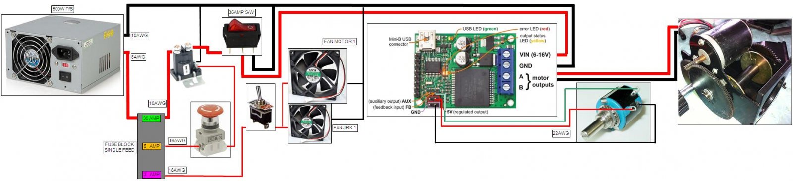

    I ended up not using any additional switches, just the emergency stop switch wired with 2 relays in parallel, one per JRK. I'll take some pictures and get back to you

    Thanks for that bit of info. I'm not that informed when it comes to fuses and relays and such but get the main concept. I'm wondering how you obtain the 3 different currents from the fuse so it can drive the eStop at lower Amps.

    Here is a pic of how I ended up wiring mine along with a quick diagram. The switch works great - I've had to use it a bunch already during setup :D
    The switch only draws 1 Amp or so. Computer fans draw even less so another small fuse required there. The JRK will draw 12A Continuous / 30A Max (or more will cooling). So each device needs a fuse of appropriate rating. Hope that helps.

    Hi, thanks for posting this, it clears alot up for me. !

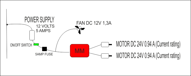

    Hi, I was studying the diagram and the question is Why does the Stop Switch goes located after the fuse? Have any diference to allocate it between the power unit & the fuse? This is my diagram with some other components (motors with lower Amps for experimentation only) but I think the point it would be the same. thank you.

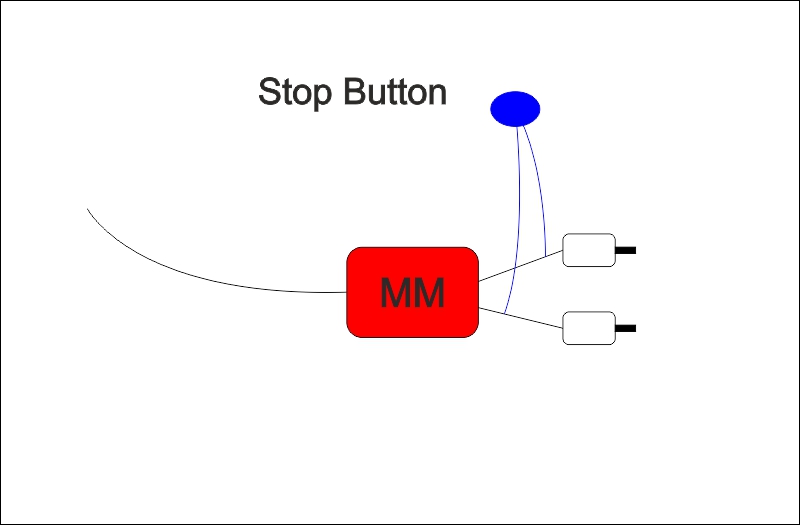

  8. masterhoo
    masterhoo New Member
    May 20, 2017
    25
    Peru
    370Coins
    Hi, @SeatTime, thank you for your answer, well I see, I think I'll end up using thanos controller because of those features, I dont understand the configuration though, meanwhile I'll continue using MMonster for experimentation. Well, I think you are already familiarized with MM, Sabertototh or JRK boards, so do you have any recommendation to stop two motors at the same time using those listed boards? Of course, bearing in mind to stop them, as described before, under no electrical risk, but the user wants to leave imediately the playseat, for example a kid, stopping the movements of the two motors only, I've added a simple sketch about the possible connection of the stop button, but if you could help me to improve it I'll be really glad of it.

    High current 12 VDC relays.

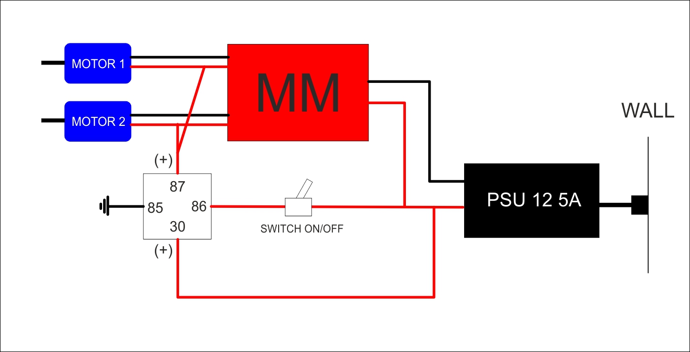

    Hi @SeatTime, I came back with a wiring diagram I created but I'm not pretty sure if correct. I want to stop both motors only with a switch/E-Stop. I would like you to help me to correct it if necessary.
    I have this doubt: I connect the 87 side of the 4-pin relay direct to both motors, that would be correct? That connection can influence or cause any short-circuit in my MM driver? or an abnormal behaviour on the motors or MM? (because It would be joining the wires of the two motors in a single one) or it would be better off to use two relays, one relay for each motor? let me know please, thank you.
    wires: red (+)/black (-) just in case ;)

    No that won't work - power is still being sent directly to the MM and motors. The relay/switch is actually doing nothing apart from shorting out everything when the polarity on the output of the MM changes to change the direction of the motors. Recommend you get onto Google etc and do a bit of research/education into electricity AC/DC - motors - MMs etc - you need to understand the basics or your going to blow something up :D. I could show you how to wire it up, but that would not teach you anything and knowledge is power:)

    @masterhoo - Does your power supply support remote power off / power interruption? Many do. That's showing as a 12V, 5A so maybe it doesn't but a relay big enough to handle that is very common.
    In the circuit you show, I'd just put a single pole normally open relay in the positive line between the power supply and the MM. Configure your emergency switch to have contacts closed in the run position and open in the stop and wire that between the power supply and the coil of the relay. What that does is when the emergency switch is in the run position, the coil will pull in and energize the MM to be able to run the motors. Hit the emergency stop, though, and that opens the contacts on the emergency switch which interrupts the circuit energizing the relay coil. When that de-energizes, the normally open contacts of the relay open which interrupts current to the MM and stops movement. The power supply stays up, though, so all you do to restore motion is reset the emergency switch which re-energizes the relay, closes the contacts to the MM and you're back in business.
    Variations would be to use a double pole relay to open and close both power and ground to the MM, using solid state relays, etc. At 5 A for testing, I don't know that I'd even bother with an emergency stop unless you are wanting to experiment with that. Thing is that while small amp supplies generally don't have remote on/off capability, the big ones you would use for real motion frequently do. That changes how you wire things up so not so much of these experiments will transfer. If you have to use a relay, it's going to be a big one, too, to handle all the current of two motors under load. It should be sized bigger than the max current the MM can handle and whatever fuse value you are going to use so it doesn't end up being the fuse or having contacts weld and then not open in an emergency.

    Hi @SeatTime, thank you for your answer...so in other words you are saying that to stop both motors, first I would need to turn off the current that goes straight to the MM, and only then the motors will stop. And there is no way to work directly on the MM-motors connections as depicted wrongly on my diagram :( due to the change of polarity, It has sense, I understand better, I'll research more, definitely. thank you.
    Hi @Zed, thank you for your feedback, I'm still waiting for my wiper motors to arrive, 1 month at least. I understand the point now...I think I'll stop this progress until they arrive & researching in the meantime, because as you say, with a 12v 5A PSU things work different & the wiring will probably be different as well. Once they arrive I'll start with bigger components suitable for a normal-size motion sim, using the recommended components, thank you. :)
