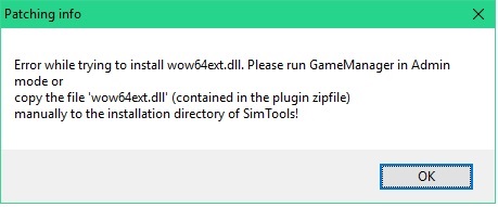

    I'm new here. Thanks for uploading this. However, I'm getting no motion and no numbers in the tuning center. It may be the wow64ext.dll error that I've been unable to resolve. I'm running SimTools pro 2.1 on a Win10 machine. The setup is working with War Thunder and Project Cars, just not with Elite Dangerous.

    Only thing I can suggest is to make sure wow64ext.dll is in your simtools install folder and make sure you are running all the simtools programs as Administrator. Hopefully that works

    There is also GetBaseAddress64.dll I forgot about that, I presume you have moved that into the simtools dir ?

    GetBaseAddress64.dll seems to have done the trick. I still get the wow64ext error, but values register in the tuning center now, and the chair is moving. Thank you for your help.

    No luck for me. I still get the wow64 error on patch and have no motion from the chair with Elite Dangerous in VR. I did verify the War Thunder works okay, and that GetBaseAddress64 was in the SimTools directory. Perhaps my Tuning Center values are incorrect? They are 1.78/1/0.8/1/1.2/1.95 (I don't remember setting those.)

    You MUST run GameManager in admin mode when patching!

    I thought that I had, but to double check I un-patched the game -> shut down all SimTools programs -> used the plugin updater to re-apply the plugin -> restarted GameEngine and GameManager in admin mode -> re-applied the patch in GameManager (again getting the wow64 error) -> hopped in game to check it out. Since I was still getting no chair motion, I opened the Tuning Center and restarted the game. The Tuning Center is showing no game data output. I'm running version 2.3.10 of Elite Dangerous with an Oculus Rift. The plugin DLL reports that it is version 2.0.0.2.

    What does "the wow64 error" say?
    And can you try to copy the wow64ext.dll manually to the installation directory of SimTools?
    The wow64ext.dll is contained in the EliteDangerous64_GamePlugin.zip

    "Error while trying to install wow64ext.dll. Please run Game Manager in Admin
    mode or
    copy the file 'wow64ext.dll' (contained in the plugin zipfile)
    manually to the installation directory of SimTools!"

    Thx. Does it work when you copy the file 'wow64ext.dll' manually to the installation directory of SimTools?
