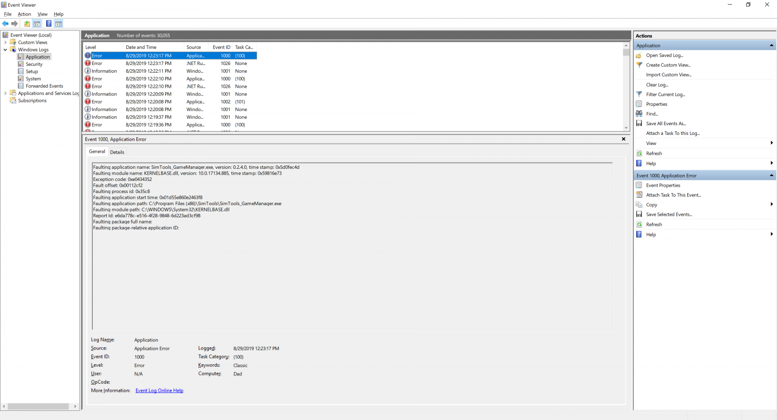

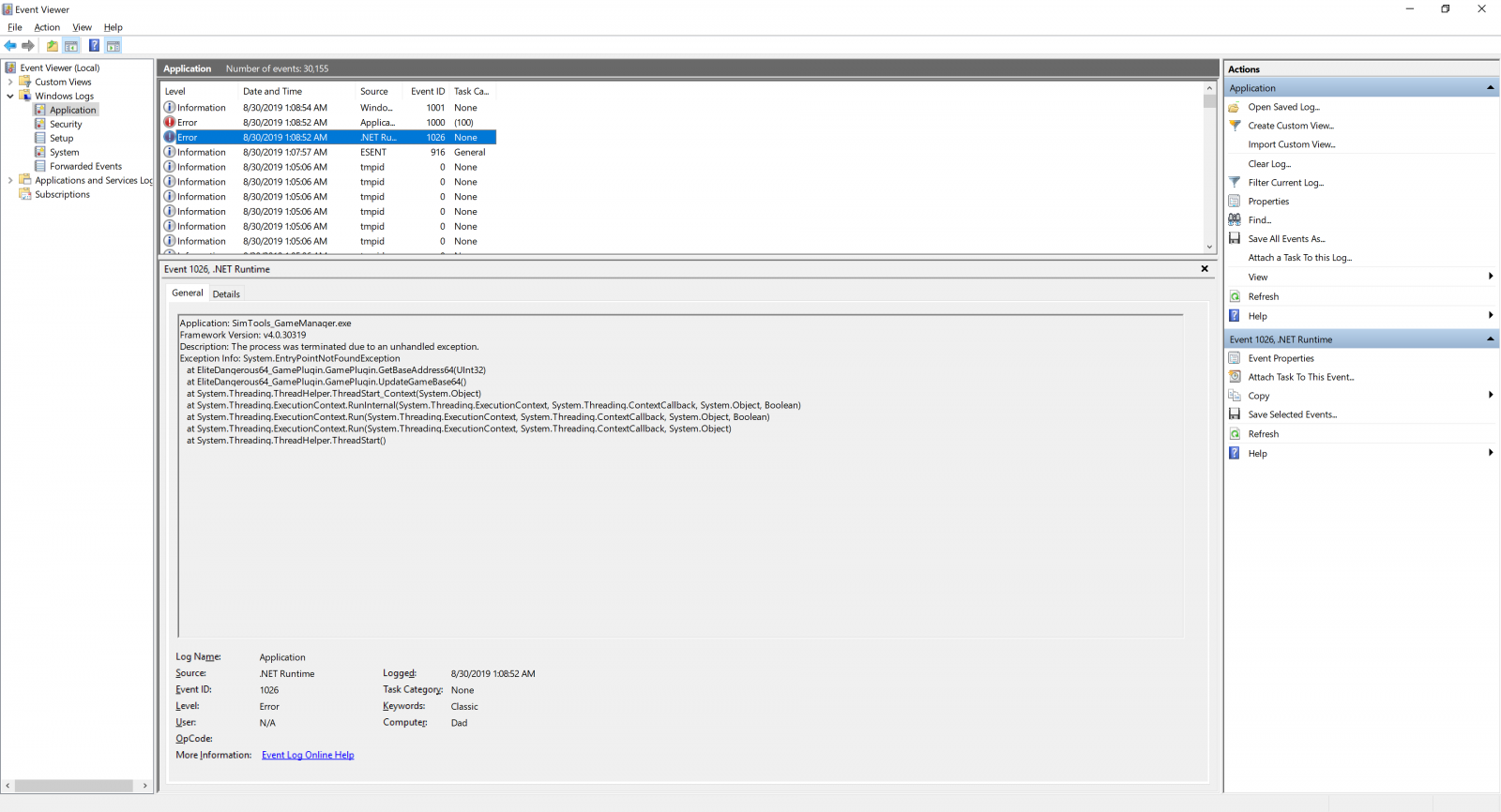

  5. edmond ying
    edmond ying New Member Gold Contributor
    Aug 18, 2018
    - 106Coins
    Motion platform
    I've the same problem with elite dangerous only.
    Game manager crash, game engine is ok.
    attached is a screenshot of the event viewer
    any help is appreciated

  7. edmond ying
    Aug 18, 2018
    - 106Coins
    Motion platform
    yes, i tried that
    updated with simtools updater
    then remove patch
    install patch
    still crash
  8. edmond ying
    Aug 18, 2018
    - 106Coins
    Motion platform
    Hey, i got it to work. thanks a million
    its the wow64ext.dll file that needs to be copied into the appdata.... folder
