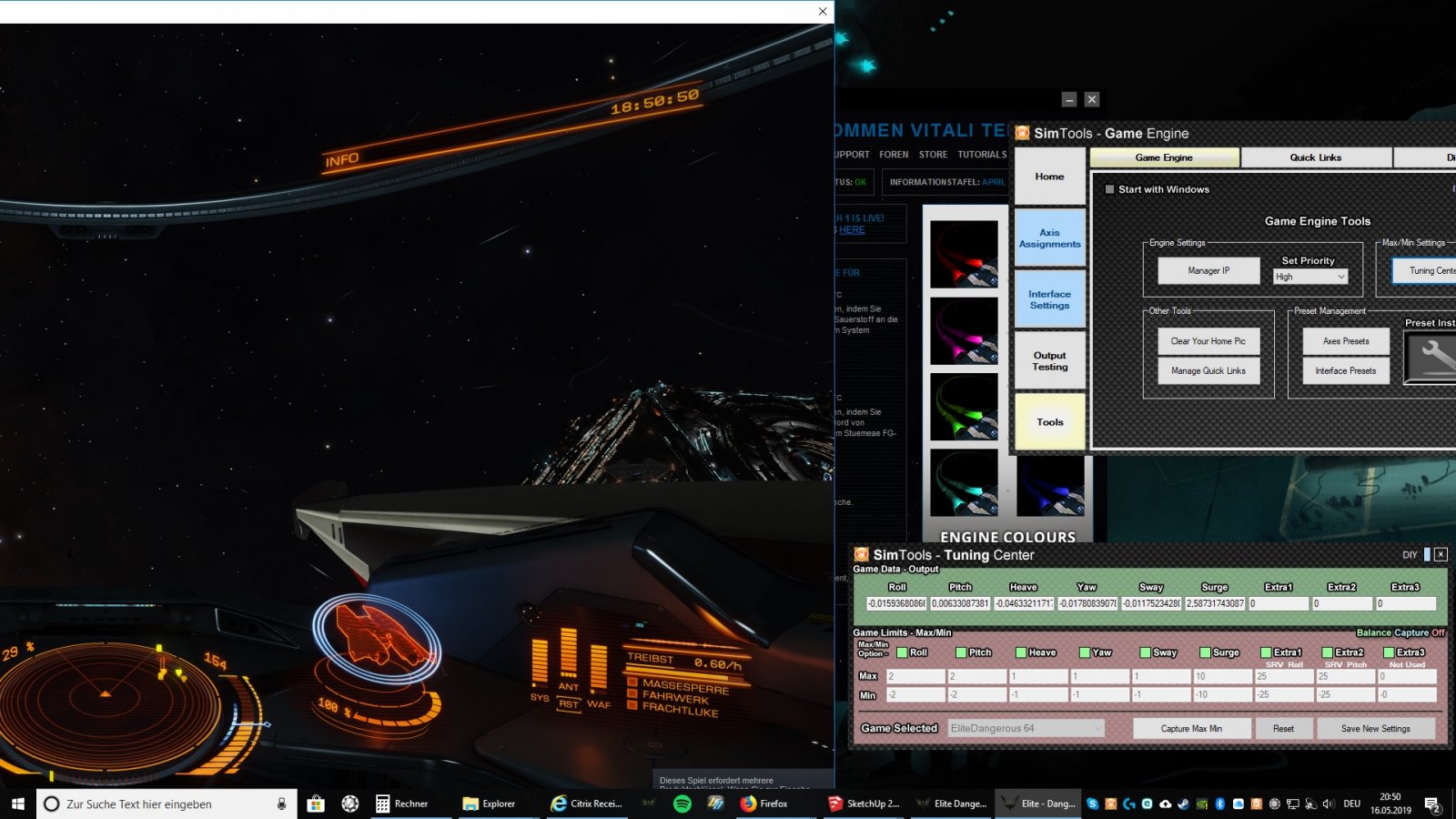

  16. Vitalius
    Vitalius Active Member Gold Contributor
    Jul 2, 2018
    153
    Bonn
    540Coins
    +74 / 1 / -0
    Motion platform, 6DOF
    Cool! Runs wonderful! Thank you
