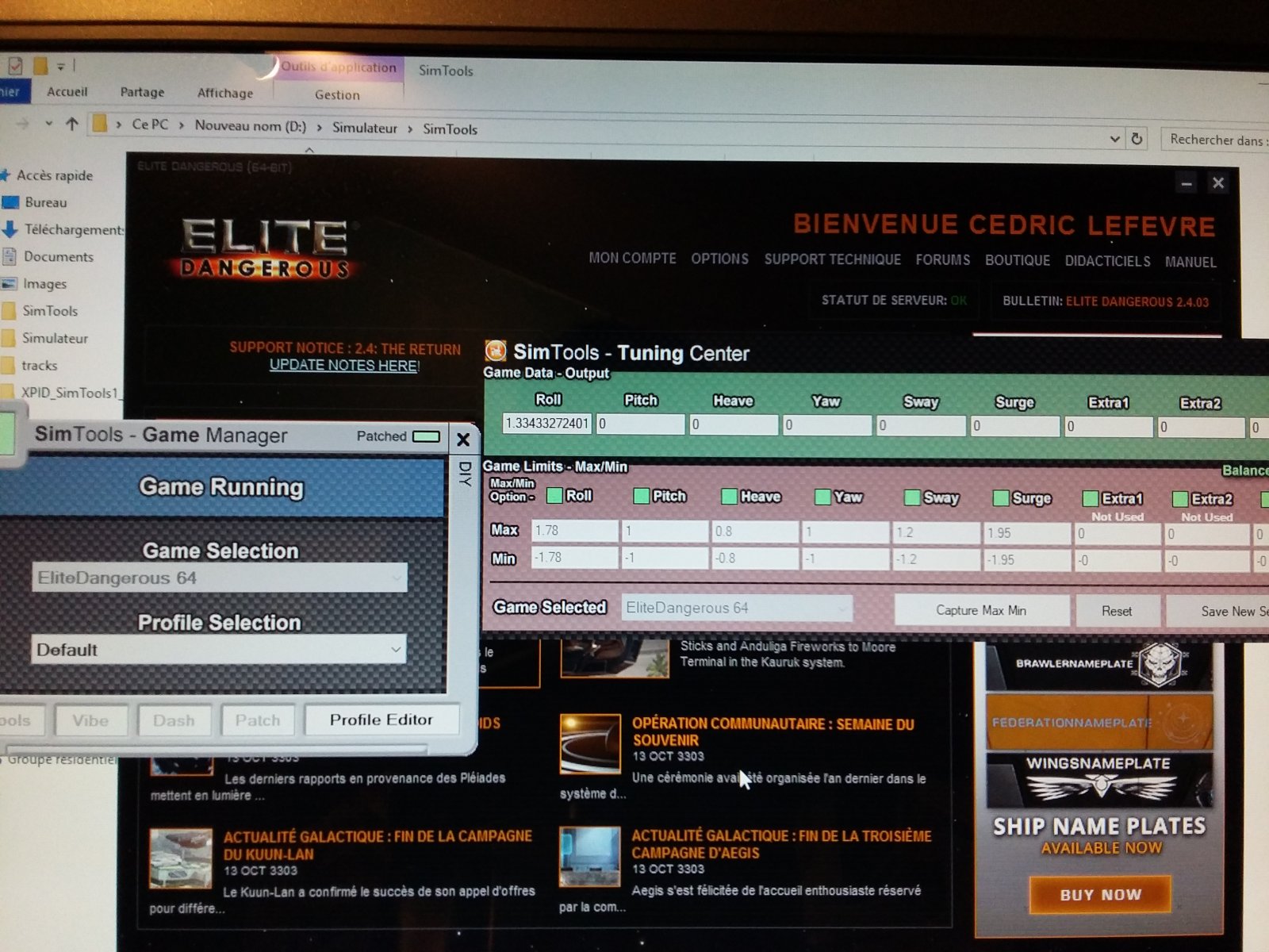

    Hello ! :) Look at this picture and tell me your opinion. Only the roll is operated.
    Administrator mode ok for game engine and game manager. When i launch the game the motion plateform moove only in roll mode in right and stop. In game any movement. Heave, pitch, Surge, Sway and Surge are activated in 20%. I play with assetto corsa and the plugin work perfectly. Can you help me please ? Thanks

    Plugin is broken at the moment due to the game update. I have not had chance to make a new one I've been way too busy.
    Also the plugin will when updated only work with ED:Horizons
