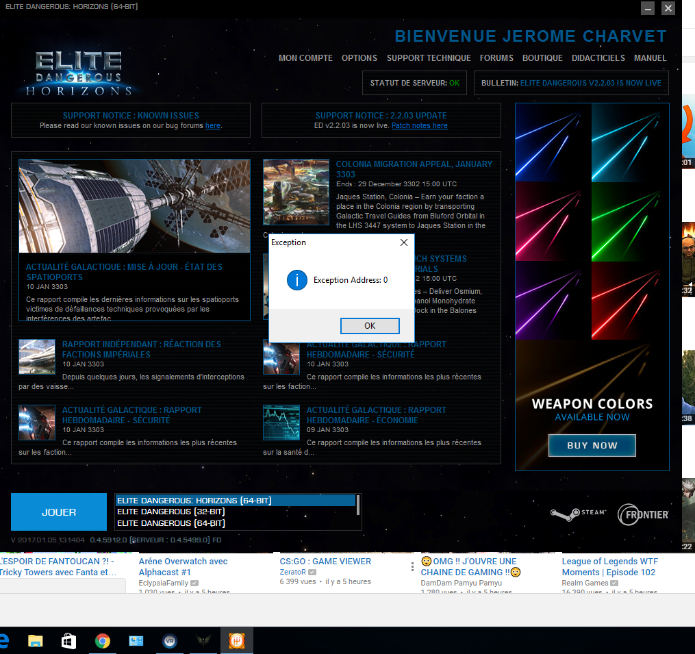

    Thanks for your great work.
    I have a mistake, i've got an error "Exception adress: 0" on game manager when i close elite dangerous.
    I haven't motion but i don't think is plugin fault.
    Do you have a suggestion to me plz?

    Hello, I am not able to get this working so far.
    I have been testing it with the pro version of Simtools with both Steam and ED launch version of Horizon and so far no luck getting any motion on my sim.
    I get wow64ext.dll error during patching even when game manager ran as admin so copied it manually into the Simtools installation folder.
    Both the game and the Simtools installed on D: drive.
    I get the same "Exception Address : 0" error up on exiting the game as well.
    Any suggestion will be appreciated.
  6. SilentChill
    2,645
    20,604Coins
    +3,570 / 34 / -0
    Once you copied the wow64 into the simtools folder do you still get the error ? Do you get "GameRunning" when ED is running ? Have you set your min/max in the tuning centre they should all be set to 1.1/-1.1 apart from roll which should be 1.8/-1.8 to begin with and then tweak to your liking
    The Exception address 0 i need to take out, that is just saying that it cant find the address anymore when ED closes.

    +130 / 4 / -0
    Locotoki,
    I had the SAME problem, as Craig wrote, write over the limits at the tuning centre, it should work after!
    Cheers
  9. Jecha
    Jecha New Member
    Nov 8, 2016
    - 39Coins
    That's working! Great!
    Thanks for support SilentChill and go Enjoy :)

    3DOF, SCN5
    I am happy to report that I have the motion back after setting the suggested values for max/min in tuning centre.
    Thank you!!!

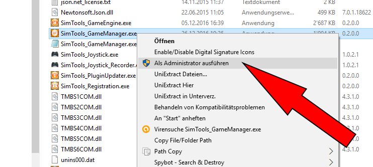

    414Coins
    Good evening,
    Thank you for the realized work, on the other hand I do not arrive has patcher the game with simtools, what is the way svp?
    Thank you

    Has every time, simtools indicate pacth no confirm
  18. value1
    Jan 9, 2011
    2,192
    Zug, Switzerland
    14,280Coins
    +3,362 / 13 / -1
    Start the GameManager in admin mode and patch the game.
