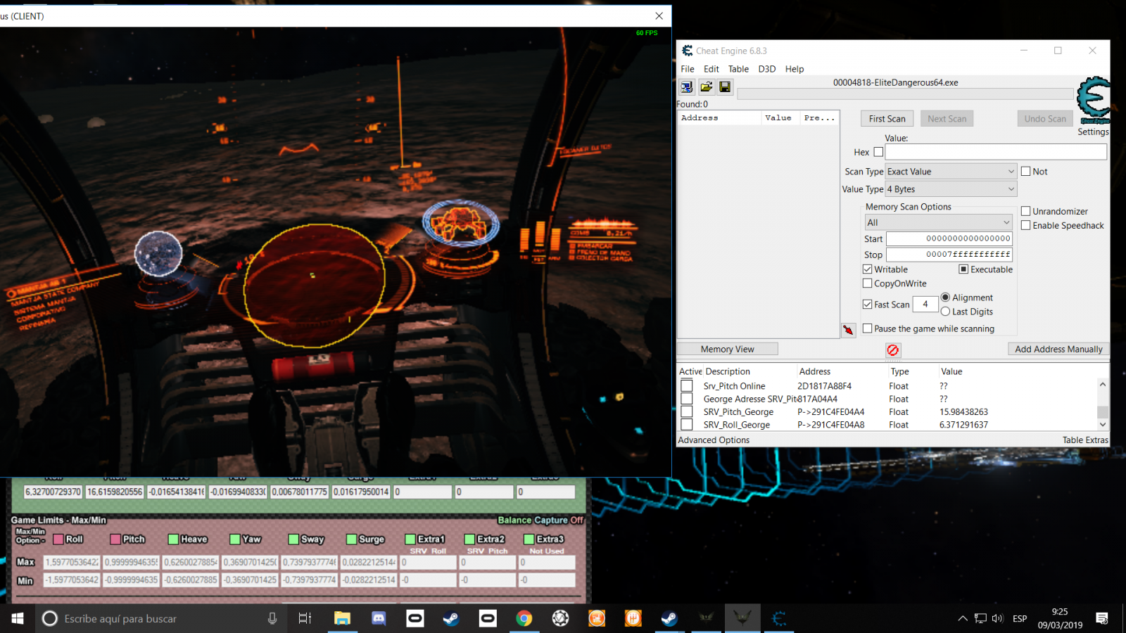

    Than its weird, srv should work too in simtools. Try it again, and give me a picture of your simtool tuning center .

    There it goes, I do not know, perhaps it has not been successful with the Xml?

    YOu have values in the SRV according to simtools. So everything is working.
    If you expect to see the SRV movement in the Extra 1 / 2 slot, you have to change in the XML :
    UseExtraForSRV="False" to "True"

    Ahhhh, I was starting to suspect it when I saw the xml, thank you very much
