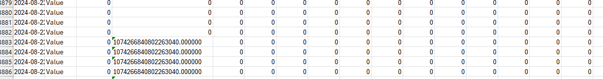

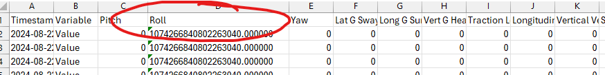

  19. Roons
    Roons New Member
    Feb 17, 2020
    16
    - 20Coins
    +10 / 0 / -0
    Motion platform, 6DOF
    Hi Wagnard! Thank you for all you do!
    There appears to be an issue with the latest points specifically for Roll. When first launching to Elite Dangerous, the points provide the following value for Roll causing motion platforms to roll extreme to the left.
    Roll:
    The value will normalize to 0 once you start moving in the game to generate telemetry. However, any time telemetry completely stops from coming to a complete stop in the game in your ship/srv, or when you are in the menus for a more than 10 seconds or so, the point value for Roll appears again as seen here:
    Moving the ship slightly in game will return the value to 0 again.
    I'm not sure what would cause this, but it appears under those circumstances.
    I'm using Sim Racing Studio version 2.33.0.21 and the results above are from its telemetry export function found in GAMES > Telemetry by selecting Export. You can also view the telemetry in realtime and see the roll value above as well.
    Hopefully its an easy fix/find and thanks again!
    Also, do you have a link to any guide/tutorial so I can potentially help find these as well?
  20. Wagnard
    Jan 30, 2017
    555
    Wagnardsoft
    Canada, Quebec, Mirabel
    5,294Coins
    +750 / 2 / -0
    Nothing I can do about for the pointers, they just gave these values, but with the simtools plugin I added some logics in the plugin to avoid this. It's more a pluggin issue than a pointer issue.
    Are you using odyssey or pure vanilla elite?
    Edit: SRS seems fine on my side. So User configuration error or a possibility that the pointers are not perfect for everyone.
