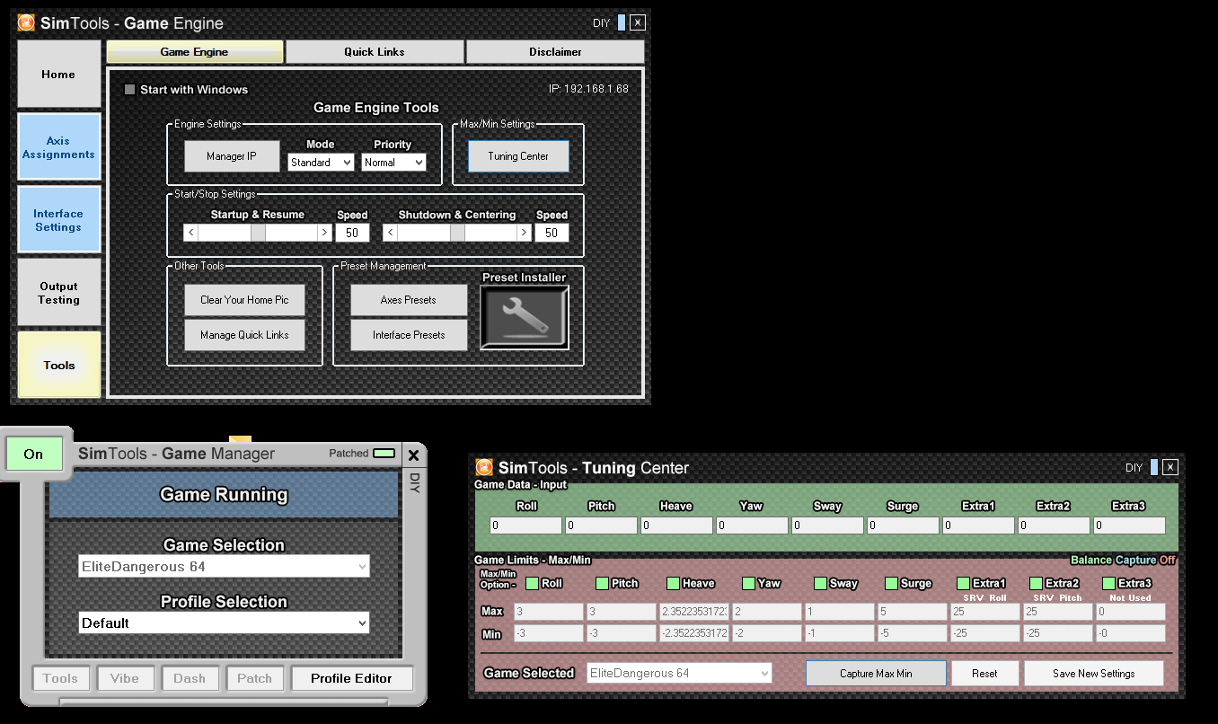

    Hello Wagnard, Hello everyone.
    I just downloaded the latest plugin and update 13 August 2022. the game is patching fine, but I have no movements in Tuning center. of October 2021 and therefore the update of the XML file for the month of August.
    I don't see what else to do, can you help me a big thank you.

  10. Dronneau.Y
    Dronneau.Y Member Gold Contributor
    Aug 22, 2015
    43
    france
    65Coins
    +7 / 0 / -0
    Hello Pierre,
    I use simTools, my platform already works for a long time and with all kinds of games. it has already worked with the SilentChill plugin. but Wagnard's connects well to the game but doesn't give me any moves.
    I unpatched the game then dragged the plugin into SimTools Plugin_updater, then I launched Game Manager and repatched the game.

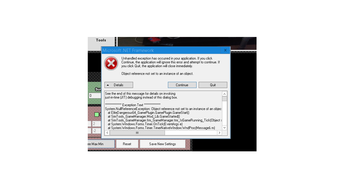

    This can happen sometimes when starting the plugin / elite. Simply re-launch the GameManager.

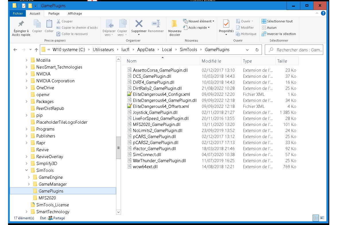

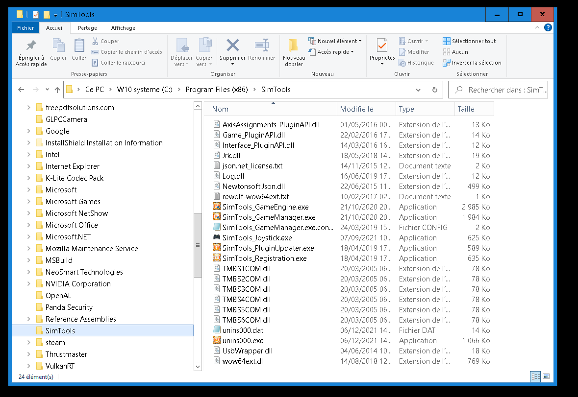

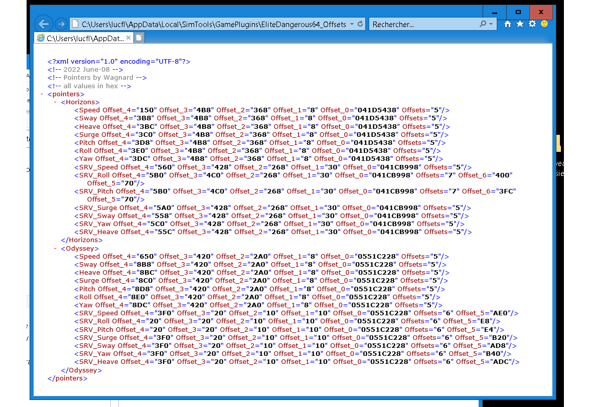

    For your problem, show me the content of your "C:\Program Files (x86)\SimTools"
    and the content of your EliteDangerous64_Offsets.xml
    Also is it for Elite Dangerous Horizon or Odyssey.

    Hello Wagnard,
    Here is the screenshot.
  19. Wagnard
    Jan 30, 2017
    562
    Wagnardsoft
    Canada, Quebec, Mirabel
    5,349Coins
    +776 / 2 / -0
    Ok this seems ok, now shoe me the content of your xml
