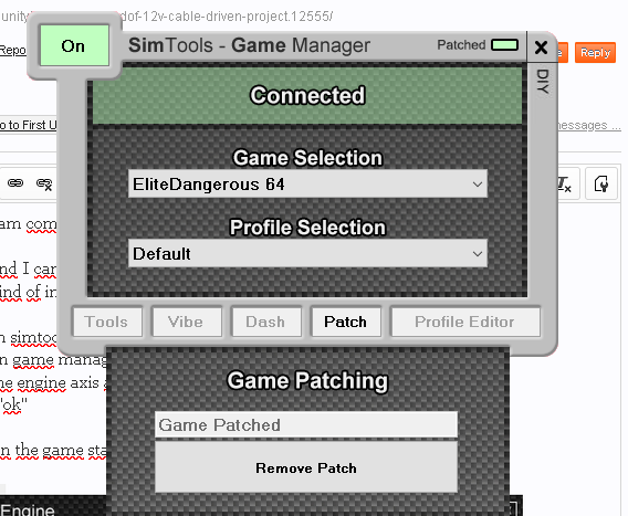

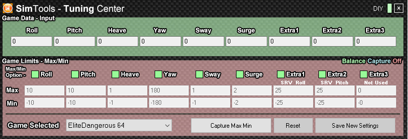

    Hello I am French and I am communicating with you via google trad.
    I am starting "Elitedangerous" and I cannot move my seat to 2 DOF.
    I am already used to this kind of installation on several games.
    Here is what I did:
    * insertion of the zip file in the simtools plugin
    * activation of the patch in the game manager
    * 100% attribution in game engine axis assignments
    * manual seat test "ok"
    * game start via steam
    * the boxes turn blue when the game starts, but no movement in the adjustment center.
    Can you help me please

    Did you get the latest XML file? https://www.xsimulator.net/community/attachments/elitedangerous64_offsets-zip.88288/
    Also, make sure you have the correct wow64ext.dll in the plugin directory?
    I advise you replace it with the one located on your simtools installation directory, it should be around 700kb in size.
    Hope that helps.
