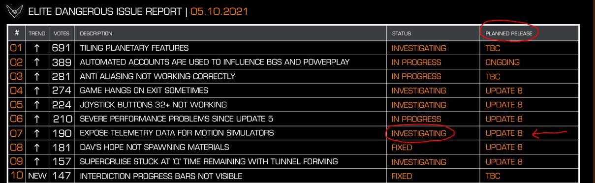

    Hi fellas,
    Maybe some good news on the horizon.
    Just noticed this on the Elite Issue tracker from a couple of days ago regarding Telemetry for motion data from the game for our simulators.
    @Konstruukt - have you seen this? as you originally raised the ticket.
    If I'm reading it correctly they are now investigating it and have specified possible release in update 8
  6. Mechromancer
    Mechromancer Active Member Gold Contributor
    Aug 28, 2018
    135
    434Coins
    +49 / 2 / -0
    OMG...the tease is excruciating! LOL
  7. George Dobransky
    Sep 29, 2016
    222
    Hungary
    - 43Coins
    +130 / 4 / -0
    Best news in ED history for us.....
