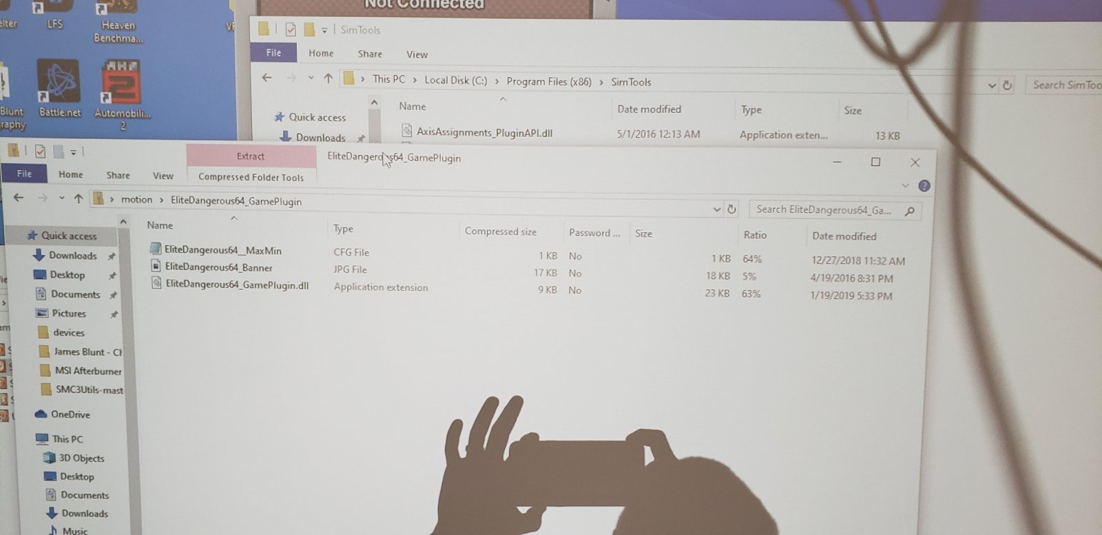

  17. Keith
    Keith Active Member
    Jan 21, 2020
    179
    Electrician
    Canada, Saskatchewan
    144Coins
    +83 / 0 / -0
    Hey guys. I can not get any motion in Elite Dangerous. I probably downloaded the wrong plugin or something. Here is a pic of the zip folder.
    I would try re downloading the plugin but I dont have enough coins
  18. Wagnard
    Jan 30, 2017
    562
    Wagnardsoft
    Canada, Quebec, Mirabel
    5,349Coins
    +776 / 2 / -0
    Yep wrong plugin.
    Also gave u some coins.
