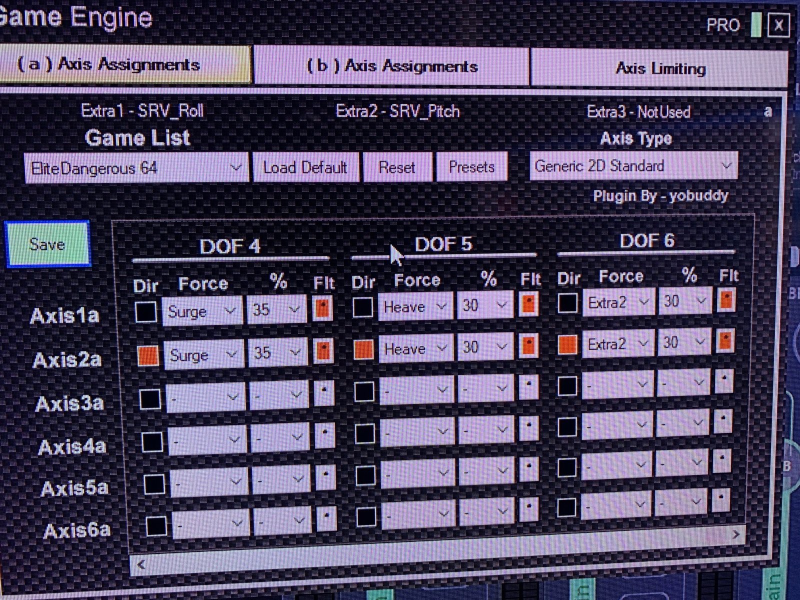

    For Pitch and roll in SRV, change the Address to one of theses in the XML and tell me the one that works for you (you have to restart at least gamemanager each time after you save. (do not patch):
    Currently: 0364D328
    Try either of theses:
    0364FD78
    0364FDF8
    0364F530
    0364FE10
    0364FE20
    0364FE40
    0364FE60
    0364FE80
    0364FEA8
    0364FEB8
    03654198
    03659528
    My little finger is telling me that the first one is the good one, but you will tell me ;)

    I have tested.
    First, the current plugin updates the xml not with 0364D324, but with 0364D328 as srv roll and pitch.
    First i have tested with 0364D324. In this case no roll and pitch, and all the other
    forces has gone in the srv...strange...
    Than I have tested all other suggested addresses, the other forces in the srv has come back, but still no roll and pitch.
    Cheers,
    George

    Don't forget that they are set at Extra by default too. Check in the GameEngine tuning .
    Edit: George confirmed that everything was ok finally. So the pointers are all good.

    How am i supposed to add the axis extra 1 or 2? I have only room left for one of the 2. use SRV Pitch now, but would be nice to add roll too.
    Am i missing something basic here?
    Thanks!
  13. Wagnard
    Jan 30, 2017
    533
    Wagnardsoft
    Canada, Quebec, Mirabel
    5,120Coins
    +713 / 2 / -0
    In the XML, there is a configurable option for you that you can switch the "extras" to the normal roll & pitch, also you can configure the force strength there too as the SRV doesn't react as smooth as the ship. Usually a 3% value is good.

    Ok, so set the UseextraForSRV to false, and then change the 100 to just 3 in the roll and pitch for SRV in the XML?
  15. Wagnard
    Jan 30, 2017
    533
    Wagnardsoft
    5,120Coins
    +713 / 2 / -0
    Exactly.
    You will have to restart game manager after that change too.

    Thanks, works great, did a 10 for roll and 50 for pitch (i like the pitch feeling when going downhill haha)
    But they slowly reset to normal/level, i guess this is normal?
    Thanks again Wagnard! This makes Elite a dream
