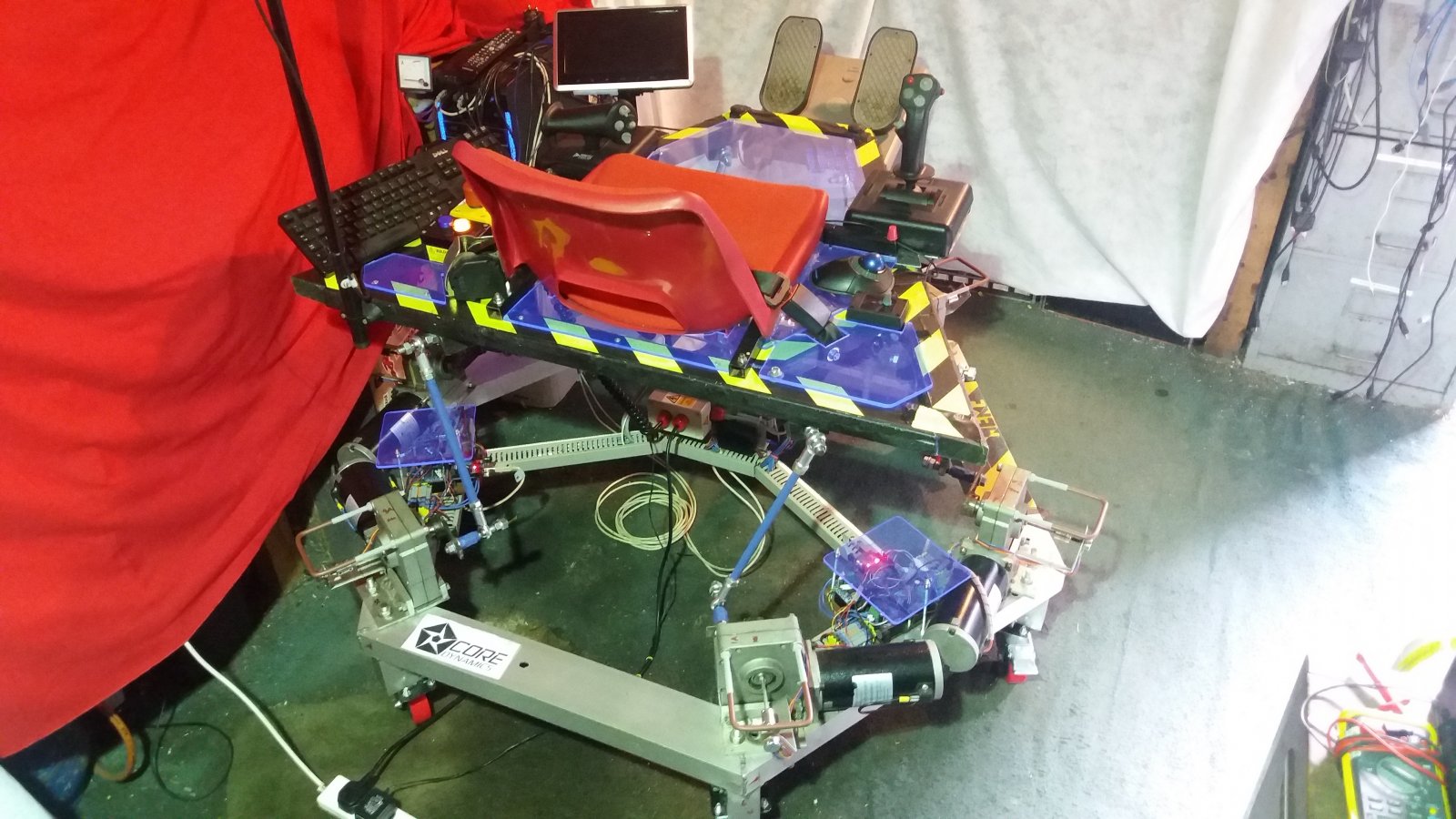

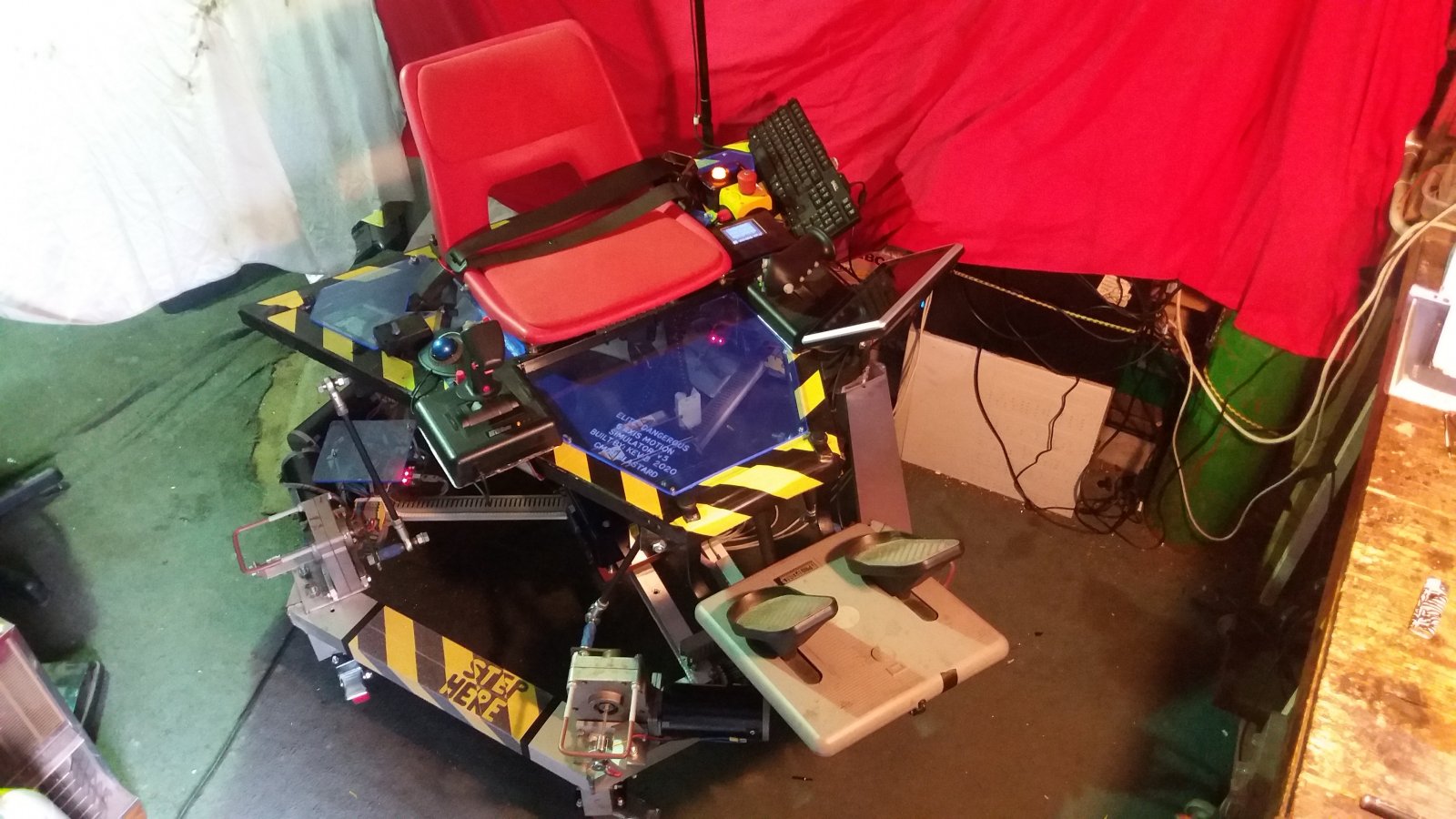

    Hi guys - some news!
    Attempt to get motion data from FD - phase #2 (and some fun along the way).
    A couple of weeks ago I saw on the ED forum that the Elite community are holding another ECM event. Some of you may remember that I took my 3dof v4 motion chair to one of these events back in April 2018, which I posted details about on this forum. It was all in an attempt to try and convince FD to release motion data API as well as demoing a motion rig to the masses and letting some people 'have a fly' (including Ed from FD)- all in VR using cv1.
    Well, this year the event is being held in Cambridge, UK - and this is where FD are based. Could be an ideal chance to 'sell' the idea of motion API to FD again. So I thought "what the hell !- what have I got to lose".
    I contacted the organisers ( - they remembered me from the 2018 event) and asked if they'e entertain me bringing the latest v5 'full-size' 6-dof motion sim to this event (along with a pimax 5k+vr headset) - I got a resounding 'yes - bring it!!, we'll make room'.
    The event is almost sold out now and I have it on good authority that quite a few of the FD staff are attending - including some of the devs (well, it is on their doorstep). I really want to put some of the tech devs in it for a go.
    So, I've made the rig portable (six double-bearing 150mm wheels) so I can move the whole 300kg rig with one hand now. I've a 3.5ton truck (with tail-lift) hired for the event, and finished 'tricking' the rig up. It's bristling with technology now and is quite stunning to see (either static or in motion), with the ED plugin it's simply amazing. Pictures just dont do it justice in my 'busy' garage but I'll try and pop a few in below
    I've completed a full Risk assessment and Method Statement for it and certified it electrically for safety. So me and the 'v' be off to the event from 10th - 12th April. I'll be demoing it with Joystick plugin and with the ED plugin. I'll be demoing the difference between the two when in ED. It'll be my biggest pitch to all attendees for motion data I can think of - and I demo it all pretty well if I do say so myself :)
    So here is a question for @Wagnard . If you were there and face-to-face with a couple of devs (who will likely have just had a fly in the rig) - what would you ask them for (in their tech speak) to enable continuous motion data (even after game updates). Something I can get printed up and give to them... the more detail the better.
    Edit: added a sneak snipped during testing of part of the on-board lighting (different patterns/displays depending on power output of rig)
