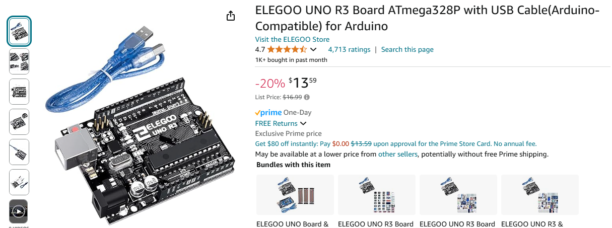

    Curiosity question, on the product page for the Elegoo Uno it states "the ELEGOO UNO R3 BOARD now uses an 16U2 instead of the ATMega8U2 chip", so I am presuming there may be differences between Elegoo Unos, do you know what hardware yours has: https://www.elegoo.com/products/elegoo-uno-r3-board
  5. Slawko
    Slawko New Member
    Dec 3, 2023
    22
    NI
    34Coins
    I'm on the same as on the photo
