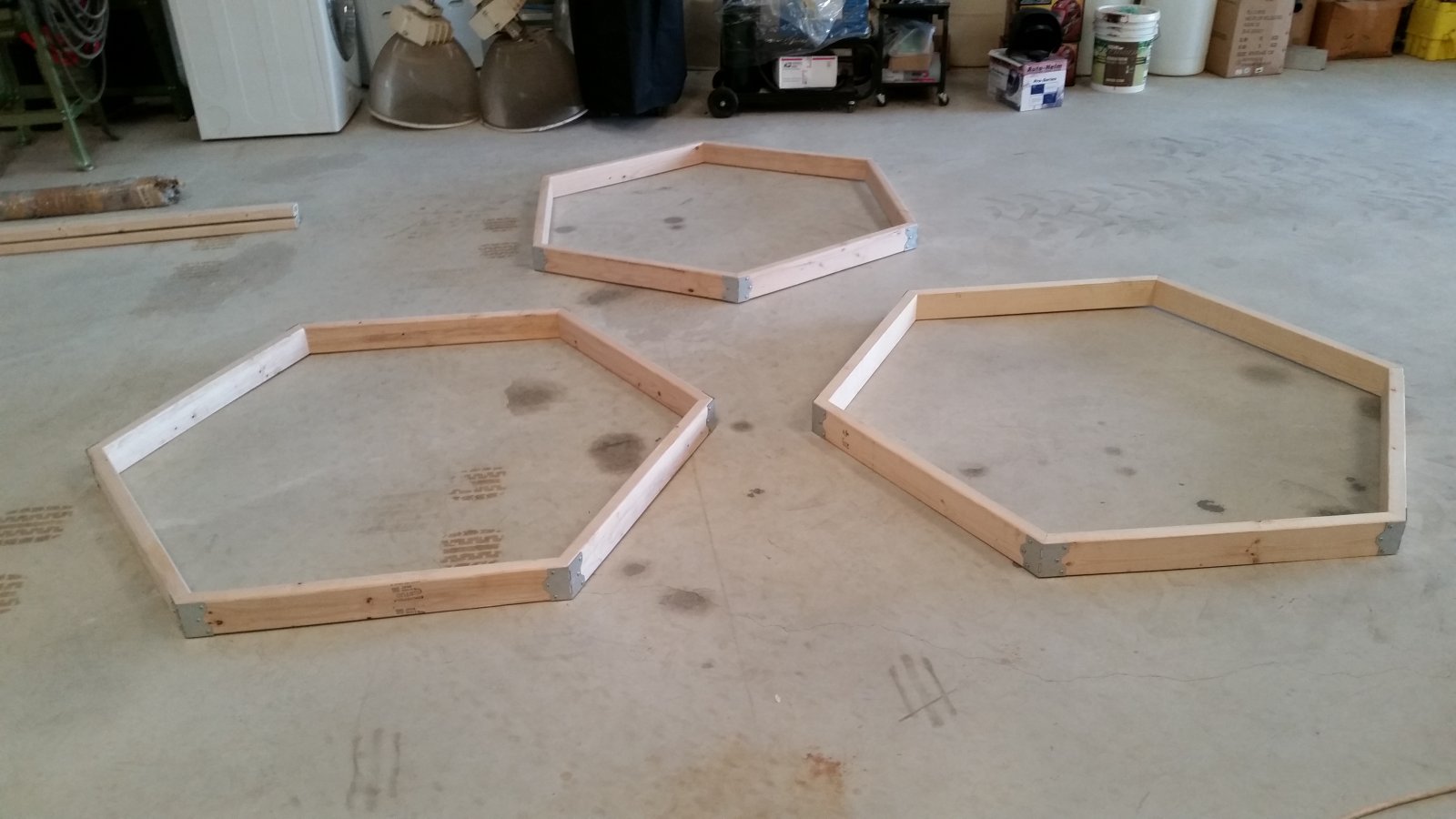

    I understand what he is doing now. Magic, after you mentioned SilentChill I looked at his 6DoF build again. I had forgotten his frame setup.
    You do not need to worry about perfect 2x4s. Most are ok for what you want to do as long as they do not have huge knots, etc, small knots are ok. We just finished building a house and believe it or not we only had seven 2x4s that we couldn't use out of 1000+ boards. 1/4 sawn douglas fir is way overkill.
    Mostly the 2x4s on the base are to keep the three platforms together and the real strength for the upper platform is the top (plywood, etc).

    I will shop tomorrow for clean white fir and plywood bottom support structure. Parts are arriving now and assembly is due. I know how to use wood and metal to make a stiff structure. Pictures will be posted in a timely manner for this project.

    Got the 3 bases built and will assembly the triangle platform tomorrow. The motors and power supply arrived. Waiting on the 1018 steel rods to thread. I need to get 1/4" steel angle to mount the motors. I know a builders thread is needed, but all this is Craig's aka SilentChill. Wish me luck!
