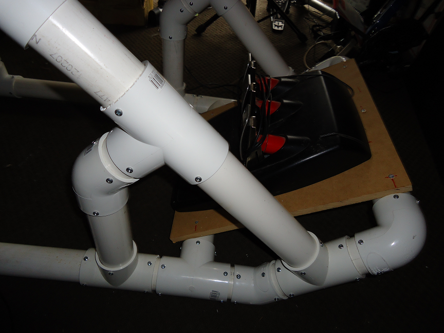

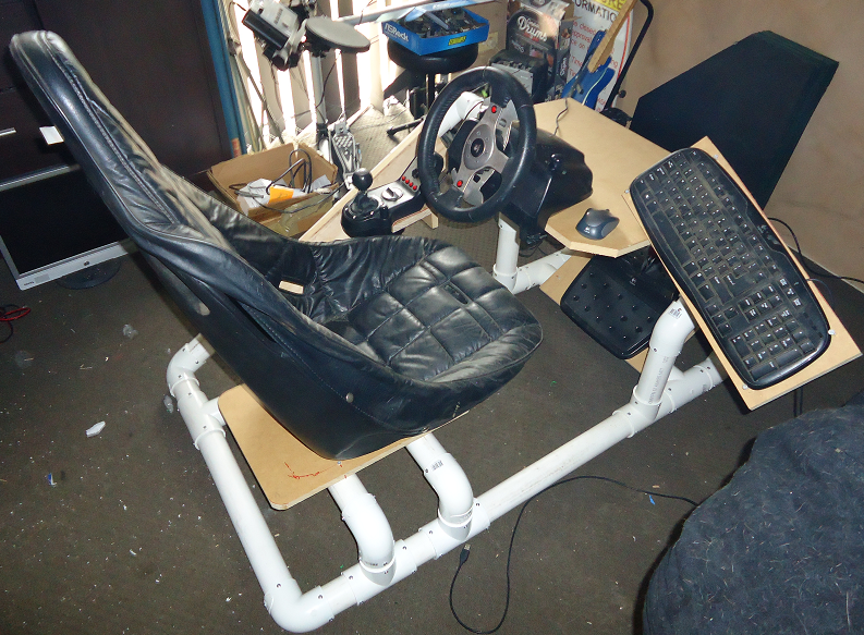

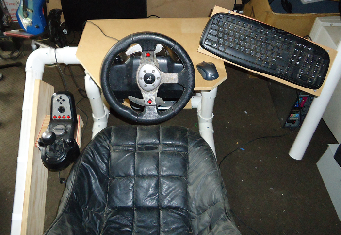

    Well after selling my sim over 12 months ago, I was leaving the sim world because of reasons I wish not too discuss here. All in the past now.
    So I discovered on InsideSimRacing a static PVC rig that looked like what I needed to go back to Sim Racing, not happy with existing software on another site , I had lost the interest for motion and just wanted to get back to my beloved and missed online race world, where I have met many friends in the past.
    http://insidesimracing.tv/forums/
    Simul8r PVC rig that I copied.
    http://insidesimracing.tv/forums/topic/681-simul8r-rig-2-pvc-schedule40-mark-ii-plans-on-pg-9/
    Look to page 9 for the plans he has kindly supplied.

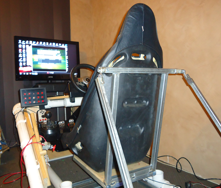

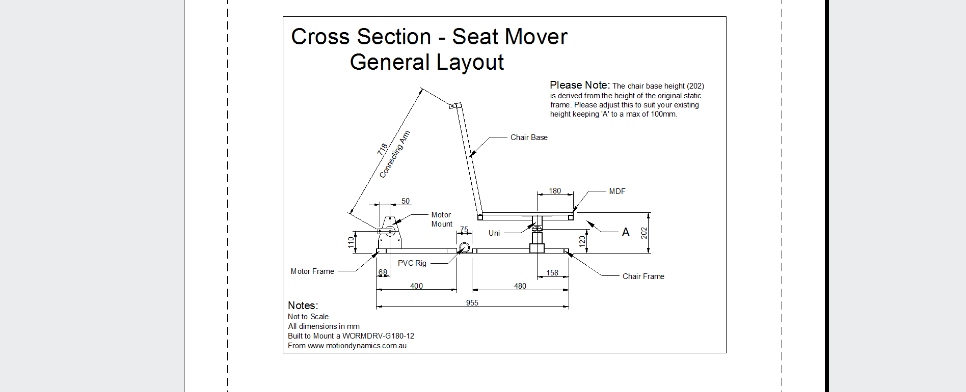

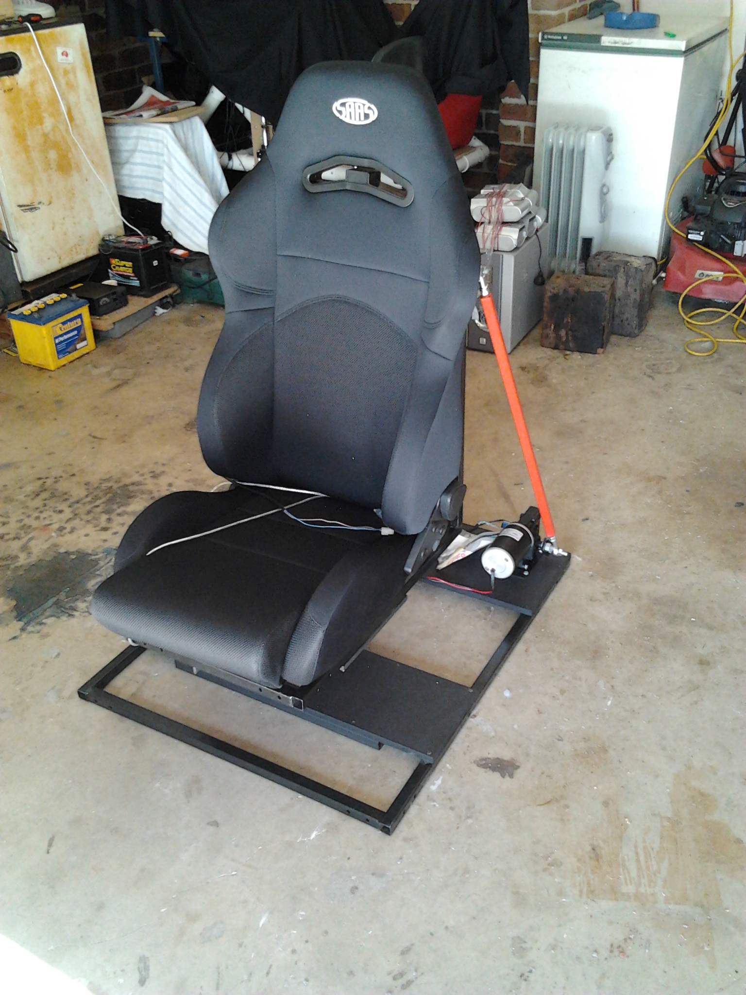

    So I went ahead and built a Seat Mover to add into my existing static frame.

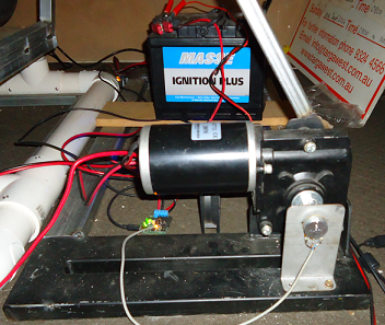

    Ok as you can see a simple 25mm box frame , using motor from Motion Dynamics and driven by Jrks powered by a 12v Car battery, fairly simple setup, Total cost of static rig + Seat Mover = $830. Fairly cheap compared to the motion gained.
    Here showing Seat mover placed over existing static rig.
    Showing motor setup, note Jrk not house as yet and testing single turn pots connected directly to the motor shaft.
    Ok I know I have not gone into detail, Document being produce thou. Thought I better show what I am using to test Sim Tools and to show I still know how to setup and fine tune Jrks. Well good to be back at it.

    Ok here's a video of my son running in Grid2 to show the range and speed of movement achieved.
    More to come.
  5. bsft
    vvvaaaaarrrooommmmm!!!!
  6. eaorobbie
    20,471Coins
    +1,686 / 23 / -2
    Now with the son on the sim, his bigger than me so a good test. Camera placed on top of the chair, to show vibrations and movement cues.
  7. eaorobbie
    20,471Coins
    +1,686 / 23 / -2
    Yes another video of motors in action. Wanted to show all angles of sim.
    Running Jrk12v12 with unlimited amps in jrks settings, very controllable with no overshooting or undershooting.
    People have been having mass problems getting these to work under Xsim, well change software.
    They work perfectly and have been proven on several different machines.
