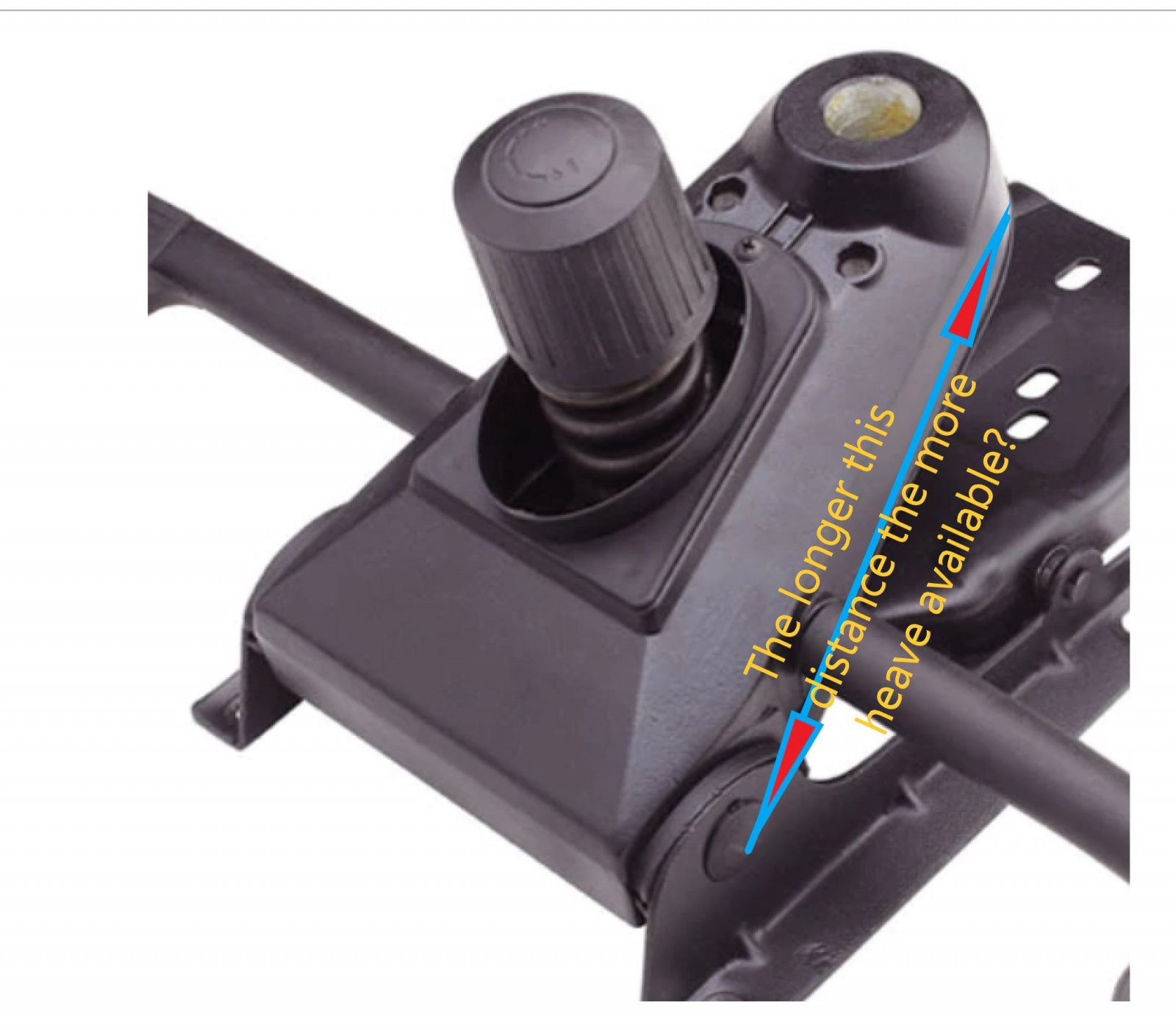

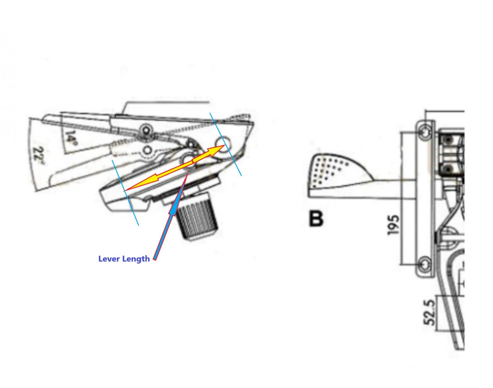

    ok thanks. I studied that pic and it looks to be 75mm but nothing to reference it against.
    The mechanism may be here tomorrow and I will see if it can extend that far.
    The one similar to yours is about $60 usd but there are no real specs on it..
    Amazon had one on sale (different model/style ) for $20 :o:
    22,208
    154,711Coins
    +11,212 / 57 / -2
    I am sure it is significantly more than 75mm, at a guess likely twice that.

    I think I finally got my head around this. That pivot point on the Tilt mechanism determines the amount of heave available..

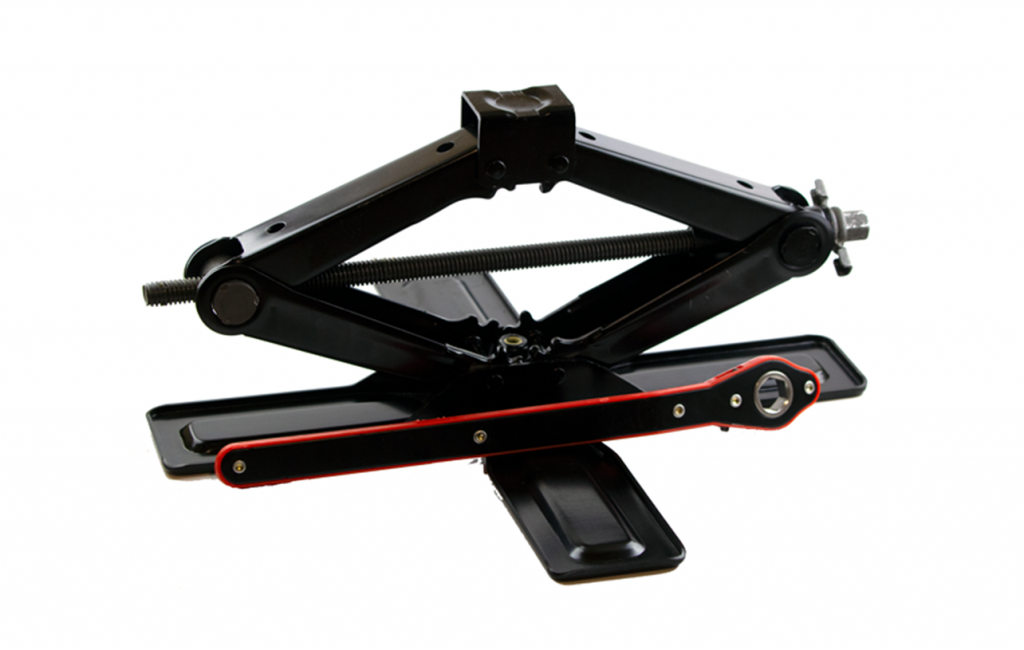

    Ive also been thinking of using a car cross jack (removing the inner rod) and mounting springs either inside or one on each side. Of course the tilt i may be easier to do cheaper but this would go straight up and only cost about 20$ so then its just finding the right spring. What's you opinion of it in relation to the other components?
