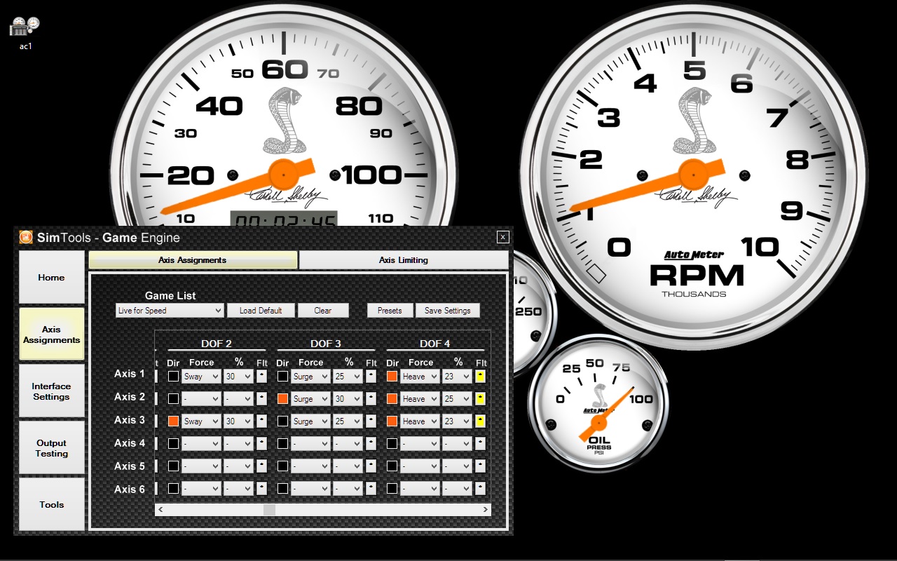

    What is needed to dial in a motion profile can differ quite dramatically. For example these are my current setting for Assetto Corsa, I use 5% smoothing on the rear heave Axis 2. Note I am using all 3 motors for heave and also for surge. It is likely hard to see in the videos but with surge the rear motor actually pulls the seat back and pushes it forward a small amount because of the arc of the heave knee.
    The settings for heave are dramatically different for LFS, there I am using quite a bit of boundary limiting for heave and much less allocation on the rear Axis 2.
