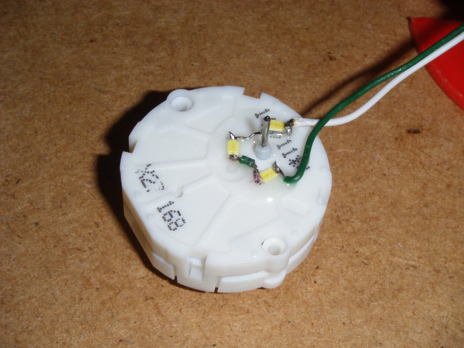

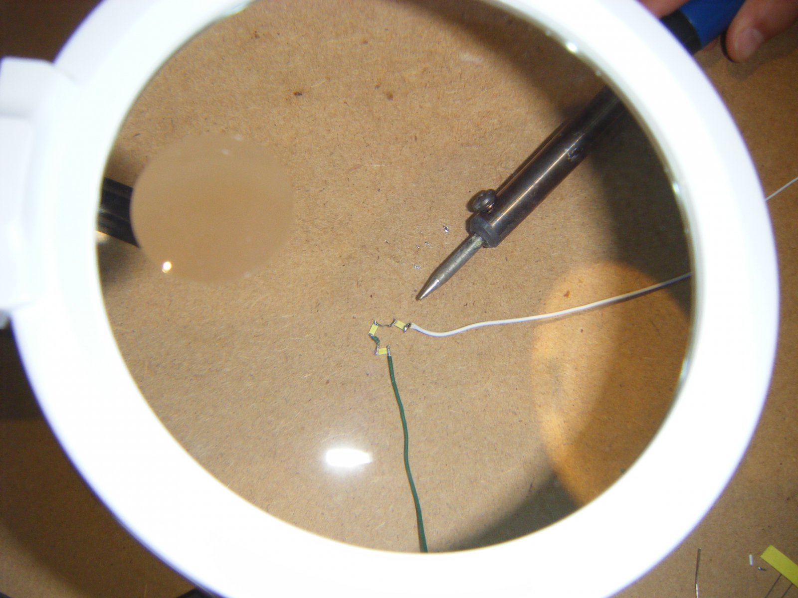

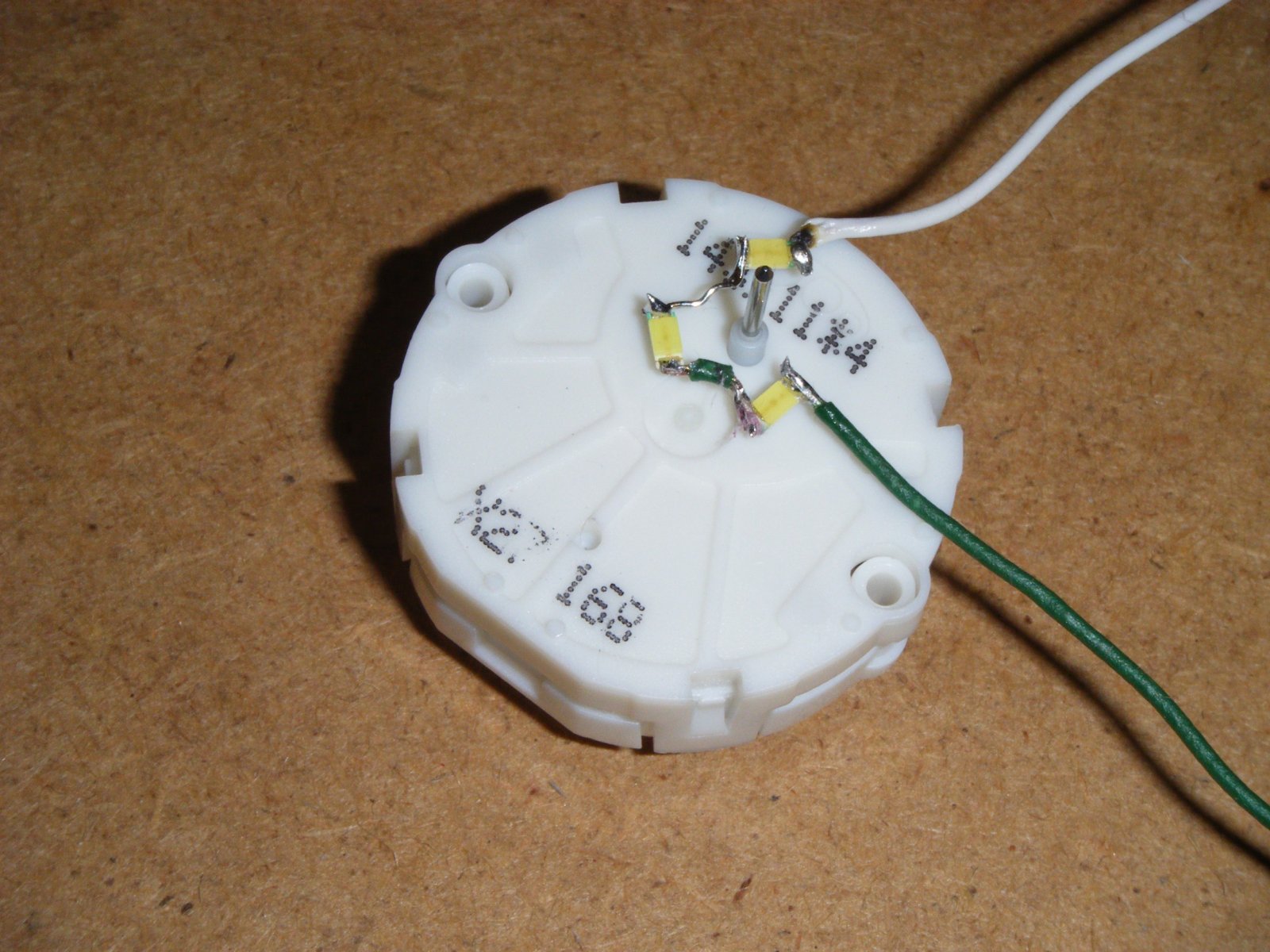

    Some progress:
    the LED are VERY small!
    I had to keep the previous LED under a wet tissu to prevent desoldering... when I soldered the next one... :mad:
    and it's fragile, i will need a round support:
    for the first one, I glued it! with bi-components glue
