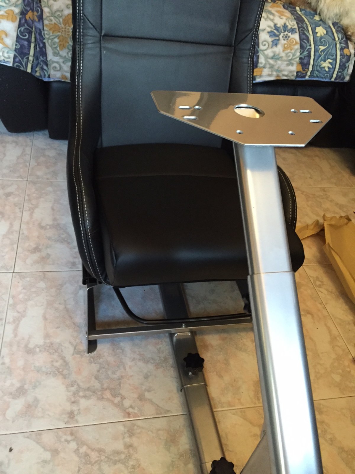

    For 24volt motors up to 120watts I would suggest this:
  3. Pit
    3,012
    30,482Coins
    +3,097 / 31 / -0
    I do not see a problem to build a seat mover using the commercial racing seat ;)
    I was a little cautious abut the specs, 120W should be OK as well but you never know the peaks can shut down a h-bridge even if the motors are less current rated.

    I know ... I bought MDF, if I can use MDF for furniture ok
    or try with the platform and when I see that at least moves
    I can think of design as your very top!

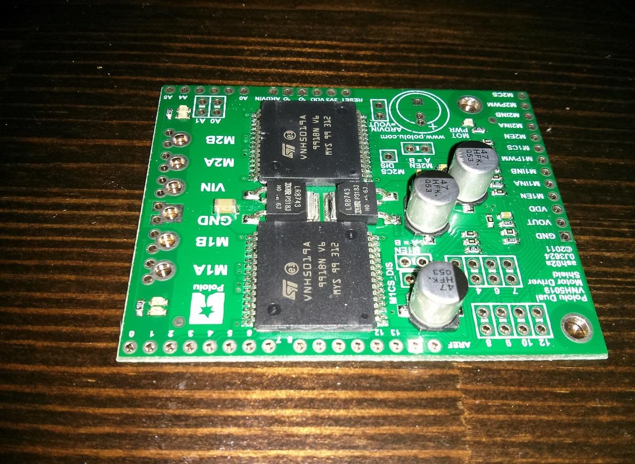

    If you check my thread I use the dual vnh5019 on my project with 12volts supply(12v=more amps ~2x).
    I never had any issues with the h-bridge.
    But i have to confess I was skeptical too.
    I didn't think it could be better than a motomonster if you consider the price difference.
    But if you check the specs...
    20amps @ 24volts (500watts) per channel should be ok for "several" secs
    And
    30amps @24volts (750watts) fos some milisecs
    should be OK for stalling a 5amp@24volt(120 watt) mottor.

    I am not talking about the specs, and I use them on 24v. I share my experience here which shows a significant less powerful bridge than expected by the specs you quoted.

    I am sorry. I must have missed the part that you have used the dual vnh 5019... just saw the picture.
    The info that you post is very interesting though, because the numbers I quoted are not suposed to be theotetical specs but real-life test results that pololu "claims" that they have done...without heatsinks.
    Of course real life experience is always more useful than a bench test.

    I tried the vndh but as I understand it these cards are to be assembled or am I wrong ??
    I ask because I want a simple solution is to connect you to configure ..
    thanks again for the valuable advice
  11. Pit
    3,012
    30,482Coins
    +3,097 / 31 / -0
    The Dual VNH5019 are assembled by default, you have to stick the cooler and fan only
    https://www.pololu.com/product/2507
    ..and to connect to the Ard, of course.

    then immediately buy a fan , and I did not understand a heat sink too ? @Pit
    It exists here on the forum explanations for this configuration ?
    I would like to understand the connections between Arduino and Pololu ..
    and how to configure it for simtools ..
    excuse the many questions
    so I can see it thanks
  13. Pit
    3,012
    30,482Coins
    +3,097 / 31 / -0
    heat sink is even more important than a fan...
    The FAQ section is your friend...look for Arduino (I can advise to to try out the SMC3 code), the wiring is described on the Pololu page itself. If you have all gadgets together I can help if you struggle, but I do not help reading all needed information.
