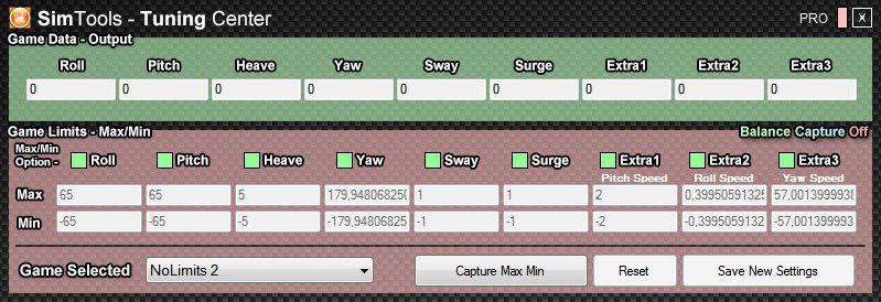

    Does it work with no limit demo or do I have to buy the game? Also PC plug in vibrates crazy when the game starts and movement doesn’t match the game. What should I do? I use rift. I tried PC UDP, UDP FOR PC
  3. Radioproffi
    May 15, 2014
    136
    Lviv
    1,620Coins
    +88 / 1 / -0
    Did you change MAX/MIN value in Tuning Center?

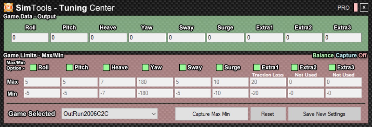

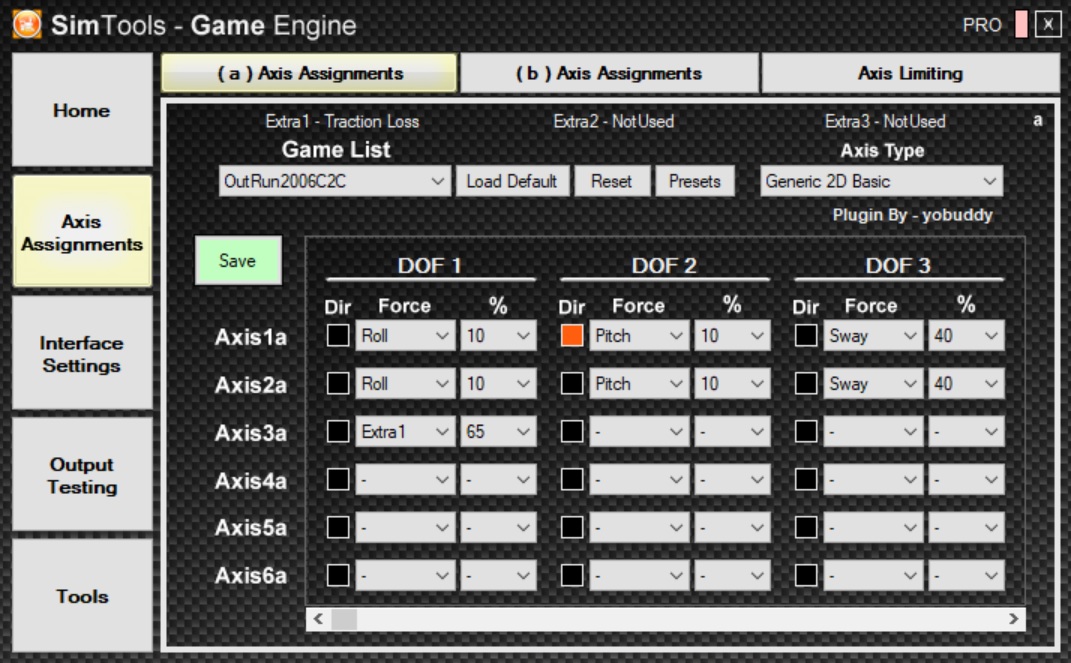

    Sorry, just noticed that this is the thread to upload presets and profiles for DOFReality rigs.. I'll repost this here:
    As a recent H3 owner I'm still easing my way into SimTools. After some initial frustration with "why don't things just work.." I thought I share what I have learned with my preset values for OutRun 2006 (you can find the game free on google at the time of this writing). This game is best played with a wheel set to about 200 degrees of rotation (even if your wheel supports 900 or 1080 degrees you can change it in the control panel or in your wheel's setting app). Please note that the axis presets are similar to the Dirt4 presets included by DOFreality. I've also shortened the min/max values within the profile to give more of that arcade feel.

    I tried this plugin and the tuning with my P3 but it doesn't move. Did I do anything wrong? Btw, I just tried with the No Limit 2 demo version.

    For some reasons, these axis assignments are not very accurate with my P3. It moves all over the place.
  10. Petrus_SM
    Petrus_SM New Member
    Apr 22, 2017
    13
    Hotel Night Manager
    Melbourne, Australia
    276Coins
    My bad I forgot to save it. It actually works like a charm.

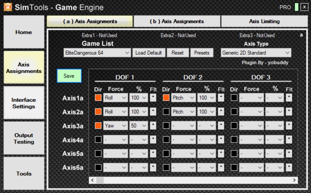

    Can anyone share their presets/tuning for Elite Dangerous?
  17. nilzilla
    nilzilla New Member
    Feb 12, 2018
    12
    US
    207Coins
    ED is still not every playable. The issue is with the current plugin/patch it seems to read joystick/KB input values and small and quick joystick movements causes a whiplash effect on the motion rig. I'm including the axis setting I've been using to for ED, I've since given up on trying to tweak it. Hopefully you'll have better luck than I did.

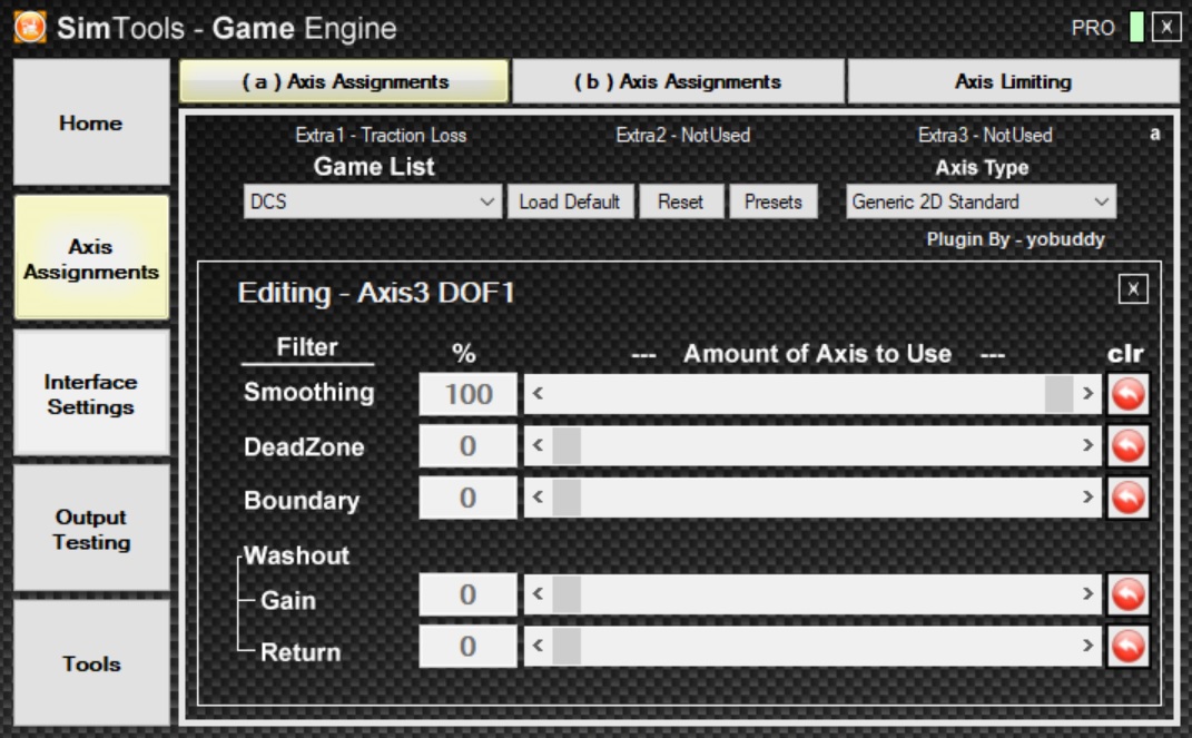

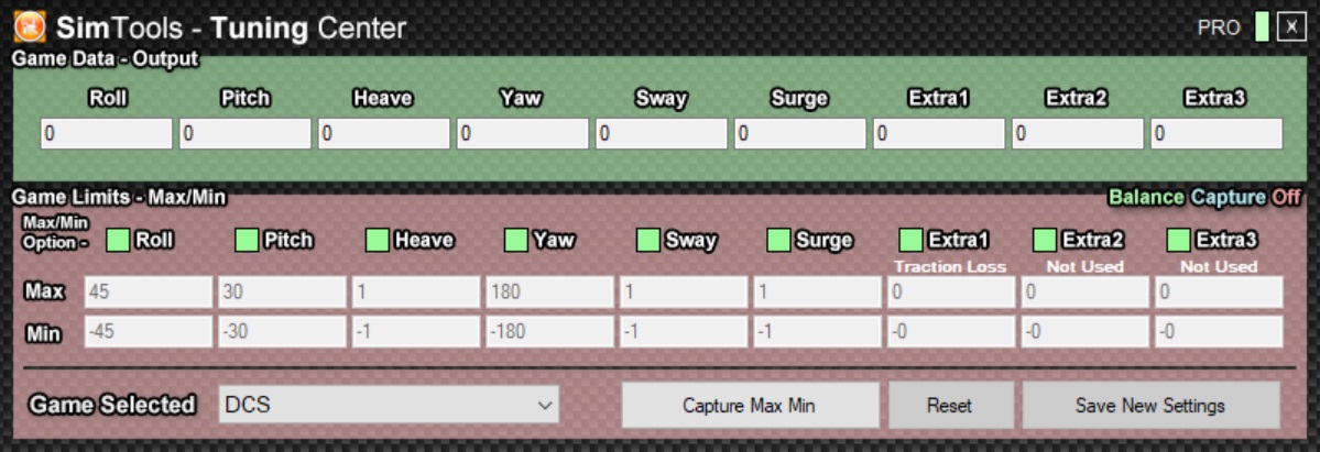

    Adding my presets for DCS, please note that this is using standard axis type for the extra filter options. I've found it to be needed for some of the propeller planes when they are on/close to the ground as their shaking "effect" causes unwanted wear on the motion rig. Also, try to avoid doing barrel rolls as it snaps the motion axis to the other side... Also as a side note, from experimentation I'm choosing the Sway output as the Yaw axis. I've found it to be a better representation of that motion axis from the available range out outputs.
  19. nilzilla
    nilzilla New Member
    Feb 12, 2018
    12
    US
    207Coins
    To clarify, I've added 100% smoothing to Sway (Axis-3 of DOF1) as the TF-51D plane in DCS will shake the 3rd DOF motor on the DOFreality H3/P3 rig when its on the ground. For roll (axis 1 and 2), I've also added 5% smoothing for good measure, but really haven't felt much difference there.
