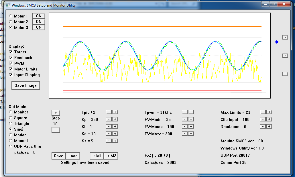

    I dug around and found a motor calibration video that helped. My 2nd motor was slightly off on the SMC3 graph, but apparently, that made a significant impact physically.
    I calibrated it and it now returns to parked correctly. YAY!!
    There was also the default SMC3 setting included in the video and I noticed they were a little different than mine, so I changed them and it really smoothed out the motion even further.

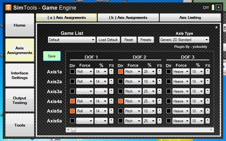

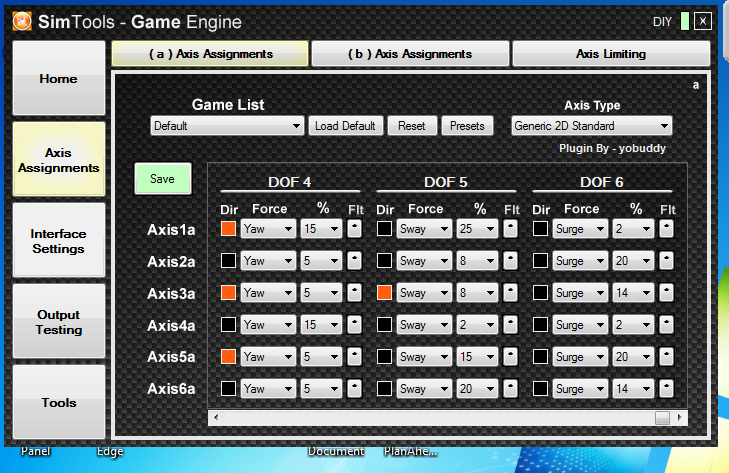

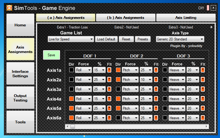

    Hi, sometimes my bike won't return to its original position (this doesn't happen often). I have attached the settings in the game LFS (Axis3) and SMC3 for motor 3. I don't see anything unusual at the SMC3 window. Please give me advice. Thank you.
  13. HoangBuidof
    HoangBuidof New Member
    Apr 15, 2021
    15Coins
    Arduino, 6DOF
    Sorry, I sent the wrong photo. Stay tuned for my updates. Thank you.
