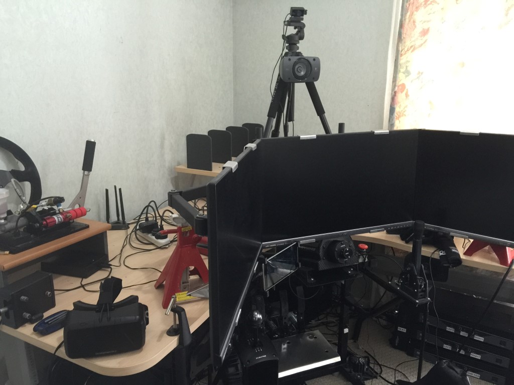

    Having actually tried a DK2 mounted to a five axis motion platform, the issue is with very fast movements of the rig causing oscillation of the DK2 tracking camera, which basically causes the camera to lose sync with the headset. One way around this is mounting the tracking camera off the rig, unfortunately if you do this then the actual motion of the rig is reflected in the DK2 which can sometimes be off-putting. The Motion Cancellation that is being talked about above is about removing this 'unwanted' motion by tracking the rig and subtracting that motion from the real game VR motion. From my experience if you get this right it actually reduces motion sickness as the motion of the rig matches what you see. Hope this explanation helps:think.
    As I don't expect this Motion Cancellation issue to be sorted out any time soon, for my new Sim I have developed a mounting system that isolates the camera from these high frequency oscillation's, allowing it to be mounted back on the rig.

    Ooh! I'd be interested in seeing your isolation system for that camera! I'm going off rig at the moment, because, as you say the camera vibrations, play havoc with tracking. Literally throwing you out of the car in both assetto corsa and Project Cars. If the camera was on the rig, it would help.
    Wierdly it seems worse using the 6.0.1 runtime than it did with the version 5 runtime.

    Has anyone looked into using gimbals or vibration dampers to mount the camera to the rig? Something like a steadicam might work for reducing vibrations.
    I'm still not decided as to which VR platform I'll be buying, but if one of them has a generic motion cancellation solution that'd be awesome.

    I have got a powered gimbal and 3 Axis Gyroscope+Accelerometer for an Arduino to try out as an on-board camera stabilizer, but work projects are taking priority at the moment and to be honest I don't use large axis movements so the camera off the rig is actually OK.
    I suspect a powered gimbal mount would be the way to go with something like a 6DOF rig.

    I would be very skeptical that soft material or weights would isolate the Rift camera with rigs that are capable of 300-700mm/s.
    Sorry @Tim McGuire I can't properly measure mine at the moment, as I just got 2 brand new HP PSUs today so I am starting to pull it apart among some pressing business priorities.
    I do know the heave knee on my sim has a total of 10 degrees of travel from full up to down, though I don't use all of it. On the other axis I am using about +/- 8 degrees. I would think anything over +/- 6 degrees with adequate speed and a good motion profile would feel pretty good. +/-10 with a Rift should be plenty.
    I don't know exactly what degree of movement it has but @SilentChill's old rig is about as far as you would reasonably want to go in VR:
