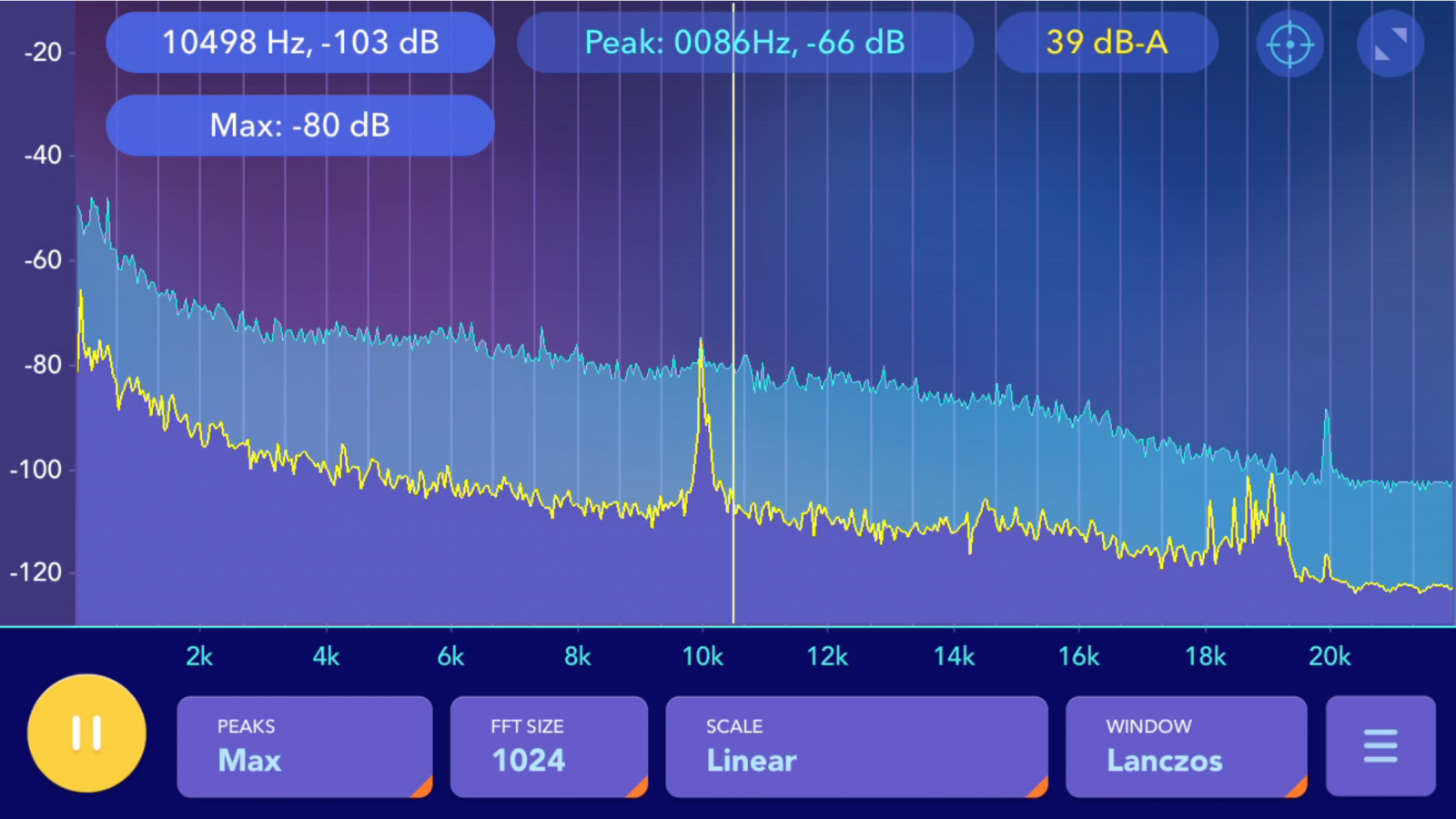

    I've been interested in building a rig for a while, and am currently visiting my brother, who has a SFX. This thing is producing a noticeable (to me) 10khz whine. After 5m I have to switch it off and the whine remains in my head for an hour. It's pretty painful and I rather wish I was one of those that wasn't this affected by it. Tears.
    I'm aware most people just put up with it, but for me, I don't think I could build one if it emitted that noise. Doesn't stop me from wanting to tho!
    So the quest begins:
    1) Are there actuators and drivers that don't exhibit this whine?
    2) If not, are there are at least actuators that don't produce it? I can relocate the drivers if needed.
    My main concern isn't cost... but I'm not sure I want to go to the dbox level of not-concerned-ness.
    Speaking of which; that's the kind of rig I have in mind. 4 actuators (I have a P1 rig). Some kind of AC driver(s).
    I've emailed PT-Actuators to ask them (the PT16 4DOF kit). Not sure what their AC driver is... but they do seem to supply one from what I can tell on their site.
    For reference, here's a pic from "Spectrum" running on an iOS 8. I know the mic is probably rubbish in a phone; but it gives *some* idea I hope of the level of 10Khz I'm talking about.
    https://www.dropbox.com/s/uokzezflmoohkwf/10khz Goblins.png?dl=0

    smarter People than me will confirm yes they do exist but generally theres a price premium , these ASD15 servo drivers are great but meant for different market , in saying that they have also been victim of there own success in the DIY sim motion niche , cheap enough to make them atractive for our use but downside was internal design , cant fault it bang for bucks it does what it says in the spec LOL the 10KHz thing is the downside, thats if your sensitve to that frequency , bad hearing helps being older helps Bloody great earphone work though LOL :) but there may be light at end of tunnel as theres a rumor that manufacturer may be trying to correct this ..

    There is communication with the AASD servos manufacturer engineers, to create new design units with 15khz frequency carrier on the IGBT, but if that fails to go through, I already allocated another brand servo drive that has adjustable frequency carrier via its panel...
