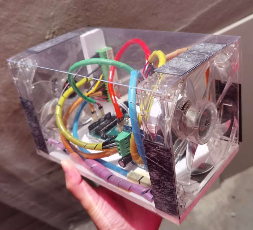

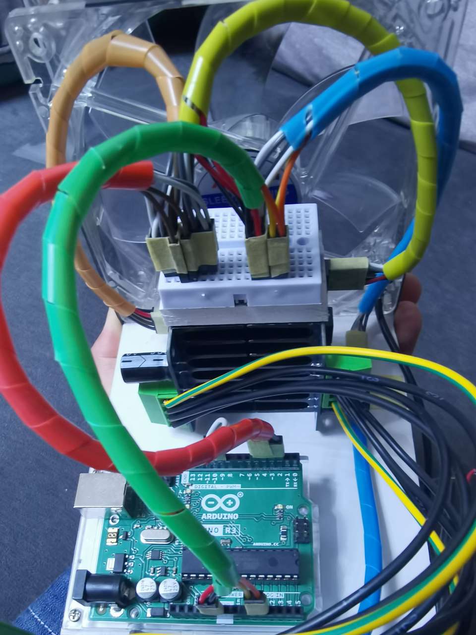

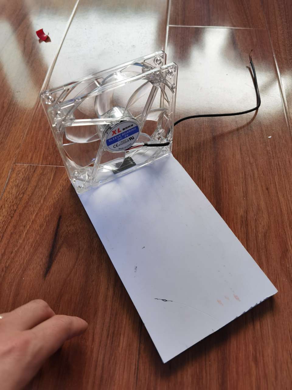

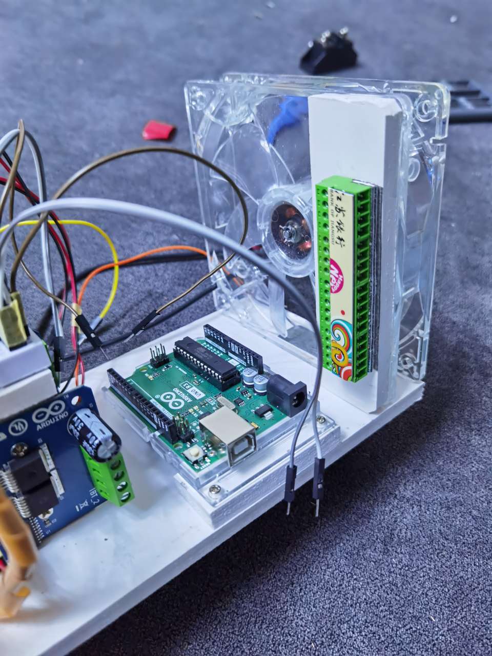

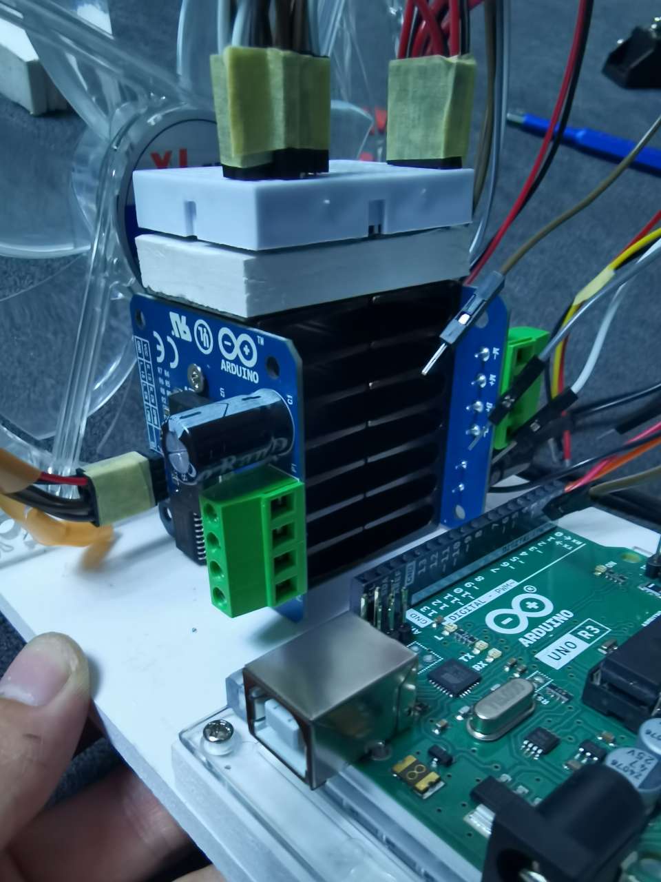

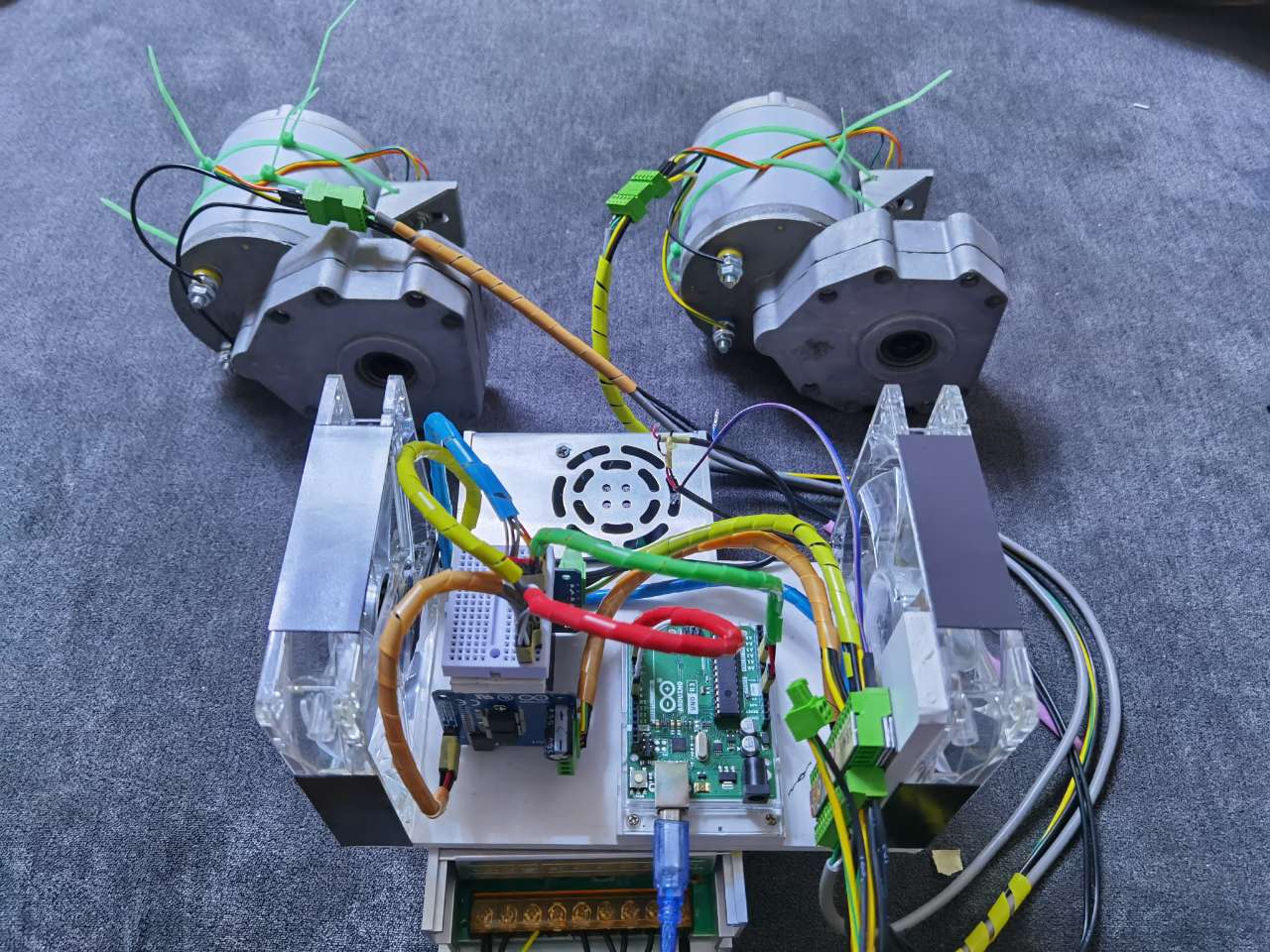

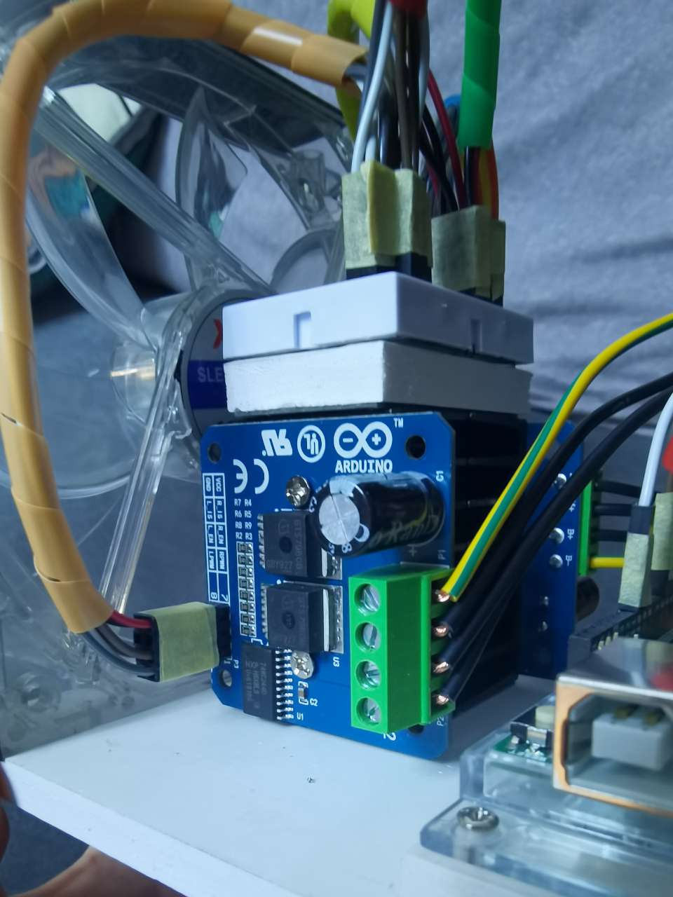

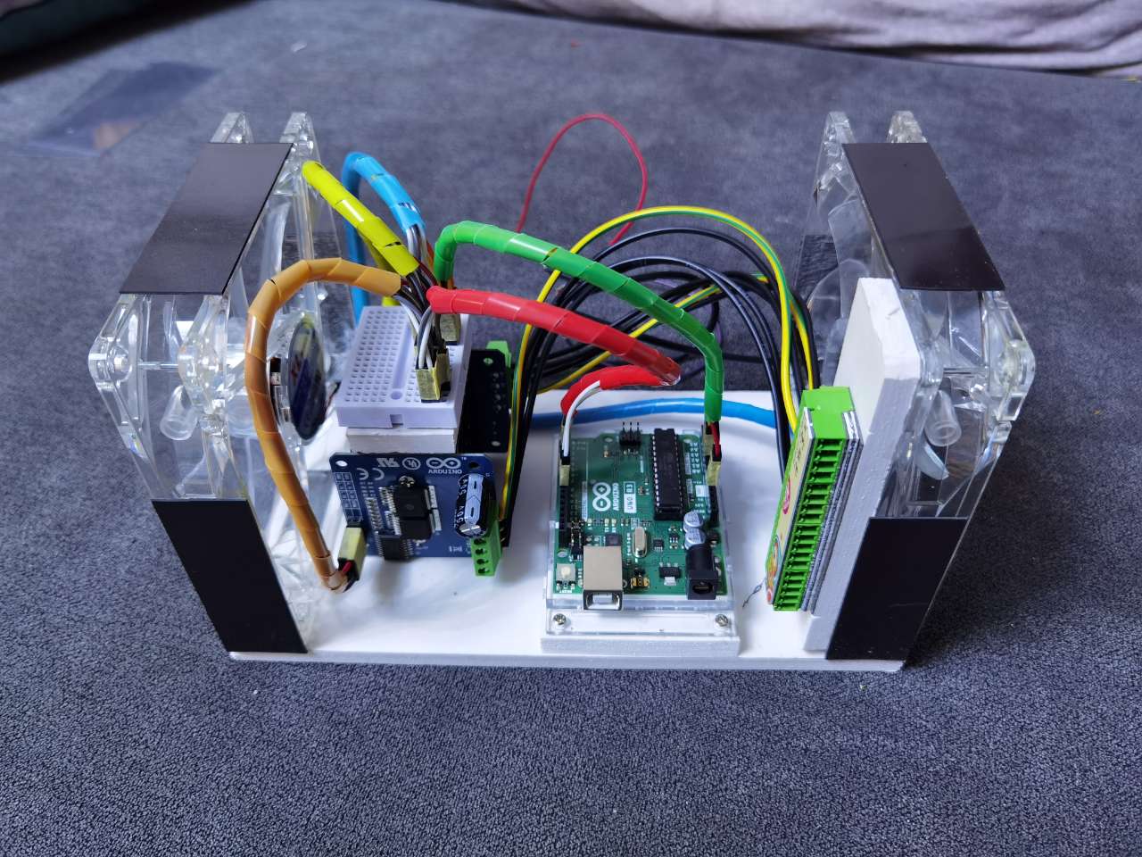

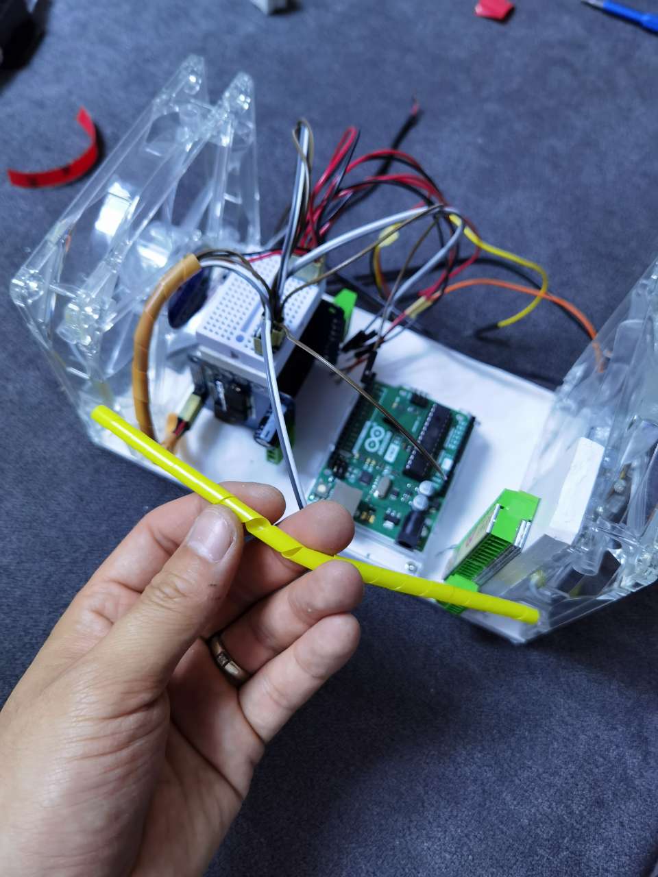

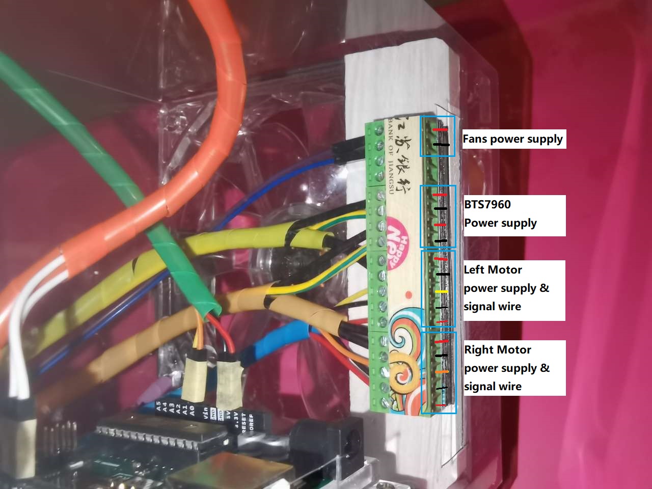

    1. first of all, I have to find a proper box to put these components. I tried to find a shoe box but failed, then I turned to another way. I found a 8mm PVC expansion sheet(some redundant I had ordered before) and cut it into 200x120;
    2. 2 cooling fans (120x120x25) from old laptop cooler were glued with hot melt adhesive on the ends of PVC board. Now the base is almost complete, let's call it control box.
    3. attach the Arduino UNO and BTS7960 boards(back to back) to the base, using 3M double-side tape and some PVC blocks, see the pictures in detail.
    4. a small breadboard(35x47) can be just located on the 2 BTS7960, using double-side tape. then connect the 3 PCBs with jumper wires, use papertape to group the pins on the breadboard. Cut some drinking straws, as cable pipes, to make the wires tidy.
    5. connect the plugs/sockets. Some quick connectors are used to make the control box a single component, and separate from lots of wires. In this way, it looks more tidy I think.
    6. download the SMC3.ino program and test all system, everything gose well except the wrong connection of left/right potentiometer.
    7. the 2 fans are connected to 12V power supply in series, so each of them get 6V, a little larger than 5V, I hope they will not burn out.
    After that I planed to use a paperboard to cover the control box, to make it looks like a box. But it looks not cool. Then I got an A3 card case. Tear off the transparent film, cut into (360+8x2)x200, bend it to be a cover of the PVC board, then open 2 holes for the connectors and Arduino UNO. see the pictures in detail.
    Then tear off the magnet sheet on the back of an A3 card case, cut into strips, attach to both film and fan body. Now everything inside are visible.

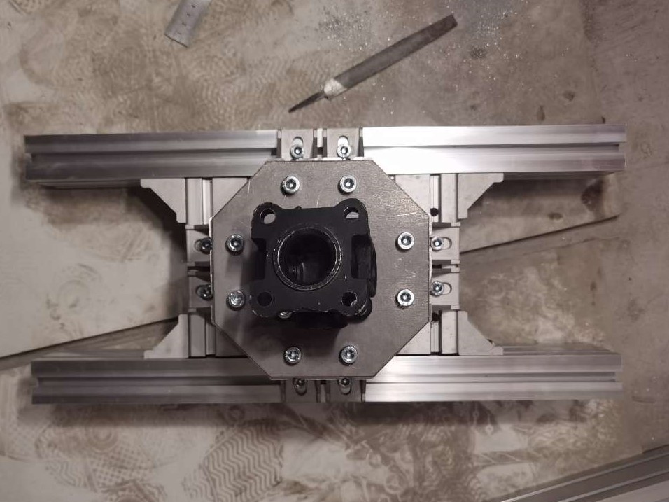

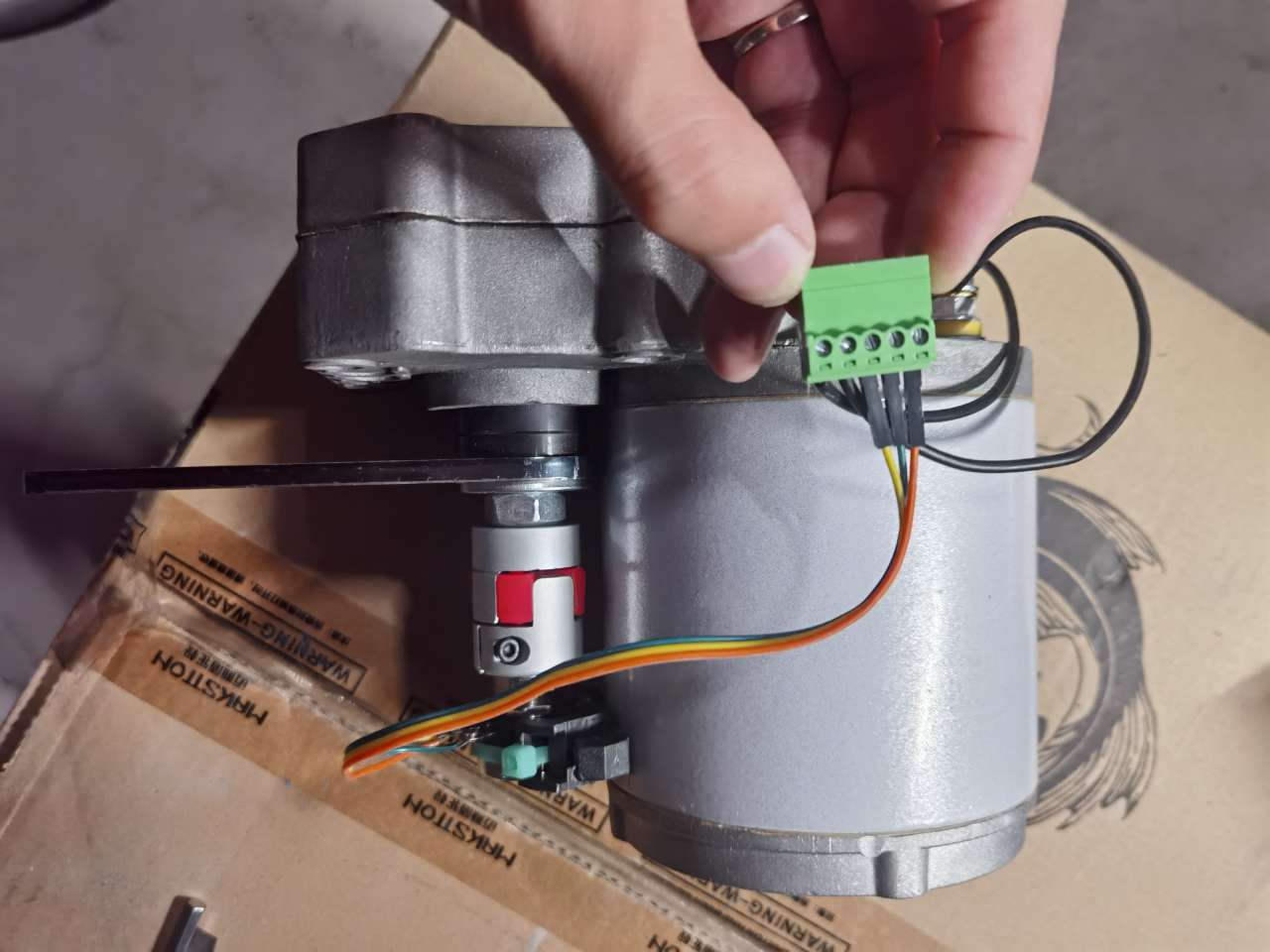

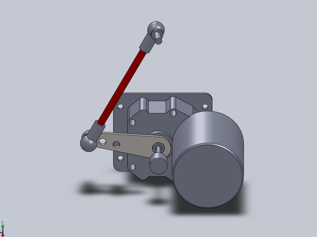

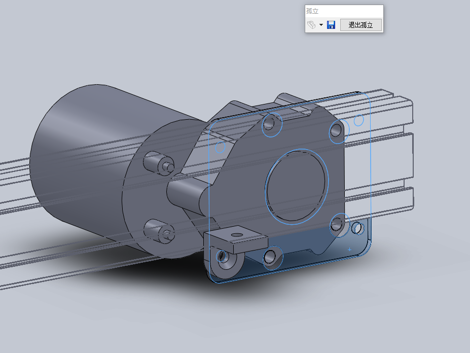

    PART 3. Drive system
    This part has to be associated with part 4 - frame design, otherwise you may go to a wrong direction.

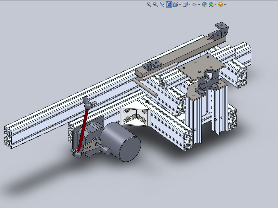

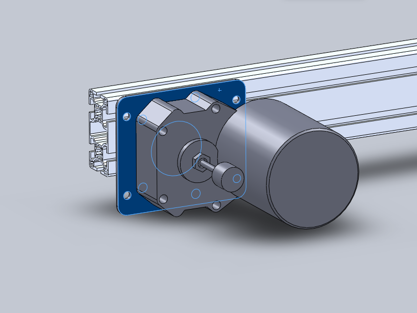

    Firstly, with help of a caliper, I tried to draw a 3D model of the motor, it will be convenient in following design.

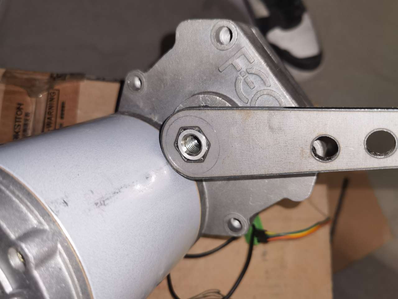

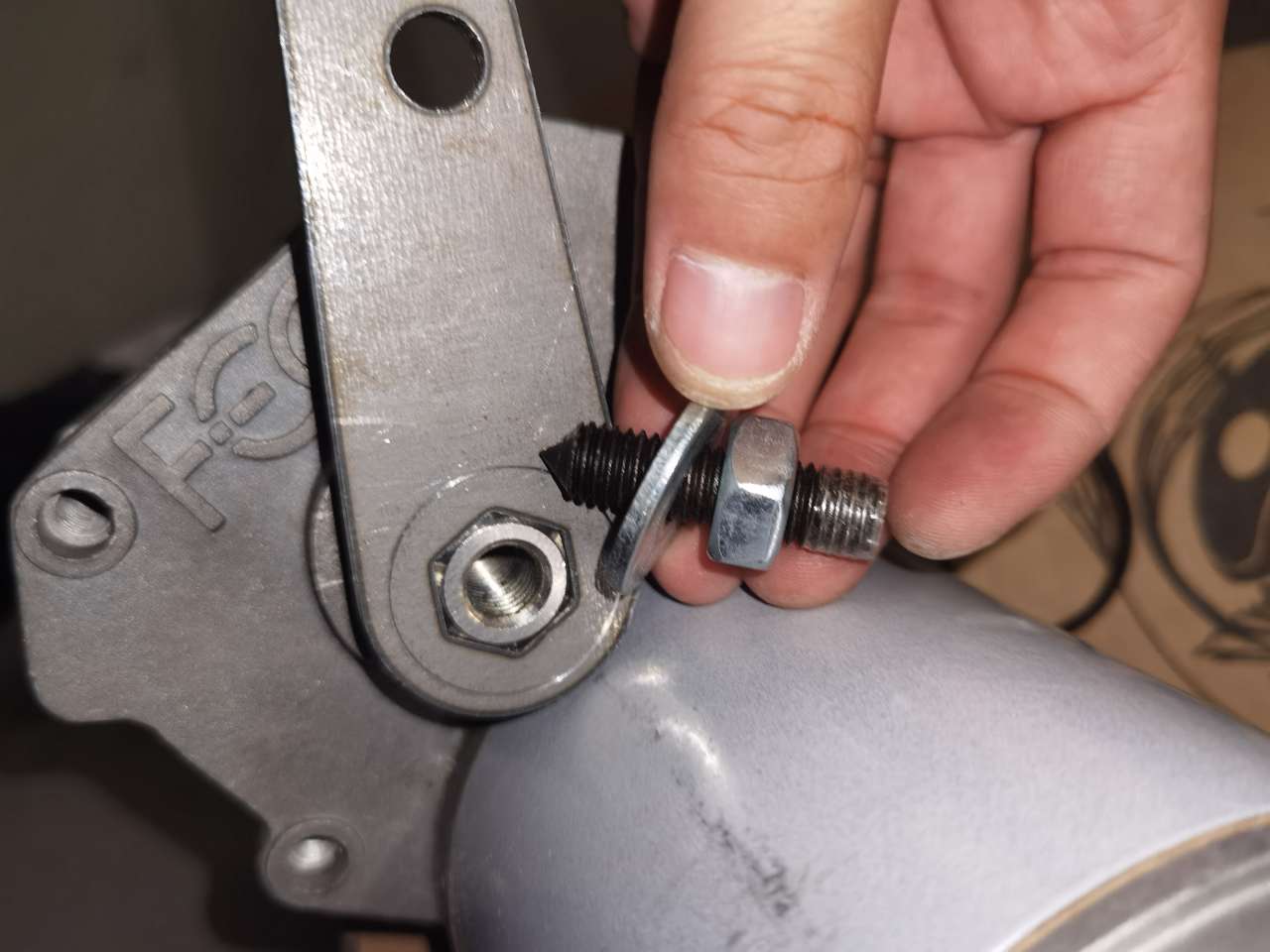

    Actuating arm is customized, 5mm sheet metal laser cutting. CTC is designed to 3 choices, 6cm/8cm/10cm, in case it cannot hold the weight of upper frame.
    the supporting plate is also laser cutting, to make it easily fixed to Al profile. Because I cannot find a good way to fix the motors in front, there is no enough space.
    The structure of my project is front motor, like DOFREALITY, different from rear motor structure.

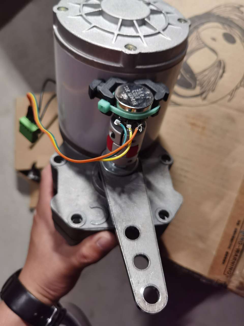

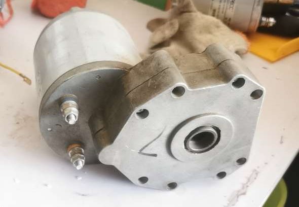

    Assembly photos of motor

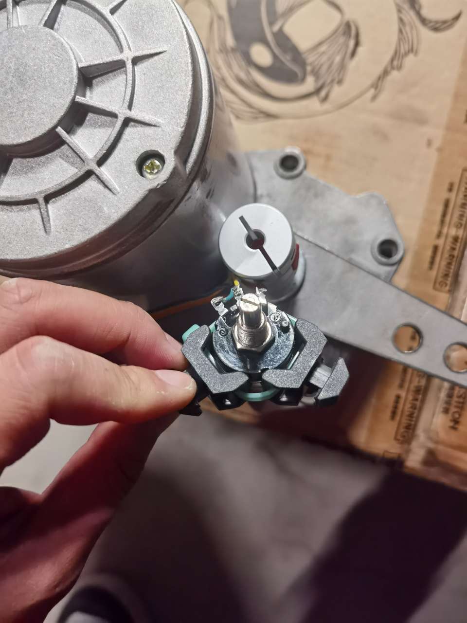

    The bolt connecting rod is pressed into the actuating arm, interference fit;
    Because the dimension of S16 hole is about 16.8mm, much bigger than dimension 16.0mm of connectin rod, it is too loose. I finally find a good way to fill the gap, insert half of a cutter blade into each surface of hexagon.
    the potentiometer is connected with a elastic coupling φ6mm / φ10mm.
    My 3D printer had someting wrong, the bracket has to be delayed. As short term action, I just tied 2 cable clamps on the cover of potentiometer to limit it rotate together with shaft.

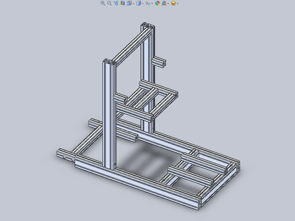

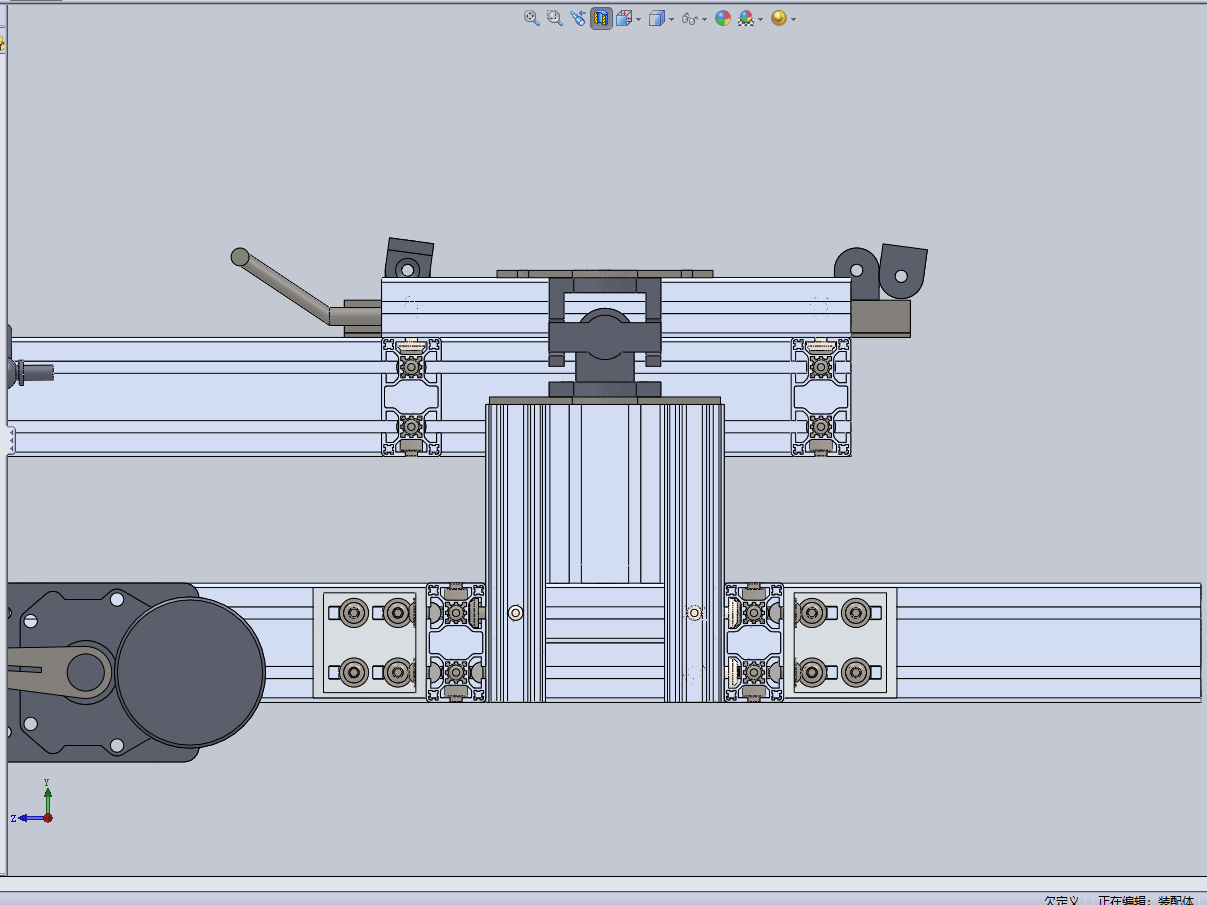

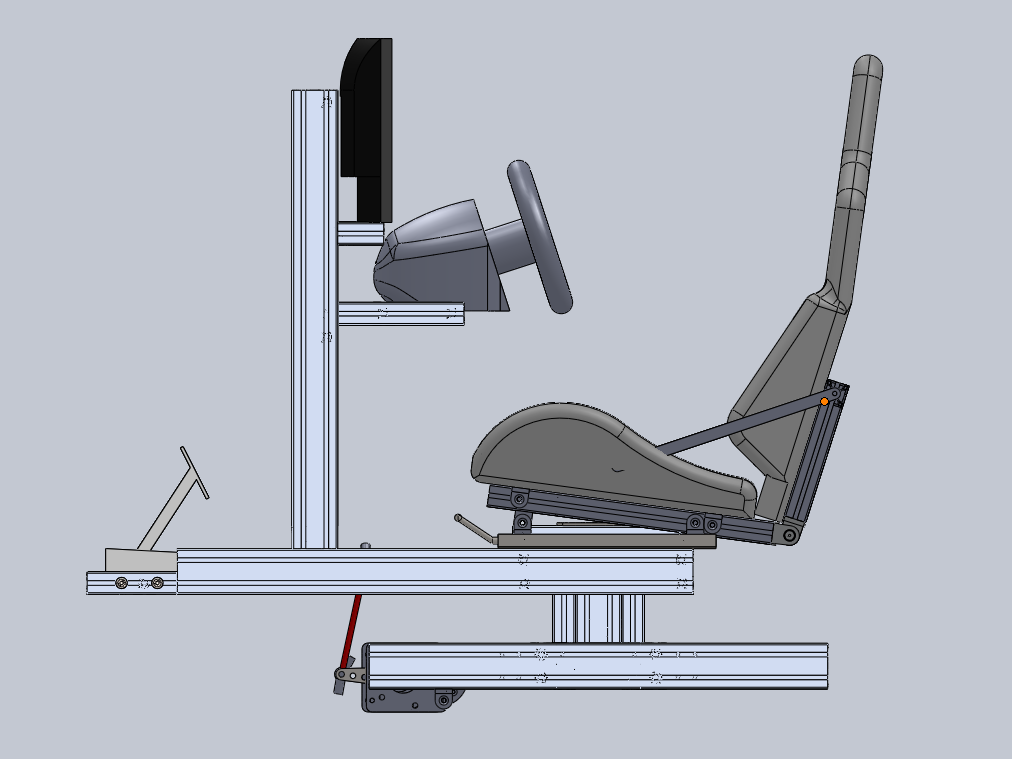

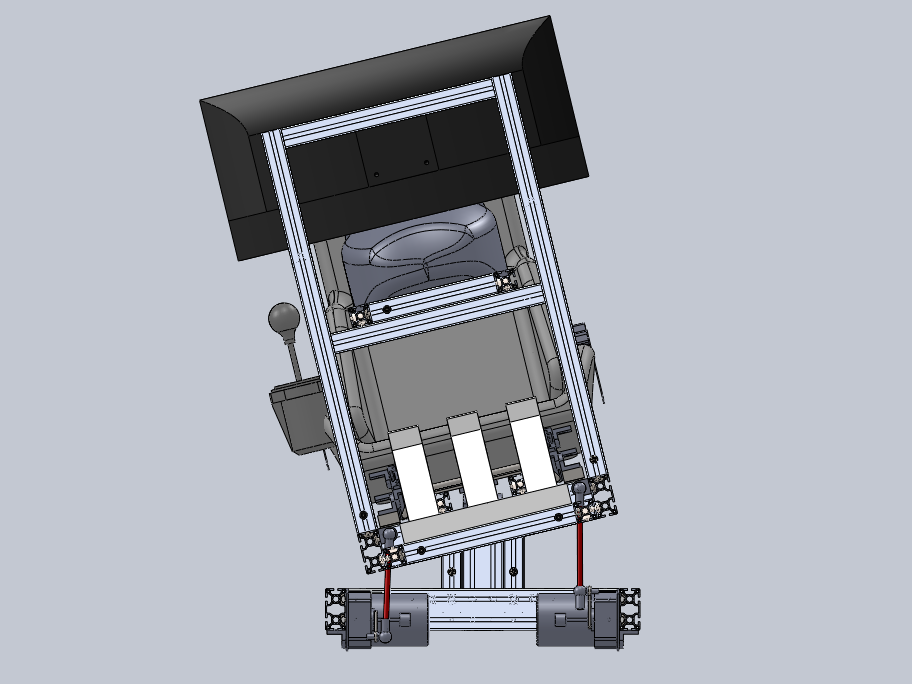

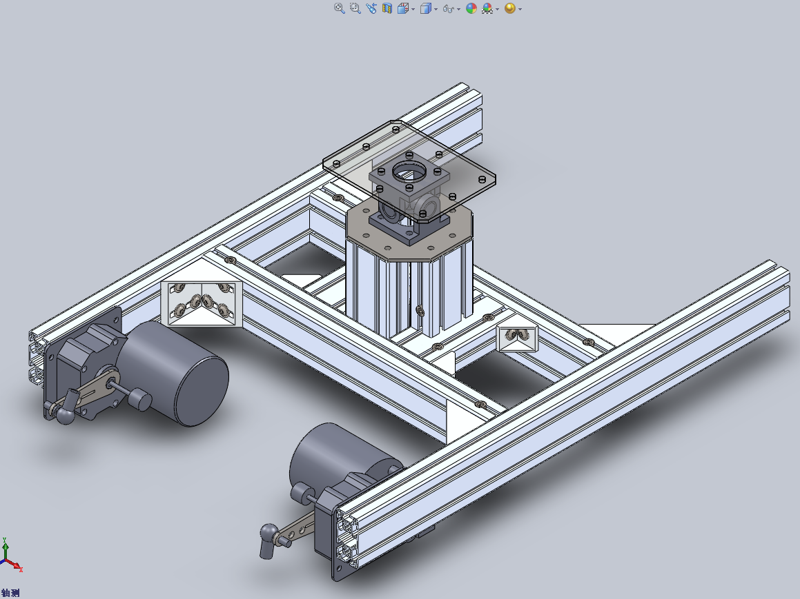

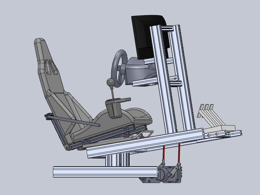

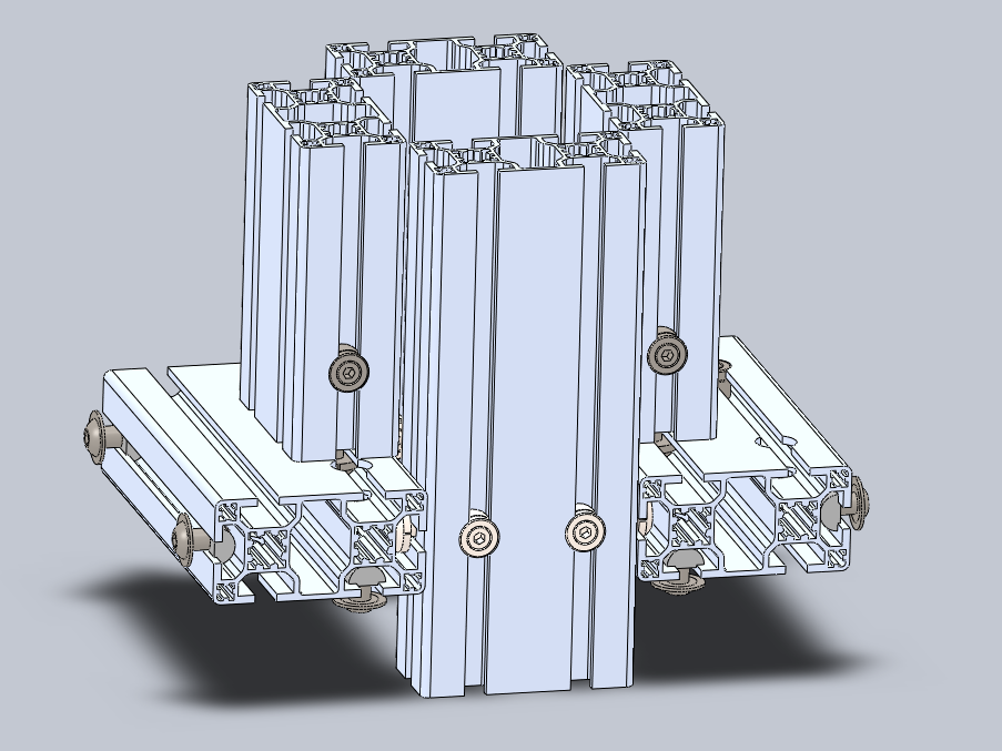

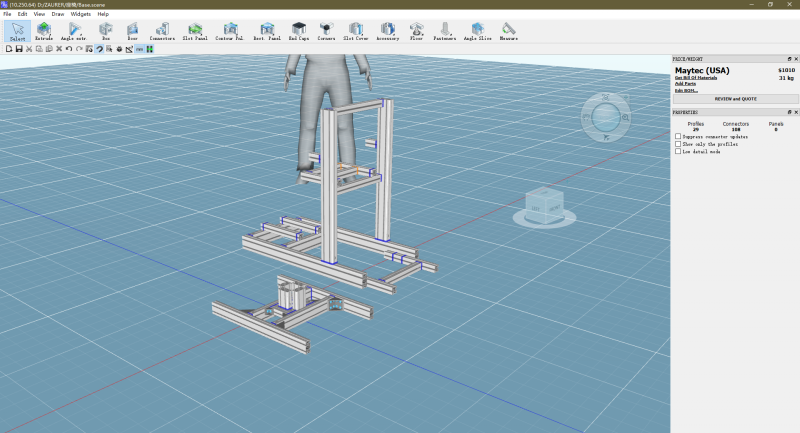

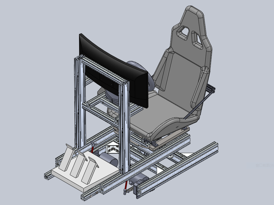

    PART 4. Frame design
    1. 3D drawings preparation.
    2. Self-learning of MAYCAD, it is very convenient to bulid an aluminum profile structure.
    3. Export to Solidworks for further assembly, simulation, and check.
    this is the main processes, and let me share some detail.
    Some preparation.

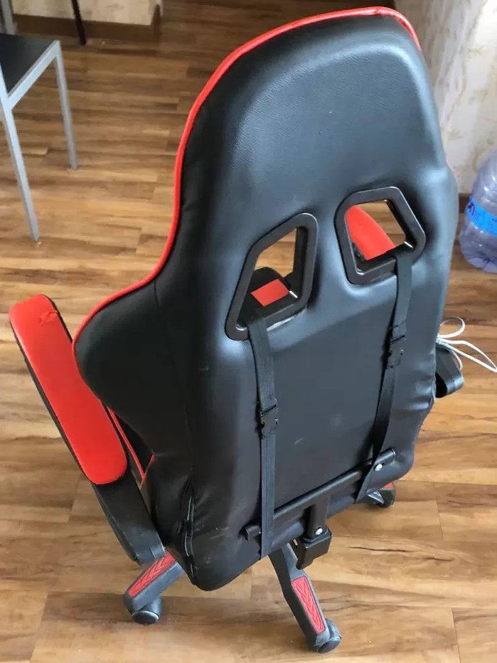

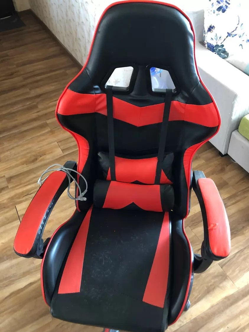

    a second-hand gaming chair for only 80 RMB( $13)
    a joint from Taobao, size 75x75x80, it looks really small (I hope it can hold the me and upper part, to be tested).
    Thrustmaster T300, ordered years before.

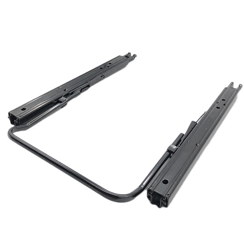

    and a seat slide rail from Taobao.

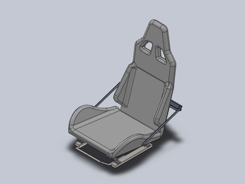

    3D drawings of actual parts will help the design process.

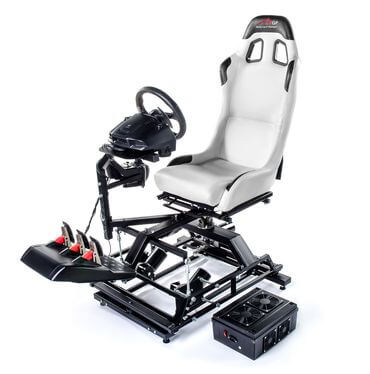

    front motor can save a lot of space, it is much shorter than rear motor. Refer to Dofreality seat frame.

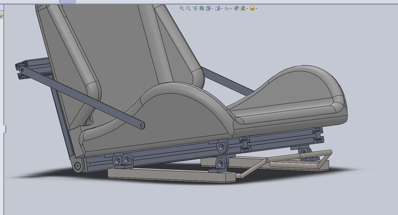

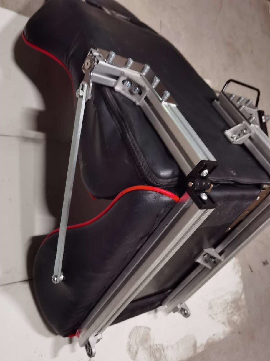

    It is the main reason why I choose it. Also, it uses less profile. I choose 4040 and 4080 profile, strong enough.

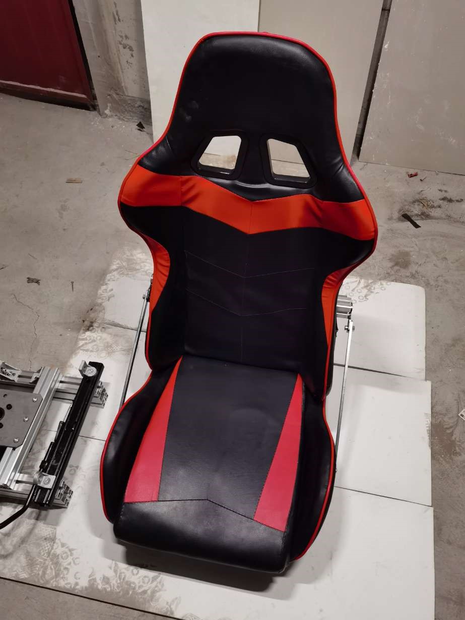

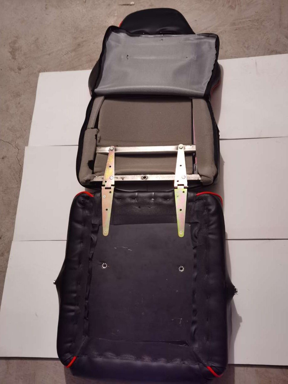

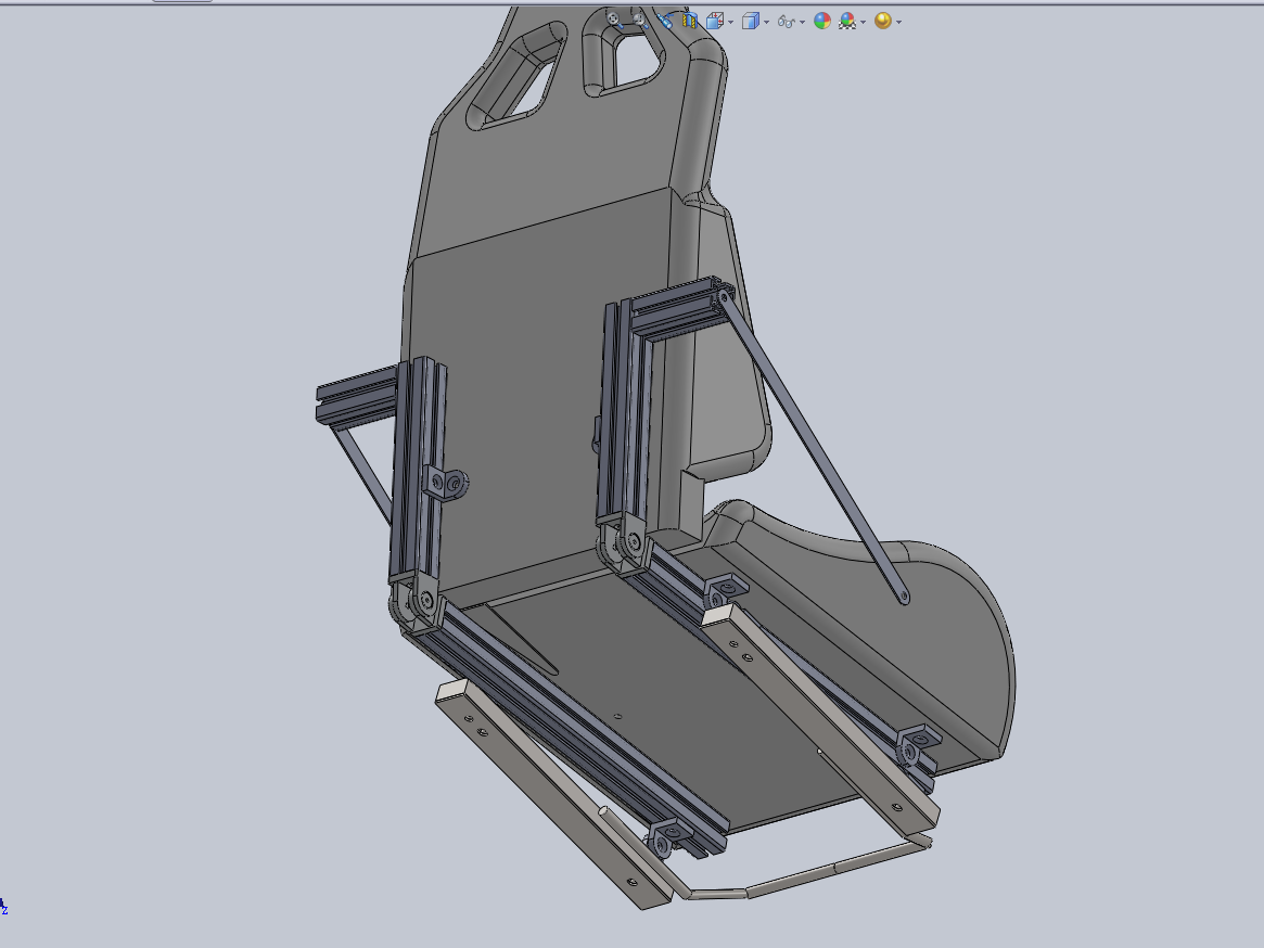

    the cheap gaming chair spent me a long time to retrofit, just for your reference.

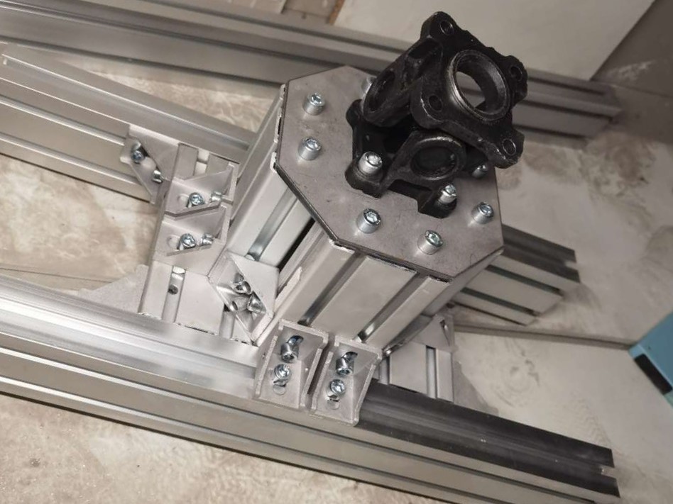

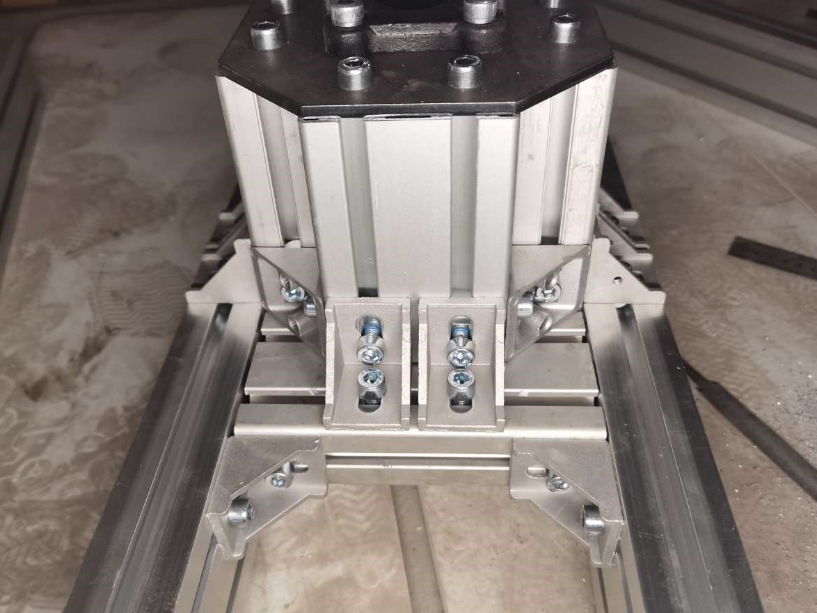

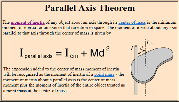

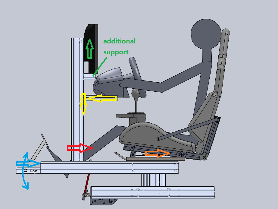

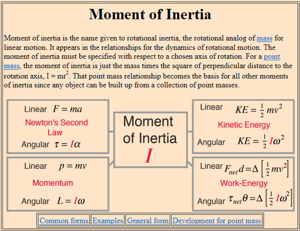

    Universal joint is placed as high as it can be, just under the seat. I remember the theory which had learned in university, but it is really difficult for me to explain this in English...
    So the key parameters are Mass_m and Distance_d.
    "m"_equal to your weight and upper structure, so lose your weight or reduce the Al profile.
    "d" _To have a better rotational inertia, we have to make parallel axis-center of mass close to universal joint. With same motors, the closer these 2 centers are, the more effective the action will be.
    Actully the universal joint is always below the center of gravity of our body , because we must sit on the chair, it is limited by the structure. If you want to make the 2 centers at same point, we must change another structure, but it can't be compact.
    I used to plan to use a 8080 profile as support, connecting lower frame and joint, but it looks not strong enough. So I enhance this support with 4x4080 profile.
    Almost each components can be adjusted.
    You can also check if there is any interference when simulate pitch and roll in Solidworks.

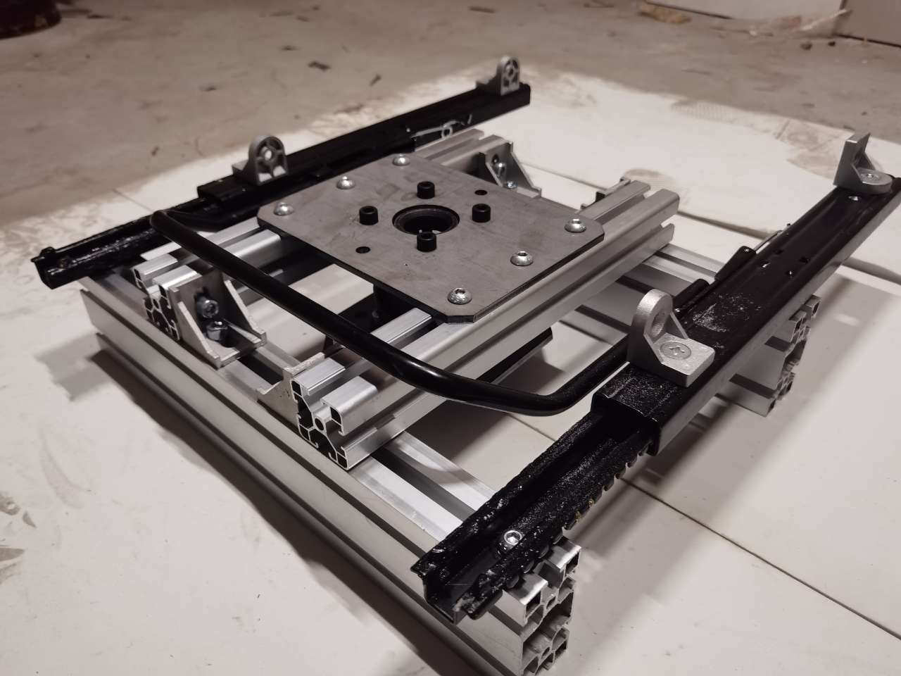

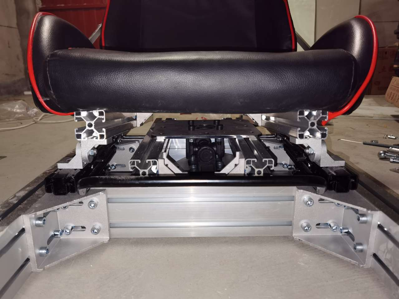

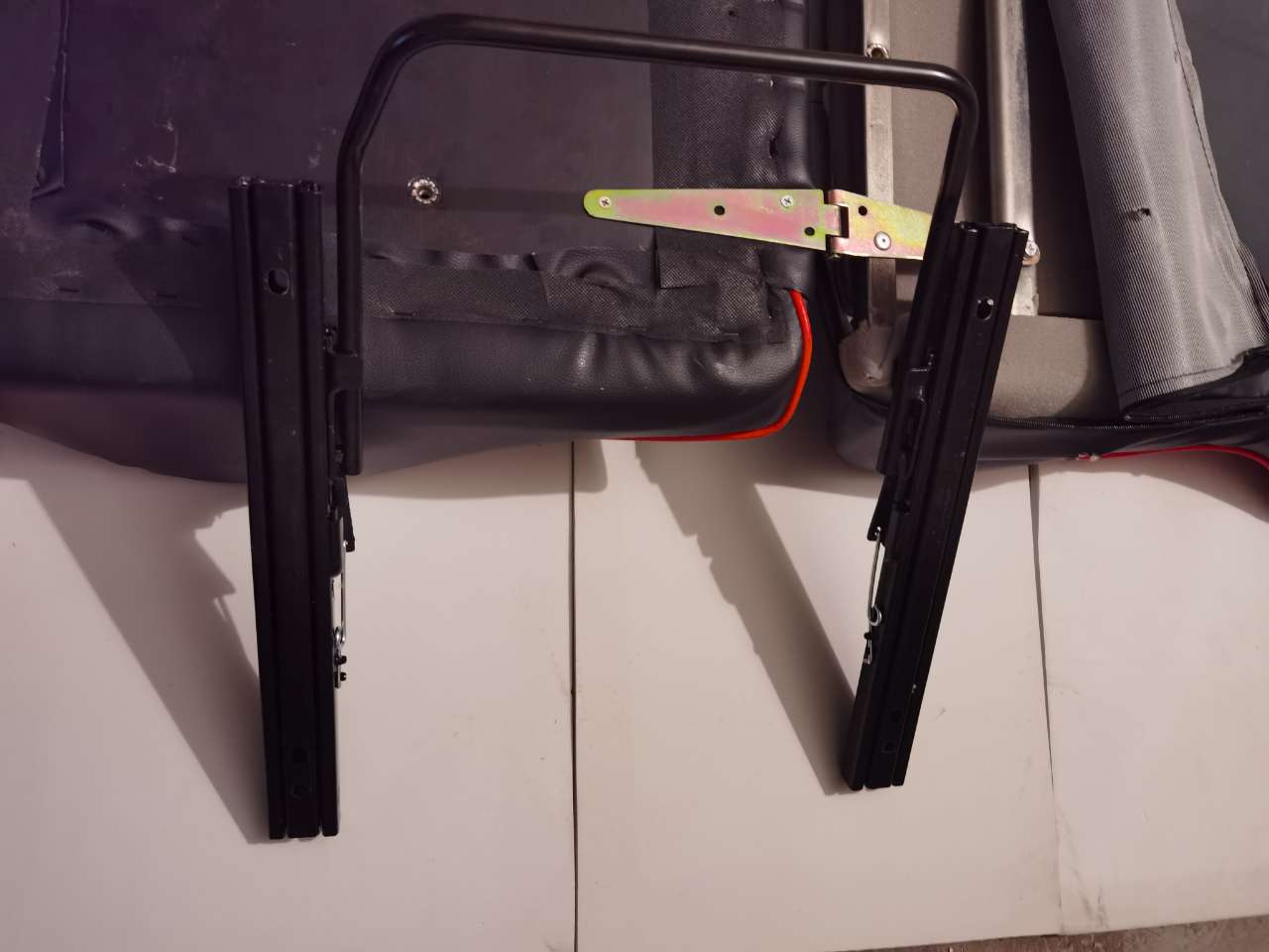

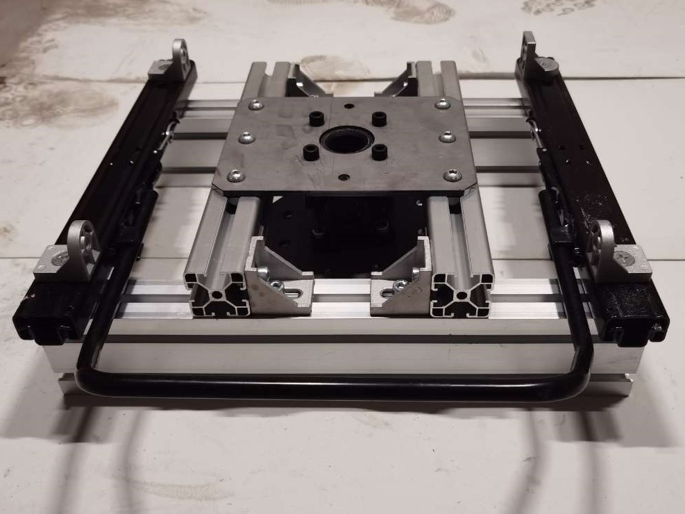

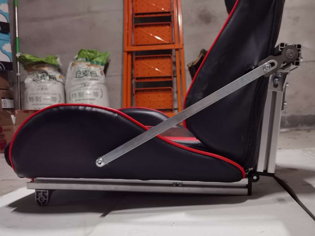

    PART 5. Assembly
    These are some photos during assembly.
    base frame

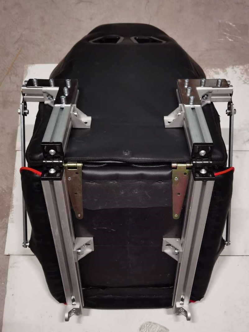

    seat retrofit (2).jpg seat retrofit.jpg seat retrofit (4).jpg seat retrofit (3).jpg
    seat retrofit

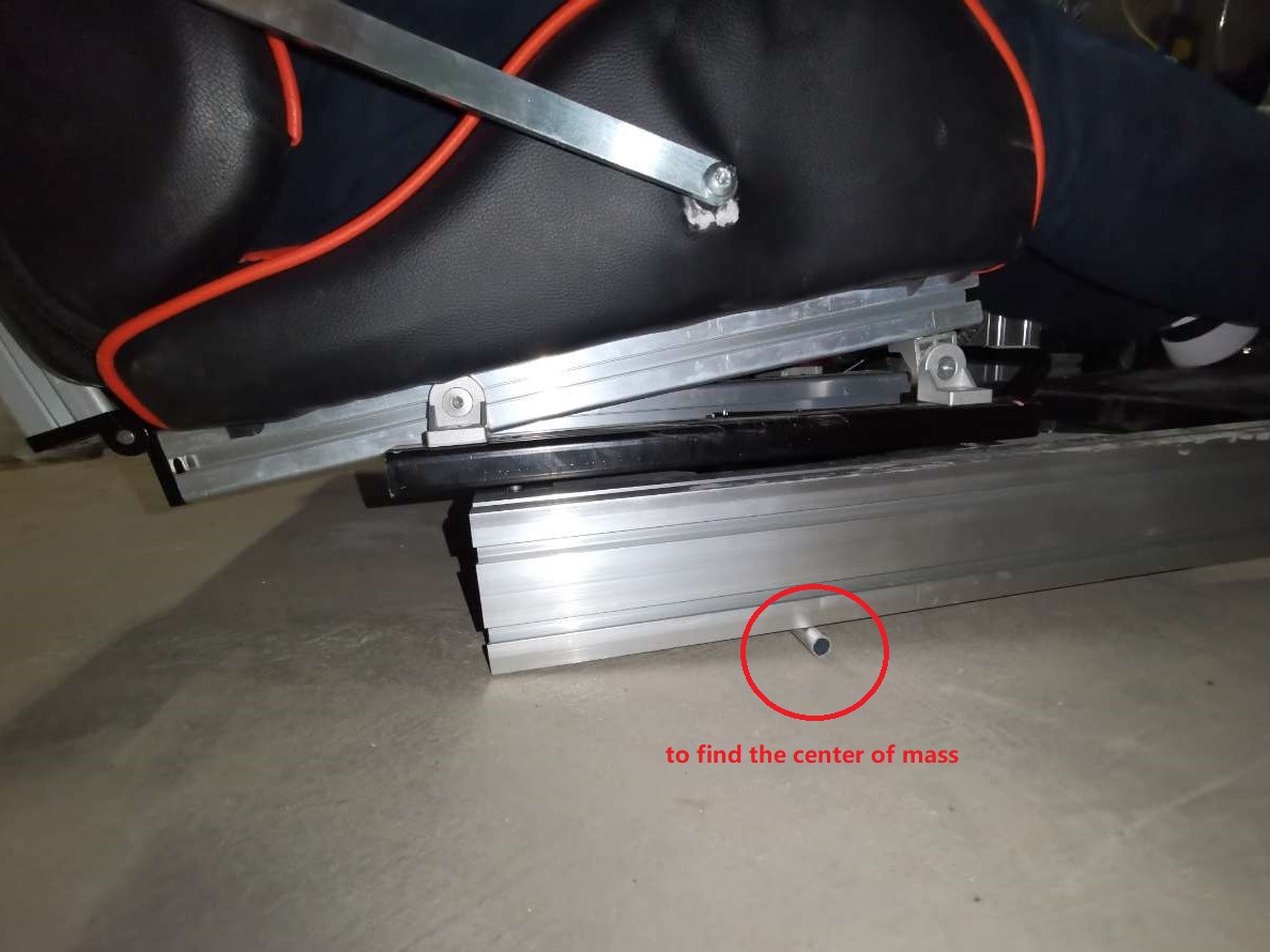

    seat slide rail.jpg seat support.jpg seat support (2).jpg upper frame.jpg base frame.jpg center of mass (2).jpg
    seat support
    use a round bar to find the center of mass, then aline the universal joint, base frame and upper frame.
    additional support for wheel holder
    That's all before functional test.

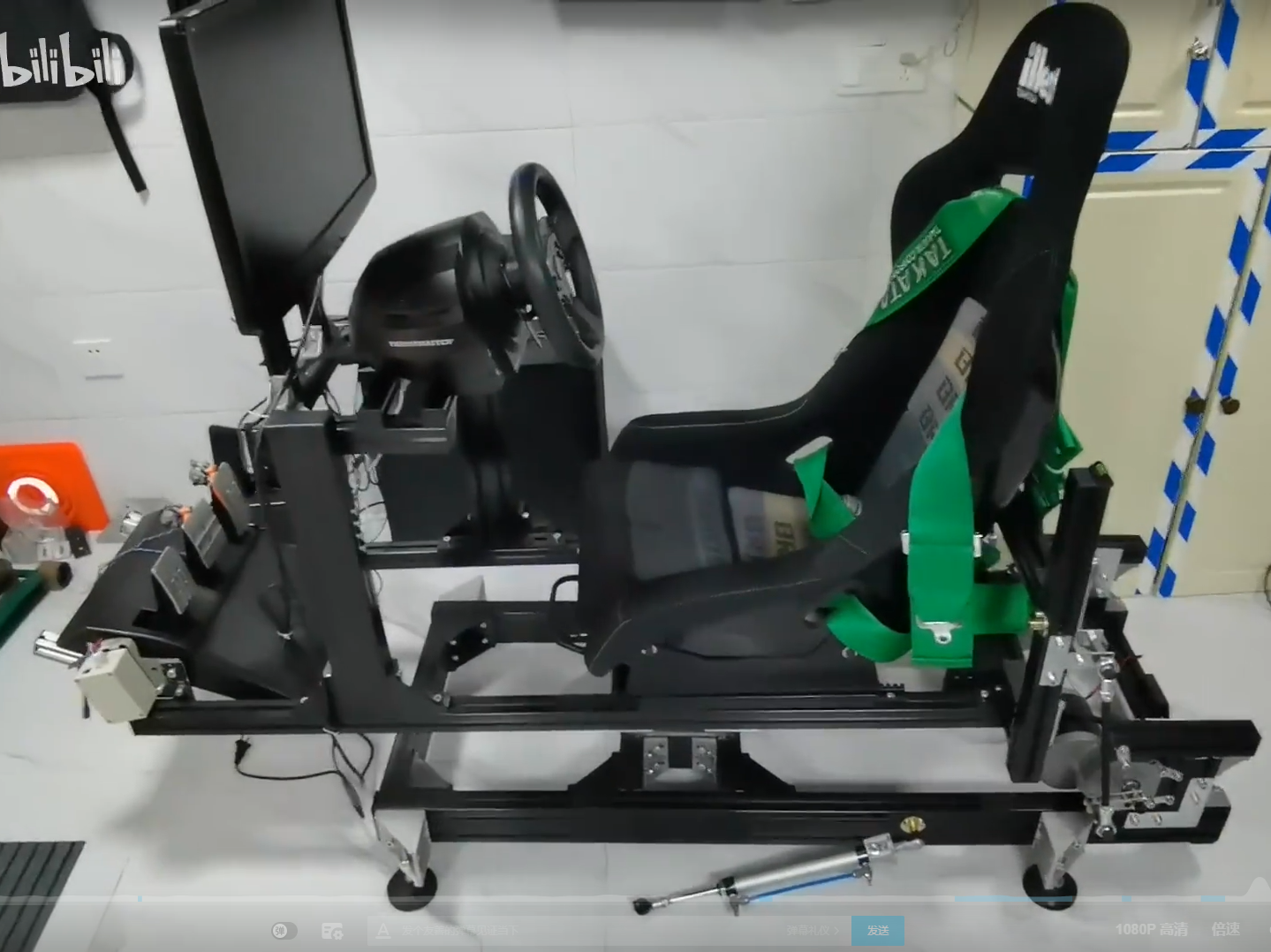

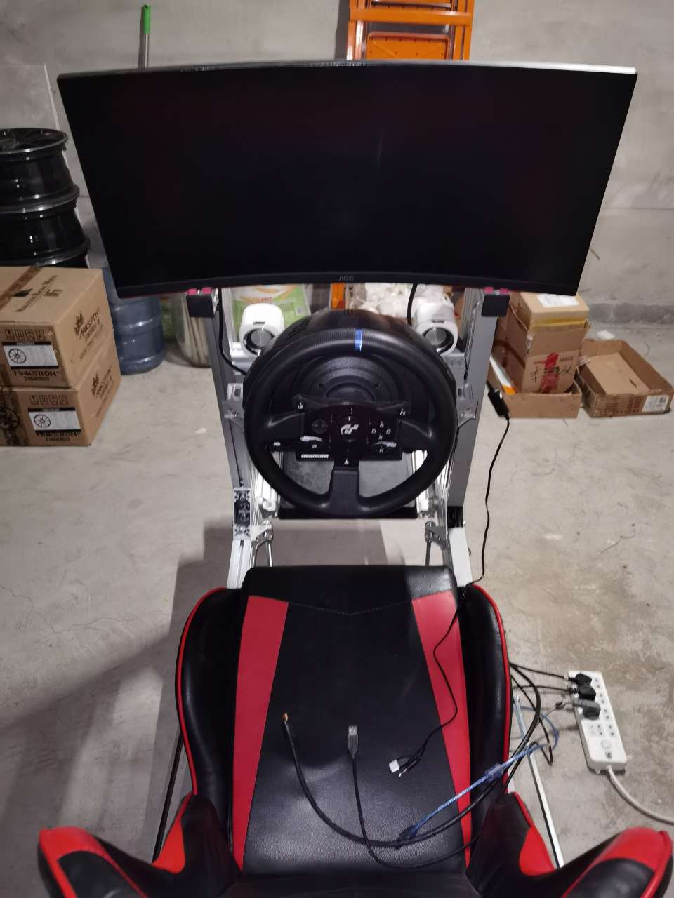

  11. Frank Li
    Frank Li New Member
    May 10, 2021
    12
    Xinjiang, China
    63Coins

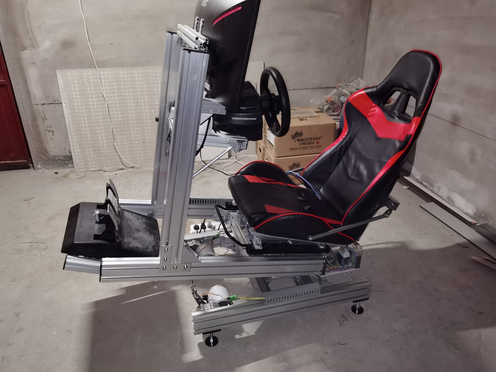

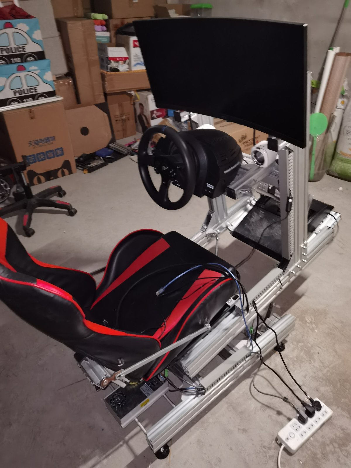

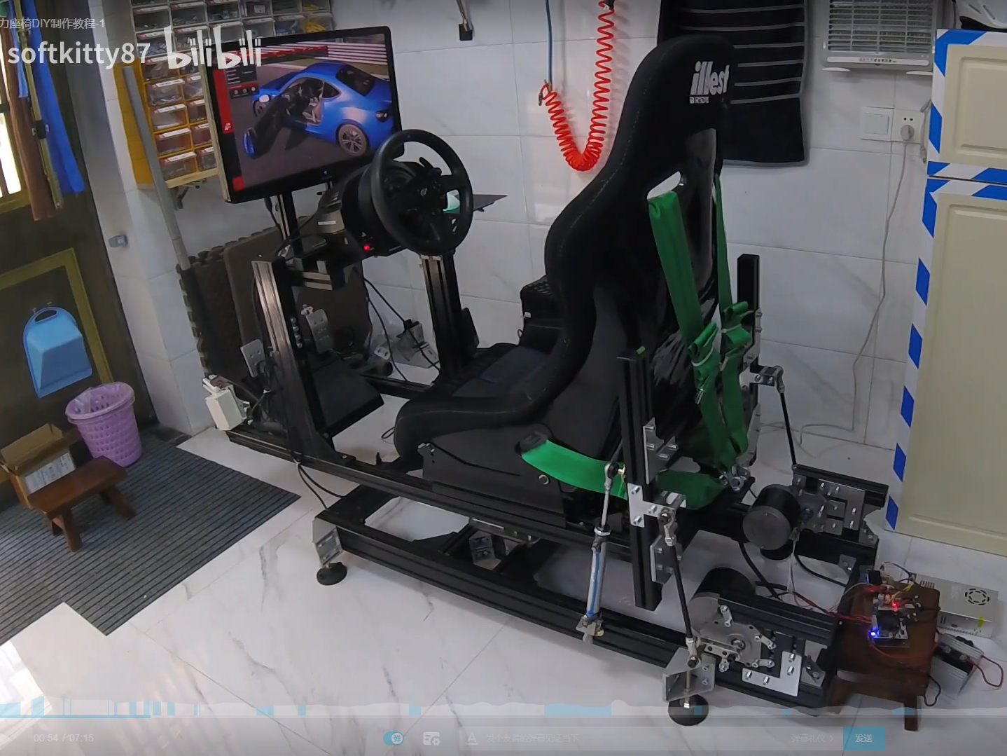

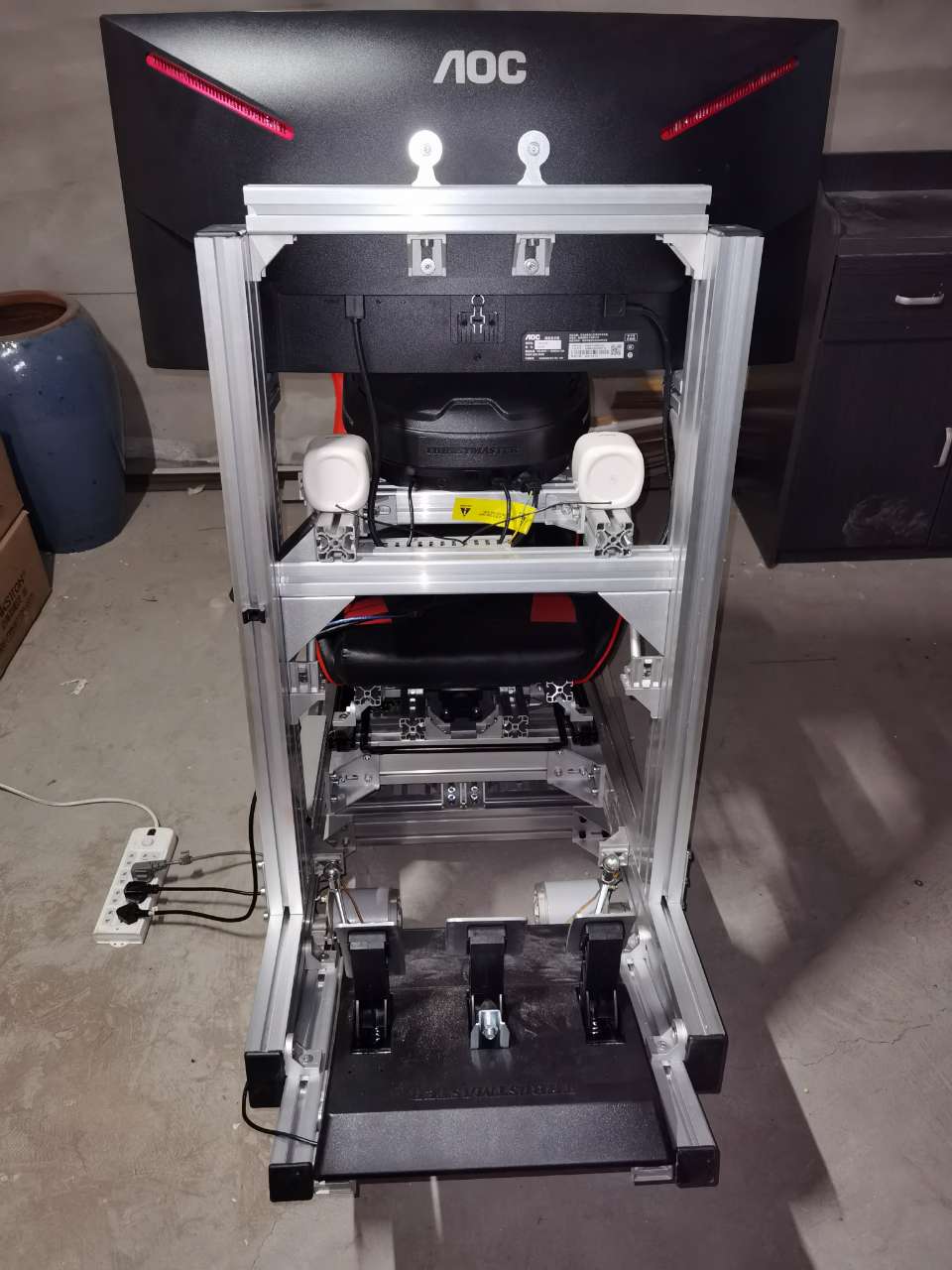

    Something updated, cable channels, supporting feet, and mini-loudspeaker. This is the final shape.
    final (1).jpg final (2).jpg fully assembled rig  (1).jpg fully assembled rig  (2).jpg

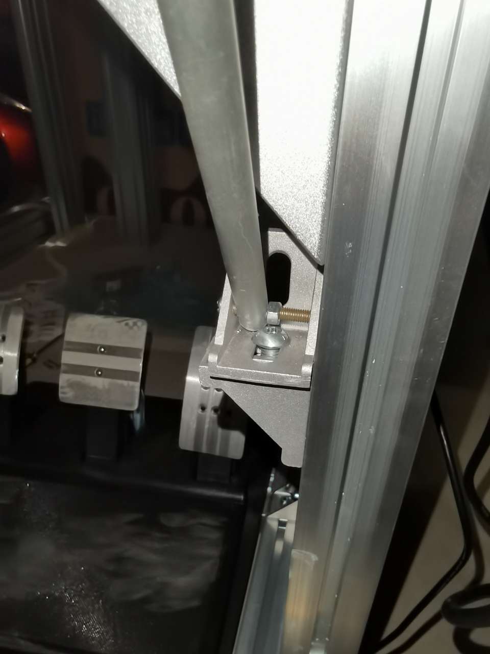

    Because the 2 motors are not worm gear reducer ones, the upper frame cannot stay balance without people in seat.
  12. Frank Li
    Frank Li New Member
    May 10, 2021
    12
    Xinjiang, China
    63Coins
    Hi noorbeast, are these 2 pictures OK ? Uncompressed photos.
    I had subumitted request of free DIY license last week, but I havn't got more feedback. I wonder that the photos of fully assembled rig are necessary for that, am I right?
  13. noorbeast
    21,916
    153,107Coins
    +11,117 / 56 / -2
    You are correct, one of the criteria for a free DIY license is that the build thread show progression of the rig to the testing phase, and all of the stated criteria must be met, so please resubmit an application.
    The photos are fine.
