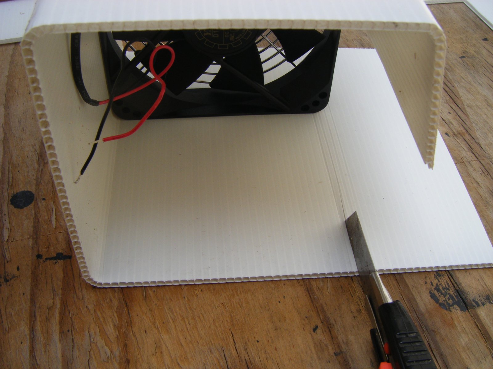

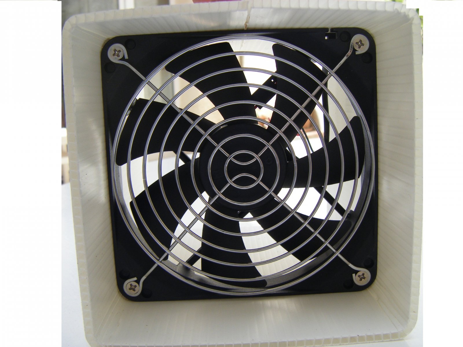

    You need to weld some electronic stuff but you would like to preserve your lungs?!
    Let's build a smoke extractor!
    - I found a beautiful 12cmx12cm fan in scrap from a CoolerMaster broken PSU
    - I used a plastic sheet (kind of corrugated) called "coroplast"
    it's like this ][][][][][][][][][][][][][][][][][
    I cut some walls near the corners (in order to bend it easily around the fan):
    The fan is surrounded perfectly and I used 4 tie-rap around:

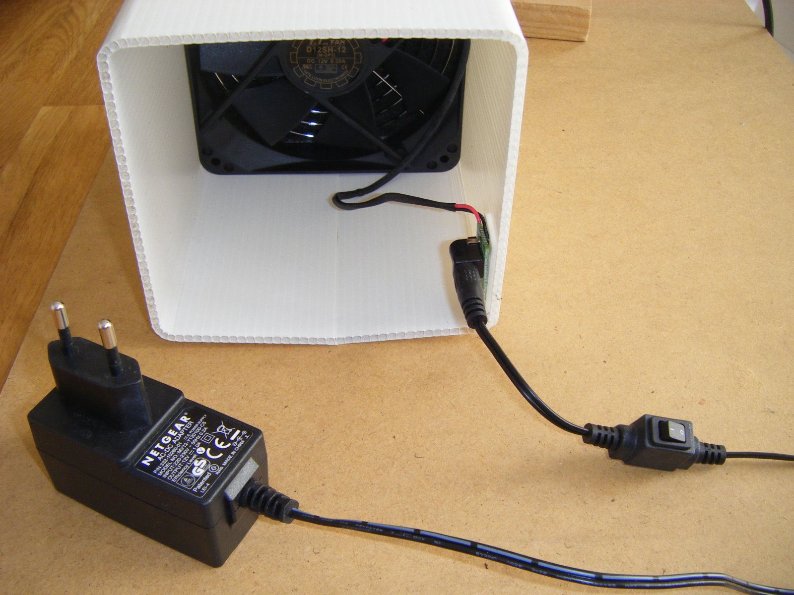

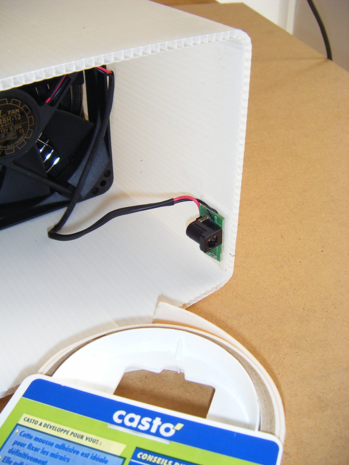

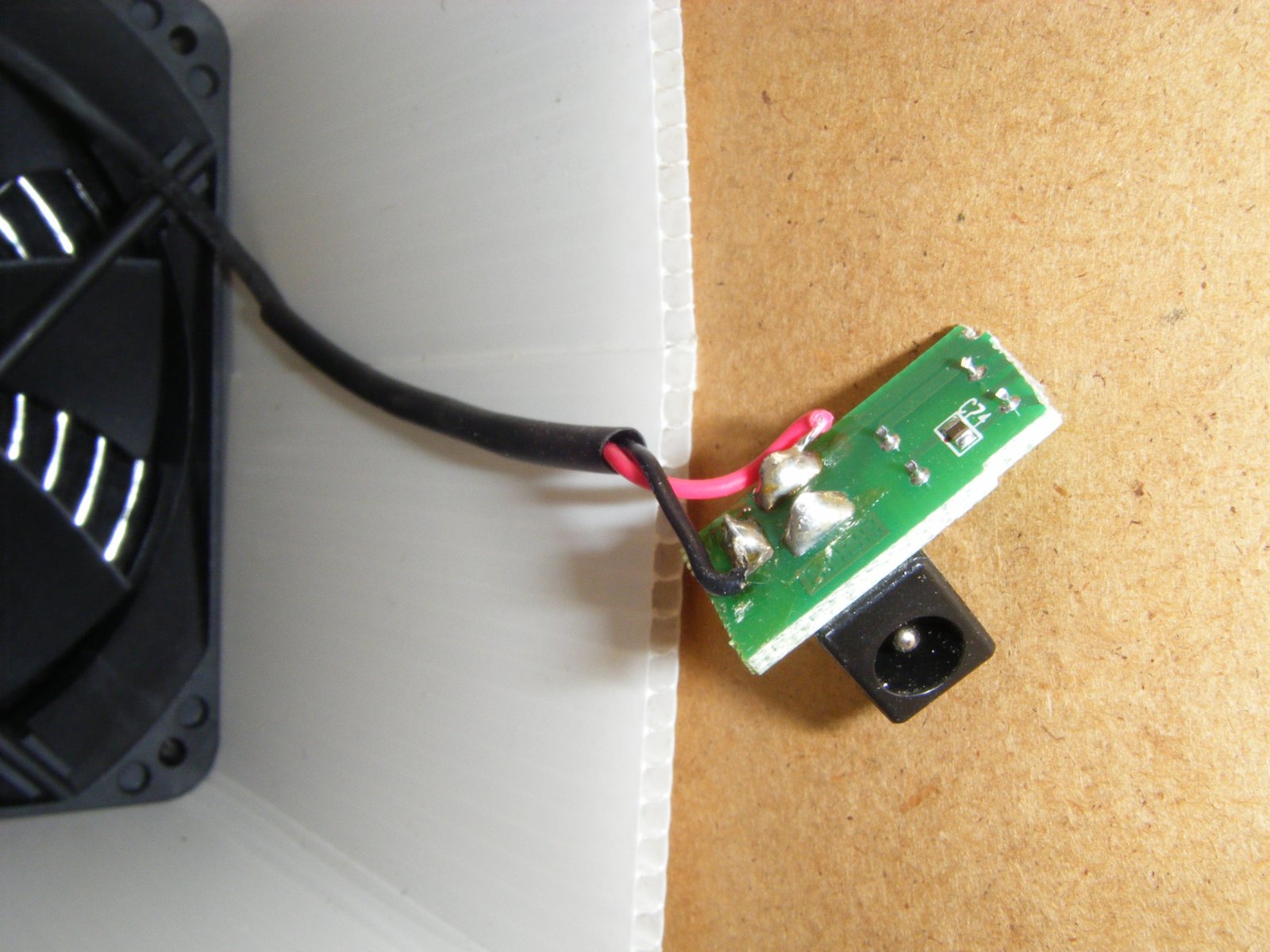

    I re-used and welded a jack to the fan wires:

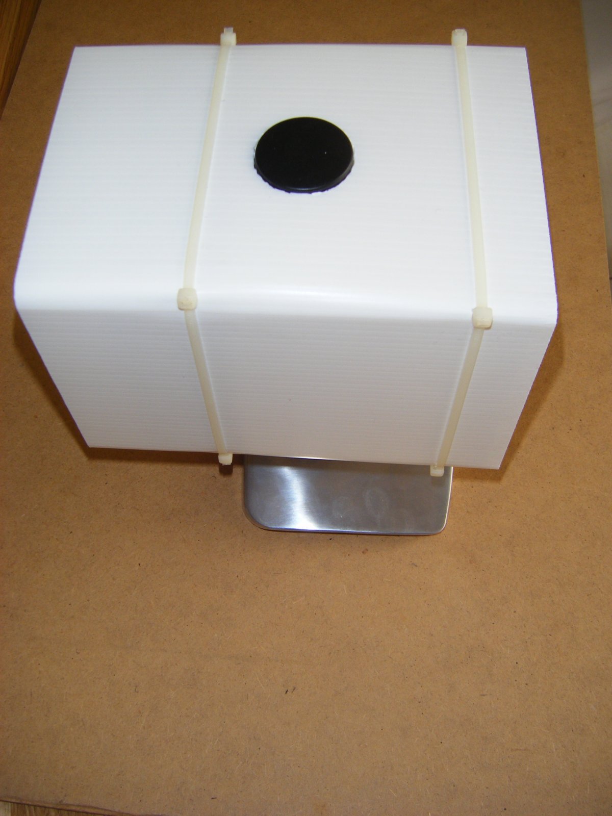

    Simply sticked it on a side:
    A power supply 12V 0,5A from scrap, with a convenient switch:

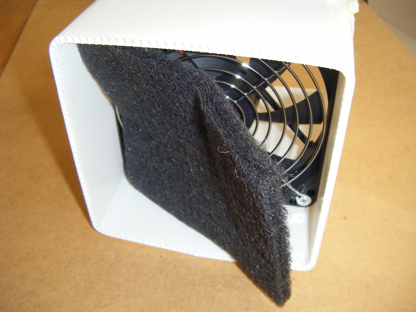

    I bought carbon filter for kitchen extractor hood (47cm x 50cm = 3€):

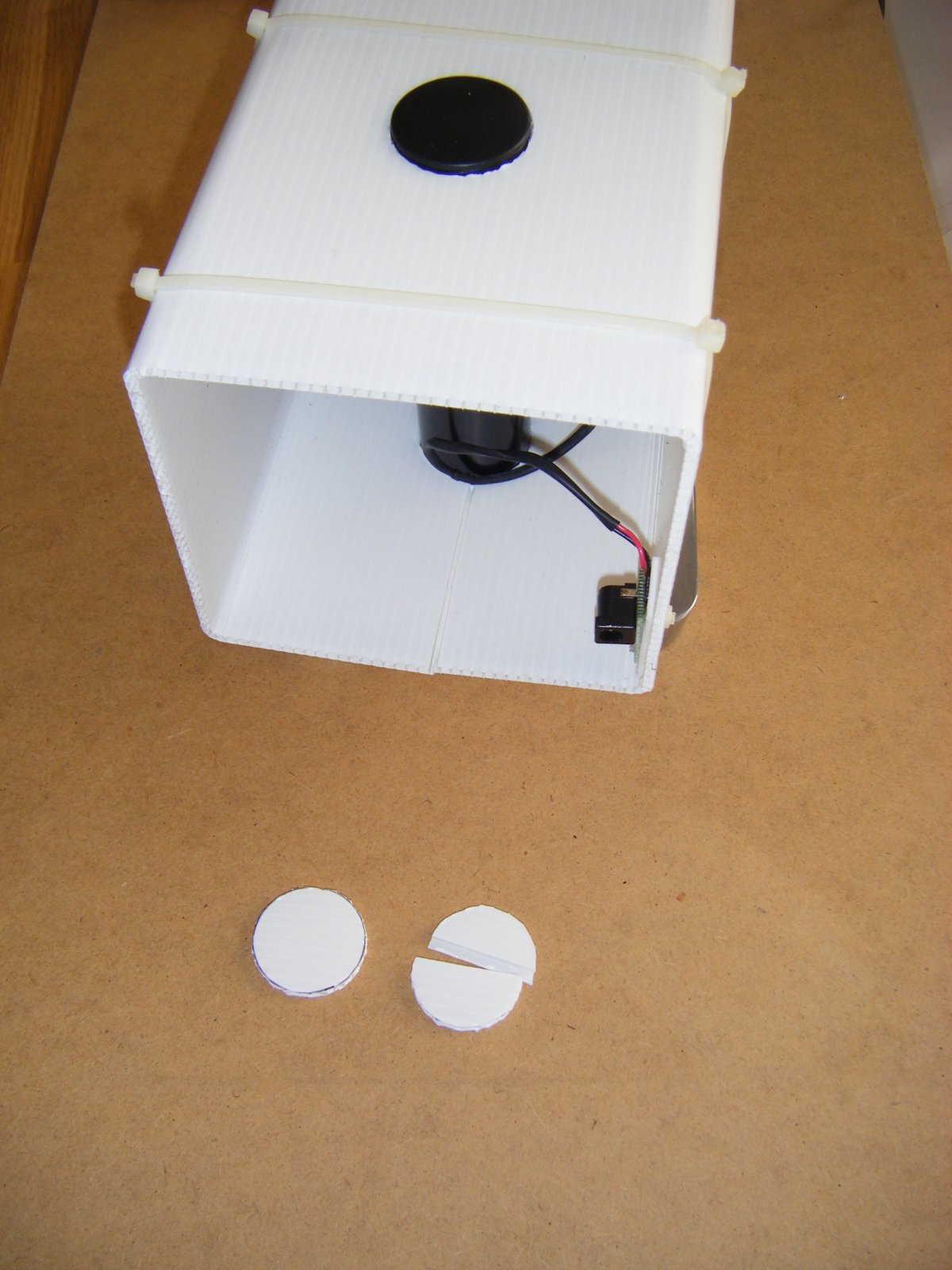

    I cut 2 holes to fit it to a support:
