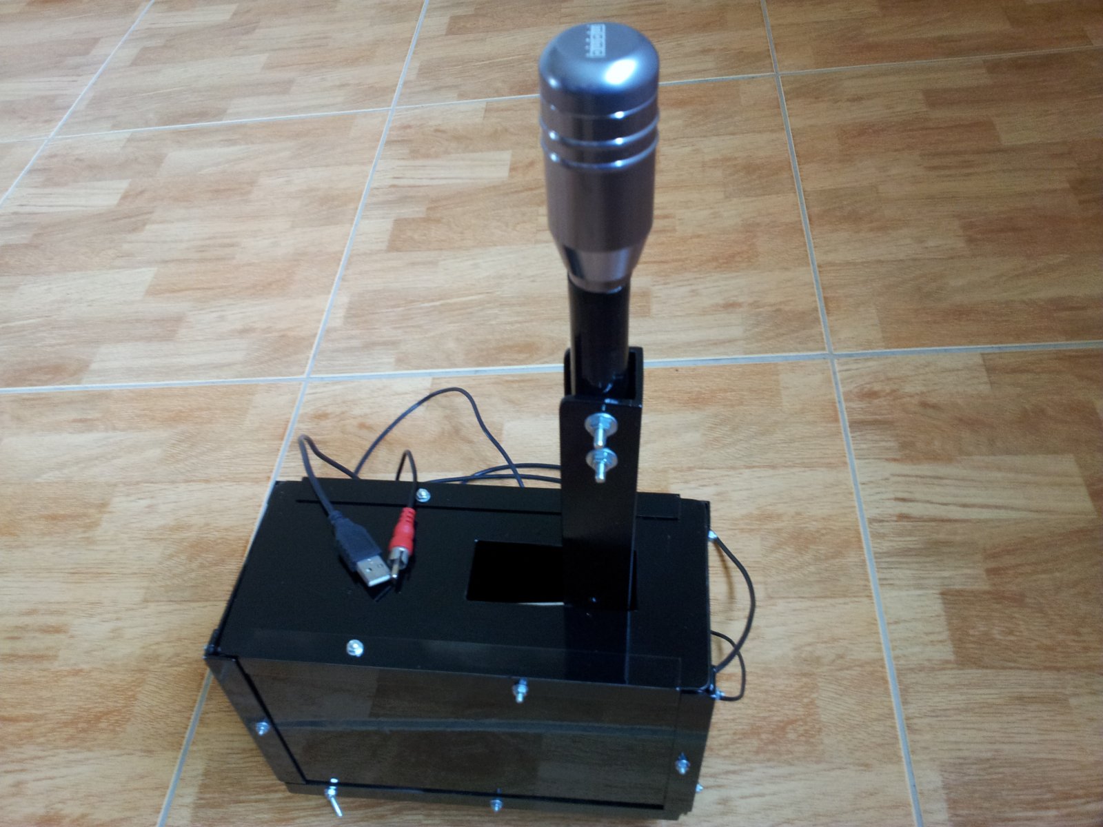

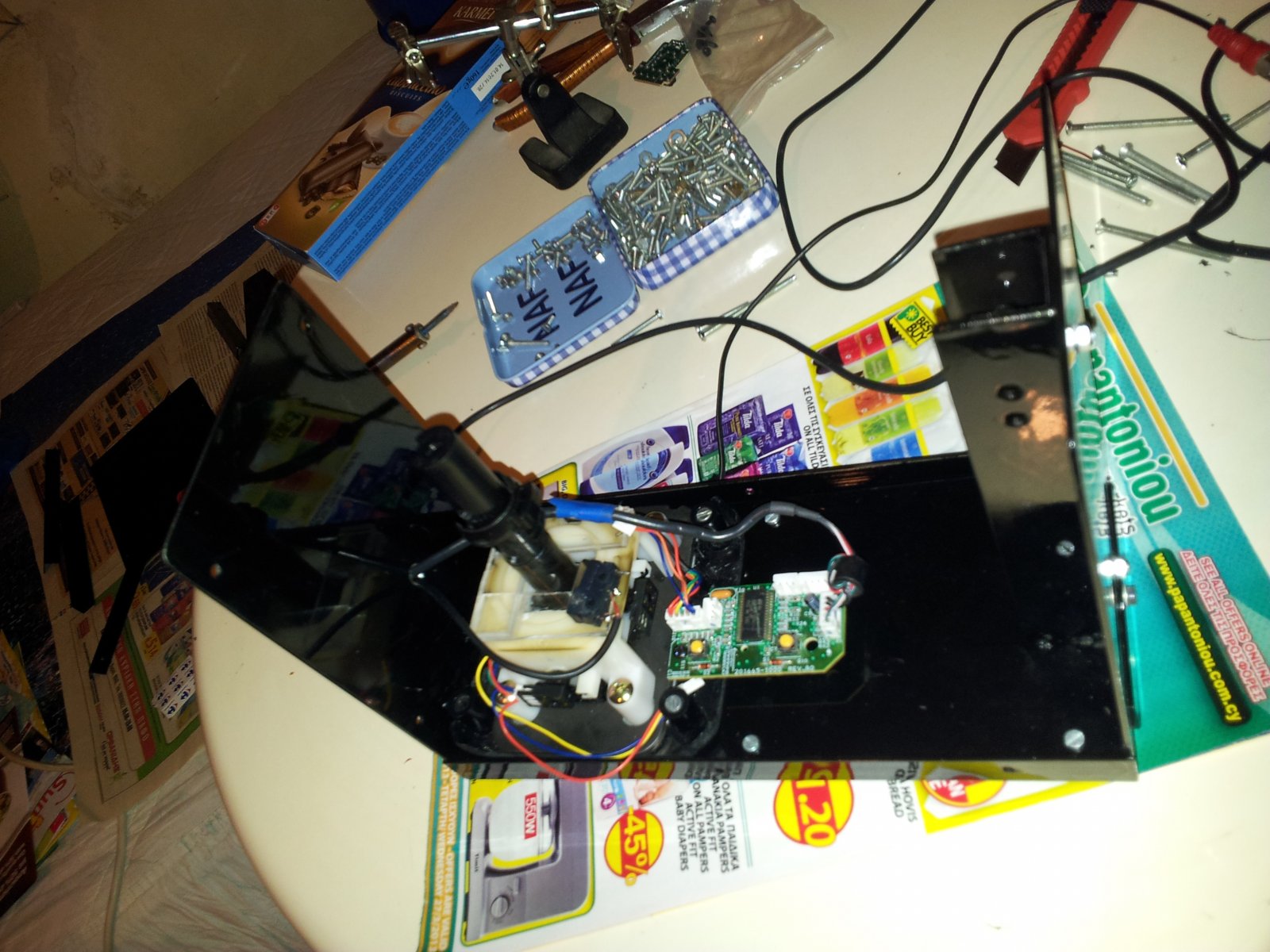

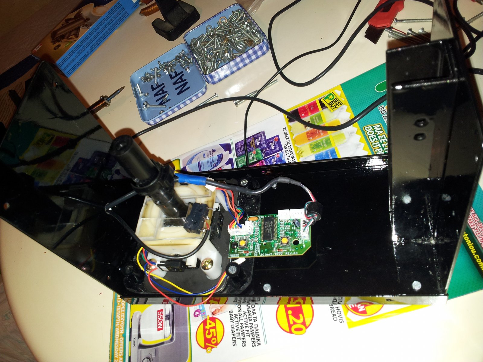

    It's about a DIY USB vertical handbrake with gas spring 10 kg that can be used both analog or digital depends on game.

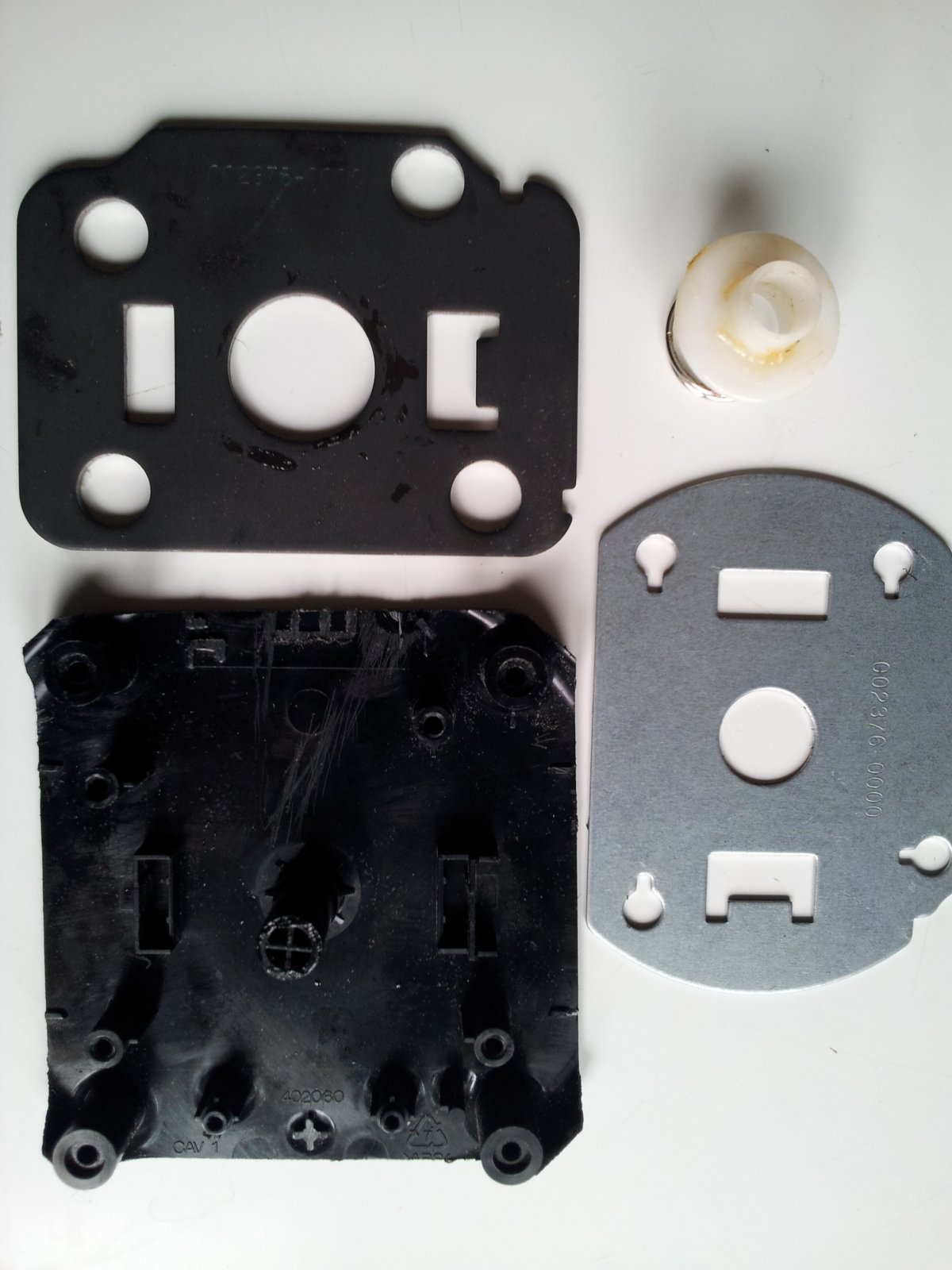

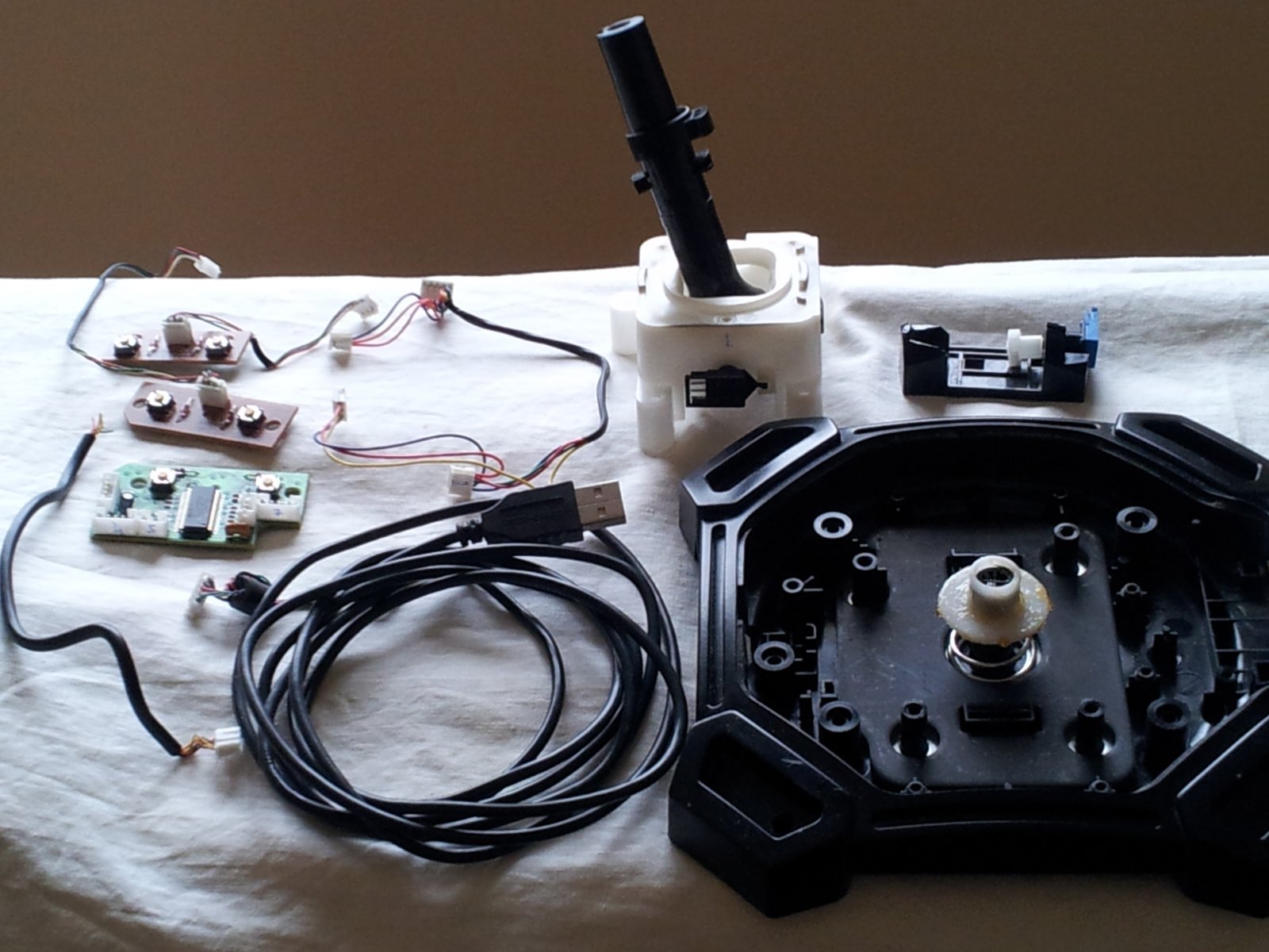

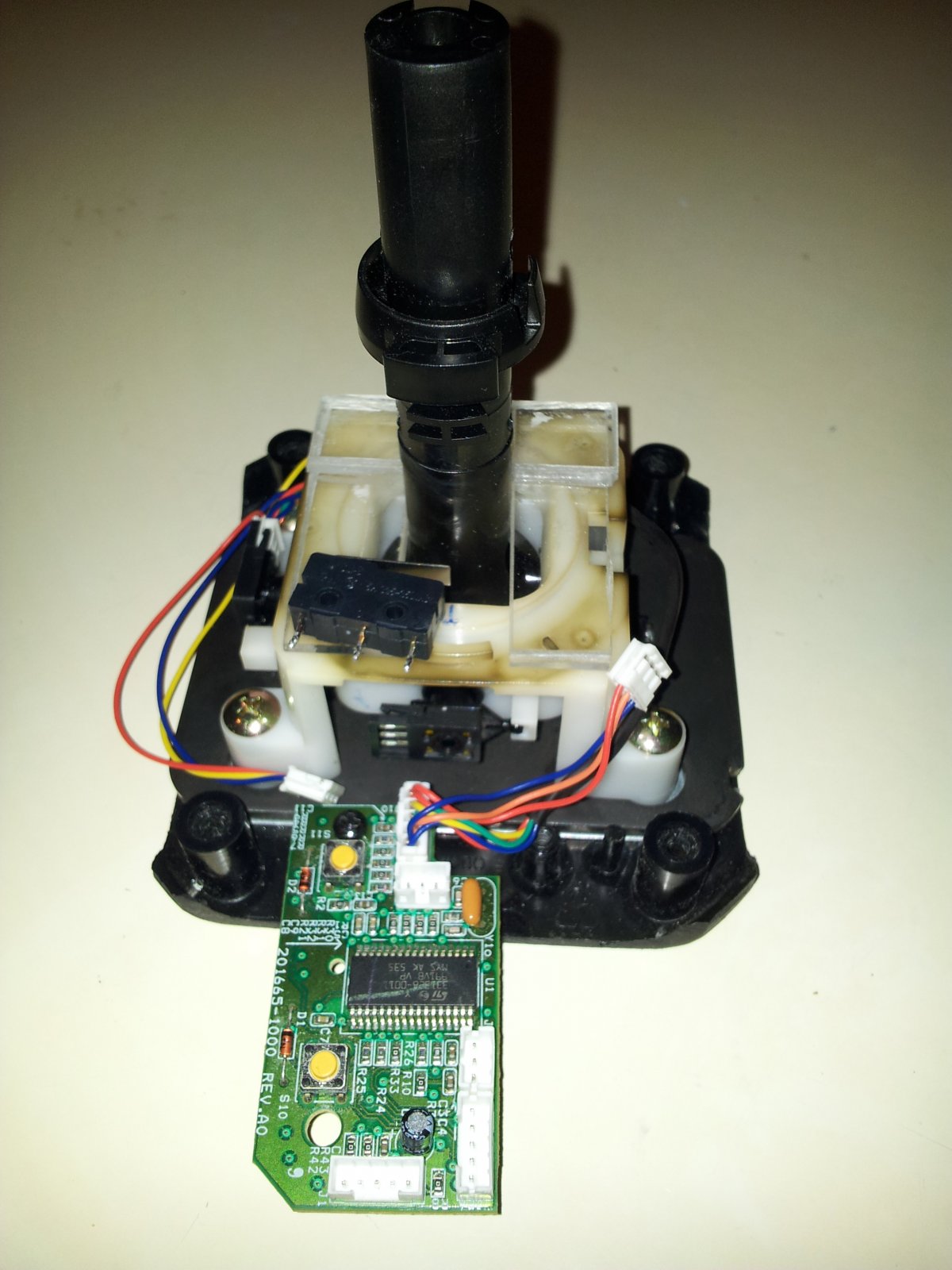

    I used an old Logitech attack 3 joystick that I don't using it anymore and disassembled it
    I cut the frame and kept the mounting holes like the pic

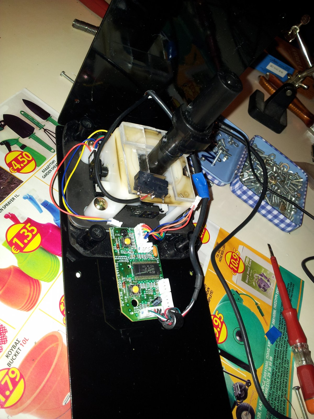

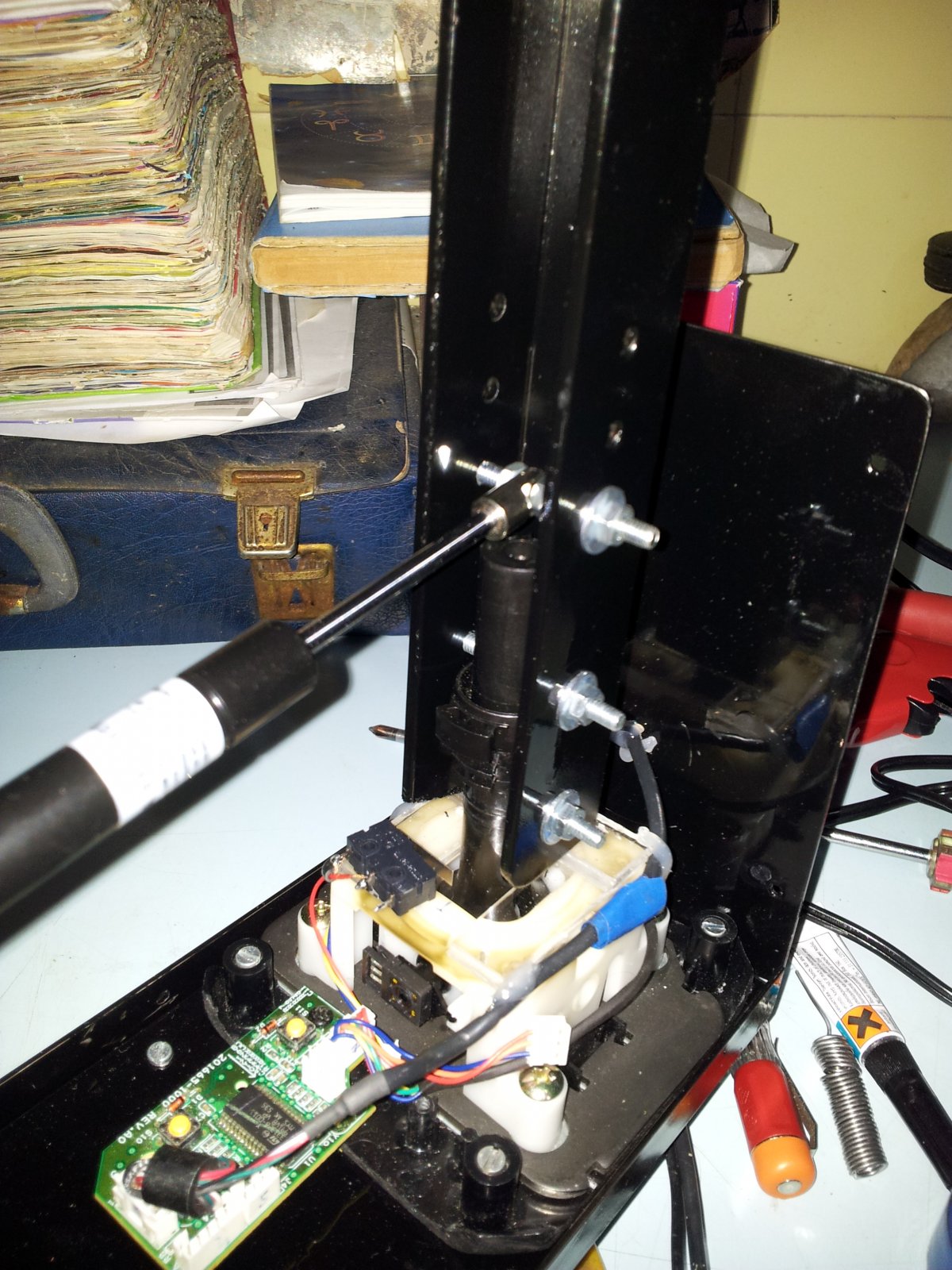

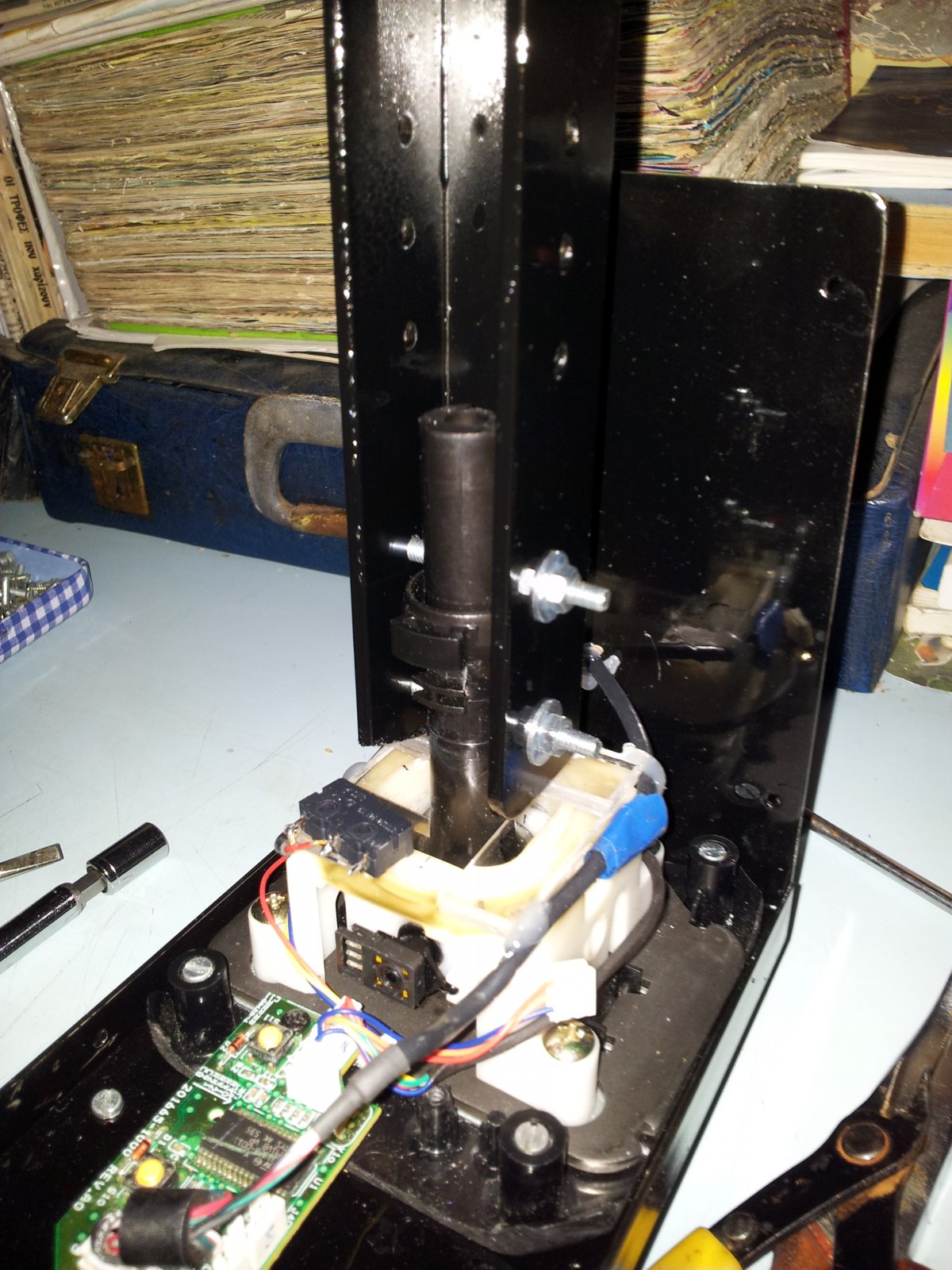

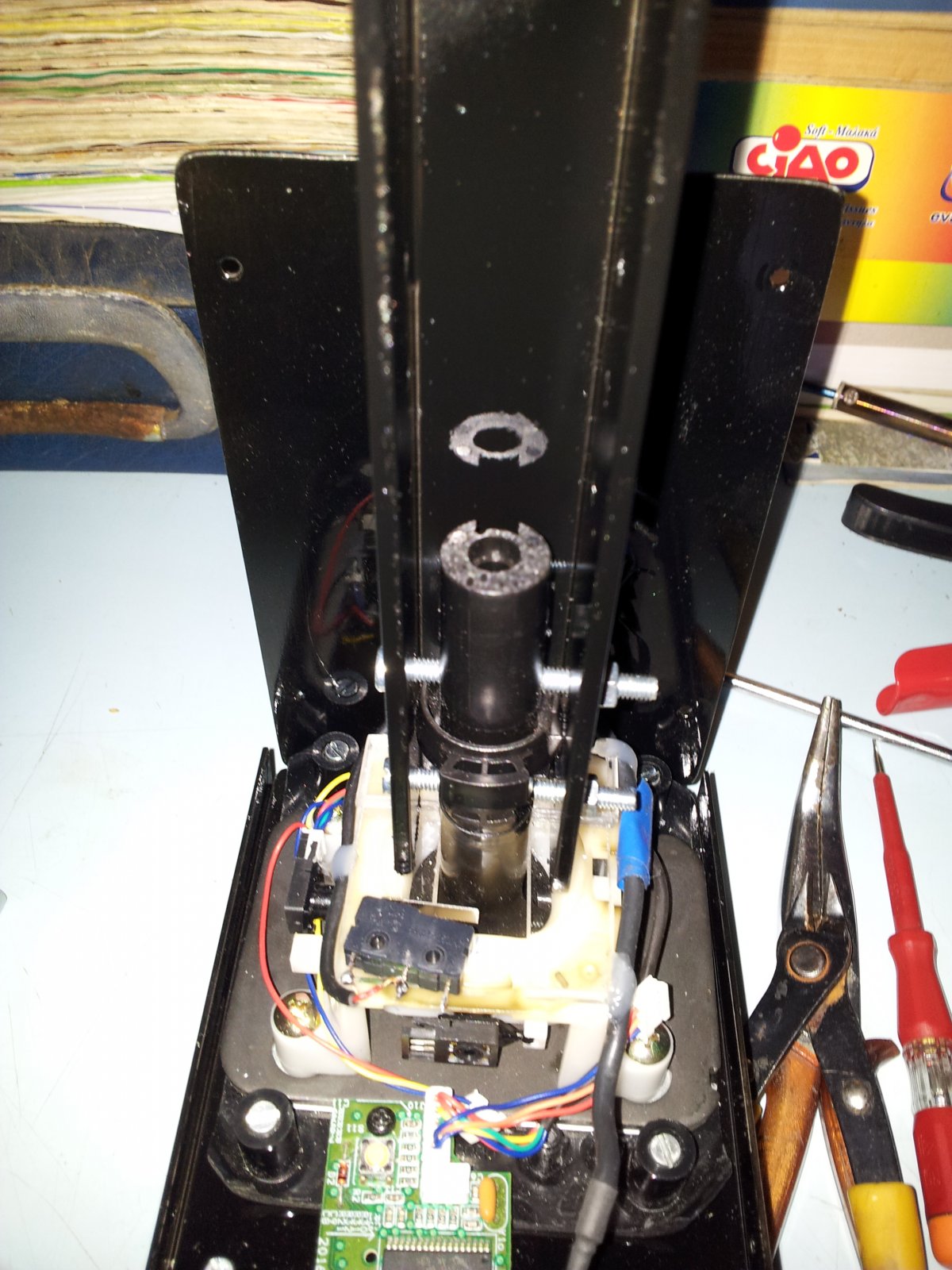

    I used Plexiglas to lock one axis and also glued a micro switch (from attack 3 joystick) for analog axis
    Aluminum ready for paint

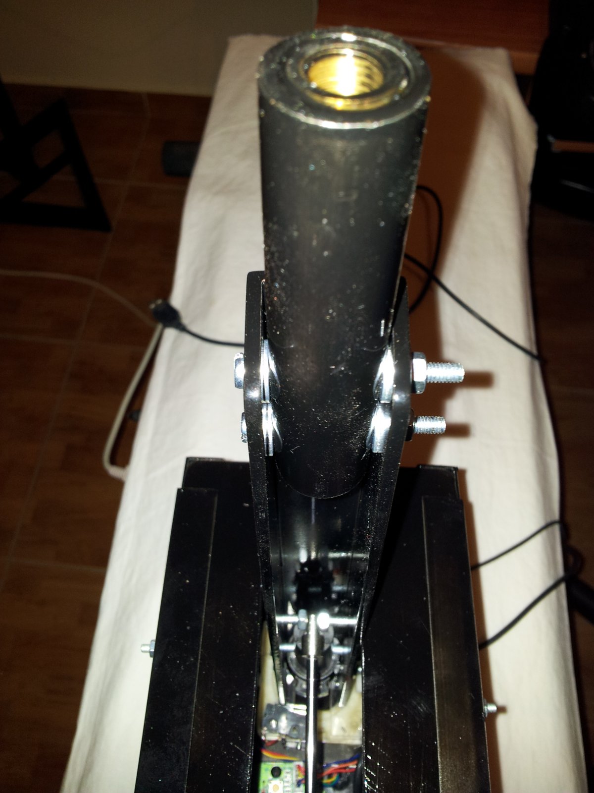

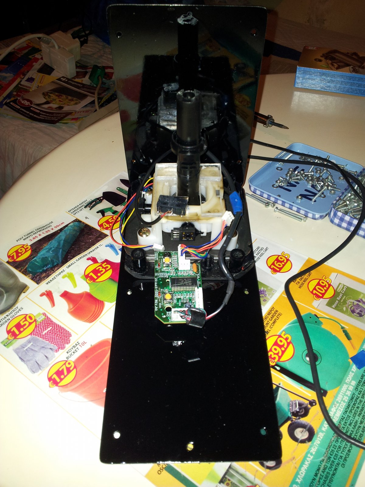

    Assembling...
    20130324_201358.jpg 20130324_201436.jpg 20130324_211304.jpg 20130324_211317.jpg 20130325_175806.jpg 20130325_175834.jpg 20130325_181052.jpg 20130325_212738.jpg

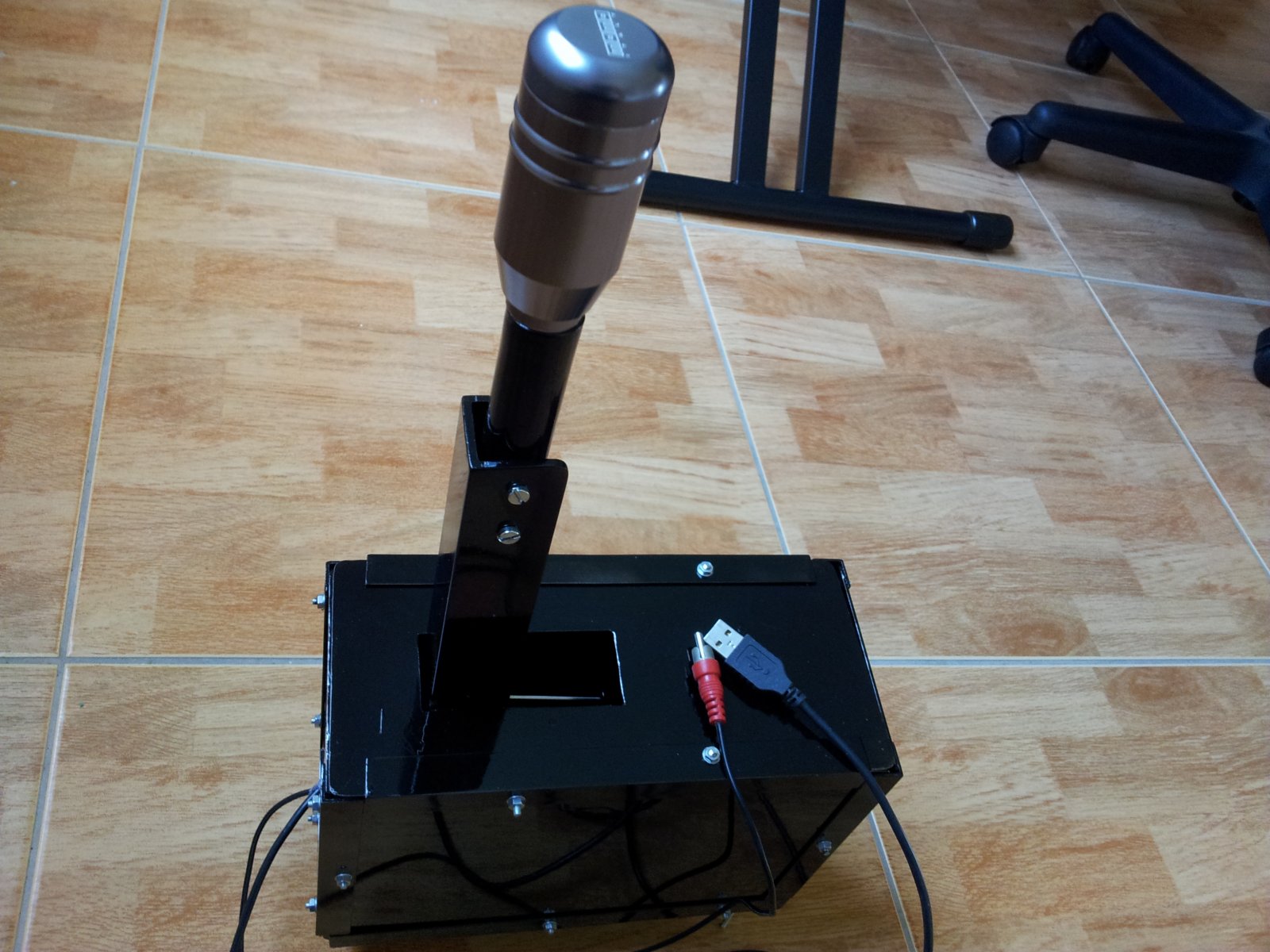

    The result
