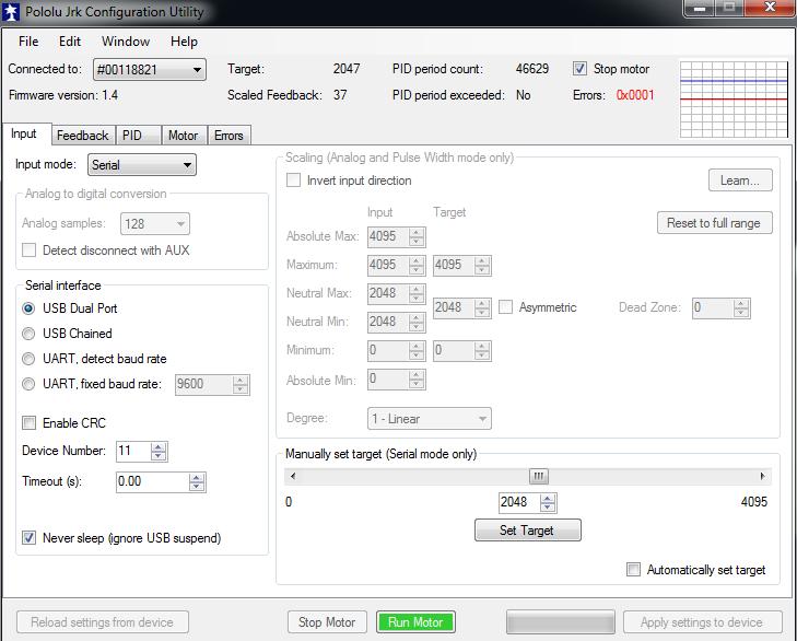

    No. :) What I mant was that in Simtools v1.3 we had to select a different COM port for each JRK when setting up. It's all automatic now in v2.0. i.e Same COM ports are used now for each JRK as they were previously in v1.3. ex. JRK1 - COM4 Jrk2 - COM6 Jrk3 - COM 8

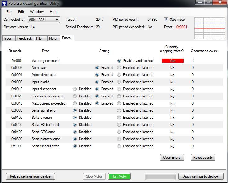

    Thanks for that explanation. Makes sense. No error whatsoever are being reported in the JRK software though, so I have to assume they are working fine.

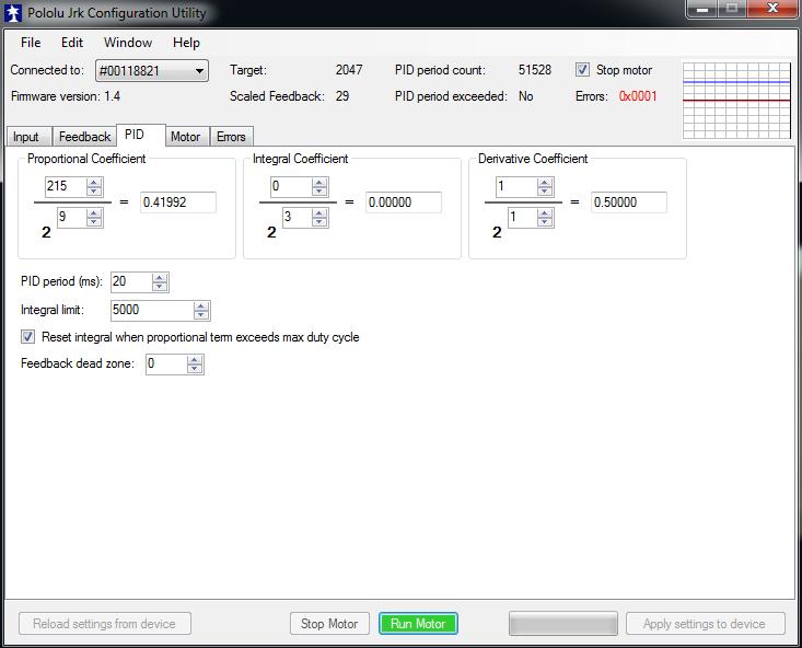

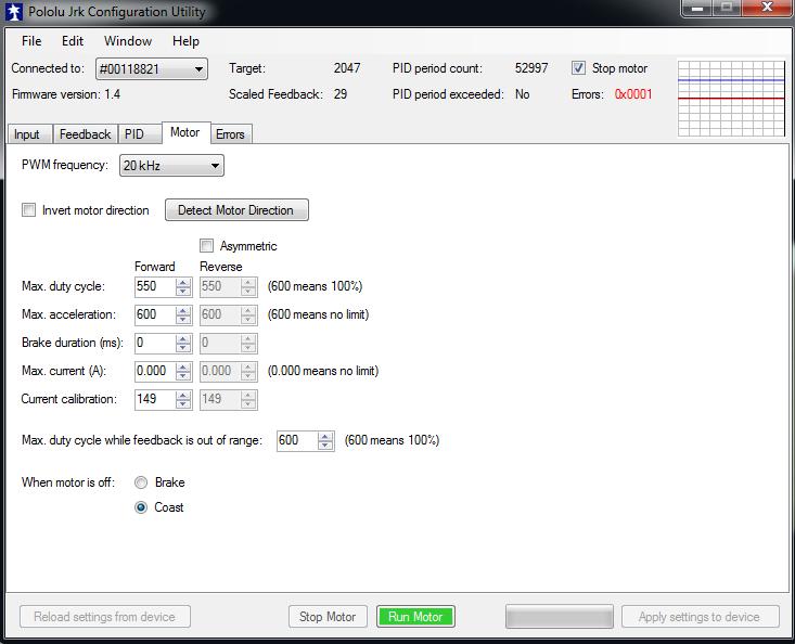

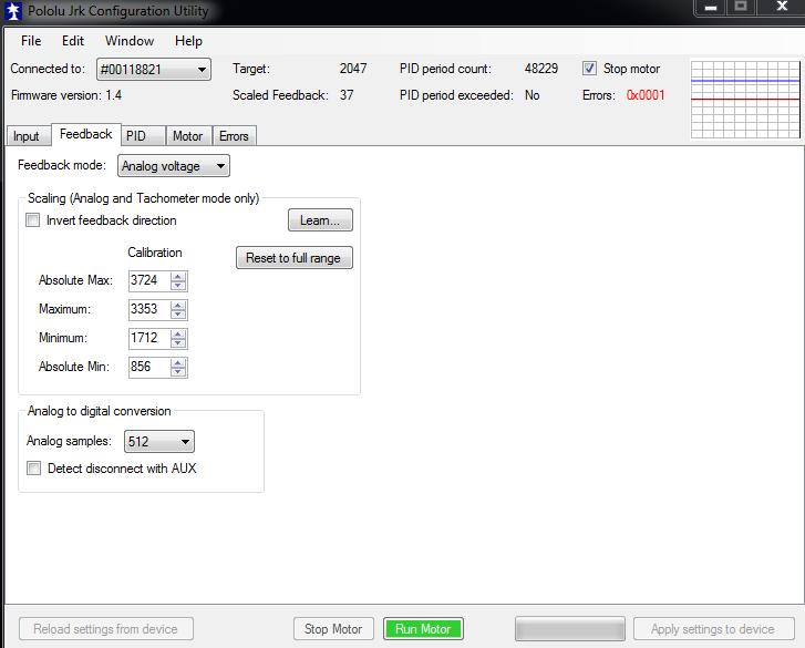

    The other 2 JRK's have the same settings.

    If your crashing the software the first thing you do is get better USB cables, Then add some ferrite shields, then Work on your Tuning center in conjunction you can turn down your duty cycle and Acceleration on the JRK.
    If dropping the Duty and Accel immediately fix the problem you either have crap USB cables or your Very much abusing the Tuning center values causing further issues.
