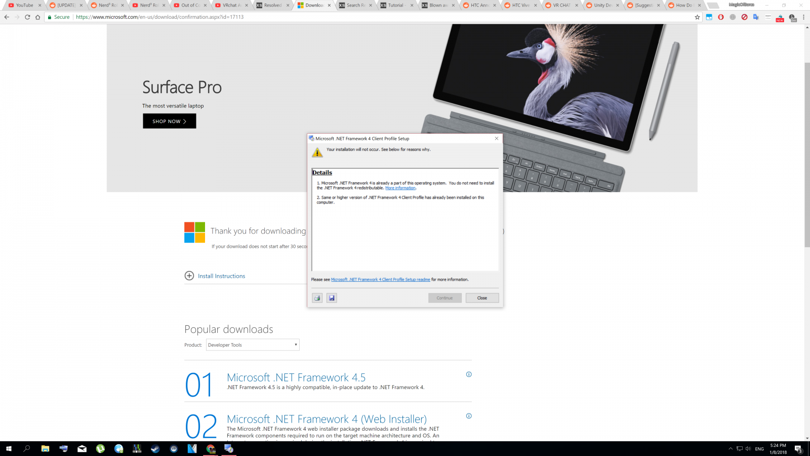

    Details
    Microsoft .NET Framework 4 is already a part of this operating system. You do not need to install the .NET Framework 4 redistributable. <A HREF="http://go.microsoft.com/fwlink/?LinkId=164207">More information</A>.
    Same or higher version of .NET Framework 4 has already been installed on this computer.

    ah ha,
    • Go to Windows Start Menu -> Control Panel -> Add or Remove Programs or Program and Features.
    • extra step.... on the left column click turn windows feature on or off
    • Select Microsoft .NET Framework 4 Extended.
    after i did this i unchecked all frameworks
    then rebooted
    now states connected....
    not tried game thought id put your mind at rest...didn't want you loosing sleep;)
    thanks again for super quick responses!

    hey man, what do you mean by uncheck all frameworks..? what should i press here: https://imgur.com/a/RcqSt

    @Mpmo
    If you reinstalled win10, check to make sure you have .net 3.5 and below checked.
    I have 3.5 and 4.7 enabled.
    Sound like @SBDESIGN had something a bit different?

    yeah it is checked https://imgur.com/a/M9eQC
    but issue still persists

    I don't see anything above .net 3.5 on your list thou?

    yeah i have no idea.. maybe i should uninstall 3.5 and install the link you sent?
