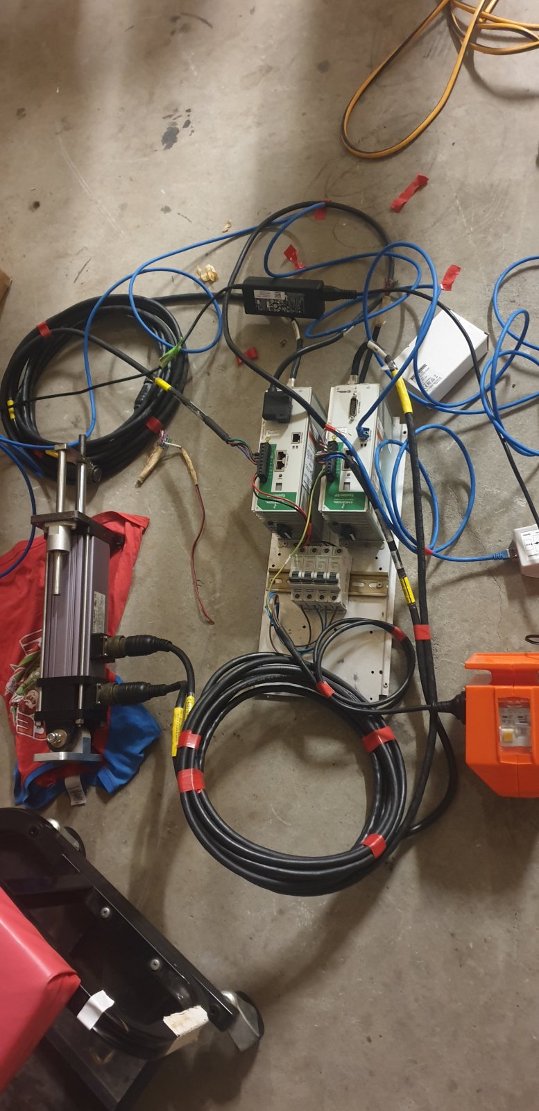

    Commercially designed non motion system, i have bought 2nd hand 2 x Exlar GSM 30 actuators with Epslion EP drives. Waiting my 30 days and hope Sim X will send me a free licence. Still have several interface issue to look at, setup is tested and working just needs refining.
    Any experience or advise is welcome.

    Garage floor test bench, I have a 26pin IO plug, i assume this is compatable with sim x gaming software converted to usb. Along way to go but actuators have tested 100%, time for the interface then construct. 20190303_183052.jpg 20190303_183151.jpg

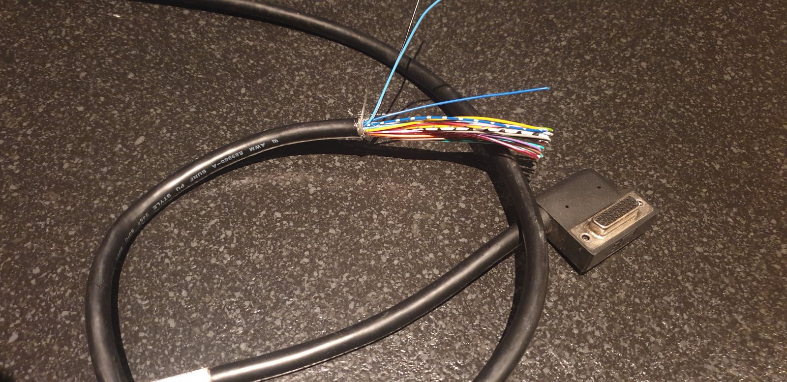

    Can anyone give me a hardware spec for the eio26 cable from my servo drive to the pc? Currently using power tools pro for testing.
