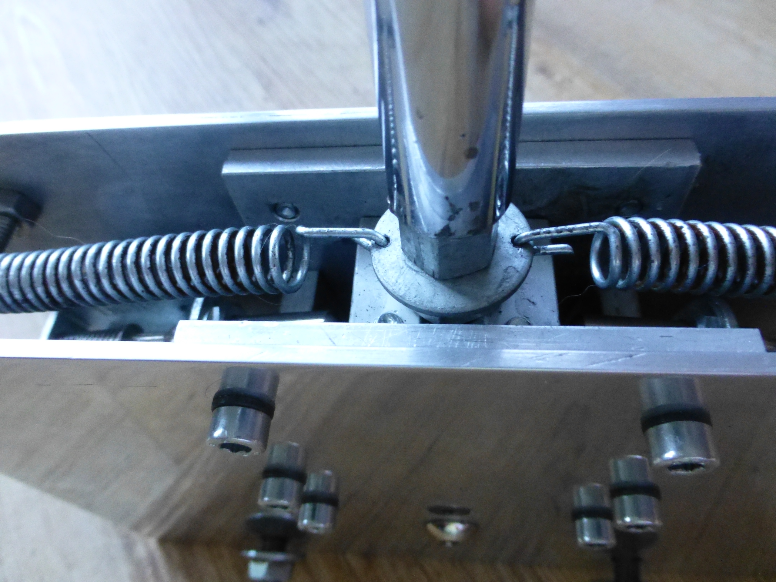

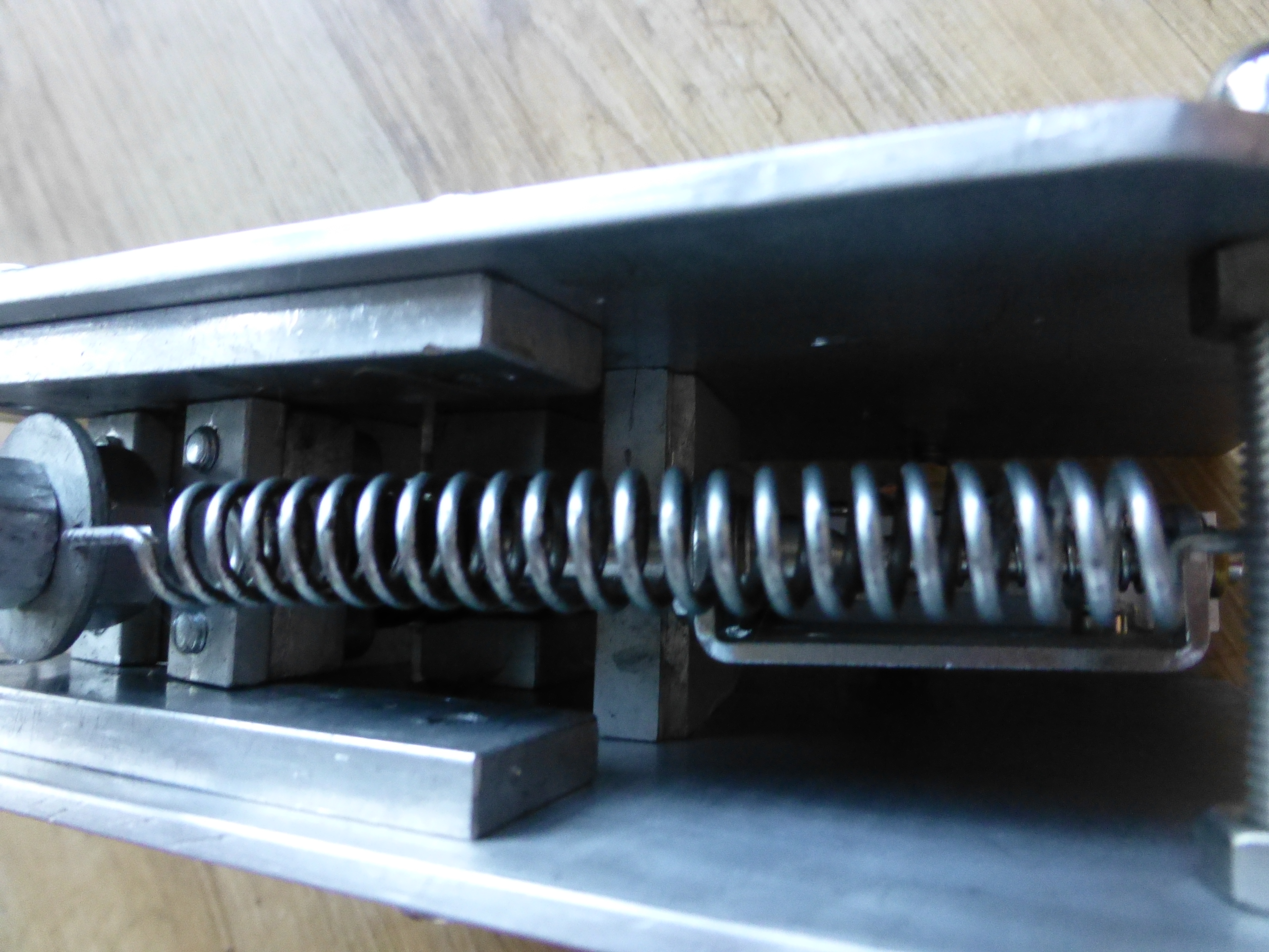

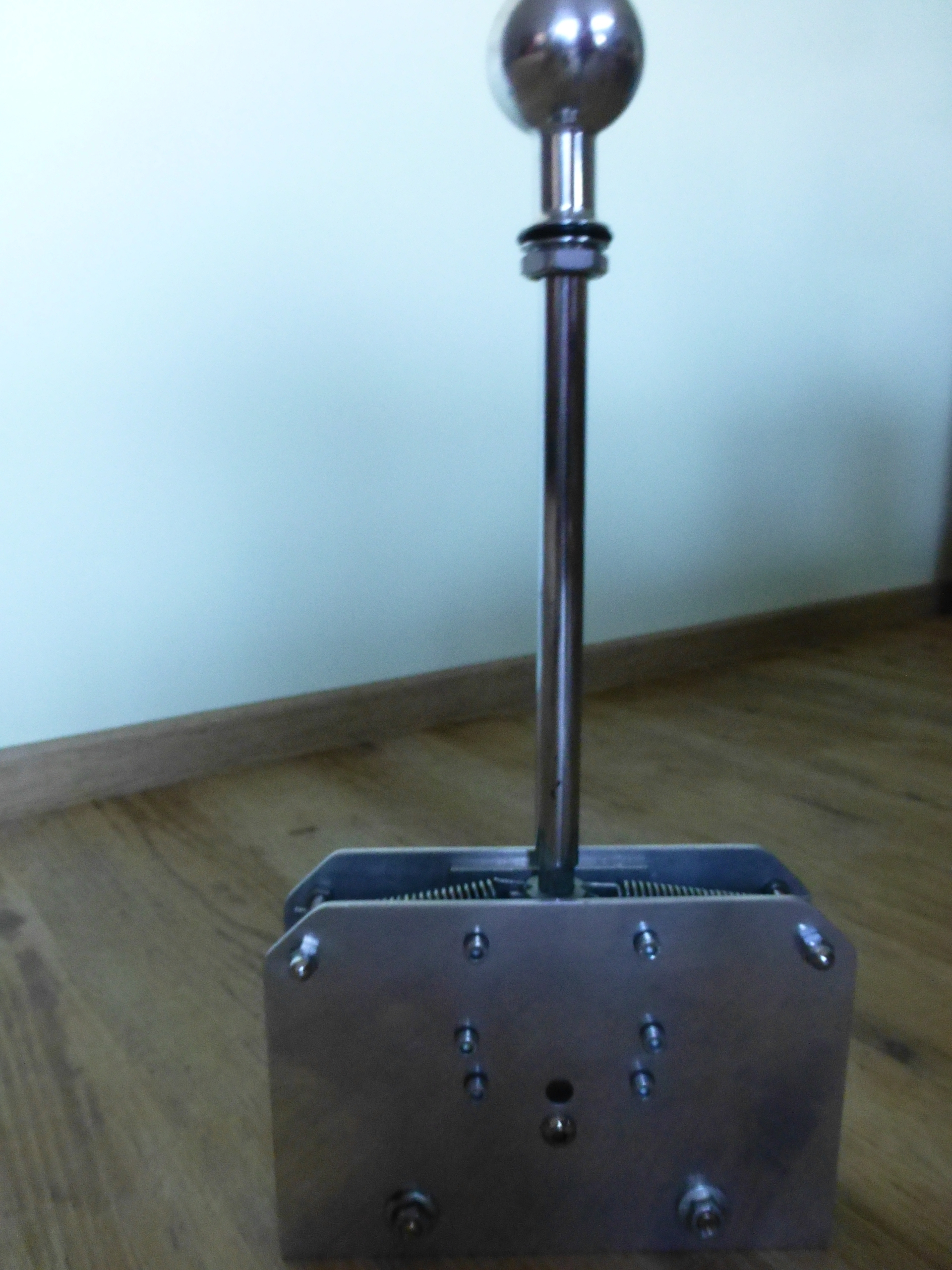

    After spending some Hours in my Garage I finished my Sequential Shifter.
    This was my first Shifter which was stuck im early Beta Stage for nearly two Years

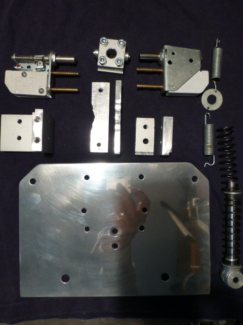

    But this won´t give me a real feeling.
    It has only resistance from the spring, when you see a real Sequential Shifter working, you see the Force increases and releases when the gear is locked.
    I had some Brainstorming to find a adequate solution.

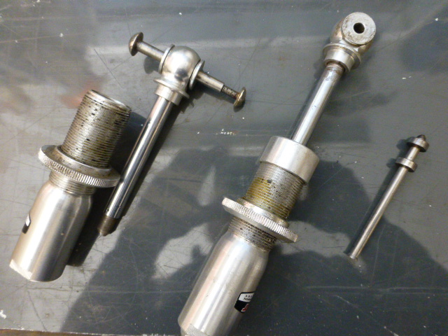

    Here are some useful parts:
    Left : A shockabsorber from a Bike and a hardened shaft with two bearings 5X11x4

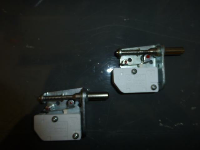

    Right: Switch with a push rod. This is recommended, caus if you push a micro switch direct you often get a double Signal ( not good shifting two gears up or down at one time ). This is prevented by the push rod. A switch with some Lever will work also.

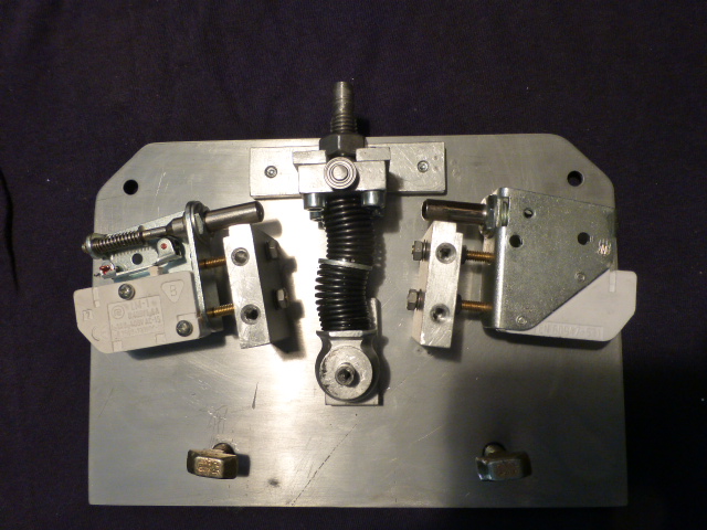

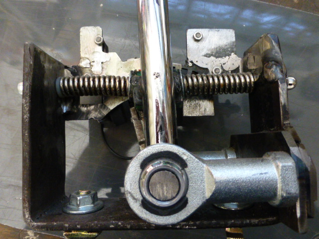

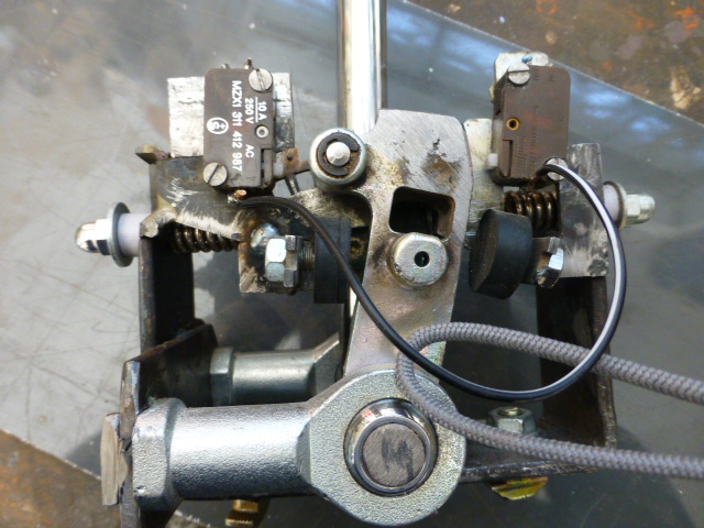

    Here are the Parts:
    Assembled:
    The small bearings are running on ramps ( shown on pic before in the middle)
    In the middle a semi circle with a smaller on each side.
    The force increases, reaches the peak and releases.
    Here a small Video:
    The Ramps are changeble , so its easy to change the character of the shifter.
    Not so far away from the original Shifter!
