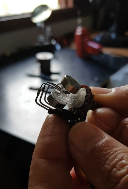

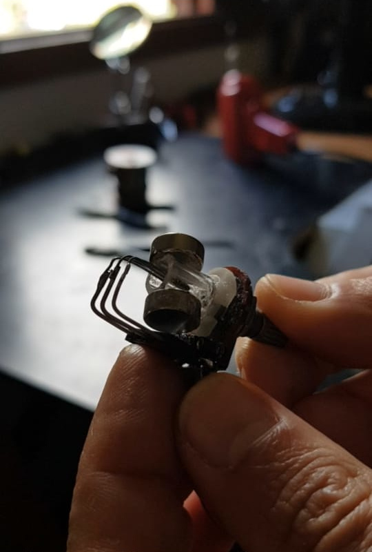

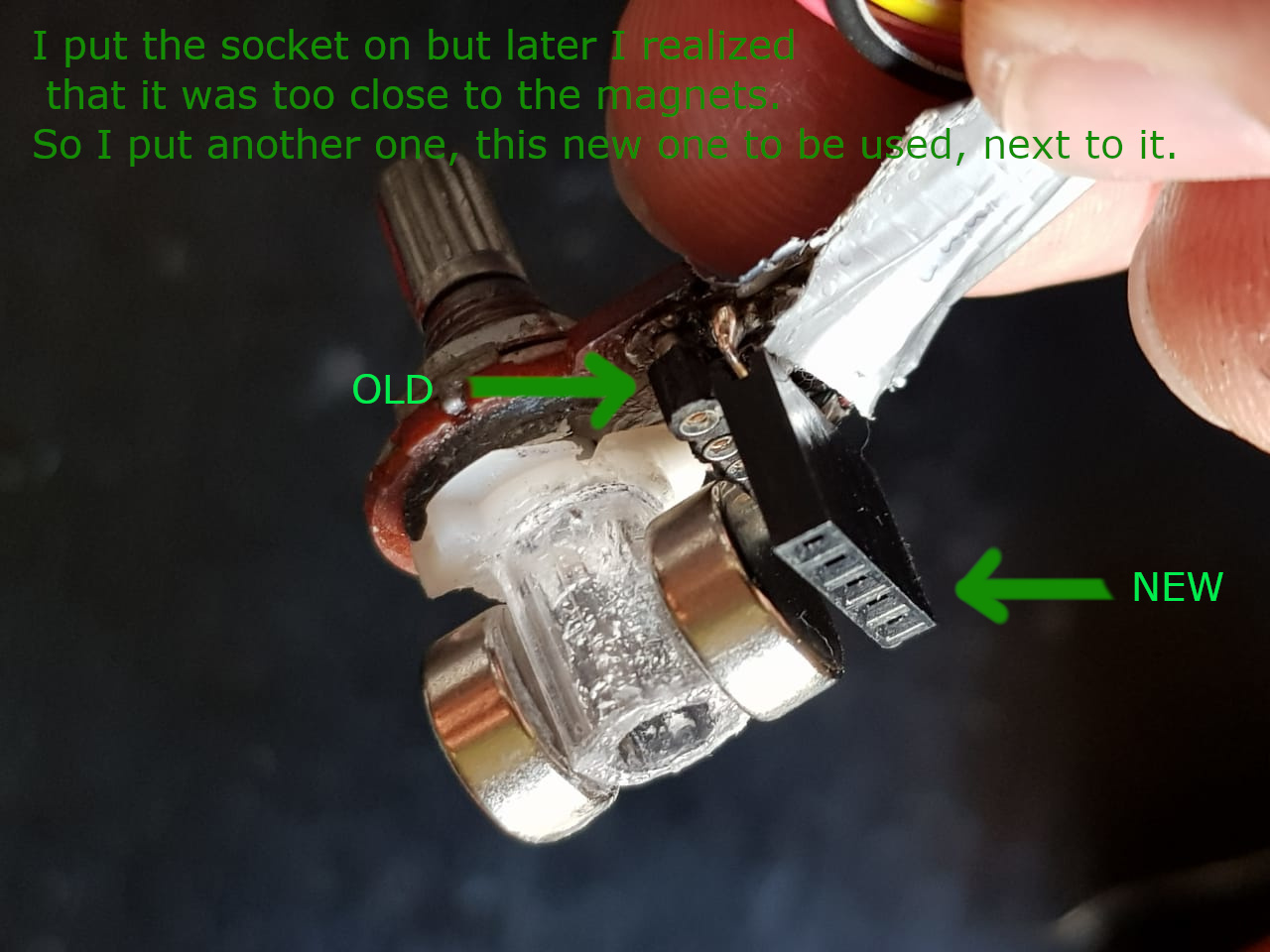

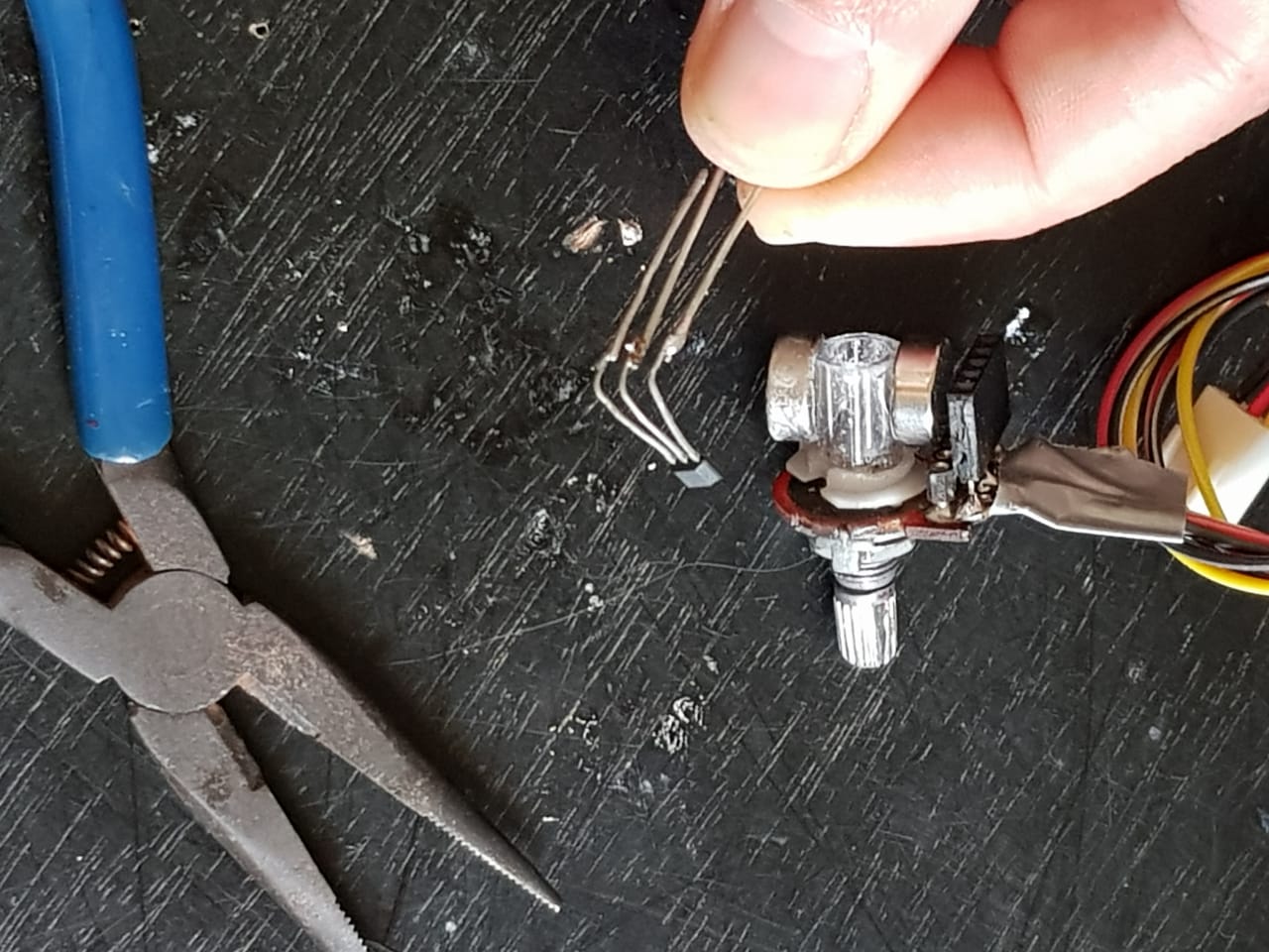

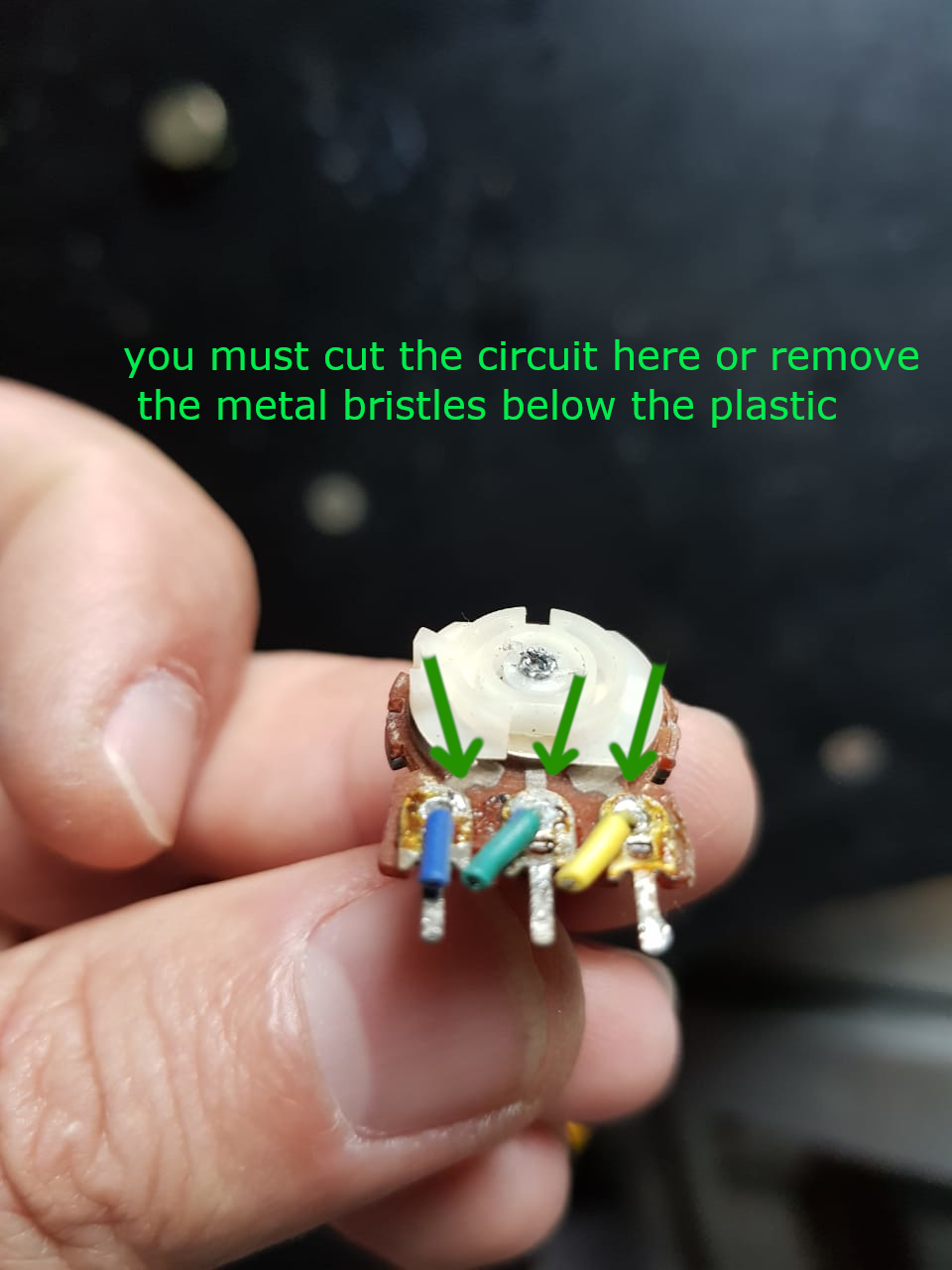

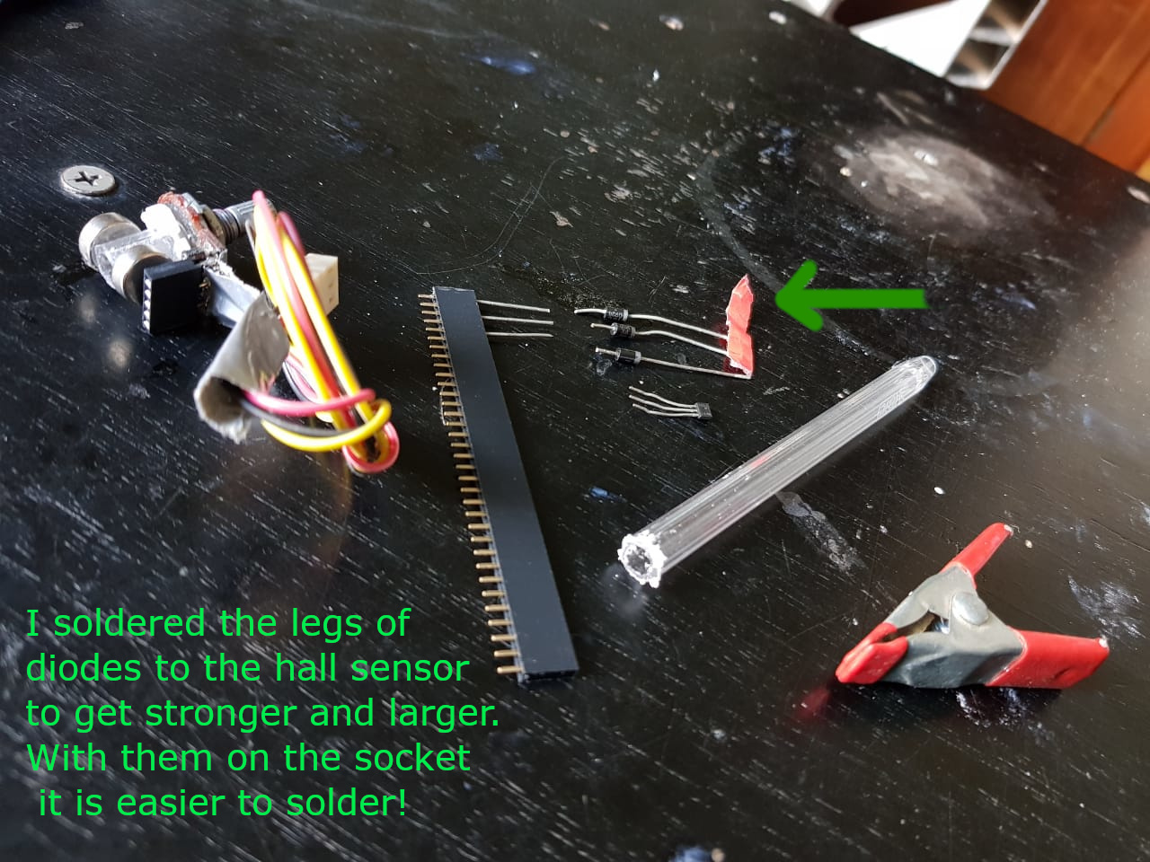

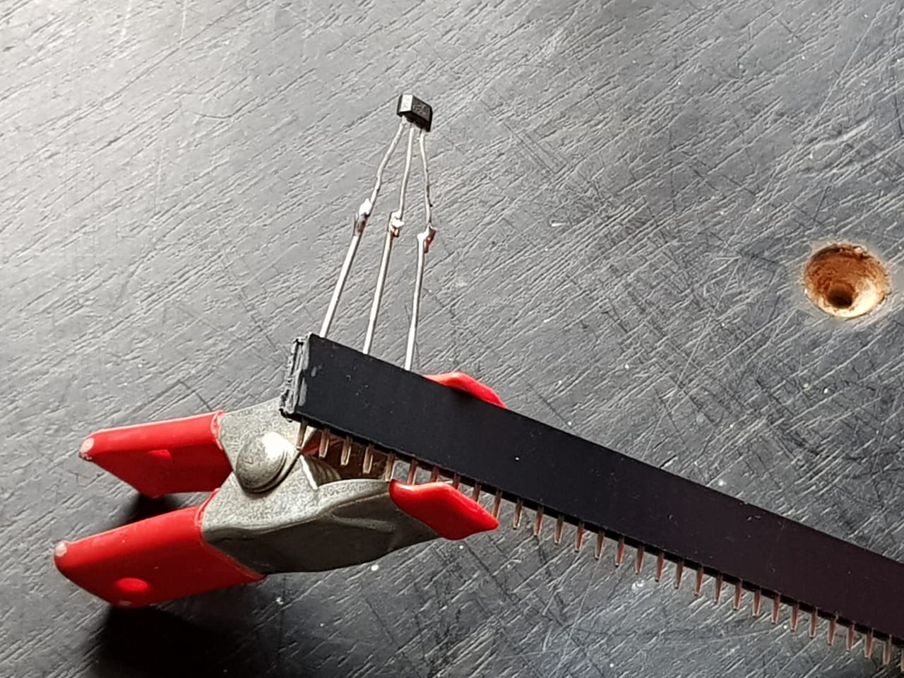

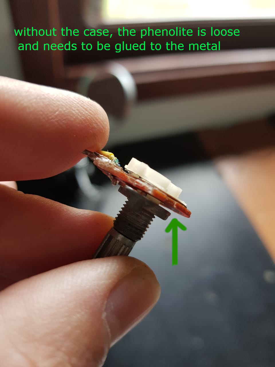

    I've been wanting to improve the pots on my platform for some time now. I had already tested some models of hall effects.
    So with the a1302kua-t 02k in hand and my platform stopped because Monster Moto is on its way I decided to do it once and for all.
    I tested with 5 volts and the output result was 0.1 to 4.7 volts. I think it's not bad.
    I haven't tested it on the platform but it looks very precise and smooth!
    Another advantage is that it fits exactly where the pot originally was.
    WhatsApp Image 2020-05-06 at 16.09.04.jpg WhatsApp Image 2020-05-06 at 16.09.04 (1).jpg
    WhatsApp Image 2020-05-06 at 16.09.03 (3).jpg WhatsApp Image 2020-05-06 at 16.09.03 (4).jpg
    WhatsApp Image 2020-05-06 at 16.09.03 (1).jpeg WhatsApp Image 2020-05-06 at 16.09.03.jpeg
    And Finally
    WhatsApp Image 2020-05-06 at 17.23.43 (1).jpeg WhatsApp Image 2020-05-06 at 17.23.43.jpeg

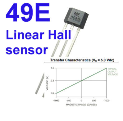

    9
    Informatics Hardware
    Argentina
    60Coins
    Hello friend, where I live I cannot find the Hall 1302A, however there are some Hall 49E (OH49E or SS49E) that provide a theoretical output of 1 to 4 Volts and are powered with 5 Volts. Could you tell me if you know that this one can replace the one you have installed? Thanks in advance (below the 49E) 100030
