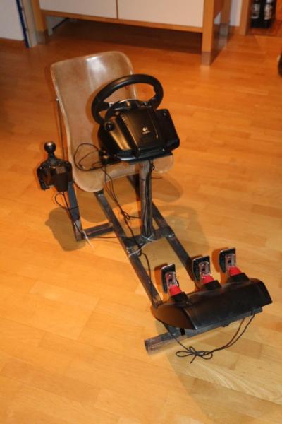

    Hallo Xsim,
    I would like to extend my DIY Playseat with 2 DOF. At the moment I have only a steel frame with kart seat and Thrustmaster RS500. I bought an Arduino and 3 Monster engine drivers. Now I'm looking for suitable engines with 12V and what else is missing.

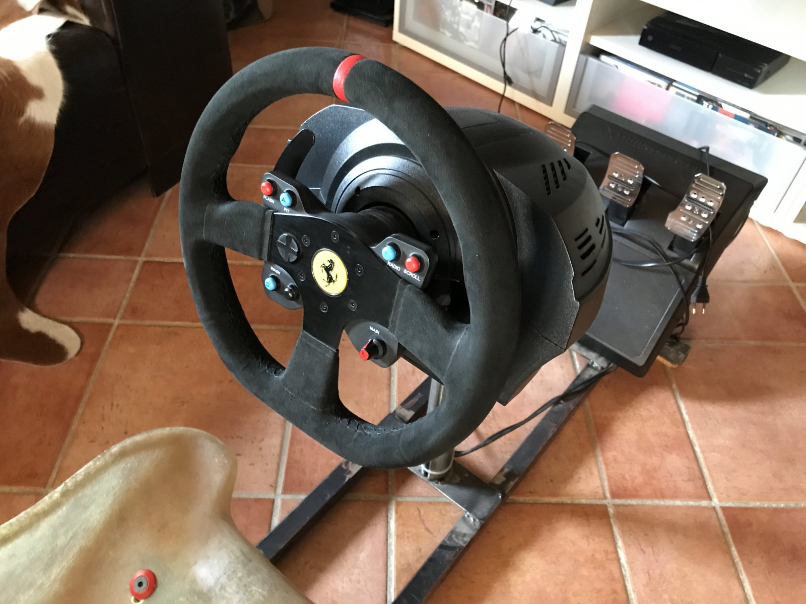

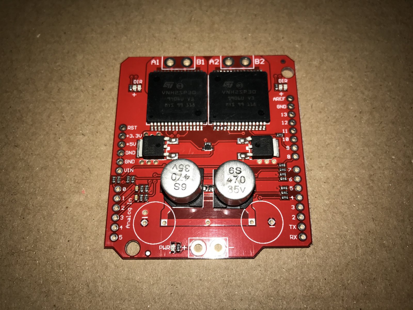

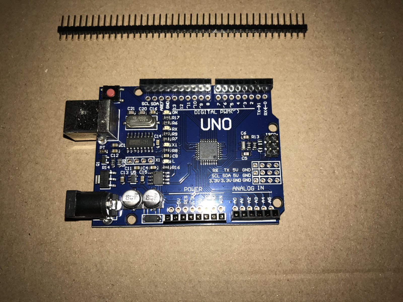

    Hallo,
    now a few new parts have arrieved:
    - Arduino
    - Monster Motor
    - Sparco Race Seat

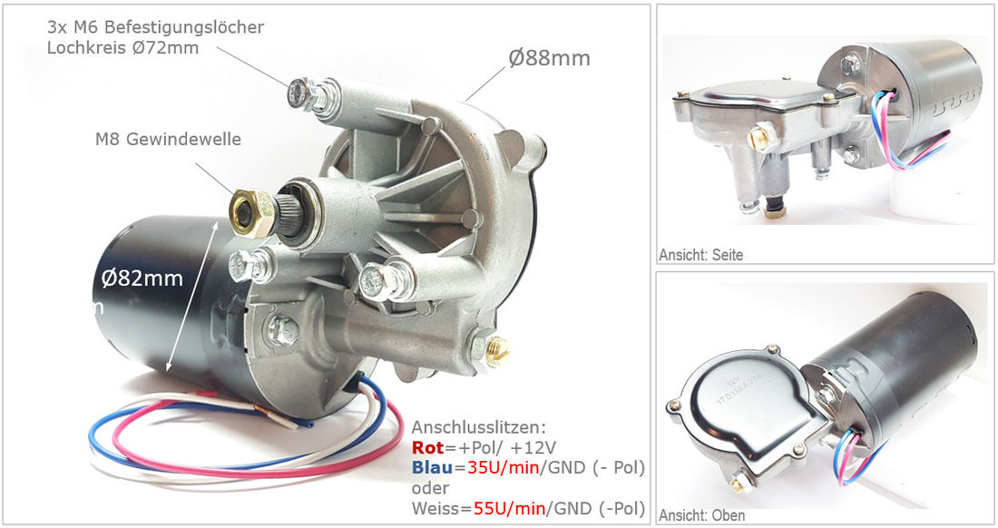

    Hallo,
    I have found on ebay this engine. Is it strong and fast enough?
    WG88BD82-3 Schneckengetriebemotor: 12V | 80W | 35/55U/min | max. 60Nm | M8 Welle
    Beschreibung:
    • Drehmomentstarker 12V Getriebemotor mit extra grossem Ø88mm Schneckengetriebe mit max. 60Nm Drehmoment. Leistungsstarker Gleichstrommotor mit 80W und Motordurchmesser von Ø82mm
      __
    • Drehrichtung Uhrzeigersinn (Drehrichtungswechsel durch Umpolung möglich)
    • Motortemperatur (Motorgehäuse) max. 55°C (bei hohem Drehmoment Start/ Stop betrieb notwendig)
    • Version: mit 3 Anschlussdrähten. Anschluss Rot/ Blau= 35U/min; Rot/ Weiss=55U/min
      (Ersetzt die Modelle WG88BD82-1/2)
    • 12-24V Betrieb möglich (max. Temperatur des Motorgehäuses beachten)
      _
  12. noorbeast
    21,581
    151,100Coins
    +11,030 / 56 / -2
    They look to be some type of wiper motor.
    They would likely work with a design that has a lot of leverage like a foot or shoulder mount, but they are not particularly fast nor as good as what was already recommended for the plan you had put forward, which is a knee mount design.

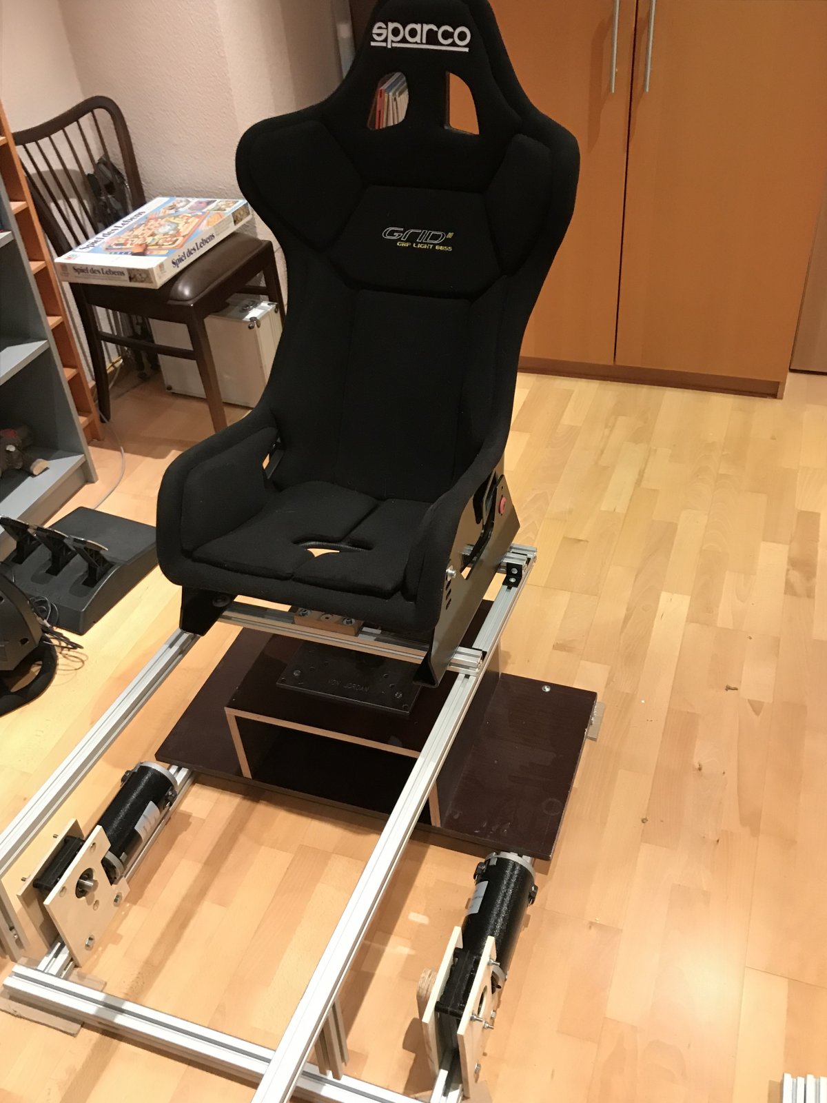

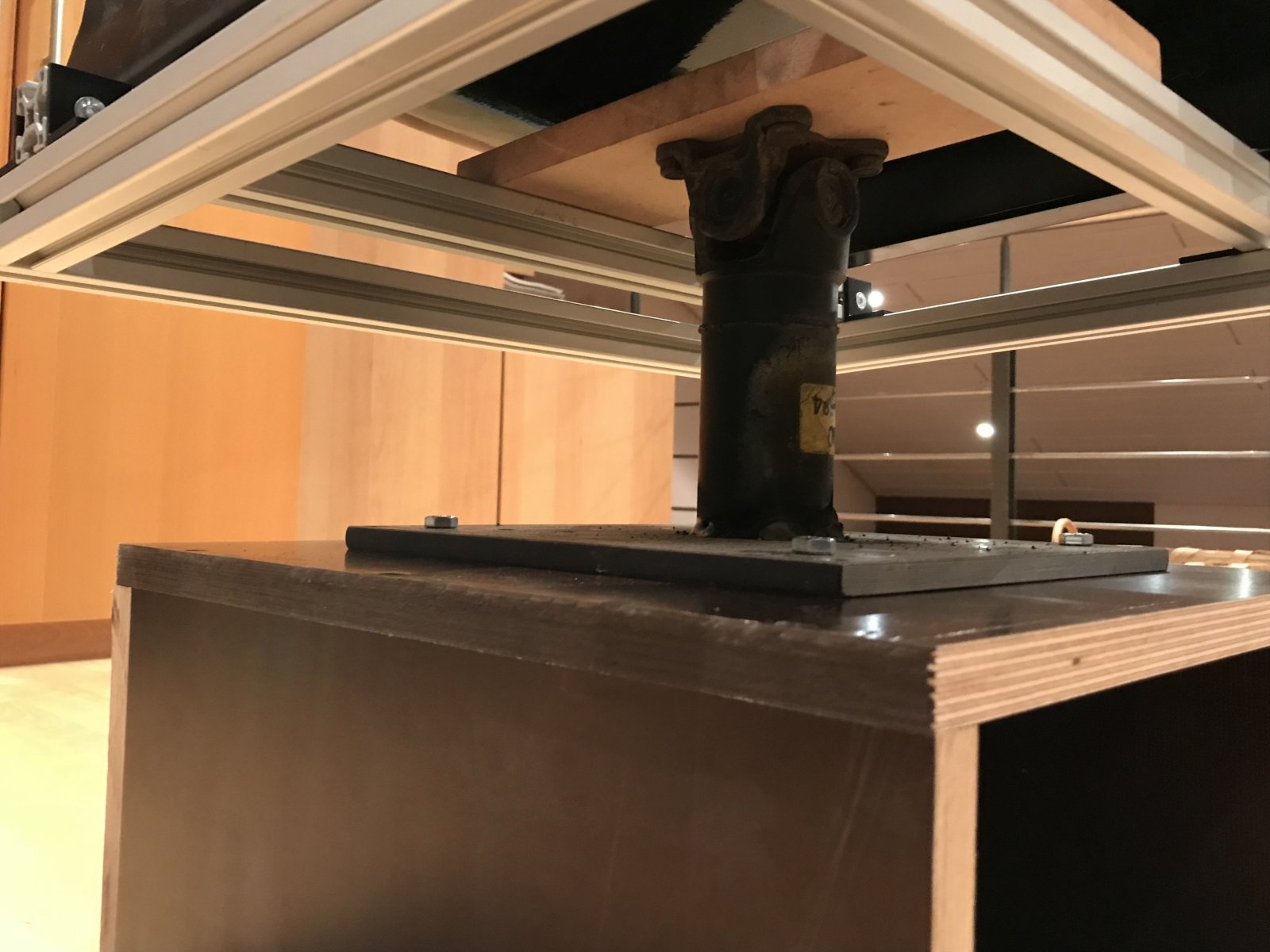

    there is news:
    The engines were delivered very fast. Could pick her up directly at the customs office. Fee about 100 €
    In addition, I have ordered for the base frame 40er aluminum profiles and already got. Cardan joint is from a BMW 3 series. I also made some wood of the basic construction. In the box outside the support the electronics come in.
    The smc3 software and the arduino board are already working.
    Attached some pictures. Have vacation at the moment and hope I can get a long way.
    The software will now use x-plane instead of dirt.
    Greetings from Baden Württemberg
    Dirk
