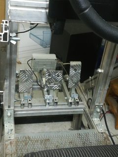

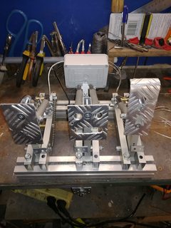

    Hi all, as the title and I hoping it can be useful, below I would like to illustrate the design of a DIY pedals board with the following purposes:
    1. three pedals, independent position adjustment, gas and clutch with hall sensor, brake with load cell + gas and brake rumble
    2. 12 bit controller / ADC self-made controller board, buttons for button box and gearbox
    3. solidity, usability and economy (especially !!!)
    ITA
    Salve a tutti, come da titolo e sperando possa essere utile, nel seguito vorrei illustrare il progetto di una pedaliera autocostruita con i seguenti scopi:
    1. tre pedali, regolazione di posizione indipendente, gas e clutch con sensore hall, brake con cella di carico, vibrazione su gas e freno
    2. scheda controllore autocostruita 12 bit ADC, pulsanti per button box e cambio
    3. solidità, usabilità ed economicità (soprattutto!!!)

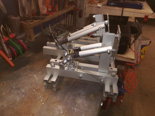

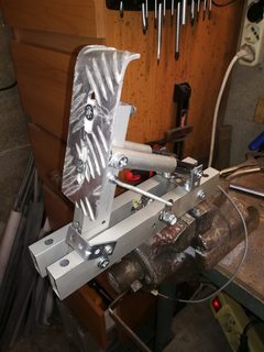

    Part 1

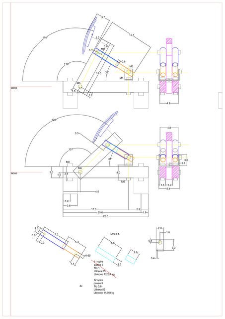

    Pedals and support are made of aluminum; screws M6 and M8, springs and logs in iron. All available in the "do it yourself"shop or hardware well supplied.
    In total I spent about 15 euros for these parts, considering something I had in the garage (aluminum profiles for support).
    For the electronic part and sensors I spent about 20 euros.

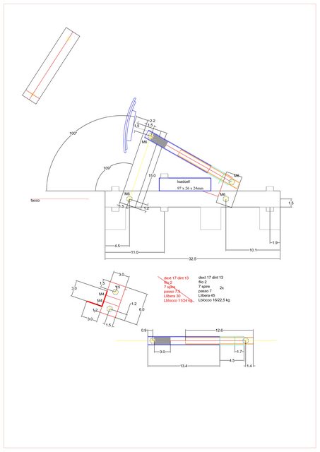

    I enclose drawings cad of maximum (the measures are varied in course of work, but not of much) of the type pedal.
    NB Do not pay attention to the lower part of the design, they are notes for the construction of the springs, then redone in the final version.

    Allego disegni cad di massima (le misure sono variate in corso d'opera, ma non di molto) del pedale tipo.
    NB Non fare caso alla parte bassa del disegno, sono appunti per la costruzione delle molle, poi rifatte nella versione finale.
    Pedale GAS [​IMG]
    Pedale Brake [​IMG]
    Pedale Clutch [​IMG]

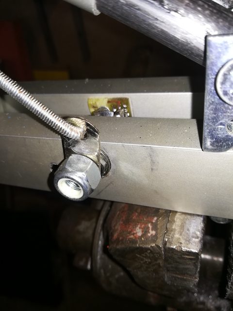

    Part 2
    The gas pedal has a simple excursion of about 5 cm, contrasted by springs at light load (1mm wire, 5mm pitch, 12mm diameter, 8cm length). The signal is detected by a hall sensor Allegro A1302, fixed with a rotating magnet by means of a linkage acting on a pin - on bearings - on which a small magnet is fixed. The rotation between position at rest and bottom stroke is just over 90 ° (the ADC system is 12 bit, about 4095 are used about 2000 steps).

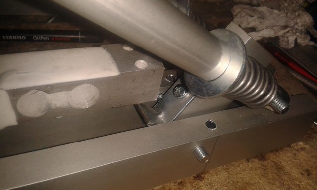

    The brake pedal has a reduced excursion to the GAS pedal, based on two short (3 cm) and hard (2 / diam.8) springs. The stroke ends with a pad (on rubber for compressor tubes) on a hinged L and free to rotate. This transfers the force to a load cell (4-wire, 40kg), free on one side and stuck on the other (eye to the sense of measurement). The signal is carried by 4 wires (Vcc +, GND, V0 +, V0-) and an instrumental amplifier INA122 which operates the differential amplification of the input signal and transduces it between 0 and 5V. the gain is adjustable (depending on the force to be applied to the cell) with a 10k multi-turn pot.
    Calibrating with DWTweak2 I have obtained that the noise remains under 250 steps and the total excursion (now calibrated to about 35 kg) is about 3500 steps (12 bit system). In the following photos there are some external springs that have been replaced by the internal ones.

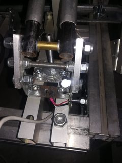

    The clutch pedal tries to emulate, by construction, the different phases of resistance to pressure, typical of a clutch.
    The system was created based on commercial "pro" solutions available on the web.
    Operation: the first part of the stroke, about 3 cm, is opposed by light load springs, once a full stroke intervenes a rotary kinematic movement - about 4 cm stroke - with medium spring contrast.NB the long springs have been replaced with springs with 1,5 mm thread.

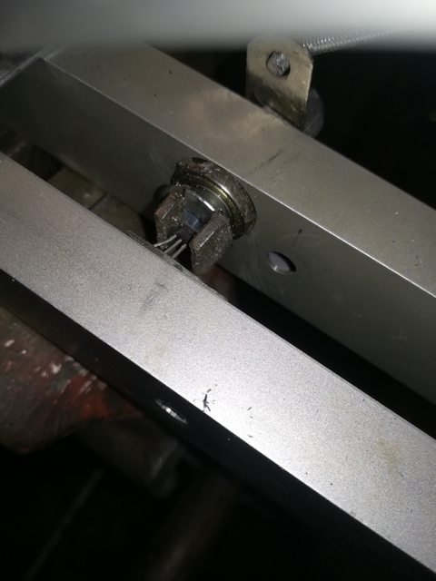

    Signal side see GAS pedal. The hall sensor (Allegro A1302) is installed on the rotation pin, so that it is possible to adjust the signal range only near the bottom of the rotation stroke (it simulates the removal of the clutch), with about 2000 steps (1000 are more than enough).
    Comments and suggestions are welcome, for me the feeling of driving is superb but I've never tried "pro" pedals (until now a G25 and the pedals of a Fanatec entrylevel).

    [​IMG] brake system
    [​IMG] hall sensor gas pedal

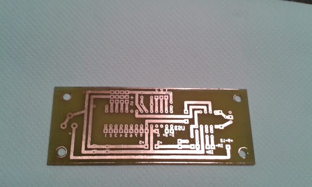

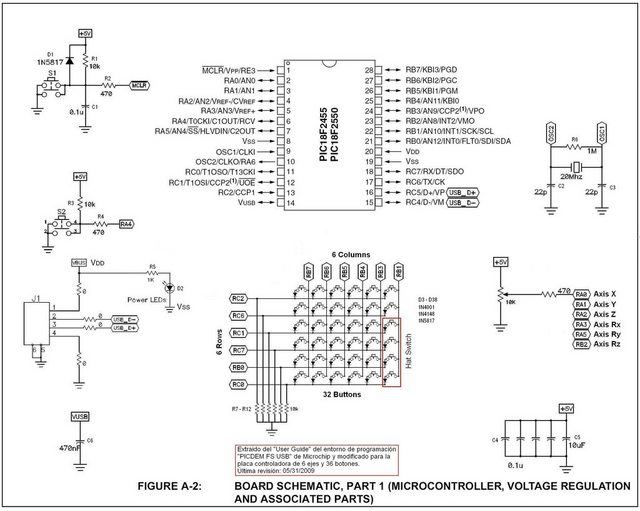

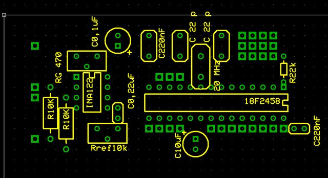

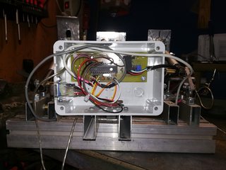

    The system made of a 12-bit USB controller board + load cell amp (pic18F1458 + INA122).
    The original project and the firmware was taken by a Willynovi creation "USB-Joystick with 5 Axis and 24 Buttons employing PIC18F2455" available here https://www.xtremeracers.info/forums/viewtopic.php?f=45&t=5696.
    I made some changes, in particular the original system was 10 bit and I brought it to 12 bit, in addition to the insertion of an instrumental amplifier for load cell INA122, here are some photos:
    For my project I used the X, Y, Ry axes over 6 buttons (2 for sequential gearbox and 4 programmable) on RC2.
    My project was born several years ago.
    Today everything is feasible more simply using an Arduino Leonardo or Pro Micro (ATmega32u chip) that natively can be seen by win as an HID device. Here a link made well to program everything:
    https://www.instructables.com/id/Crea te-a-joystick-Using-the-Arduino-Joystick-Pound /
    looking on the web "HID arduino game controller" you will find sketches already written for different applications.

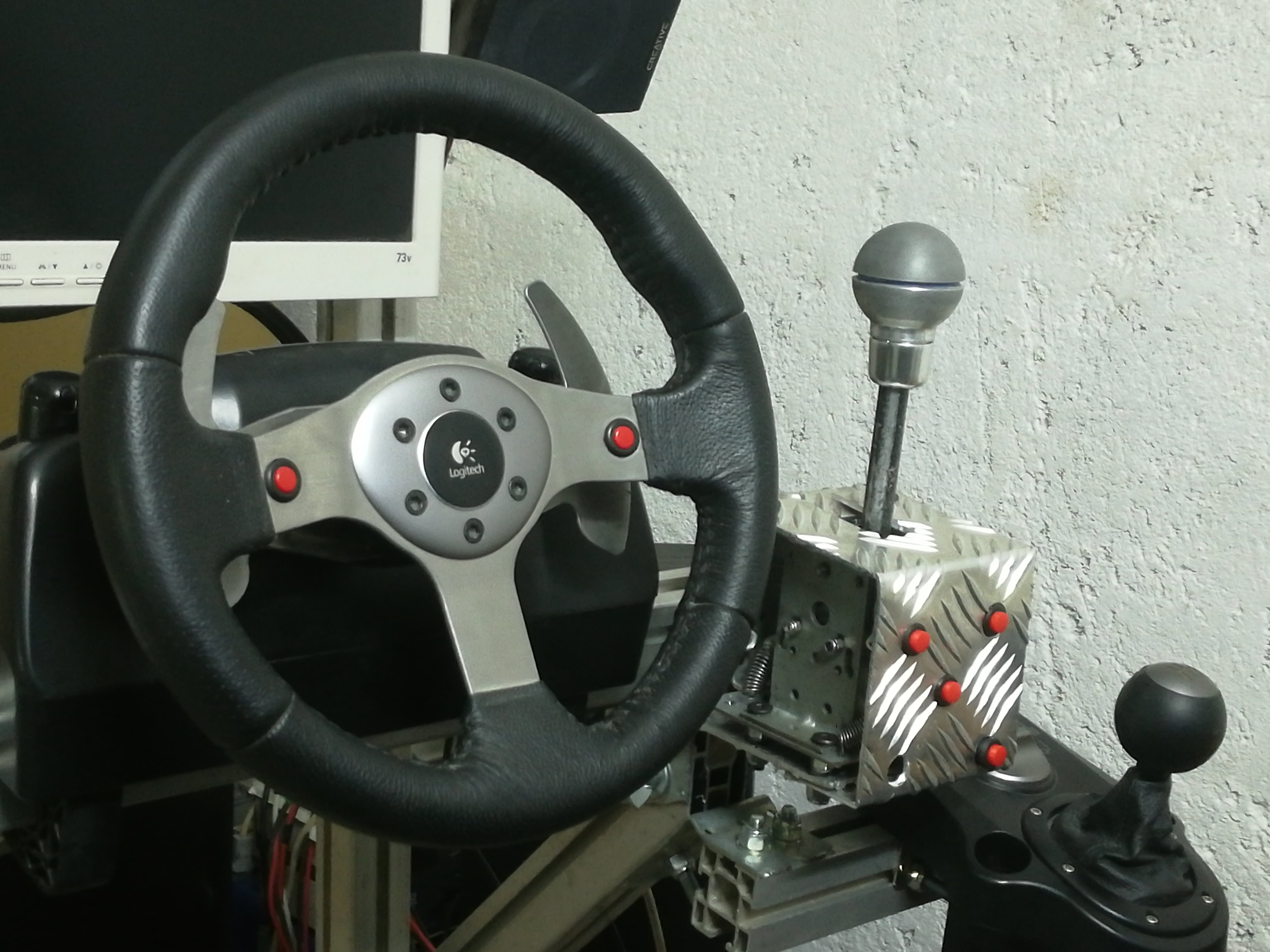

    Hi, seq shift pics.
    New post?
    Micma
