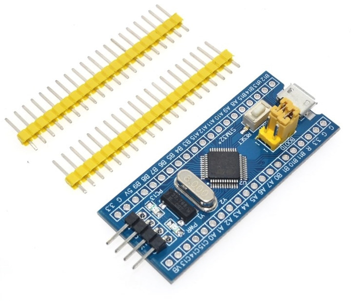

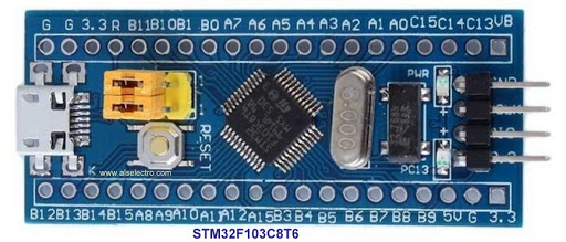

  10. f1simgames
    f1simgames Member
    Mar 21, 2014
    34
    516Coins
    +27 / 0 / -0
    As i write before , STM32 controller with plastic reset buttons not work with analog devices.If you see , those controllers not have the original STM32 chipset.
    Only STM32 controllers with round metal reset buttons works.They have original STM32 chipset.
    Those are photos of two controllers. First works , Second not!
  11. tag141
    tag141 New Member
    Apr 28, 2013
    Tinkerer
    South Walesish
    - 2Coins
    I read this whole thread and didn't see where that was written.
    Mine has a square reset, so bang out of luck. Luckily they are cheap.
    cheers

    Tried a round & square button STM32, sadly, both don't seem to read analog input. Now using an Arduino instead and that works fine but I'd rather run the STM32 with OSH Studio to be honest for the extended functionality and software.

    I bought a black pill (STM32F103C8T6) to try analog with and I have only tested a potentiometer and it worked fine.

    If anyone is stuck with a bluepill with plastic reset button and cannot get the OSH studio working, the Freejoy software/firmware does work with the bluepill with square plastic reset.
    I tested it on my own bluepill that would not register any analog inputs in the OSH software.
    I am unable to add a link due to a new profile, but a quick google search for STM32 Freejoy will send you on the correct path.
