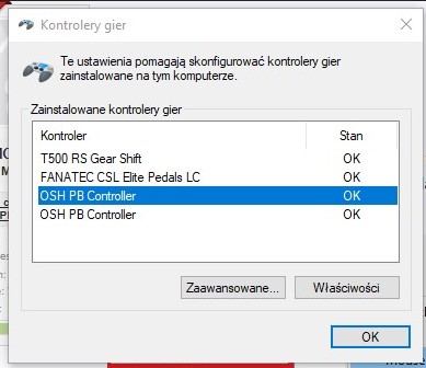

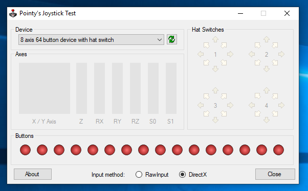

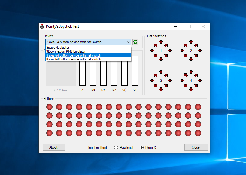

    Is it normal for the v.16 to pull up "2 controllers" ?

    hmm, no maybe its joystick test's "feature"
    windows shows one joystick for me

    @TOPMO3 very nice work, i have the same problem like @Nick Moxley i see 2 OSH Controllers and in default config i have first 6 buttons on:

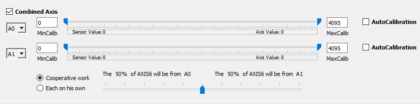

    you should check "combined axis" than 2 inputs will work for the same axis. for example below one half of axis will came from A0 and another from A1
    it seems something wrong with new combined USB descriptor. some people also report intermittent "USB descriptor will not be recognized" errors
    well, yes you can connect rotary switches this way. Changing number of available buttons for one input is not easy as changing one digit in code however, it'll take some time to increase it

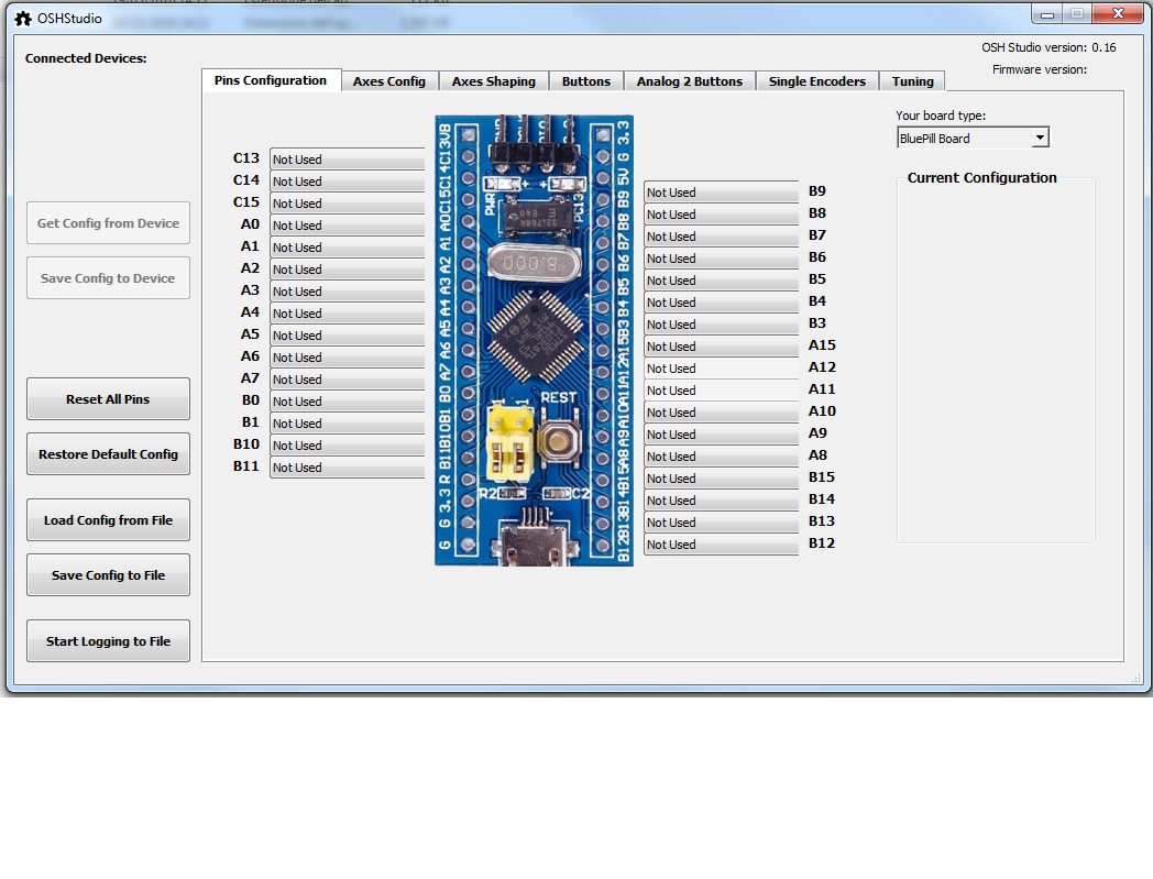

    Hi, I followed the tutorial in full, but I have a problem. The OHSstudio software does not detect my STM32 board. Does anyone know why this may be due?
    Thank you

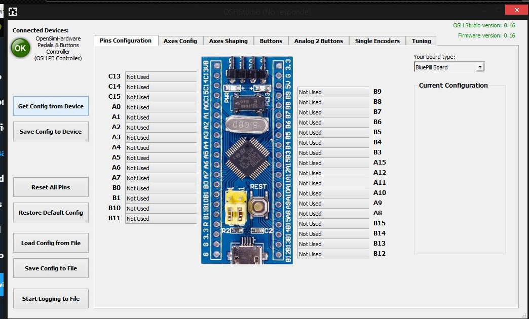

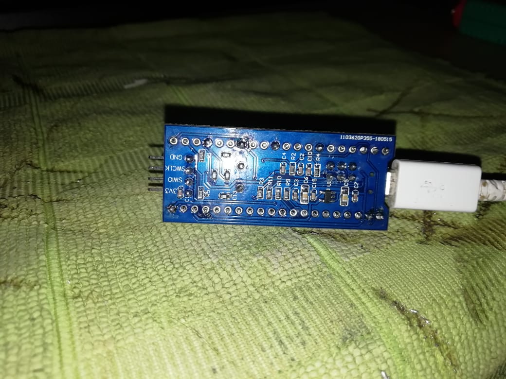

  14. Emiliano Videla
    Emiliano Videla New Member
    Aug 12, 2019
    94Coins

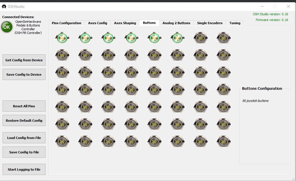

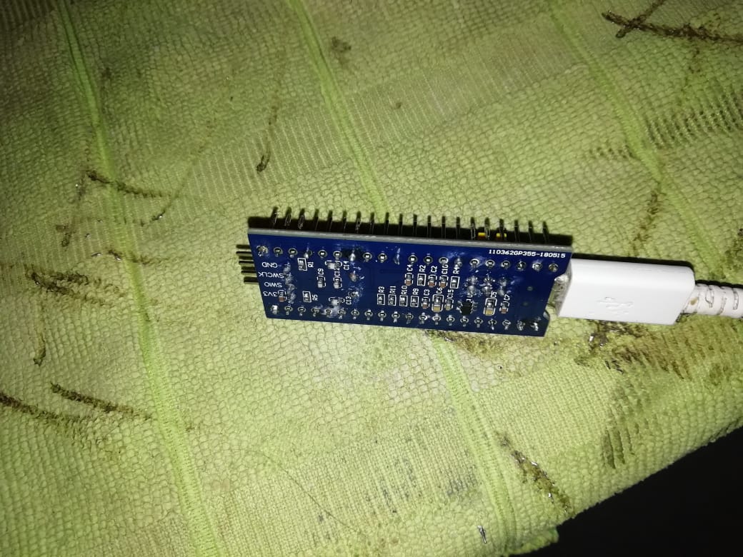

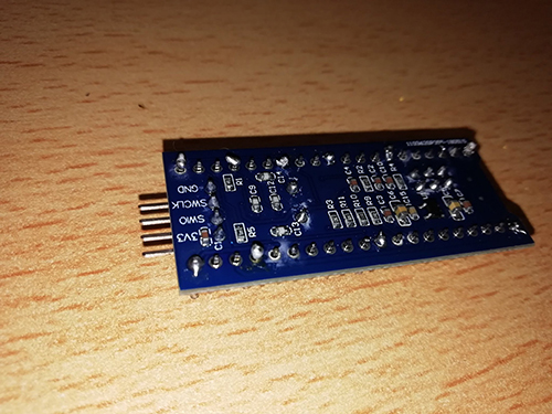

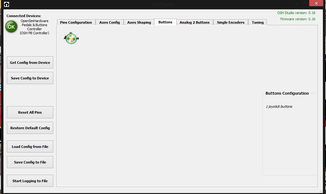

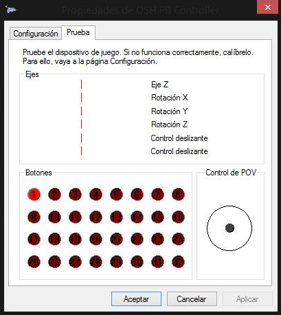

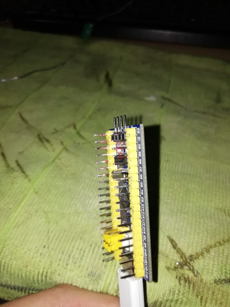

    Hi, I bought an STM32 board to make a steering wheel and I am experiencing a series of problems that cannot be resolved due to my inability.
    It turns out that I installed the firmware on the board as the OSH Studio website says, when adding a button it is kept pressed, the funny thing is that I have not yet welded any cables to the board, if I made previous attempts but currently not It has none.
    Then I will leave some screenshots to show what I have at this time.
    This is how it looks in the OSH Studio
    This is how the STM32 board is
    [​IMG] [​IMG]
    And here is a sample of what the pressed button looks like without having a single cable soldered on the board.
    [​IMG] [​IMG]
    Please help :(:(:(
  15. Nick Moxley
    17,057Coins
    +2,507 / 30 / -2
    It doesn't appear that you have soldered the Header Pins properly on the board, Please take a better picture of the Soldering job.
    Imo your likely not using Flux, So do yourself a favor and pick some up please, Soldering will become a LOT easier with good quality solder and Flux.
  16. Emiliano Videla
    Aug 12, 2019
    94Coins
    I think I'm useless doing this haha
  17. Emiliano Videla
    Aug 12, 2019
    94Coins
    Problem solved, thank you very much for the help!

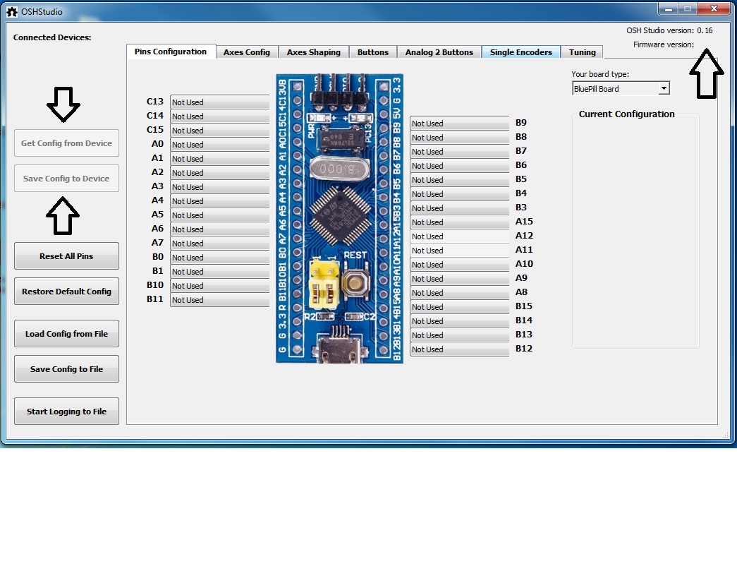

    i have a problem my board is not recognized .i followed the tutorial but i have a problem.....possible solution yks

    get config from device and save config to device is not possible to click
  20. thecures
    thecures New Member
    Oct 22, 2013
    28
    68Coins
    +3 / 2 / -0
    my problem i think ..its' not recognized a firmware .(look the black arrow) ...and the others black arrow is not possible to click
