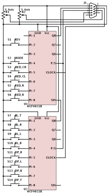

    Hi everyone,
    I did a quick google search but came up empty on this. Has anyone tried interfacing a DIY peripheral (handbrake, H-shifter, pedals) with the logitech G920 via its onboard DSUB connectors? Is the data coming out of these peripherals serial encoded (and if-so is there a proprietary handshake?) or is it just direct pin-outs of switches and pots? If it's the latter, then the 920 would be a great test bed for the operation/mechanics of DIY controls without having to fight with much in the way of electronics or embedded software.

    Hi @Gambledog. Its been a while since I used my Logitech g27 which I assume is the same internals as the G920 but ill give you what help I can.
    The pedal set is just 3 10k potentiometers directly connected to the wheel base via the dsub connector. You could directly connect to that socket if you wanted to build a diy set of pedals but id be sure to continue to use 10k potentiometers so the current draw from the wheel base is the same as stock. The downsides to those pedals are that they are only 8bit resolution (256 potentiometer steps) when plugged into the wheel base and they don't have a load cell brake pedal which in my opinion is a must for any serious sim racer. As for the H shifter gear lever and handbrake mods that you mentioned they are just connected to buttons as standard so would be relatively easy to mod both. However there is a better and much better way to do what you mentioned.

    This is definitely helpful. Thanks! I think the LB board will be the way to go for PC controls. I didn't realize the 920 pedals were only 8-bit resolution.
    I found a diagram for the shifter that shows x/y data for the shifter on 2 pins (pots presumably) but there are serial in and out pins for button info and dead links to arduino scripts that talked it through a calibration/handshake. Unlike the pedal it seems like it's got some proprietary communication going on. The detailed documentation is lost to a time when modders were still paying attention to the G25/27.

    I don't have a Logitech wheel set anymore as I gave it to a fellow sim racer years ago when I got my direct drive wheel and to be honest I never tried to mod the shifter as I never used it. I built a button box for the pc, unplugged the shifter completely and just used the paddle shifters. I cant test any of this for you but ill try to help assuming the G920 is just a g25/g27 in a new dress
    Ok it seems you were right about the shifter, it does indeed use 2 potentiometers for gear stick position and 2 shift registers for the buttons daisy chained and using spi to communicate with the wheel base. The wipers on the 2 potentiometers are wired directly to the Dsub connector and are basically used as analogue buttons.
    give this a read.
    http://forum.arcadecontrols.com/index.php?topic=134988.0
    The black / red buttons, hat switch and reverse switch all wire to shift registers (74hc165d or similar as the ones suggested in the schematic are no longer manufactured) and are wired like this
    You will probably have to check and change the pin configuration of the Dsub connector as Logitech seem to change this model to model.

    This helps! I think I'll keep it simple and just do the sequential shift, pedals and handbrakes as console-compatible mods. If/when I do the H shifter I'll probably go straight to something USB compatible.
